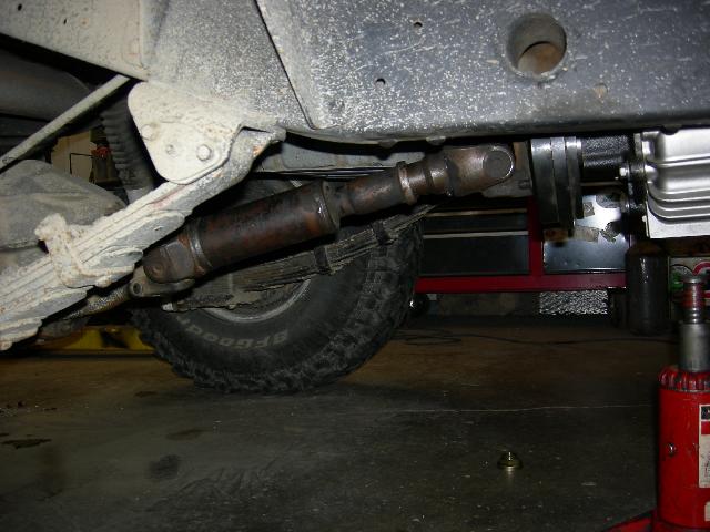

This truck is not going to see hard core off road trails, so the fact that the trans and tcase are sitting an inch and a half lower than they would be is of no real consequence.
Lowering the trans/tcase sneekee but I like it, how was this done

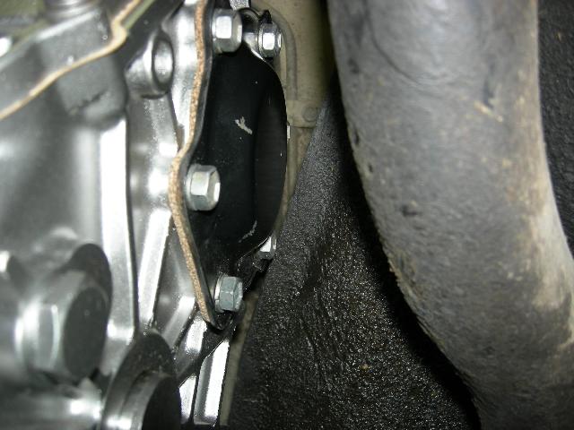

I have a very small clearence dent in the cross memeber but we do play hard:D
Mine
I actually tapped the fuel tank seam gently:D to give a little xtra clearence it's real tight.

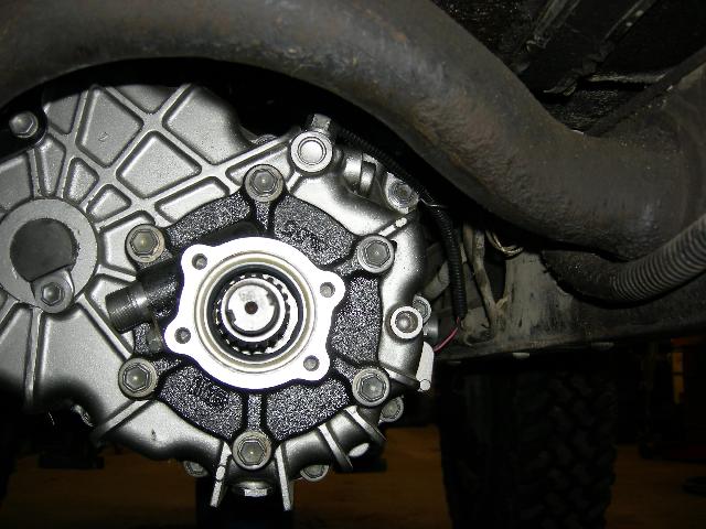

I had issues with the low range shifter interfering with the hand brake but looking at your pics been left hand drive it's not an issue. I had to bend the gear leaver over to the right of the hand break and shorten it other wise it also interfered with my leg. Before the hand brake was in the way between high 4 and low 4

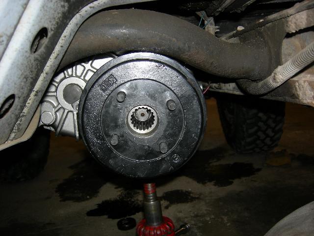

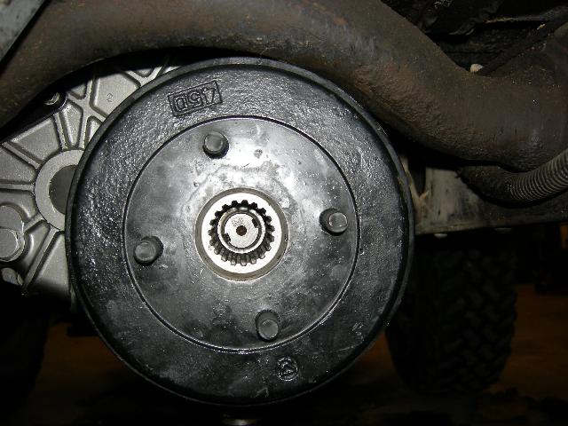

Hi All:
Cool pics! Thanks Steve and Matt!
Steve, I assume these are "mock-up" photos of the PB drum since then PB backing plate is apparently missing? :D
Regards,
Alan

Great thread Poser. It's bookmarked for my current project. Did you give any thought of using the MAF "disc" parking brake to help with clearance? I haven't seen anyone mention that before so it must not be a great option. Keep the great info coming.
I really didn’t.
I have not heard anything good about any of the disc brake parking brake conversion kits that have been out there for a while now. This will work great. The stock speedometer cable reaches, as does the stock parking brake cable.
