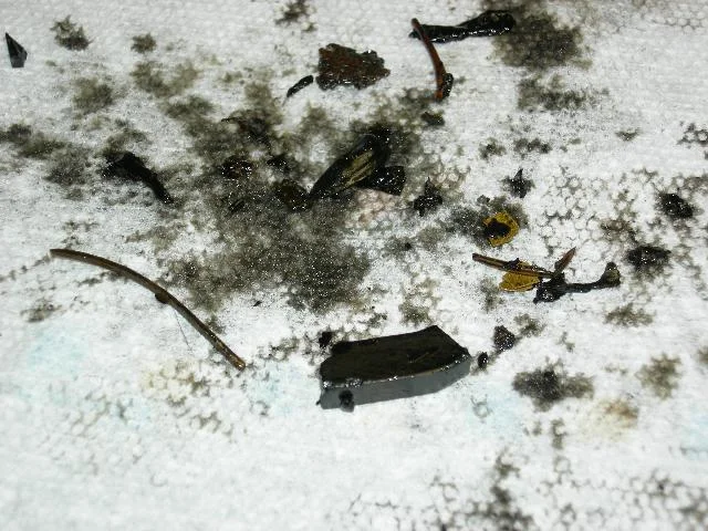

So I have been working on this a bit today...

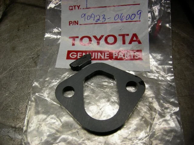

I think that MILLHOUSE figured out what the large mystery piece from the oil pan was...
attachment.php

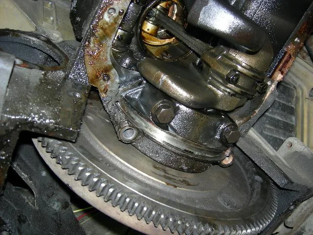

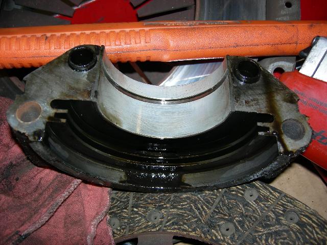

Dropped number five rod bearing, just to see what might be going on inside there...looks pretty good. I will drop a couple more just to make sure there is no lower end drama cooking in here...

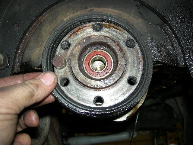

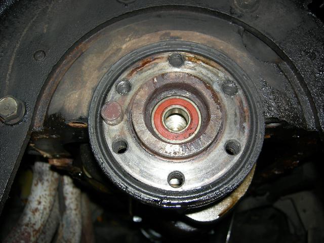

So the oil pan is down and the clutch has been removed. I have removed the flywheel bolts, and realized that the exhaust system was preventing the flywheel from dropping free. So after gas axing the offending pieces of exhaust tubing out of the way, the flywheel dropped free. It is good to know an exhaust guy.
I also removed the four bolts retaining the number four main cap so that I could remove the rear main seal by hand and inspect the number four main bearing.

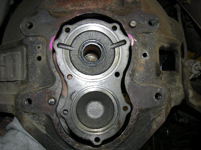

Needed to modify the flywheel housing to work with the input bearing retainer of the H55...
Pictures show the input bearing retainer from the H55 and the areas where the flywheel housing need to be opened up. I marked those two spots with a pink paint pen, and then got after them with a 90 degree die grinder with a carbide tool. It made pretty quick work of the areas that needed to be removed.
The top picture shows the tool used to modify the flywheel housing...
