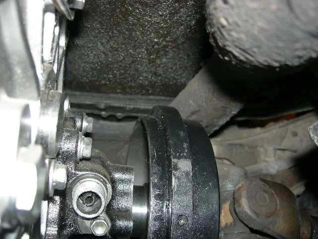

Needed to modify the flywheel housing to work with the input bearing retainer of the H55...
Pictures show the input bearing retainer from the H55 and the areas where the flywheel housing need to be opened up. I marked those two spots with a pink paint pen, and then got after them with a 90 degree die grinder with a carbide tool. It made pretty quick work of the areas that needed to be removed.

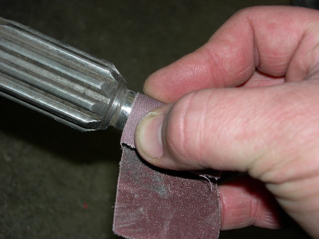

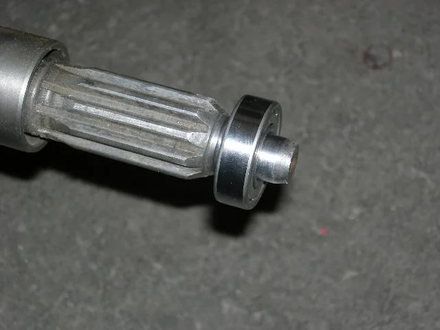

So the flywheel is in and the new fasteners are torqued. Before installing the pilot bearing, I always make sure that it is a slip-fit on the end of the transmission input shaft so as to avoid any binding while installing the transmission into the clutch and flywheel housing. I just use a piece of emery cloth and lightly sand down the input shaft.
After the pilot bearing is a slip fit on the input shaft, it is then installed into the end of the crank shaft. After it is seated, I put a dab of anti-seize in the center of the pilot bearing where the input shaft will be touching it.

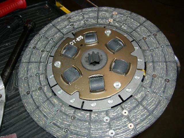

So with the pilot bearing installed, I then install the clutch disc, pressure plate and throw out bearing. The first picture shows which side of the clutch disc is the flywheel side and the second picture shows the opposite side, or the side that faces the pressure plate/transmission when installed.

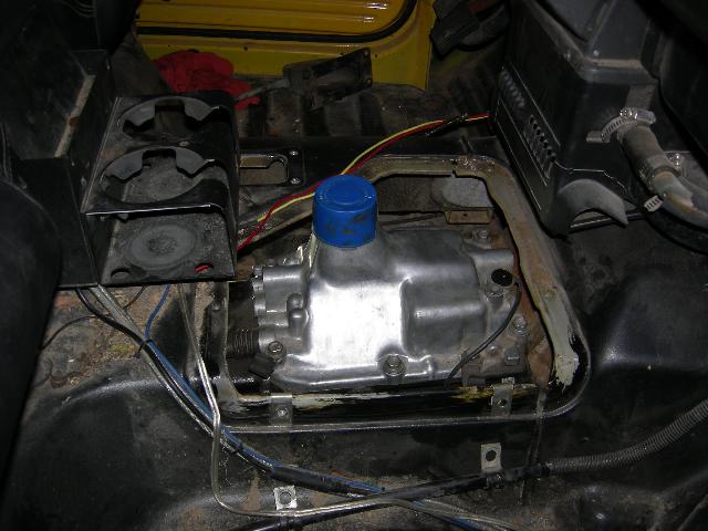

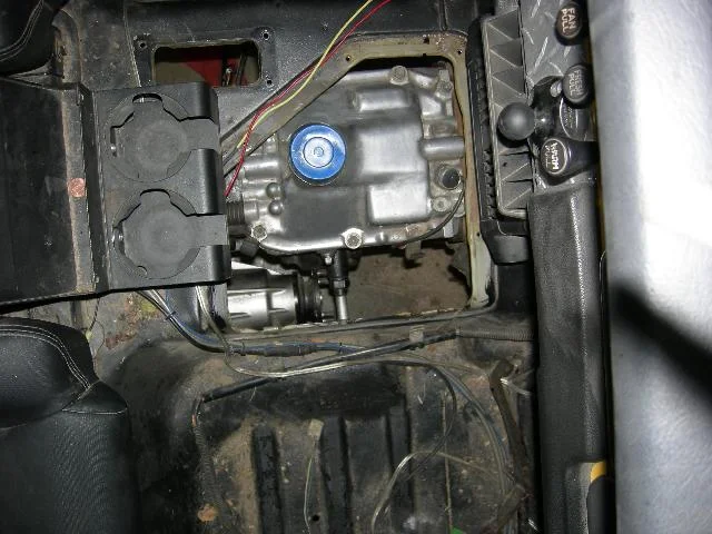

I am just going to modify the floor. I think that is far more realistic and would be applicable to others wanting to see how this is done, since the top plate for this transmission to suit a 40 series is pretty much non-existent. I have been searching for one for over a year now, and they are not that easy to come by.
I have search my entire photo ablum and I must have forgoten to take a photo of mine:crybaby:
But I'll explain. I cut 2 sections from the plate , one around the old holes for the gear leavers taking in the rubber boot captive nuts. The second cut I took so the first cut could be slid into it's positon and welded up, the second cut then filled the hole from the first cut and was re welded.
So I basically cut and slid one piece down and then the other piece up. There are a couple of minor bits like a corner to adjust for and so on but on the whole worked well and kept all the boot mounting geniune.
You might need to put a dent in the cross member behind the tranfer case for clearence or the uni may knock and watch out for the hand brake cable it has issues with clearence and route. Also mine has but only just a slight issue with the uni binding up at full suspesion drop due to shortening the rear tail shaft, the angle gets more acute, I have however moved the rear axle back 30mm. If you have not it may be even acuter depending on you suspension set up. I may one day go to a double cardial joint. There is one other issue but this my only effect me as I drive on the other side of the road. Petrol tank also maybe an issue.
Hope this is food for thought if your not finished, I went to the 5 speed to compensate for the 4.556 diff I changed too. If you want any pics of mine just ask.

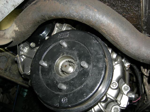

The H55/splitcase came from MAF with the mainshaft and different rear bearing retainer changed so that the parking brake from the one piece case could be used on it.
The guy that owns this truck does not intend to pound rocks with this vehicle. After the trans is installed, I will look at the skid plate and see what can be done, but as of right now, he does not see the need for a 40MPH rock rated skid plate. ;) There will be something under there protecting this though.
The gearbox wont fit with the drum parking brake on no room:D you need the later a model rear hand brake hope this dont burst someones bubble

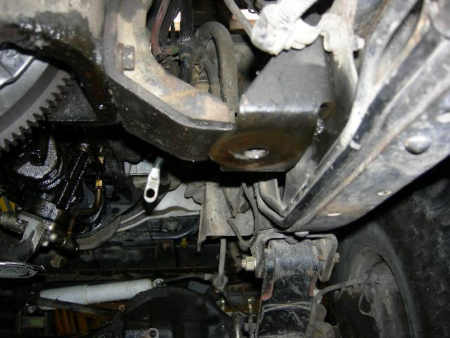

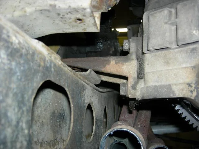

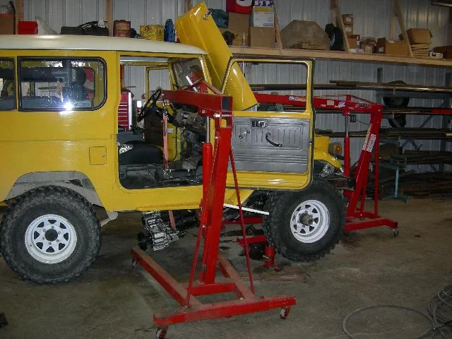

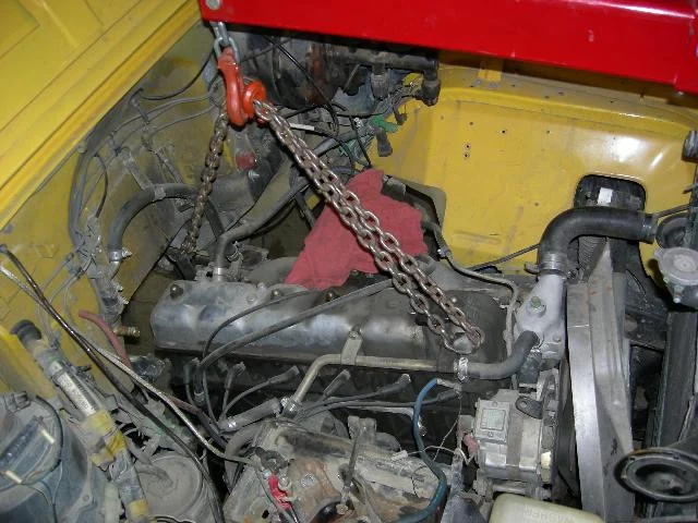

So now is when the fun starts. I had to lower the engine to get the trans and tcase slid home, that is why I had to use two hoists; one to support the engine and one for the trans and tcase assembly.
I am going to be using a late model cross member, however, temporarily for fitment testing and so that I can roll the truck around by hand, I have the front engine mounts back on and secure, and the rear brackets are secure on the flywheel housing, but are just set on the frame.
This truck is not going to see hard core off road trails, so the fact that the trans and tcase are sitting an inch and a half lower than they would be is of no real consequence.
Things are tight, but everything fits, and the rear drive shaft angle, even with a 4 inch HFS lift and 1 inch longer shackles is fine, and would still be if the drive train was raised up to a stock location.
