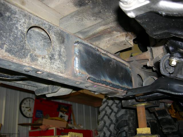

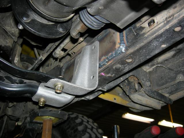

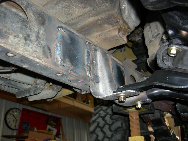

I had to plate the frame where the 60 series frame cross member pieces were going to be welded to the frame, so that I could get sufficient welding surface area to ensure that they remain attached for many years. The center piece (black in color) is a 40 series specific part that a friend in AZ sent up to me. (Thank you Rick! :beer: ) I used .250” thick material to plate the frame.
