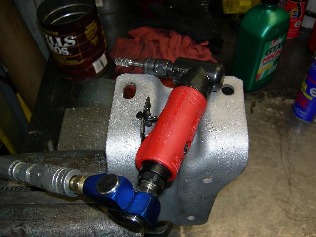

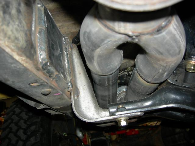

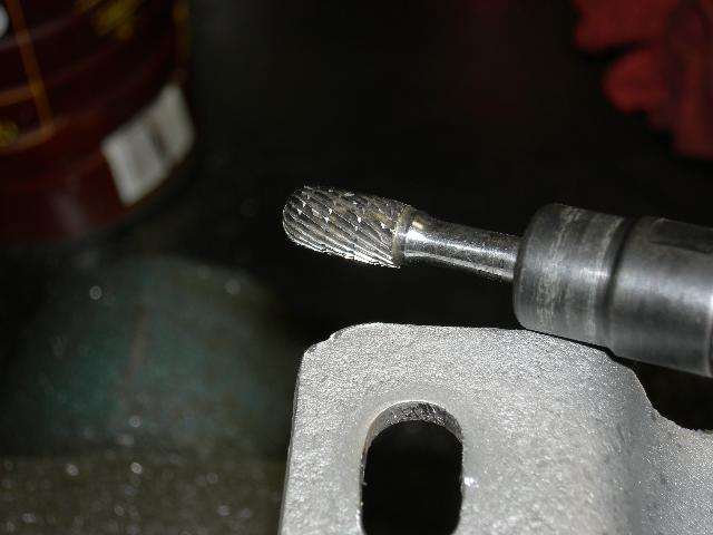

The 60 series frame brackets only required the driver side holes to be modified. So I elongated them with a carbide on a .250” die grinder, and then welded the other side of the hole closed, and ground it flush again. The passenger side fit like it was meant to be there, and really, this whole thing went very smooth considering what I had been told, and even if I would have had to modify/narrow up a 60 series cross member piece, it would not have been that big of a deal, and could be done without a lot of screwing around.
I had to plate the frame where the 60 series frame cross member pieces were going to be welded to the frame, so that I could get sufficient welding surface area to ensure that they remain attached for many years. The center piece (black in color) is a 40 series specific part that a friend in AZ sent up to me. (Thank you Rick! :beer: ) I used .250” thick material to plate the frame.
