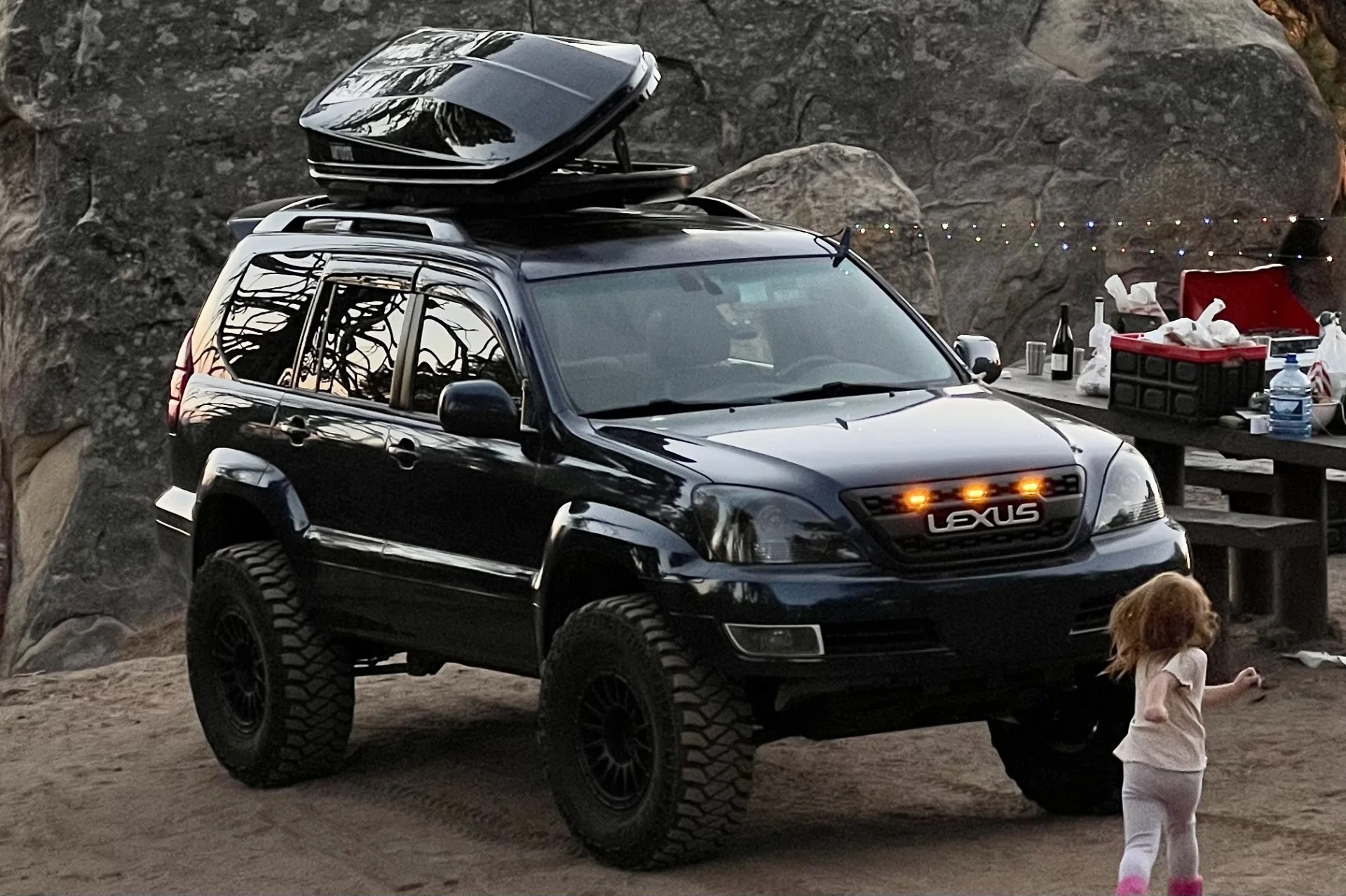

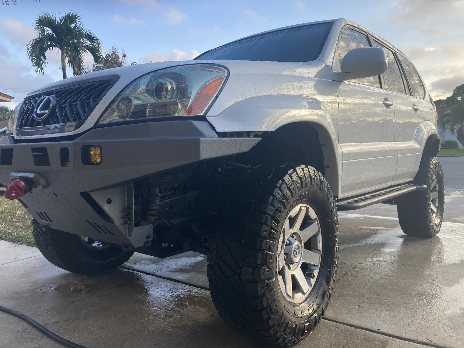

2007 GX 37x12.5R17 Kenda Klever MT2
w/ Bilstein 5100's w/ OME 885's, a 1/2" top out spacers, and 3" dual-rate springs for the rear + 2" BL from 4Crawler.
4Runner Trail wheels 17x7.5 w/ 1.5" wheel spacer.
What color did you use for the bumpers? Powder coat or rattle can? Looks great!!
That’s Raptor Liner in metallic charcoal. Product from a company called custom coat meant to mix with raptor urethane.

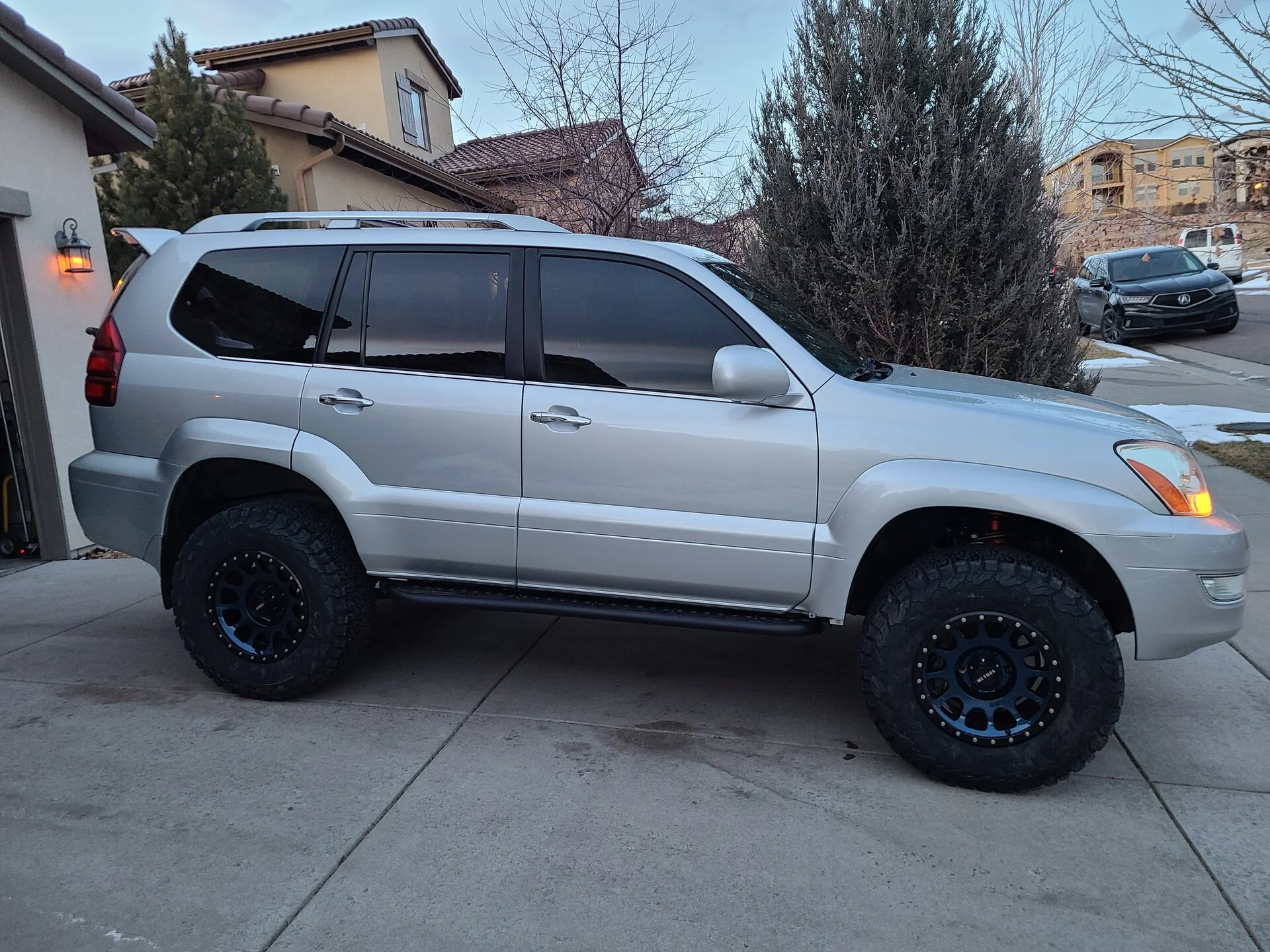

Wheels: 17” method 314 17”x8.5” 0 offset
Spacers: spidertraxx 1.25” all around
Lift: Ironman foam cell pro stage 2
Tires: Mickey Thompson Baja mtz p3, 315/70r17
Other mods: Body mount chop, pinch weld trim, spc adjustable upper control arms, adjustable front and rear sway bar links, front bumper trim
I know it’s not perfect but I’m happy the way it turned out! And the plus side is… i don’t rub. Like ever actually ! Enjoy!

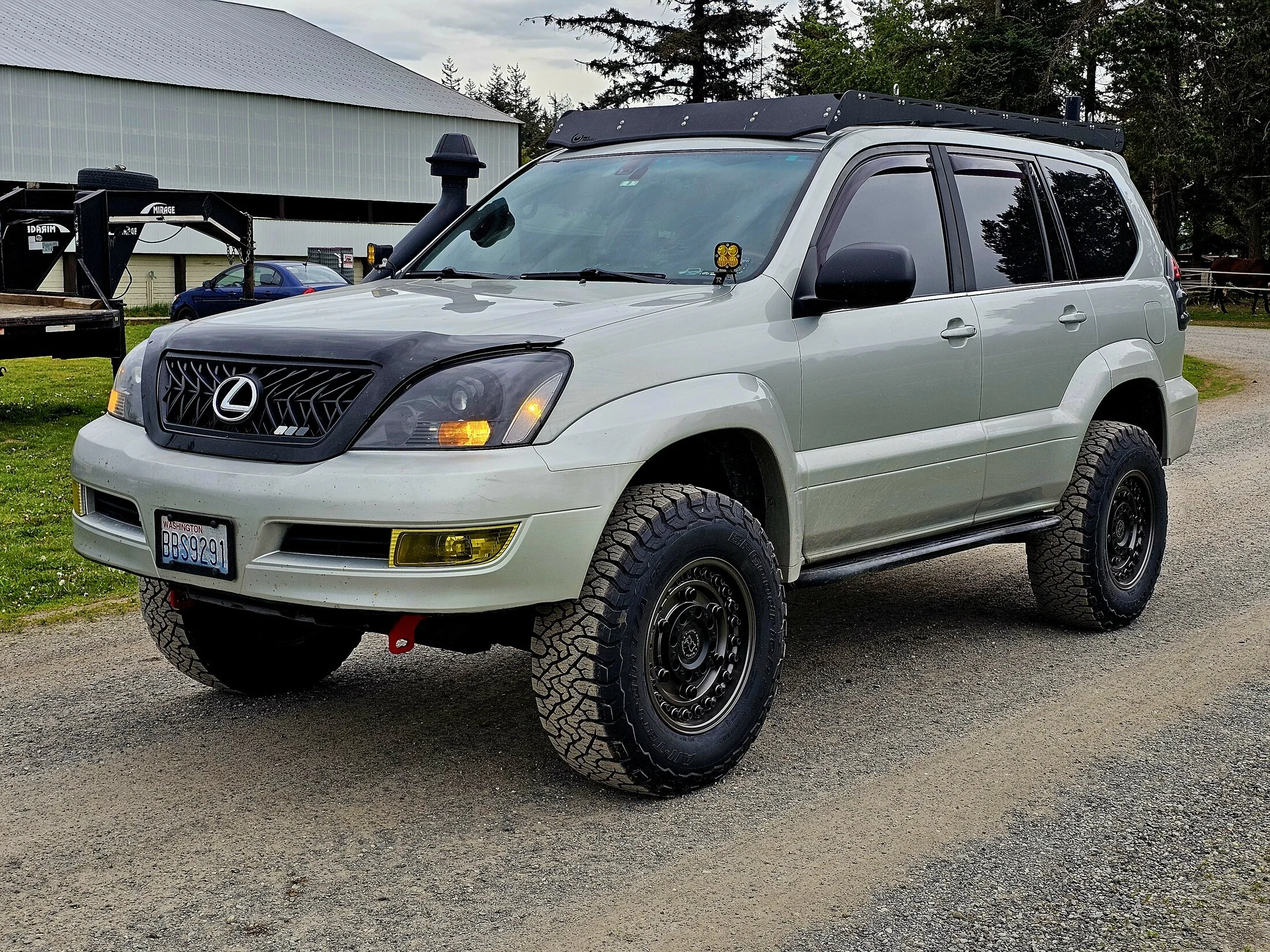

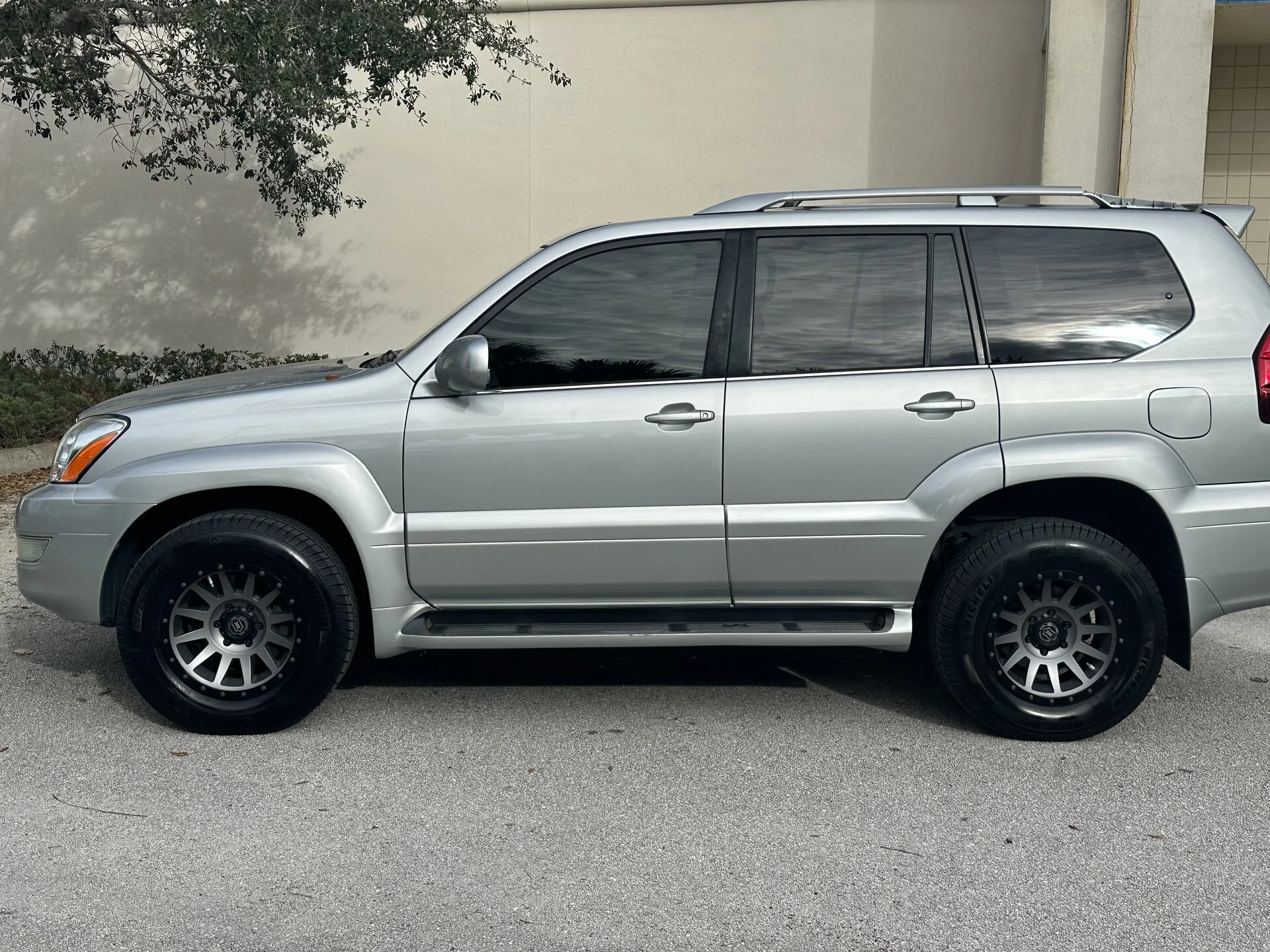

I finally lifted mine so the soccer mom vibe is completely gone (I hope)
LIFT
Dobinsons MRA with 352 springs up front and 327 springs in the rear
SSO coil conversion...two shims on left, one on right
Ironman Pro forged UCAs
Superpro double offset LCAs
WHEELS/TIRES
RockTrix RT107 in 18x9 -12 offset
Kenda Klever RT in 275/70/18
Great part of this combo/setup is zero rubbing with no BMC or pinch weld work. Rides like a stiffened Lexus...well worth the effort to get rid of the marshmallow feeling of the OEM setup.View attachment 3469910

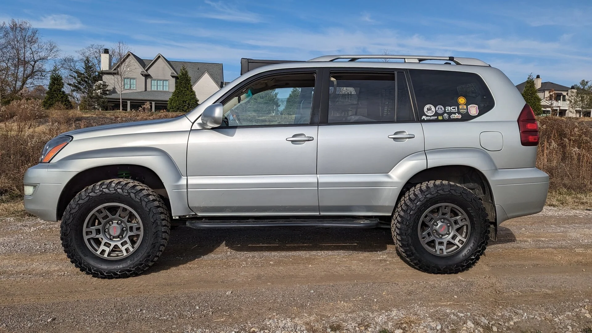

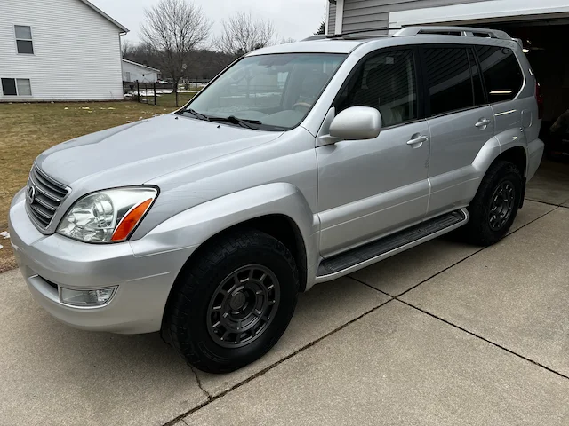

Stock 2006 suspension. Everything functioning well, but probably has some droop.
Wheels: Fifteen52 Matrix HD 17x8.5 0 offset
Tires: Cooper AT3 275/70r17 (about half worn 8/32 tread left. Bought used).
Only a slight amount of rubbing on the reverse. The front liner at the bottom. Drives great!

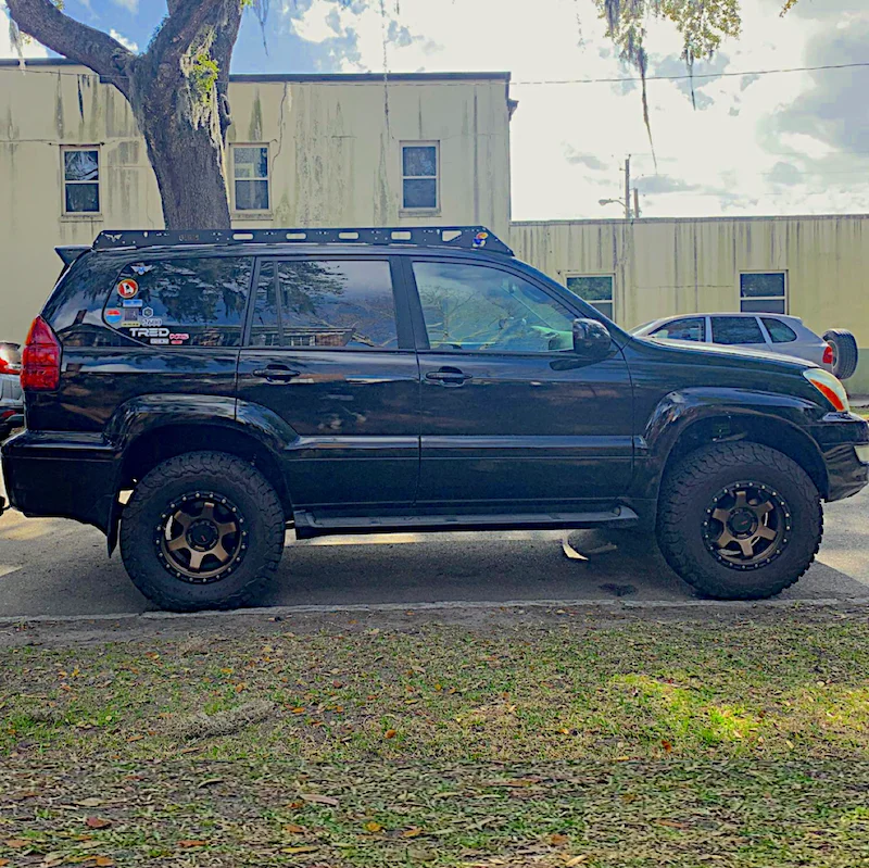

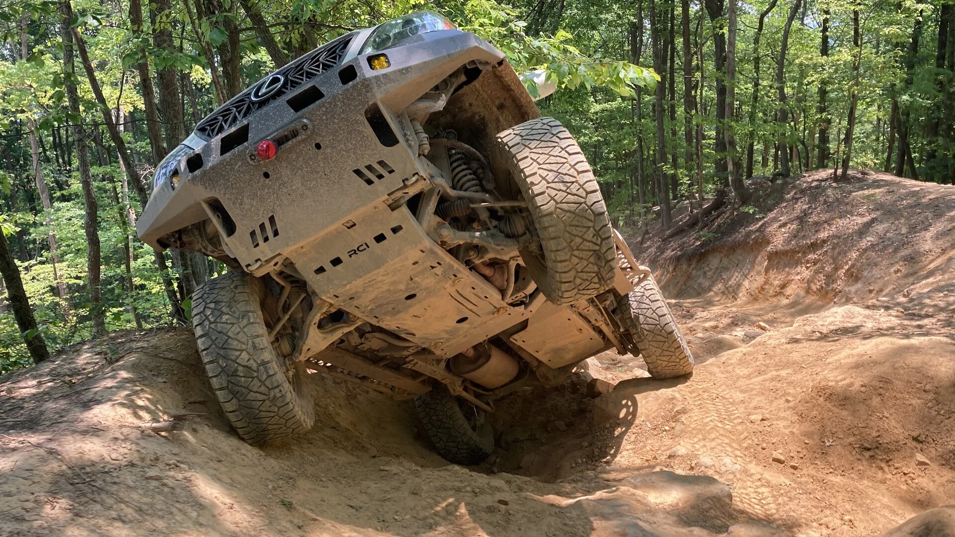

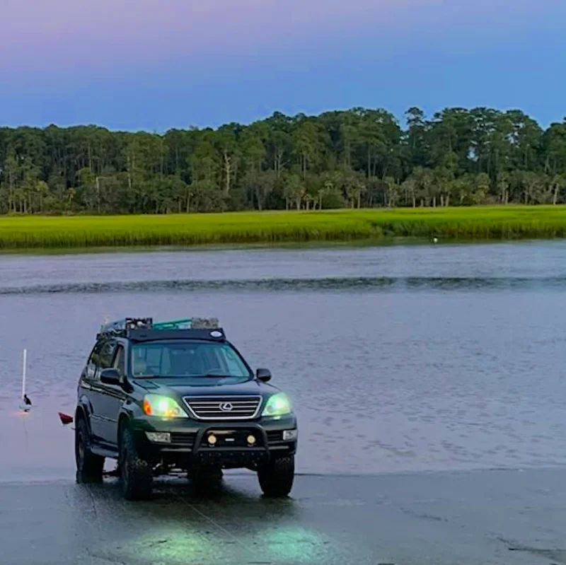

2006 GX470
Wheels: DX4 Nitros in bronze
Ironman 4x4 Nitro Gas 2.5" front and rear
Ironman 4x4 UCAs (have voucher to do recall but haven't gotten around to it)
BFG KO2's 33's (285/70/17) - they're OK but they're terrible at self cleaning. Think I'll go with Toyo's next. Still getting a weird rubbing/crunch when turning left into an incline, I've trimmed and hammered back all I can).
Victory 4x4 roof rack
Amazon special bull bar/pod lights (I think they're messing with my Bluetooth/CarPlay as sometimes they will max volume a terrifying feedback)
Custom fab foldable sleeping platform
Bison Gear rear window panels
NashFabCo rear ladder

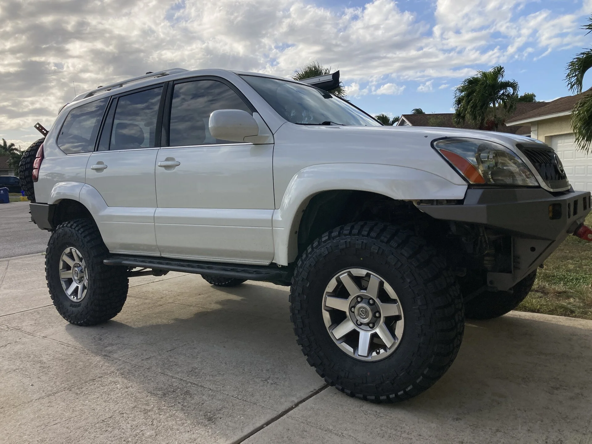

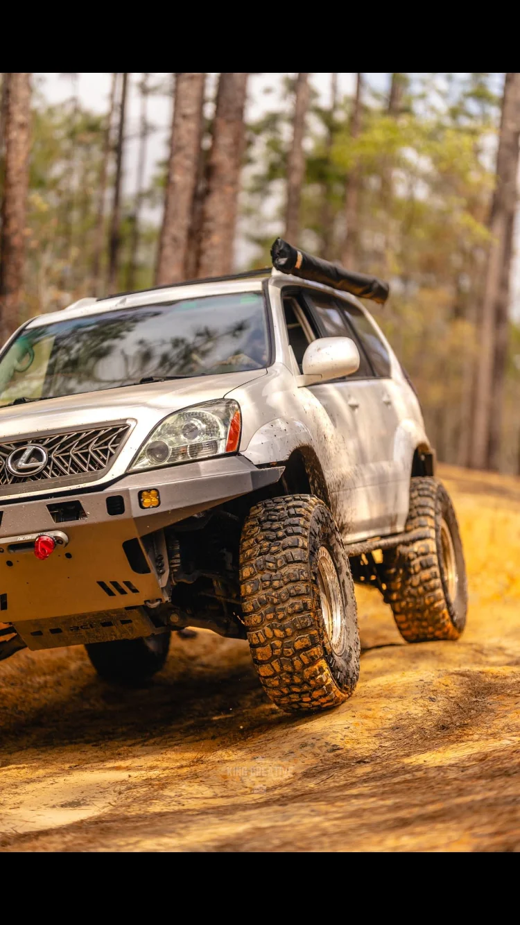

2007 GX 315/70R17 Nitto RG’s

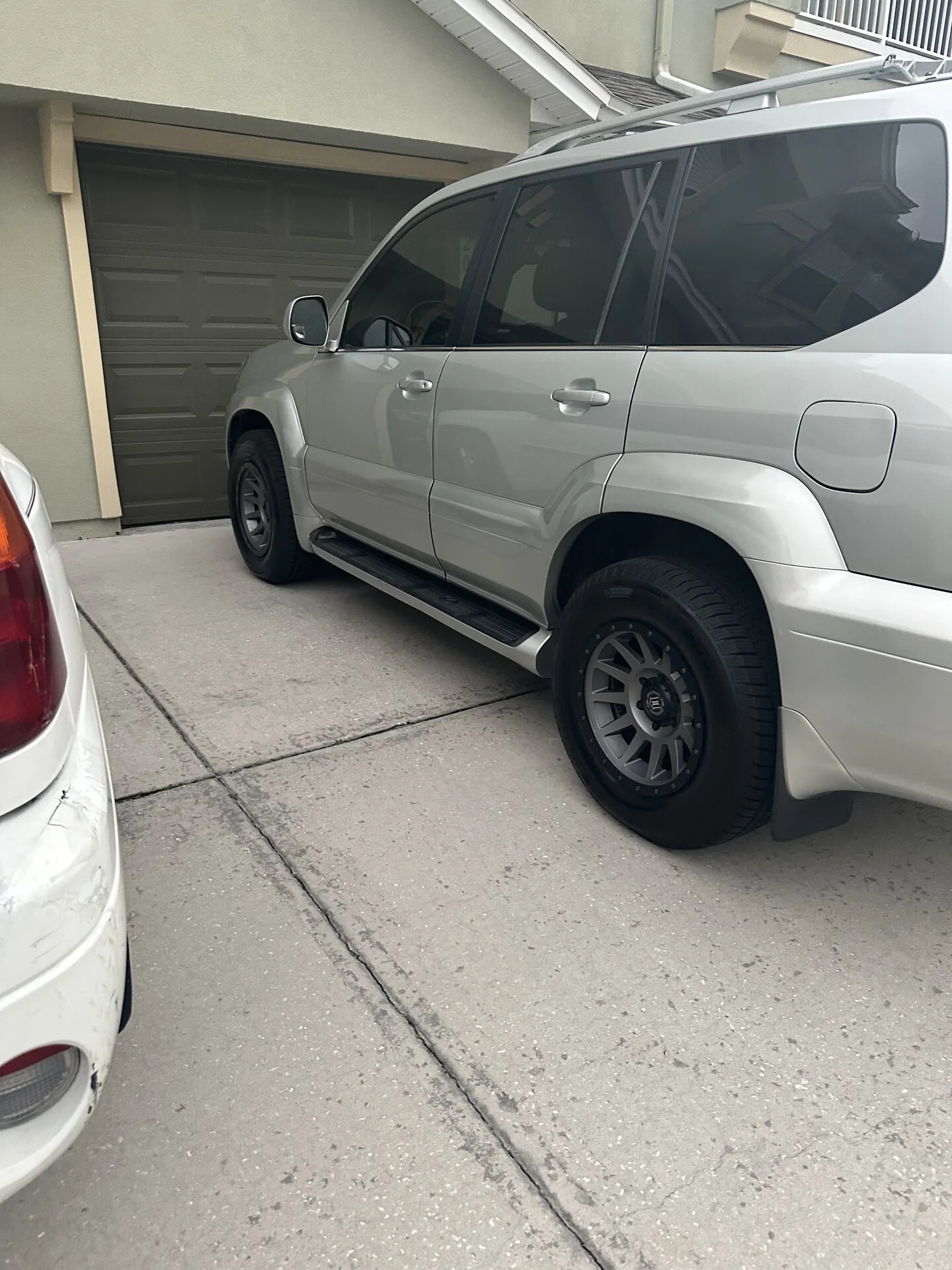

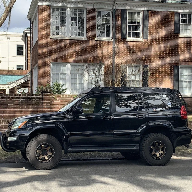

A little update;
Raceline Avenger Machines 17" wheels 17x9 -12 4.5 BS w/ Spidertrax 1.25" wheel spacer.
Ditched the TRD wheels, KO2's and 1.25" spacers and replaced with;
New BFG KO3's 285/70/17
Black Rhino Armory 17x9.5 -18 offset
Existing previously;
SPC upper control arms
Alldogs Offroad springs (Mediums front/rear)
Bilstein 5100's all around with fronts on 2nd notch
Body mount chop
Flattened pinch weld
Fender liner trim/reshape
Bumpers cut
