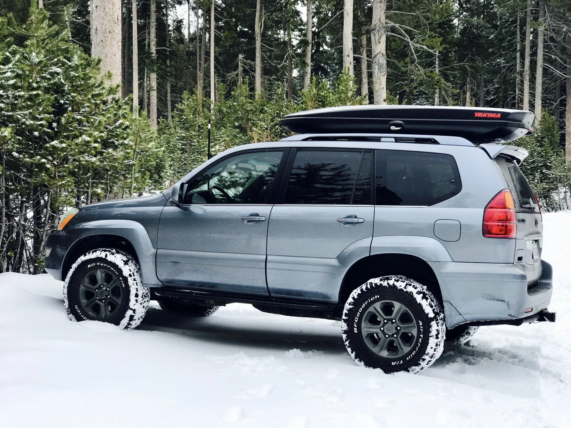

What color and type of paint did you use? Looks amazing!
Thank you sir! I used Duplicolor Storm Grey Metallic & Clear on the wheels. I got the color idea from @GXLee I believe.
Stock wheels
1.25” spidertrax spacers
275/70/17 cooper st maxx
2” Elka front and rear lift/airbag delete
Stock wheels

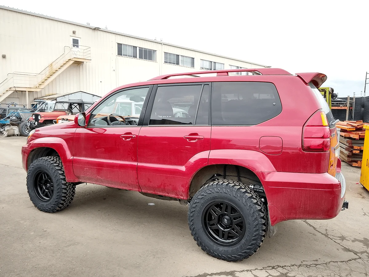

New version of the Tandem Offroad 612s. 35" ridge grapplers.
Do you happen to remember the part #s? Looking at doing a similar Dobinson set up, 2.5" up front with ~3" long travel in the rear. Did you do a diff drop, and how does the Dobinson set up ride compared to stock? Thanks!
I have the 3in dobinsons and JBA uca with 3 in in the rear. Imedietly my boots started leaking and I replaced both axles with OEM. I put the diff drop in for peace of mind. Rides much better than stock. I have 285 falkens. Got the wheelers bump stop I will install soon and post pictures. The reason why I did the diff drop is because without it my axels would bind at full droop. Also I had to cut a front sway bar bolt and I haven't put the front or rear back on yet but hasn't been sketchy at all but I am a defensive grandma driver around town.
