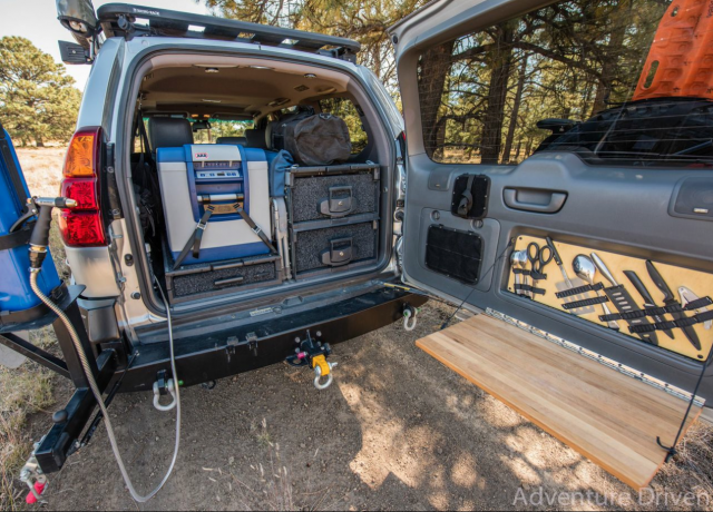

I have seen some awesome rear cutting board/cutlery set ups on the various builds but was wondering who else out there has done the same? Would love to compile a little thread with images and lessons learned as I am about to do the same for the back of mine. Post up some pics of your GX rear kitchen set up!

I like the concept of the FrontRunner model but I'd prefer the vertical space to be open so you could put cutlery there, similar to Adventure Driven's setup.
I agree. The front runner set up is very cool, however, the way the cutlery was stored on the ADVDRVN set up was really slick.
Anyone else out there using a similar or unique set up on the back gate?
Since it's not visibly obvious, does anyone know how the board was kept in place when in transit?

Looks like there's some empty interior space when folded (wood drawer sits under that bottom metal piece) - might be able to attach/stow cutlery inside and away from prying eyes. The FrontRunner table is currently out of stock :(....
I was looking at that as well. Couldn't figure it out from photos. I am thinking out either using a piece of HDPE for the cutting board as I just feel it's safer/cleaner than bamboo or wood (especially with meat). My thought was to take and flush mount some small magnets and then another set on the door so that it would stay up when needed and then could be popped down when needed as well.
