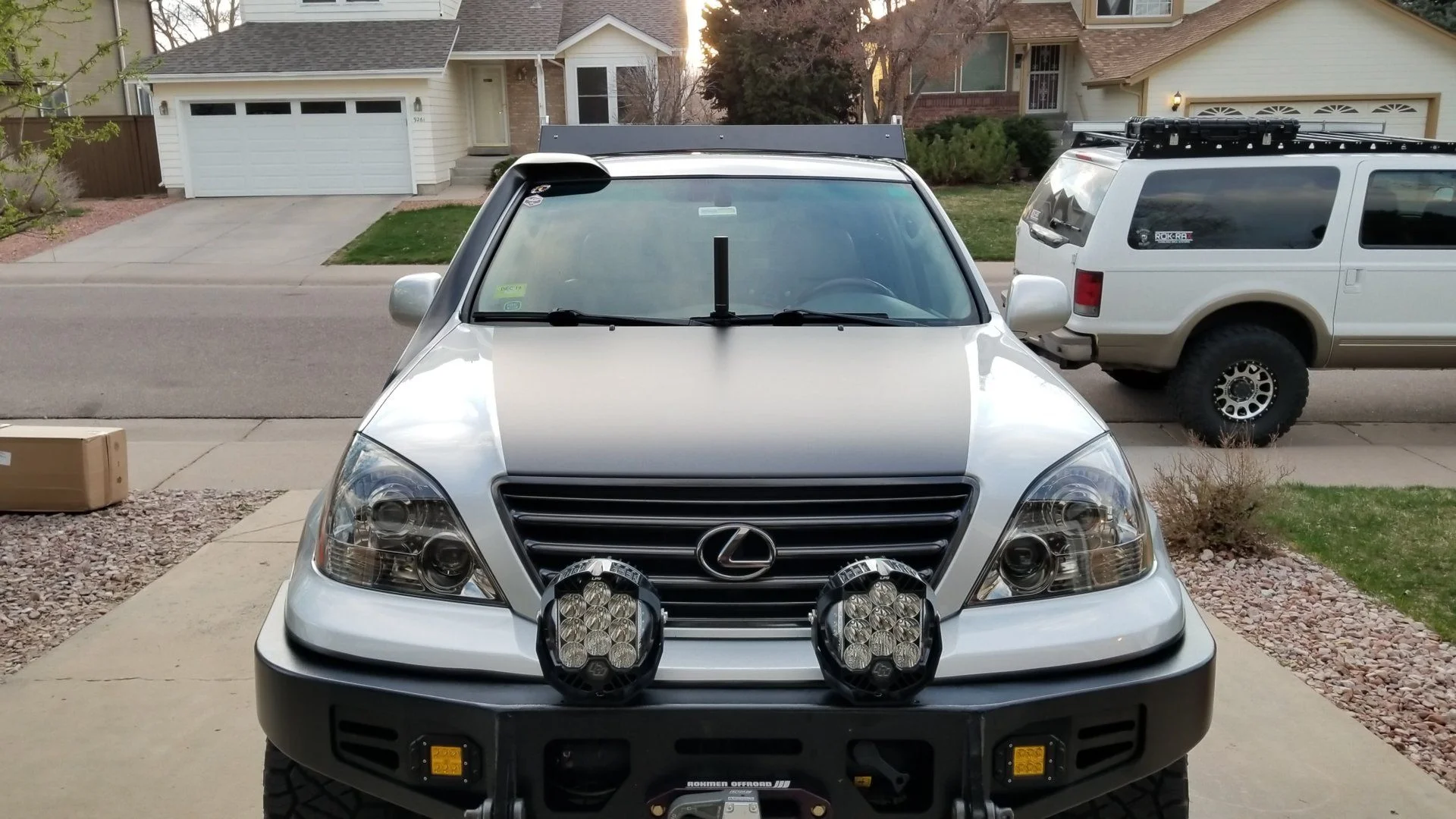

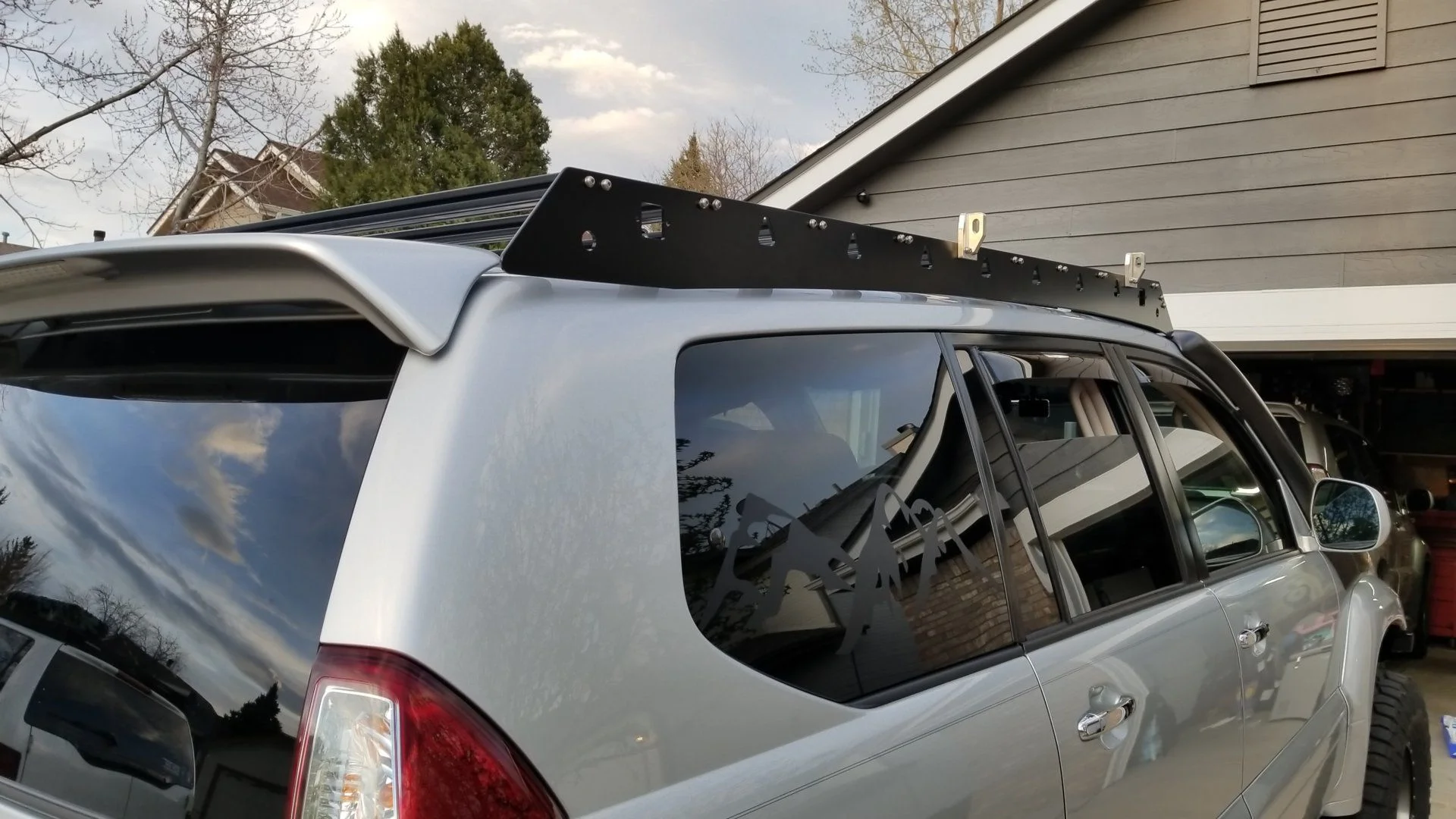

:cool:New ROK-RAX roof rack from Rokmen Offroad. Prototype 1 installed. I am pretty stoked!

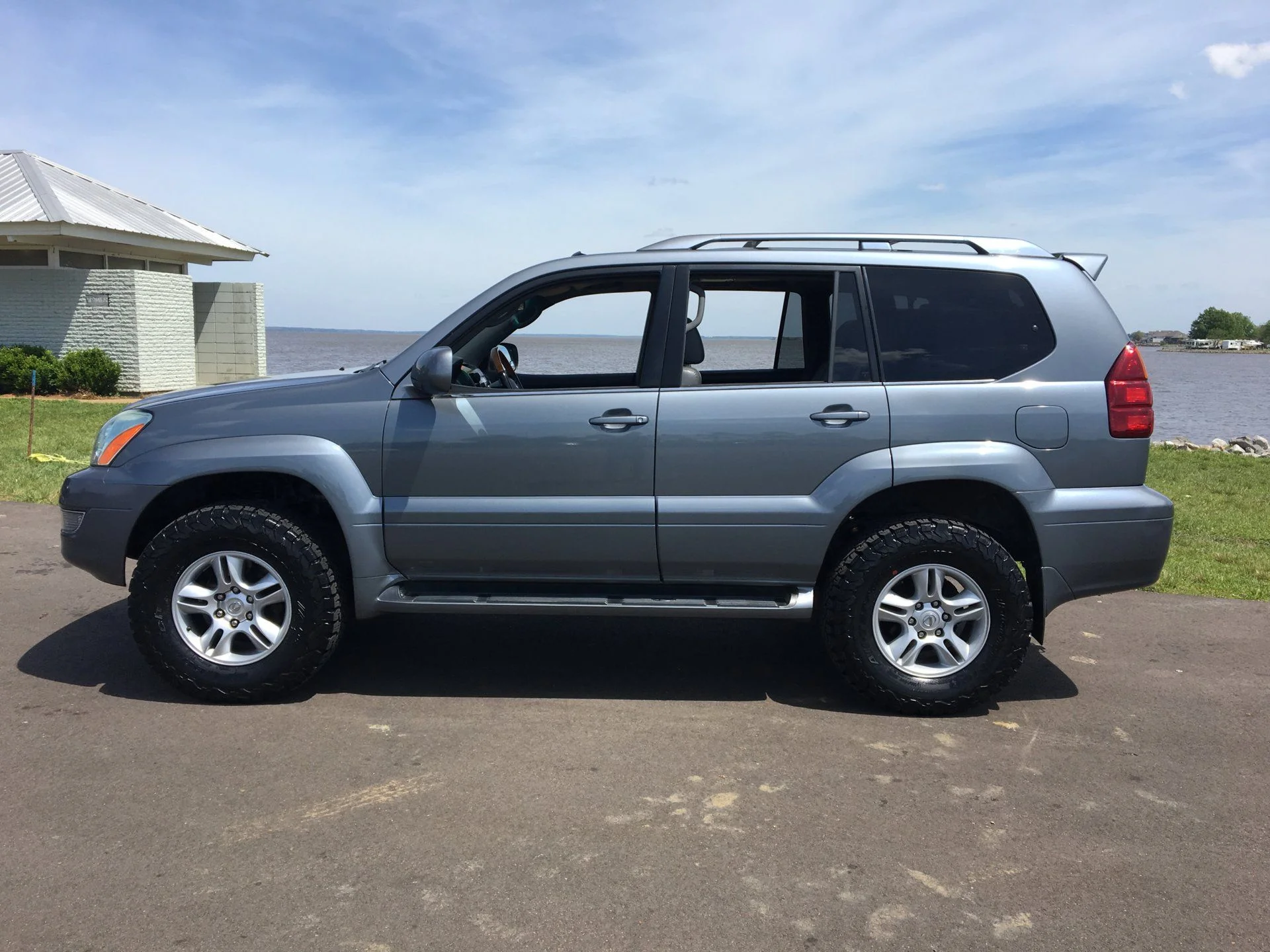

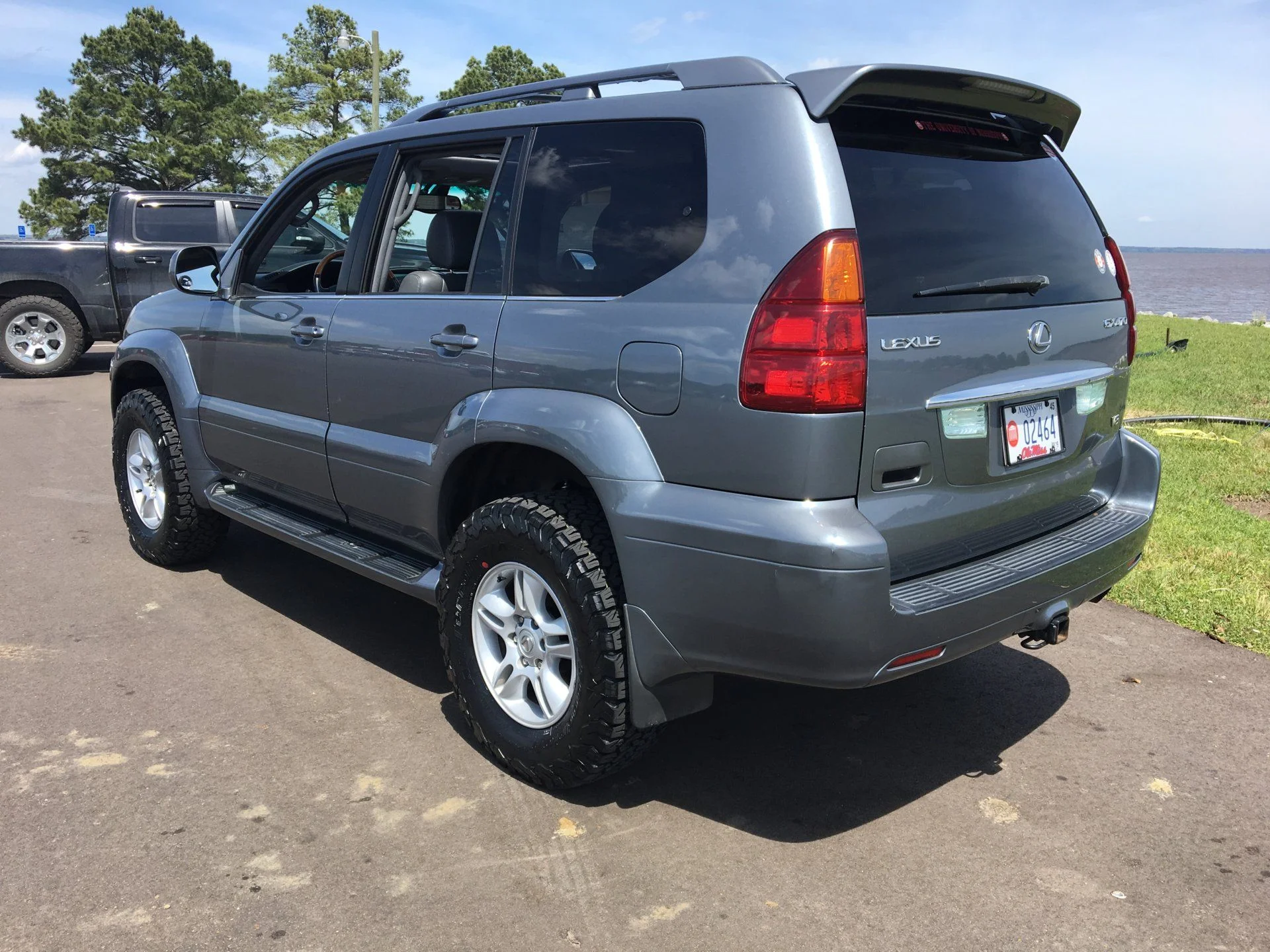

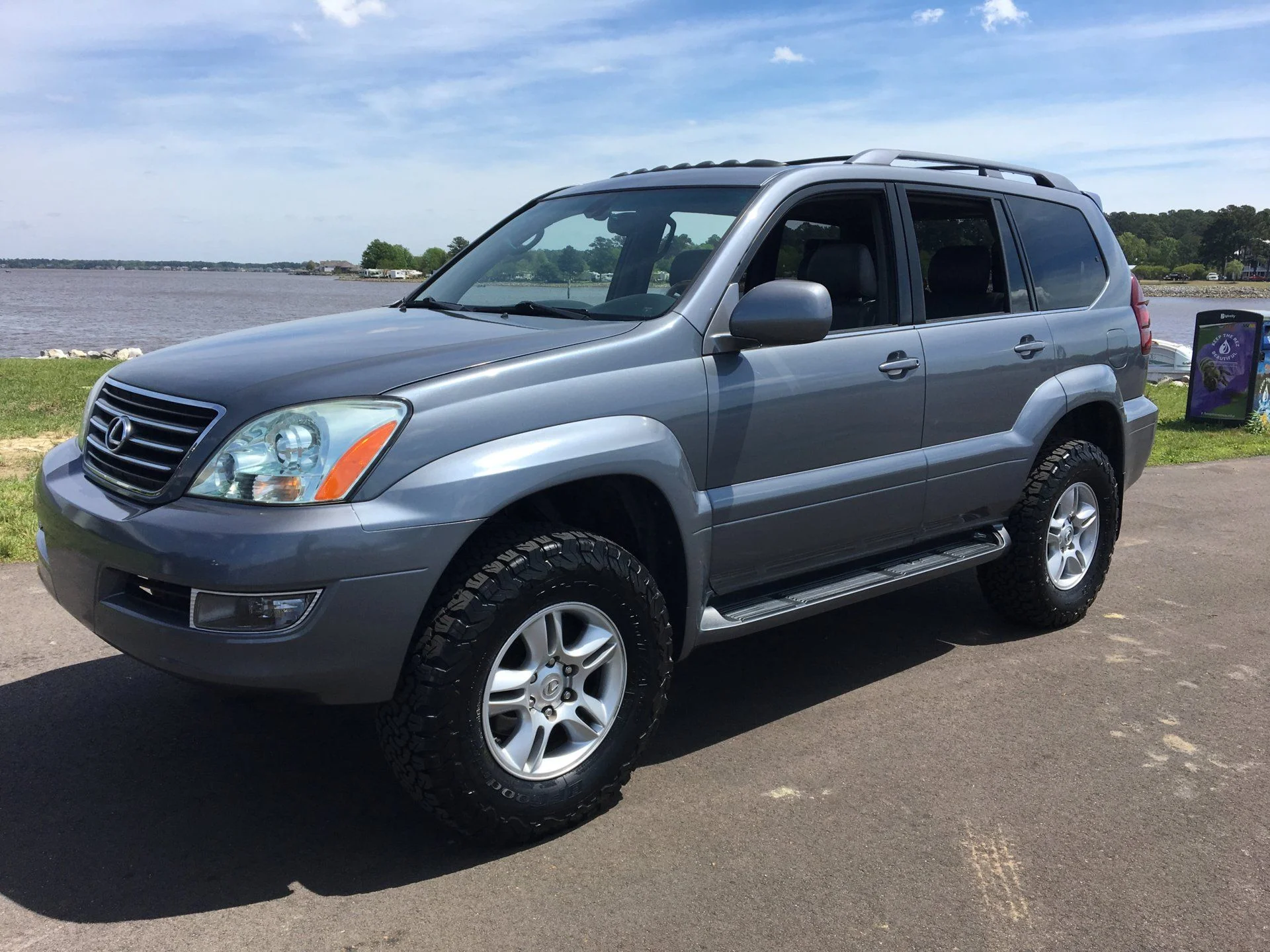

So after a month waiting on the OME lift it is finallly done. 1.25 spacers on stock rims and BFG KO'2 285/70/17.
Have Wilco HitchGate High clearance Solo spear tire carrier on the way for the fifth 285/70/17 that won't fit under any more.
Looks good, love your paint color. Any rubbing with spacers. I want spacers after I downsize from 285/70 to skinny 255/75 but the spacer debate is real.

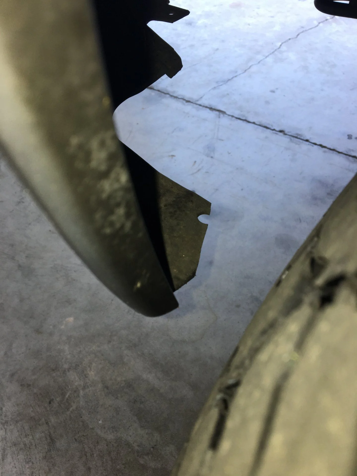

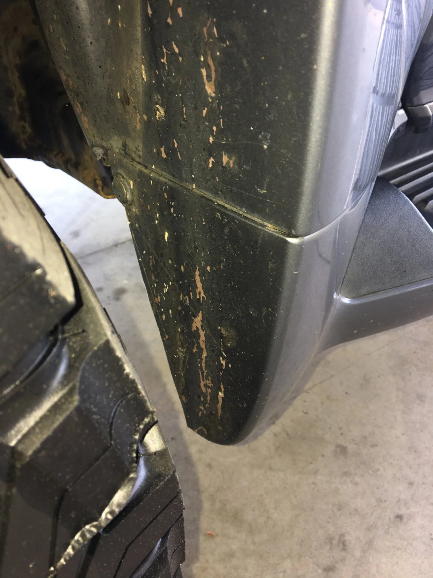

Nothing in the rear of course, Since I still have running boards a slight trim on front inside of running board and trim the front bumper tab and fender liner at the bottom. No big deal!

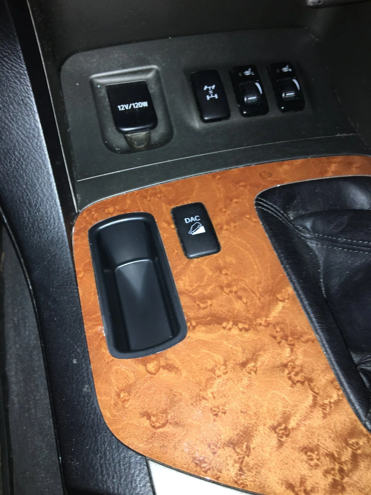

With lift installed and the airbags gone, i removed the ride control in the center console and replaced with land cruiser pocket.

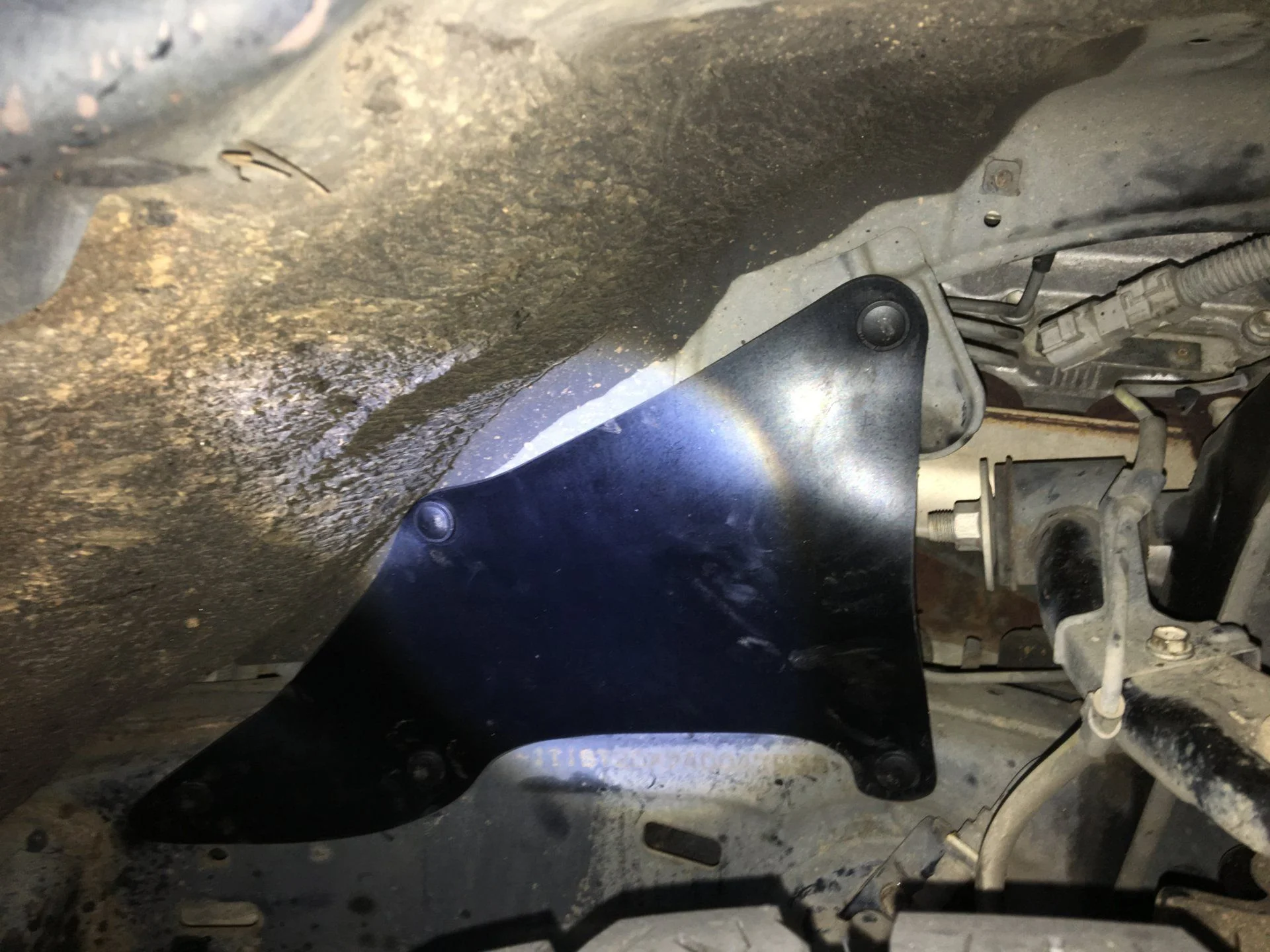

Also installed my Rad Rubber engine splash guards!

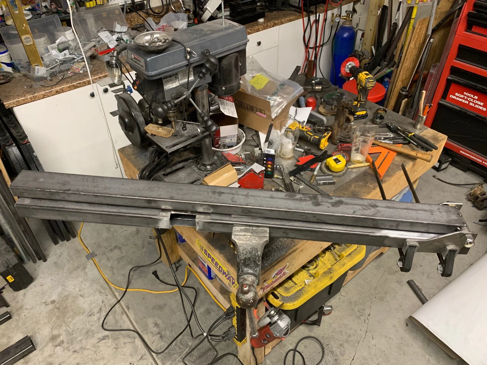

Began building my hitch mounted spare tire carrier:
1951112
The notch is where the 4x2 tube will straddle the 2" hitch insert. It will be gusseted at final assembly. final width is still TBD.

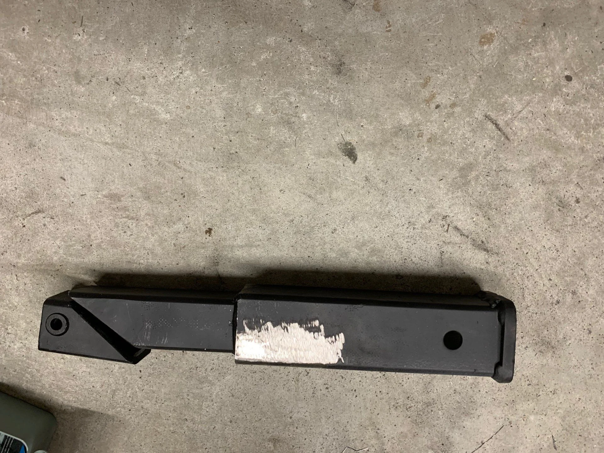

Using a 2" hitch extension from HF, i cut it up and made an anti-wiggle device. An 8mm bolt runs longitudinally through the center to tighten the wedges taking up any slack in the hitch (at least that is the theory).

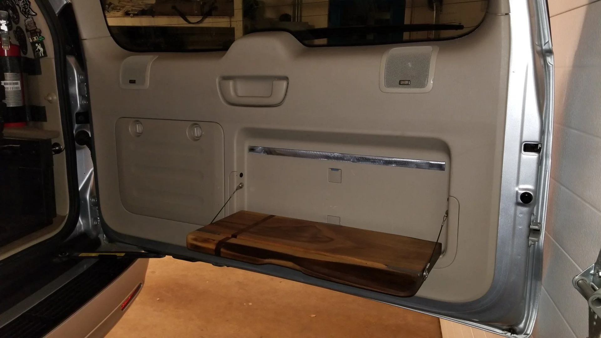

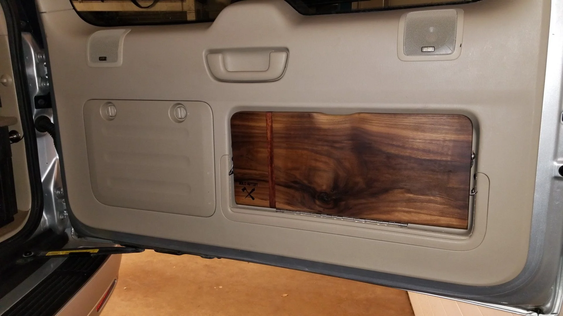

Worked with a good friend of mine that is very artistic and creative. Working to create a kit that anyone could install. Its held up with 2 strong magnets and will require 4 1/4" holes to be drilled through the plastic door cover. Not the biggest table but will work for lunches, beers, or as a cutting board. It is a finished butcher block afterall. :)
More to come. ;)
