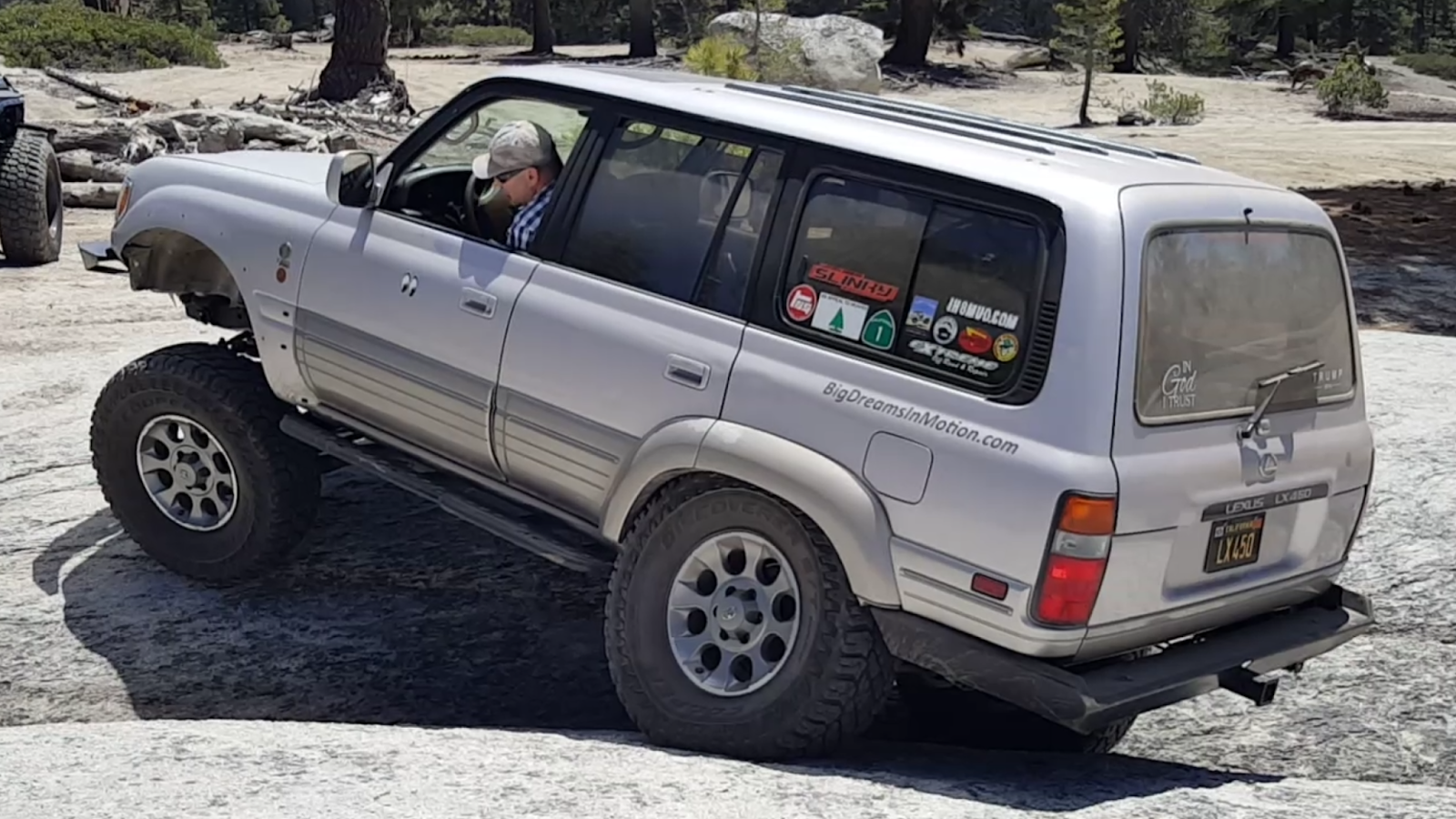

New Slinky rear Intermediate coils AC7501
Last May 2017 I went ahead & purchased the Intermediate Slinky rear coils. When I originally purchased the rear slinky coils they just had 160/320# heavy coils in stock, I didn't want to wait another 2 months for the lighter duty coils. The heavy coils were just that... I run a light rig so the normal 160/270# Intermediate coils suite my needs much better. If I had a dual swing out & spare tire out back the heavy coils would of been just fine. As far as specs... turns & free height are basically the same but the wire diameter looks to be a couple mm thinner.
The ride is much more supple & the handling is really good. I only run approximately 250 lbs overstock in the rear so I can feel that I'm still in the 160# rate then when my family climbs in I can feel it hit the 270# rate. The on pavement ride is like a stock feel same as the heavy coils. The real difference is on the trail... they compress more & soak up some of the heavier hits. Also when I wheel solo... at the end of the day my back likes me better.​
The ride is much more supple but the handling is really good. I only run approximately 250 lbs overstock in the rear so I can feel that I'm still in the 160# rate then when my family climbs in I can feel it hit the 270# rate. The on pavement ride is like a stock feel same as the heavy coils. The real difference is on the trail... they compress more & soak up some of the heavier hits. Also when I wheel solo... at the end of the day my back likes me better.​

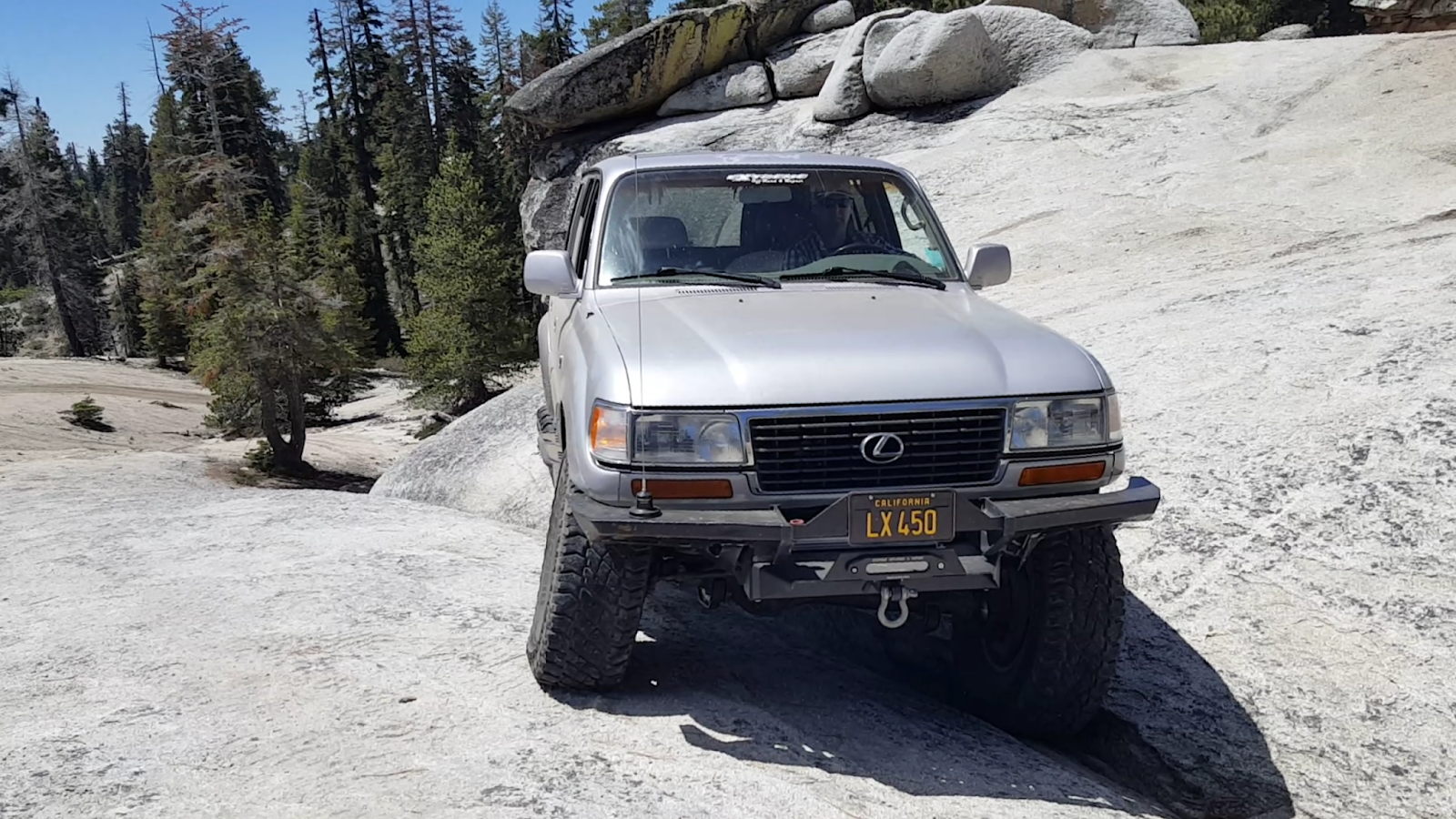

Just bolted up the #BattleBornWheels in time to make it to work. These are the #GateKeeper wheel 17x9 3.5"BS
On the short drive to work got it up to freeway speeds... smooth a silk without any balancing what so ever. I can't be more happy right now with the new set up. They weight 43lbs & widen my track width by 2 inches.
I decided to get rid of the wheels spacers & go a wee bit wider in stance.
So for my birthday I bought me some wheels. 17x9 3.5" BS Battleborn Gatekeepers
They were a Black Friday deal for $199 per + no shipping fee.

Looks treat Gary. 3.5” backspace and how wide?
The wheels are 17x9 3.5" BS
That puts the track width out 1" from center (were it was) same as a 8" wheel 4" BS .5" wider than your set up.
