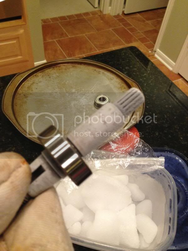

A helpful hint that I read around here for putting bearings on a shaft without a press... Freeze the shaft in dry ice in your freezer (1-2 hrs) and bake the bearings at 225 degrees in your oven for 30 min.
Slid right on. This was after I ruined a bearing trying to get it on with a socket...
Also then froze the bearing and shaft before I put it back in the pump housing... worked like a charm.

Great tip on the dry ice. To get a super cooling effect, mix dry ice and denatured alcohol, mineral spirits or acetone.

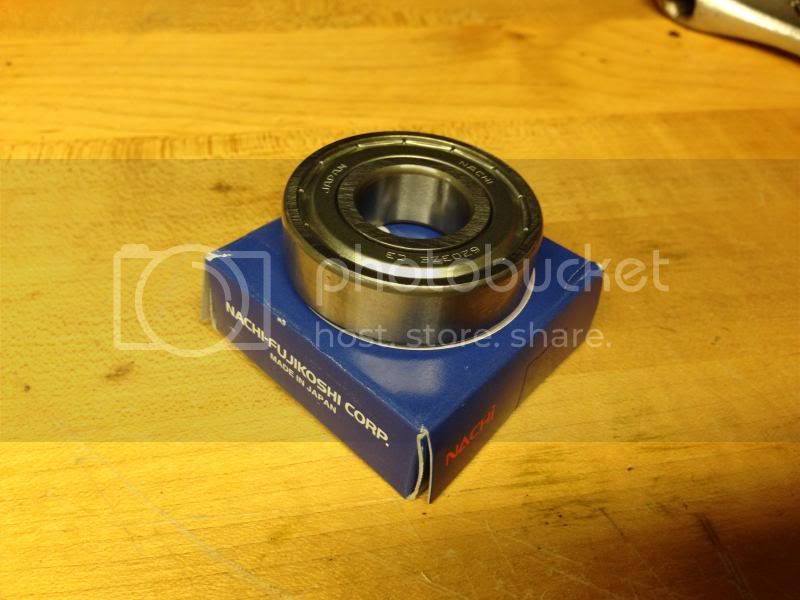

Some folks have inquired about the PS pump shaft bearing... unfortunately it is also not offered by Toyota at all, so I will be offering them.
I took a while and found the exact bearing that met or exceeded OEM Quality. Nachi Japanese bearings are top quality that is as good if not better than the Koyo or NSK bearings in the pump... those brands are all good... a NSK bearing came out of mine and had rough movement (not bad after 210K!). I couldn't find a reliable source that had the NSK or Koyo bearing in stock (at least on these shores).
These Nachis are the exact double metal shielded (ZZ) and sealed spec, including the C3 clearance designation that allows it to operate smoothly while hot and expanded inside the pump. This is critical... if you get a bearing yourself, make sure its a C3.
These are ZZ bearings... as Nachi America engineering explained to me, the stamp on the shield is actually the shield part number... these are double metal sealed... ZZ one Z per side. The E disignation is for the Excel series of bearings, which is an upgrade of their previous generation, hence the E to tell the stock apart.
