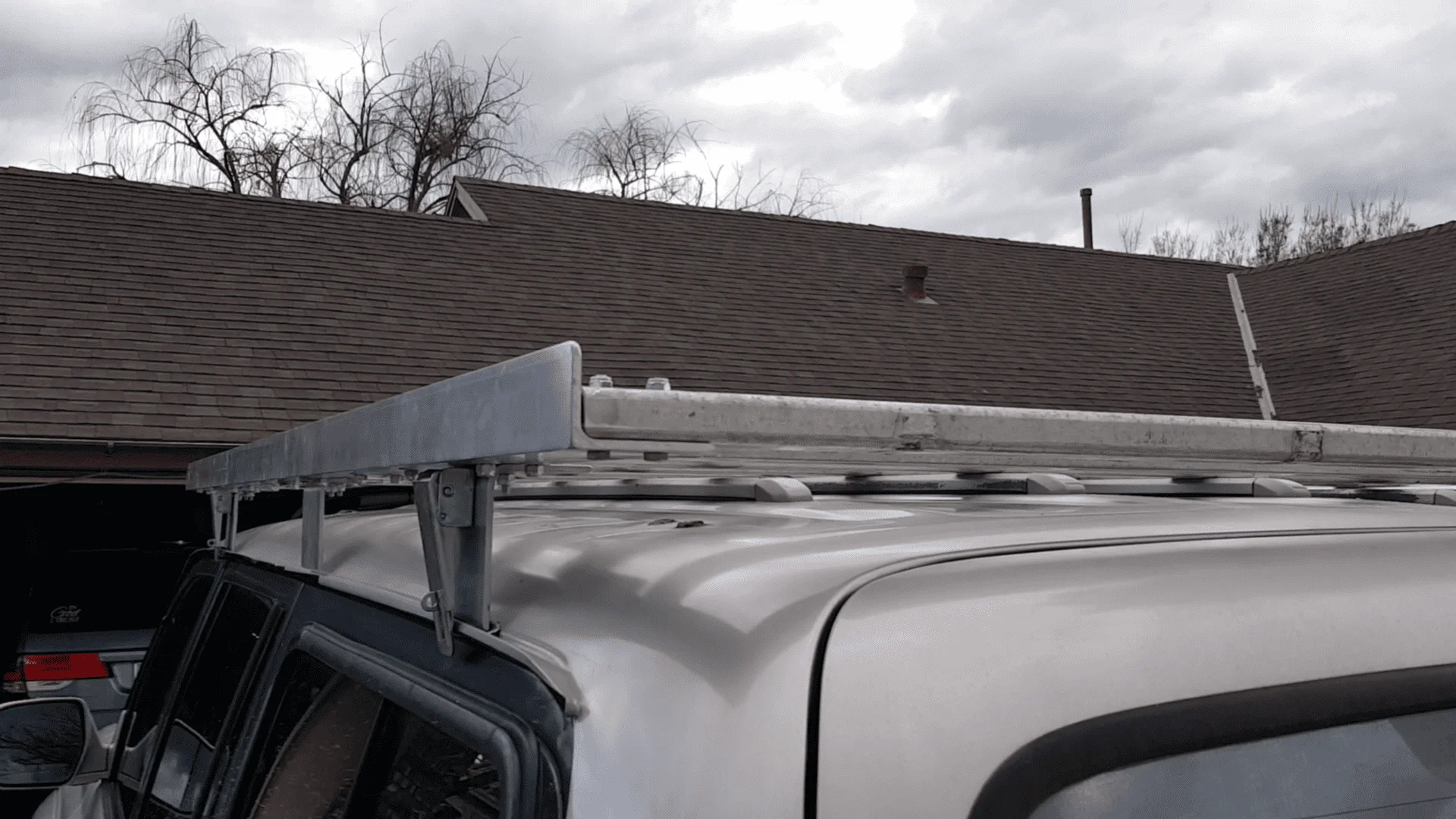

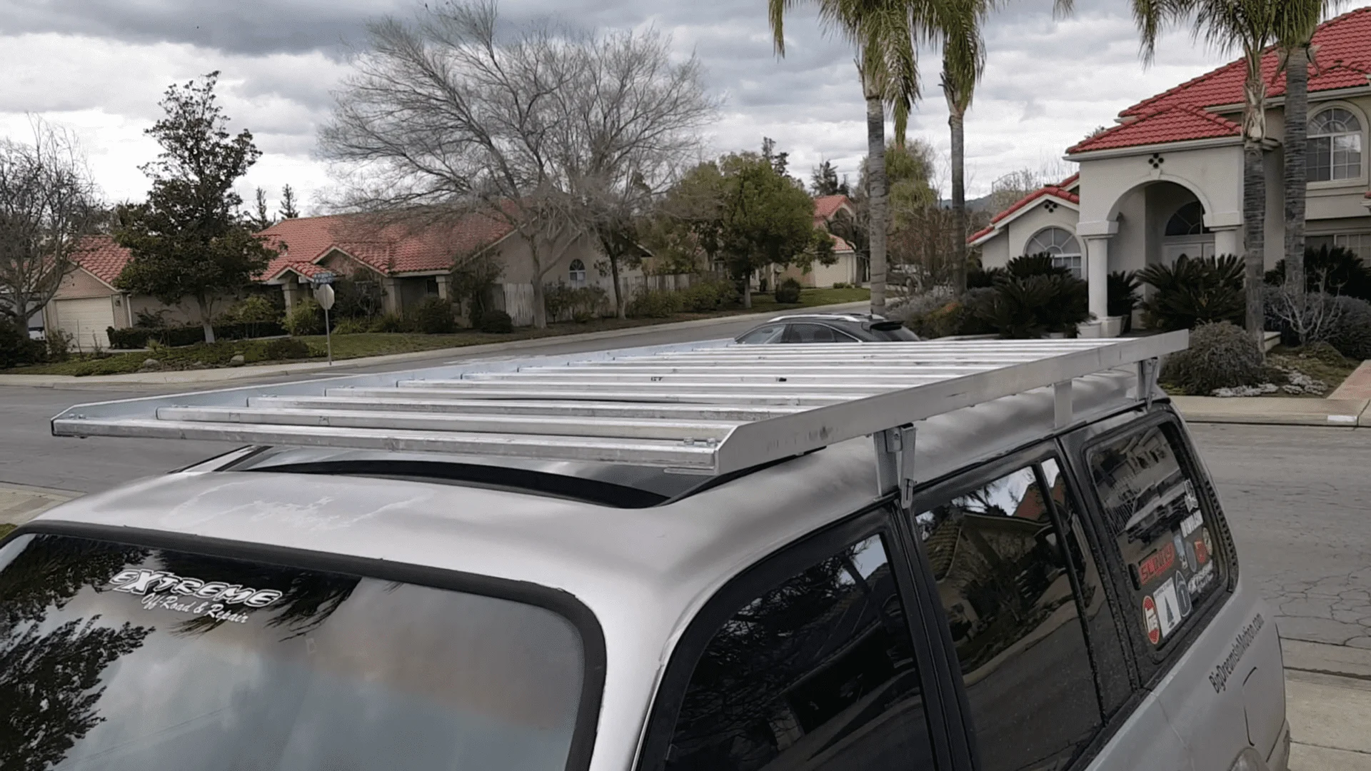

I've been working on my DIY bolt on rack... I'm in like $200 so far.
It's not completed... I need to bend up more gutter mounts.
I might skinny it up a bit, but that will take a bunch of time.
After working on my own rack, I appreciate the quality, workmanship & appearance of the Bowfin rack.

Your rack looks great. I have one in process also. (waiting on a couple parts to finish) I see you used alum angle for the side rails, what did you use for the cross rails? Alum square tubing?
Looks really good!
To get the design gears turning, when I built mine I used uni-strut for the cross bars, and B-Line Combo nut/washer spring nuts for any mounting. I have eye bolts that thread down to the nuts, and also regular bolts w/ quickfist clamps for other items. Allows for any possible tiedown configuration.
1x2 6061 T6

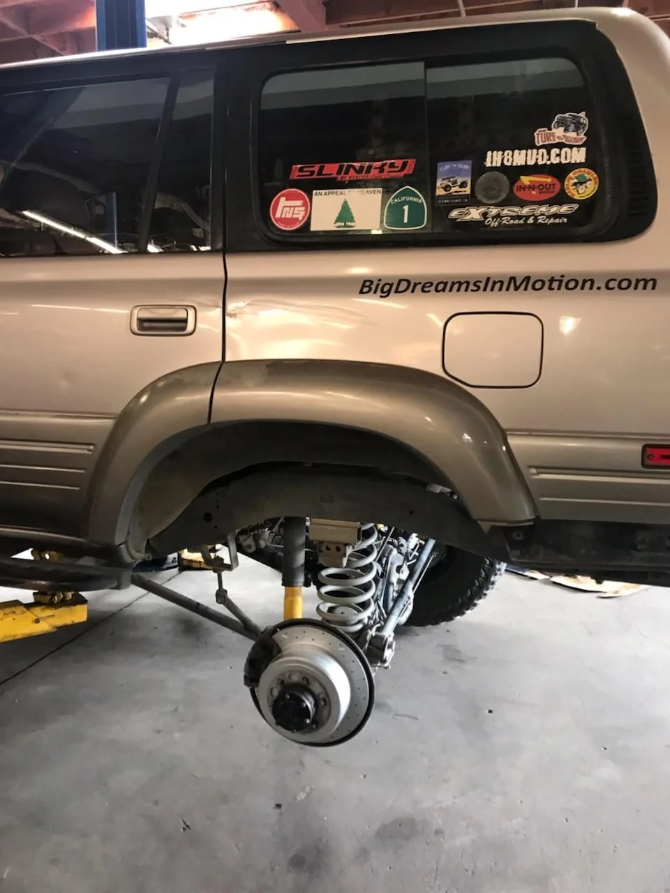

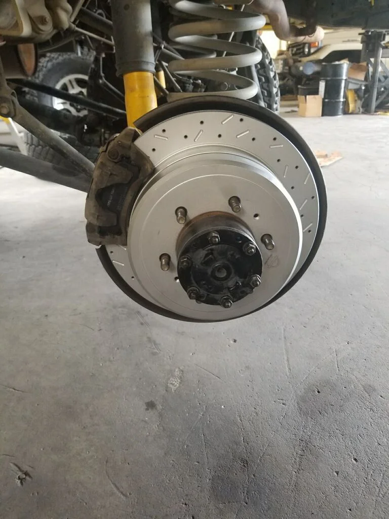

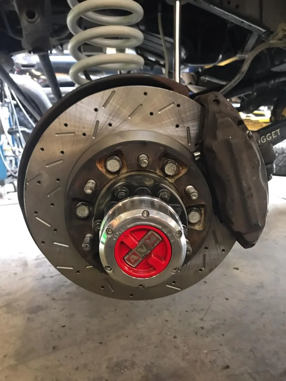

Sneak peek... Georg @orangefj45 has it but sent me these pics. Waiting on some last minute rear calipers.
Did you install a part time kit?
197,500
So Georg @orangefj45 did a complete axle rebuild including TT birfs, brakes & hand breaks with 4:88 gears. Thanks Valley Hybrids in Stockton. Ah... also a OEM master cylinder.

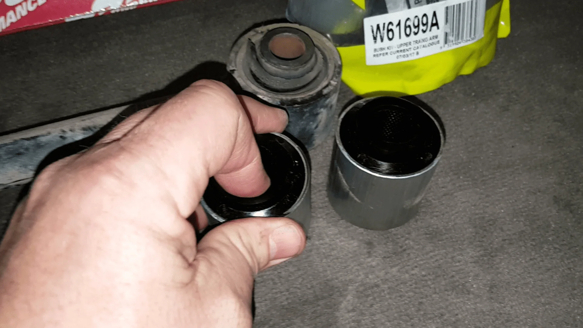

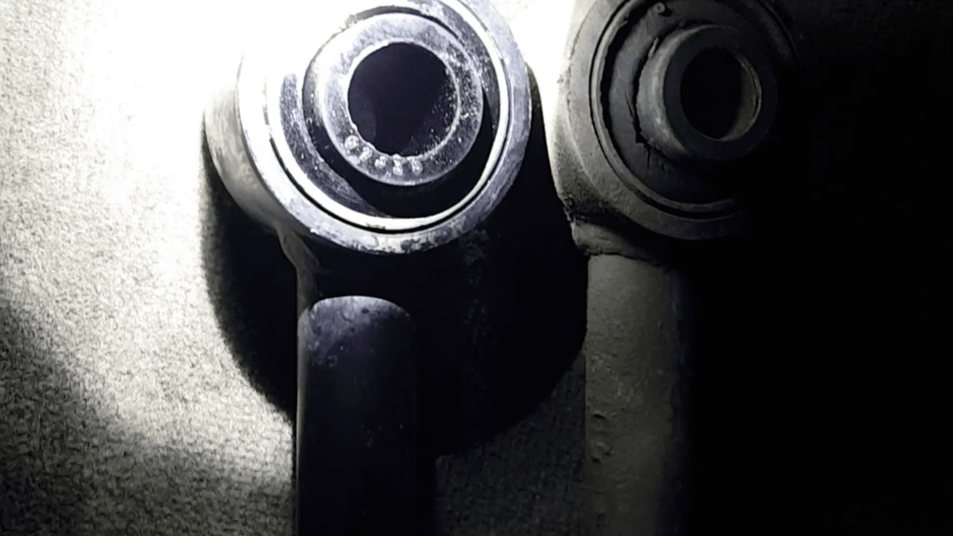

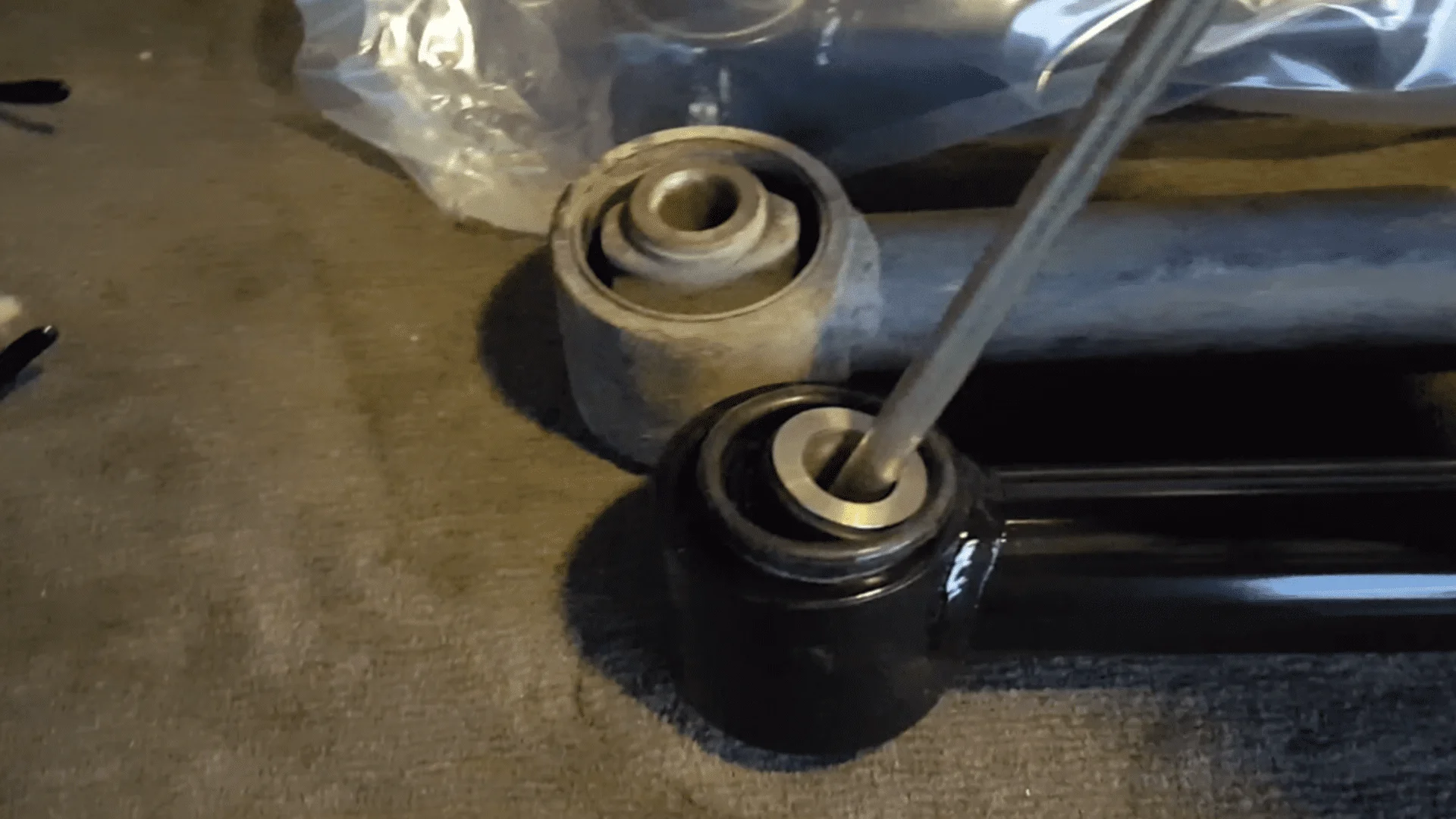

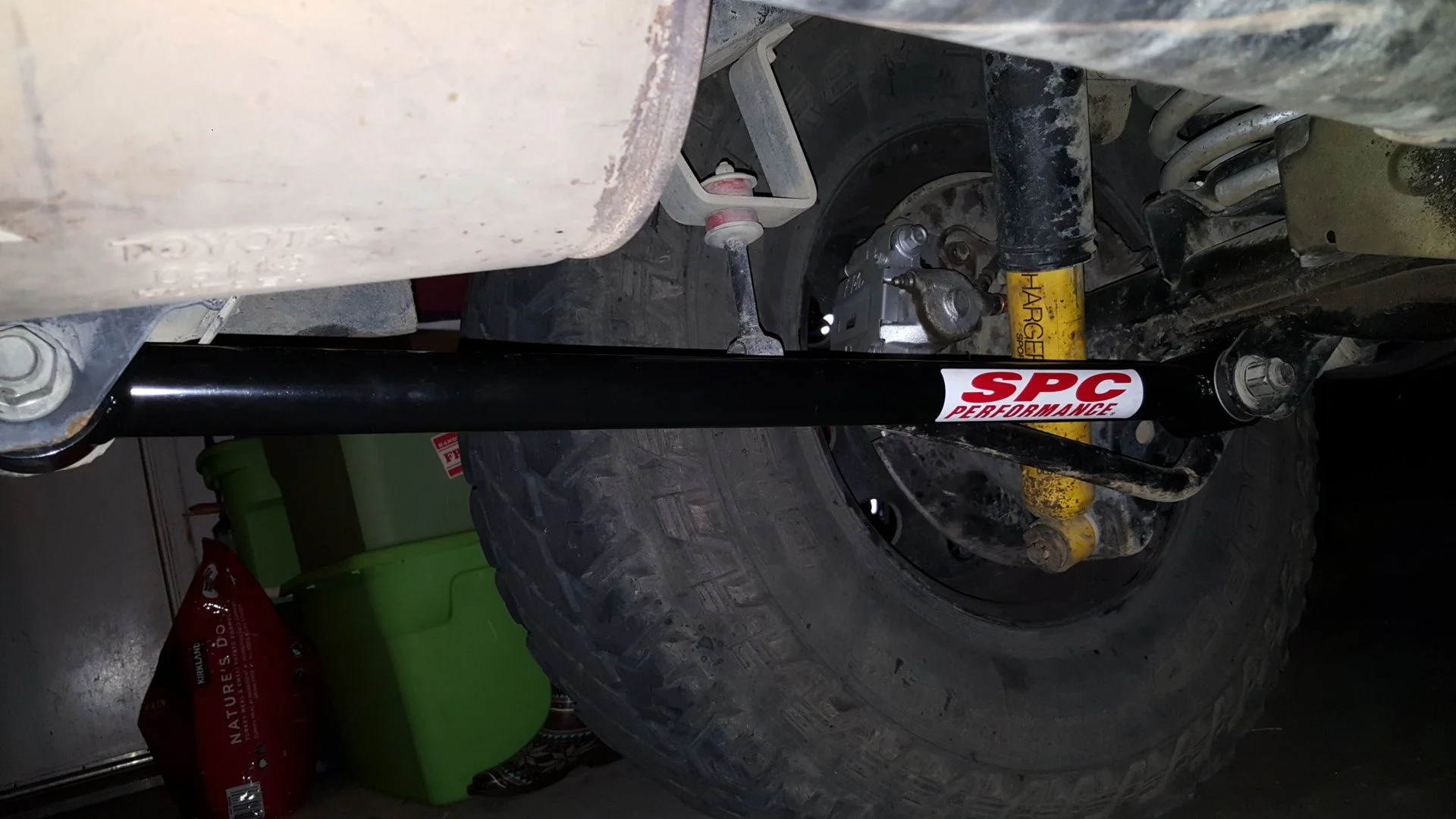

Since then I've installed SPC lower control arms from Slee, rebushed the upper control arms with Whiteline bushings.
The SPC control arms on one end have what they call a xAxis joint.

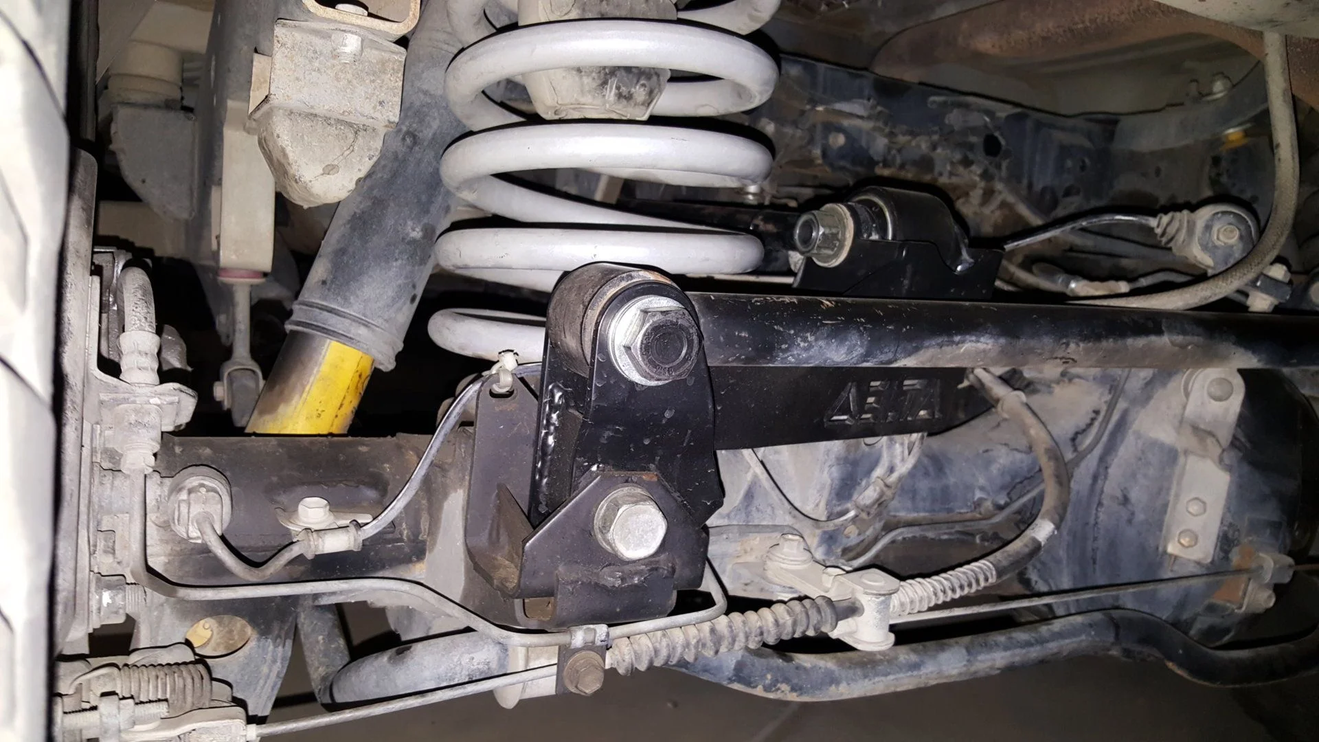

I also was able to get the DELTA rear panhard bracket on.
With doing all to the rearend changes via new control arm bushing & bracket, the way the rig turns is a huge difference. The best way to describe it is it turns flatter... meaning the rear does not raise up while in a breaking turn. It stays flat & follows the front. No more turning on top of a ball type feeling. I'm sure @nukegoat has a more proper word terminology to describe that.
