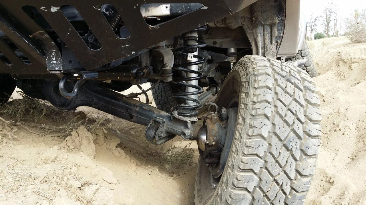

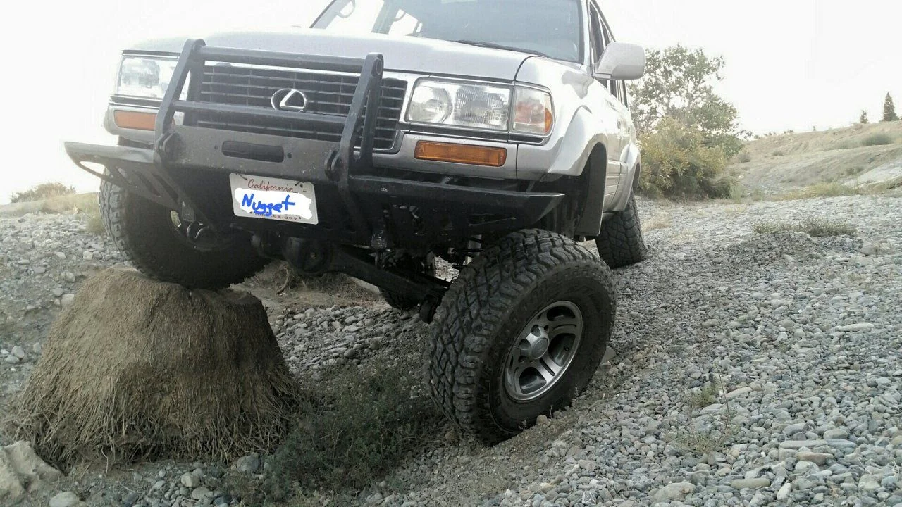

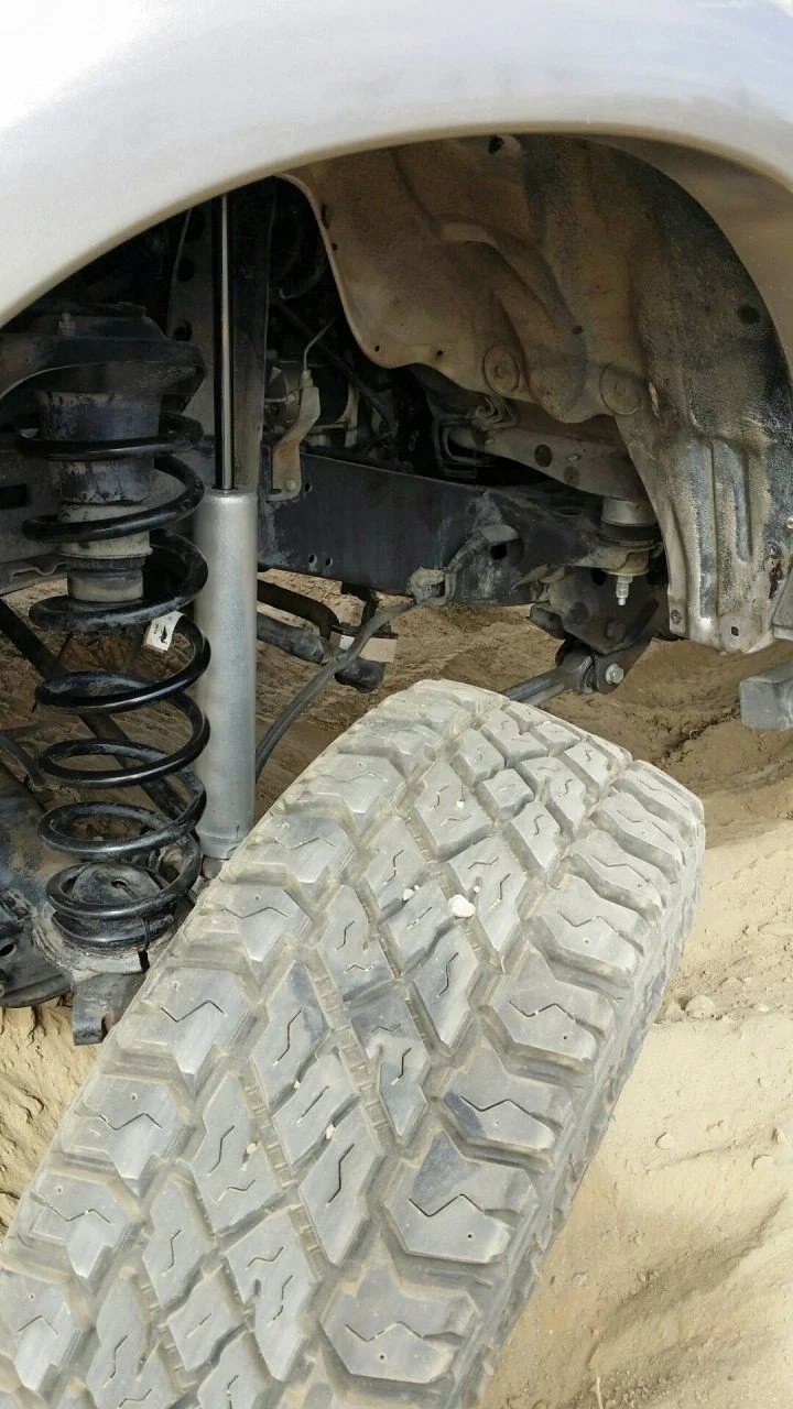

I'm beginning to understand the value of balanced flex. I put longer shocks on the back thinking this would make things better but it didn't, it actually increased more body lean or roll. It was said maybe here, I've read so many threads... that limiting the back will force the front to flex or work sooner. Here is a pic showing more body roll after increasing more rear flex than front. Since 1st pic I removed my front bump pucks after the 1" body lift. End results was 3" more up travel & less body lean or roll. I am now a big believer in a body lift for the 80 series & not bump stopping front travel.
20150725_193059-jpg.1125077
20150822_193922-jpg.1125081
My next move to increase front down travel is to lower the aft rear of the control arm via MAF drop brackets. Think about it... it's just basic geometry. Look @Apounder... he is a perfect example of a bunch of flex by lowering the rear aft of the control arm.
Without bump stops.
I removed the bump stop which allowed more uptravel or articulation only after I made more fender room via the body lift.

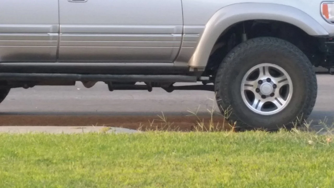

Sliders installed & painted.
Lexi received her last major purchase of the season... the rock sliders are on & ready to go sliding.
I got a really good deal with them welded on with no paint. So, today I taped her up & painted them with the Dupli-Color Bed Armor. I'm hoping the bumpy texture will help with the family getting in & out without slipping.

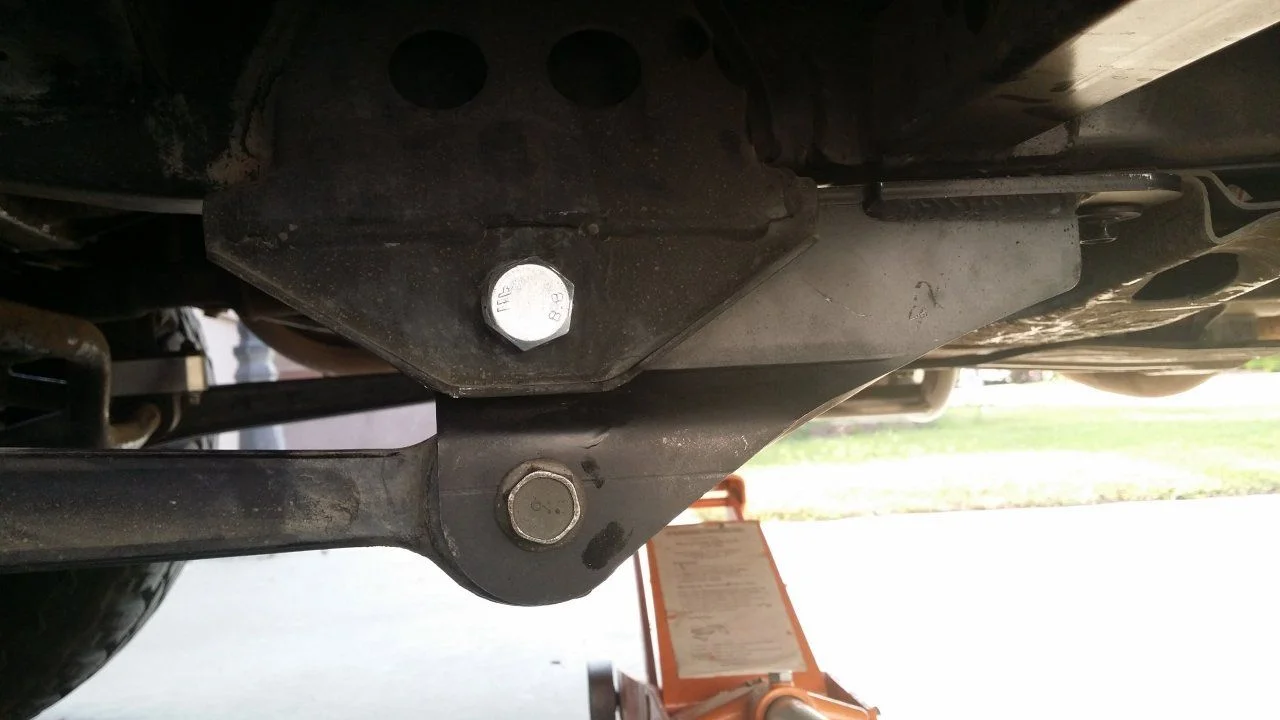

Thanks to @baldilocks I have aquired a set of the MAF drop brackets that I have been writing talking about. They where very simple to put on with a we bit of filing they slid right in. The 1st thing I noticed is they measured out to a 2.5" drop rather than the assumed 2" by the name of them. Once on the road I noticed a big difference in road manners. It's a more relaxing feel & Lexi turns much better. The rear seems to follow the turn rather than want to lift up & come overy the top. A stiffer sway bar in the rear I think would help this also.
That was the bonus. Now for the main reason I got these was to hopefully increase down travel, well it did by two more inches. The shocks were only ext. to 26.5" now they are going 28.5"
They definitely don't hang down as bad as the 3" MAF brackets. I'm still using my yellow caster bushings.

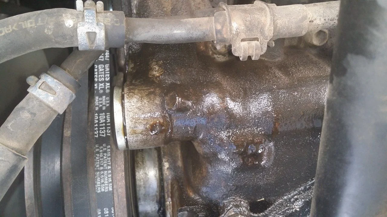

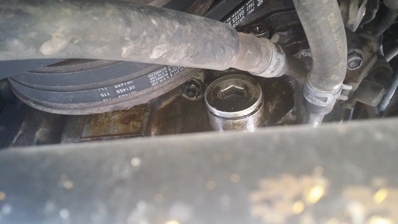

Well, it looks like I found my 1st oil leak, it's coming from that hex allen thing. I haven't research it yet. But it looks like a easy fix next oil change. The size looks like a 14 mm maybe?
View attachment 1138327 View attachment 1138328
Have you checked it while running? Mine's been parked for a few months, but I started a massive leak in this area too. I ended up changing the front crank and oil pump cover seals. Working on a few other things so I haven't started the truck yet, but I'm hoping that fixed the leak.
Yes, probably oil pump seal. Let me know if you want me to get the parts for you. Also look for the replacement screws; used to be able to get them from the guy who sold PHH kits, but I think he's gone.
Hmm, well there is a lesson be learned if it is the oil pump seal. I have it & decided not to put it in while in the HG change. :doh: I will clean it up good & go from there. Thanks for the replies folks...:meh:
