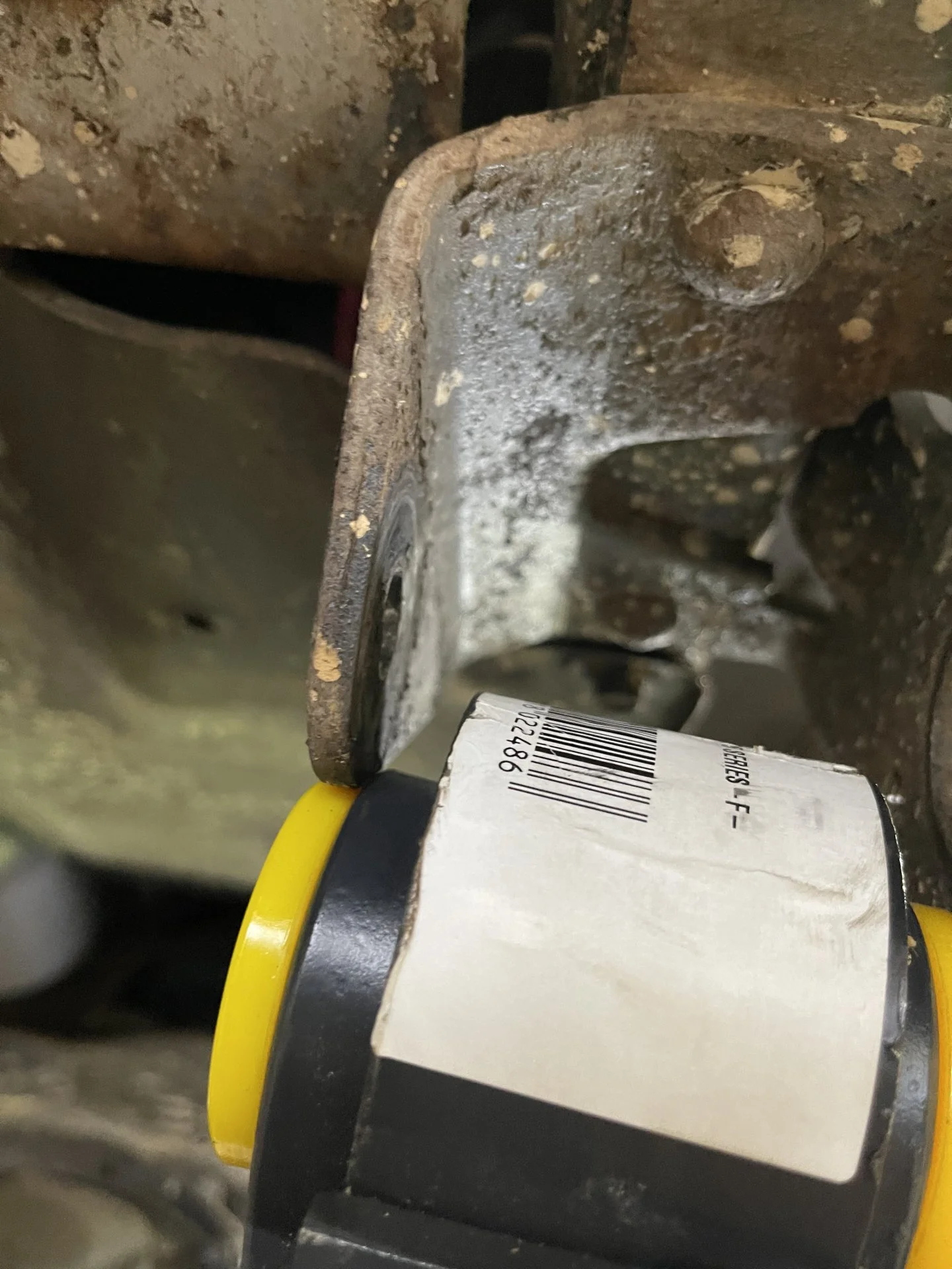

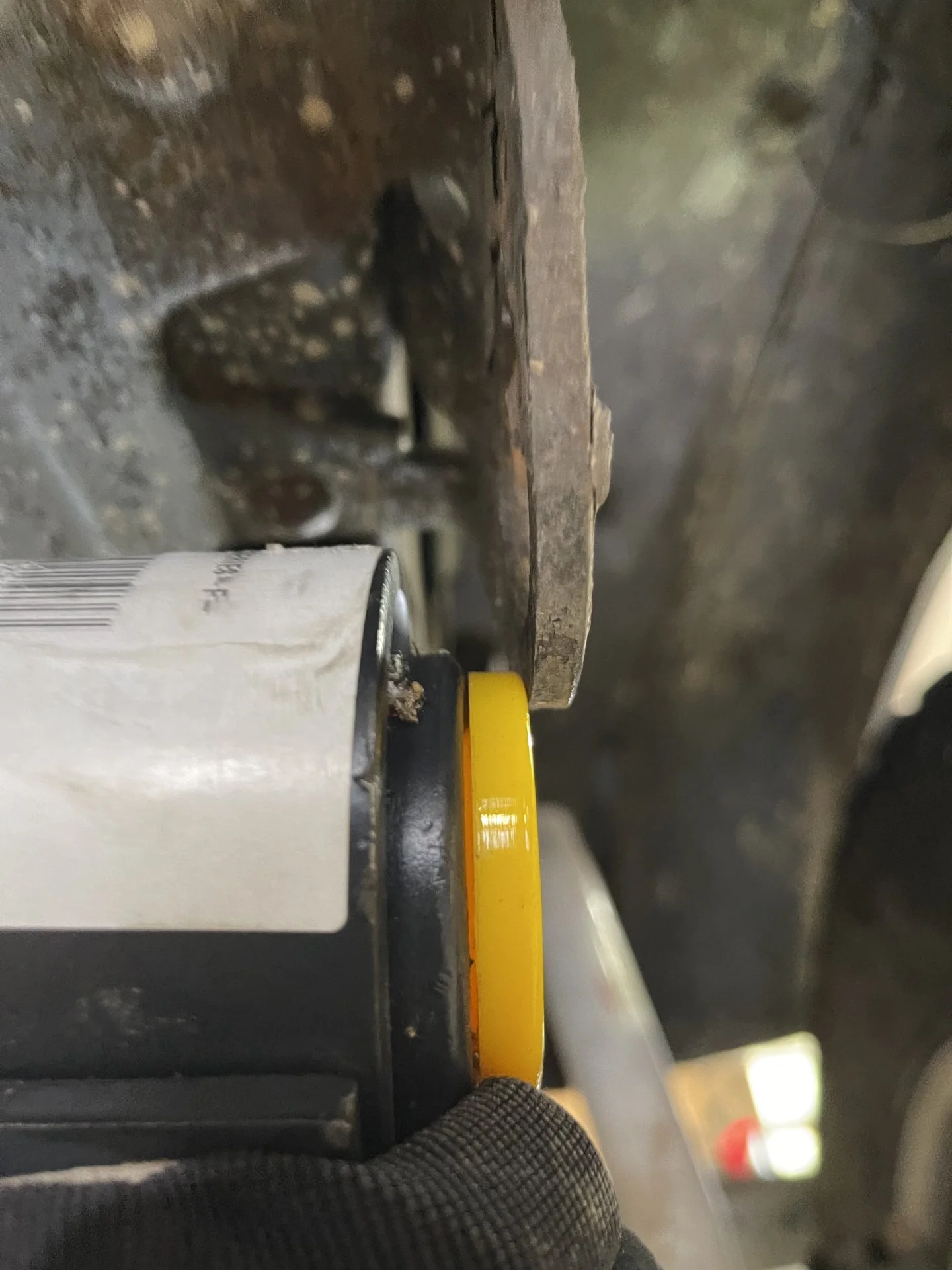

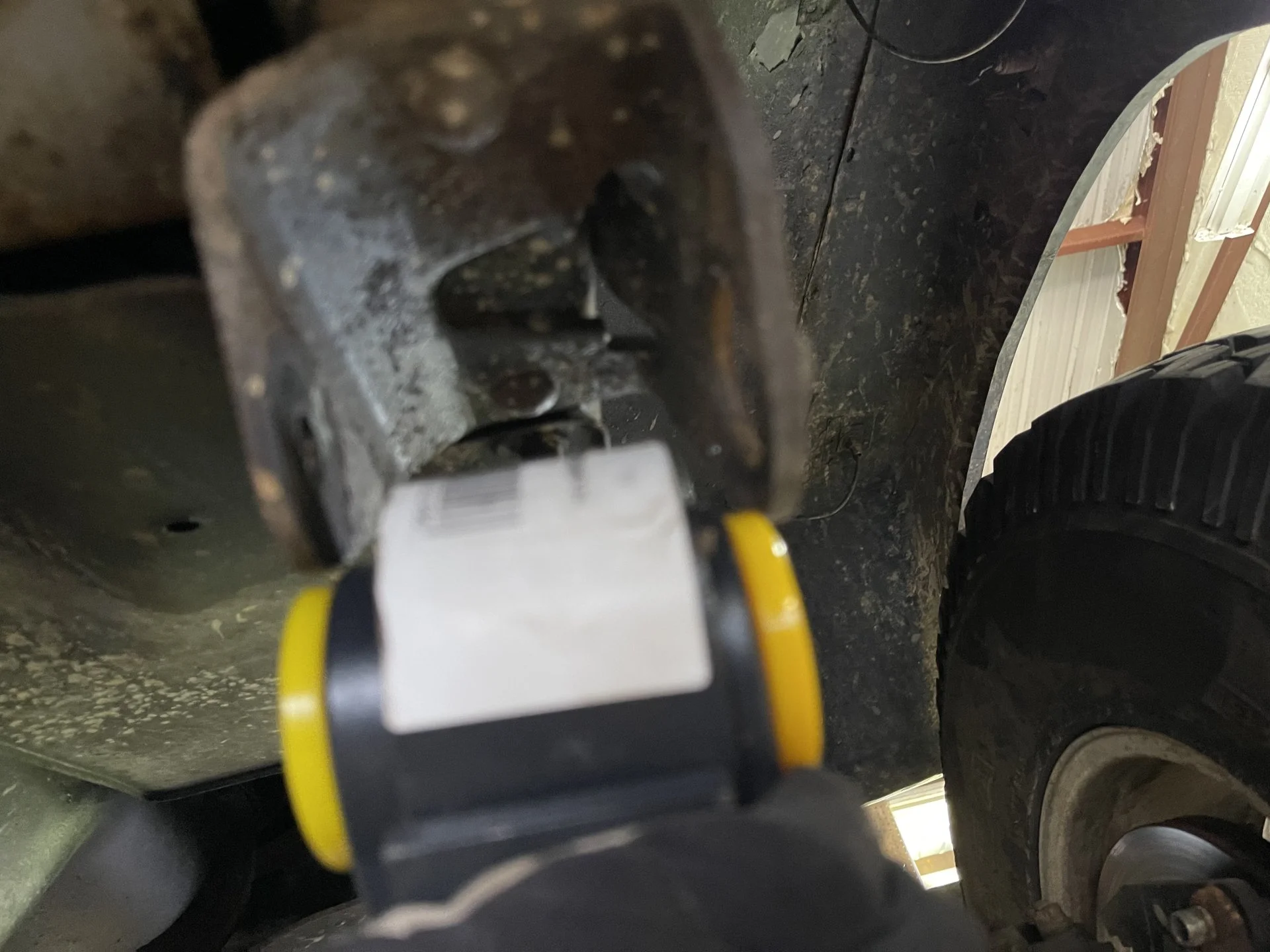

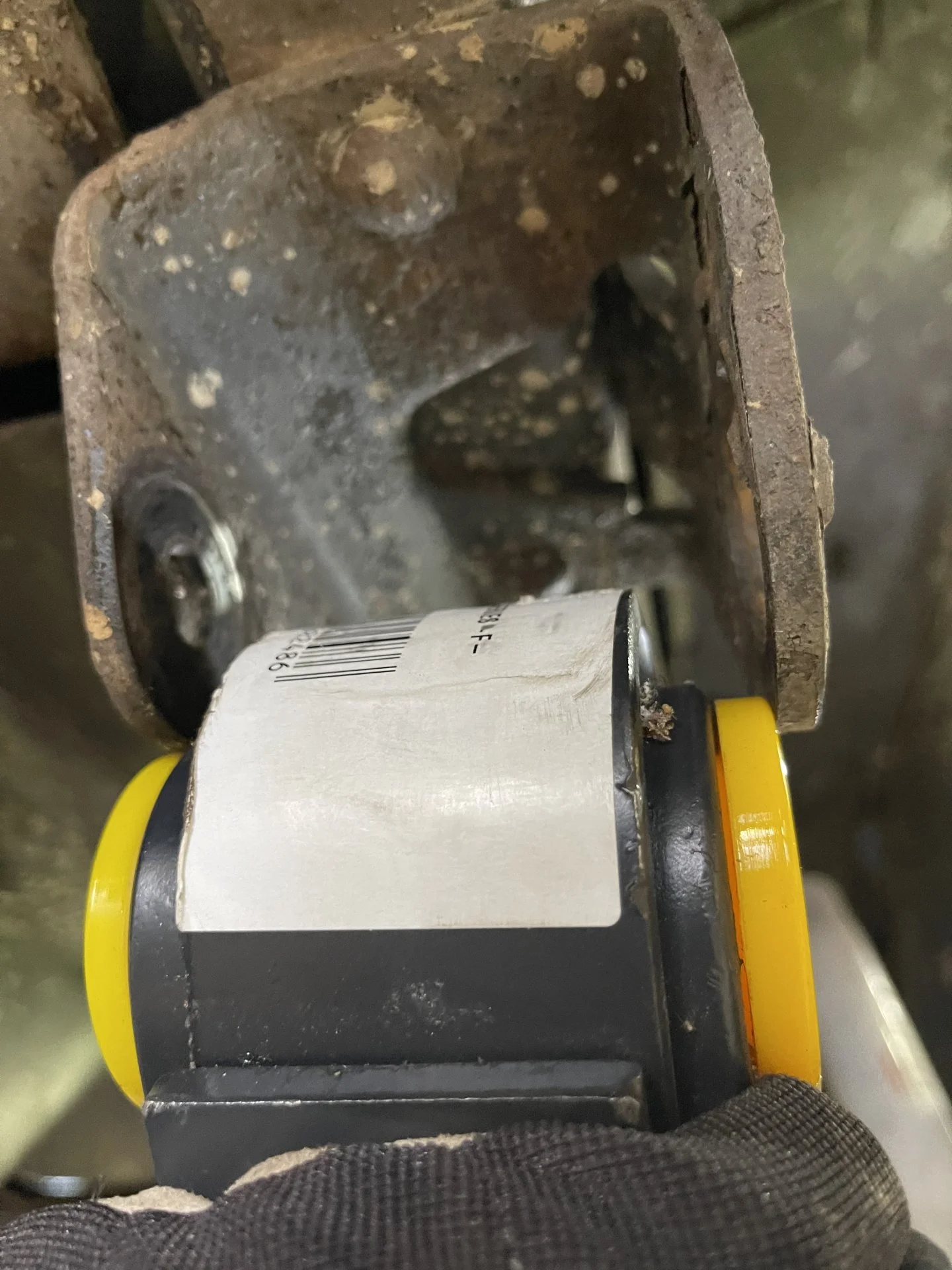

Ok life happens, just now installing lift and I am having a problem on fixed side hanger. My new leafs plus bushing are two wide. Is it as simple as spreading the hanger a little bit?
You can spread a little and take a little off the OME bushings. Every OME setup does this. Annoying as hell they won’t make the spring a bit smaller
I like how Nolen still slums in the IPPS forum to help and simultaneously throw shade. His swine flu may be in remission, but it's only a matter of time he starts seeing symptoms if he keeps comin' 'round here parts.
Just me, but it looks like you would have to grind most of the bushing shoulder off to get it in there, something I wouldn't want to do.
Correct, I am hoping I don’t have too. I called cruiser outfitters and emailed pics waiting to hear back.
It’s better to take a little off the bushing shoulder on each side than try to spread the hanger open. If you try to spread the hanger it’s going to cause misalignment of the pin, and will just clamp back down on the shoulders again.
You only take off enough to get them to fit. There’s still shoulder there when you’re done.
