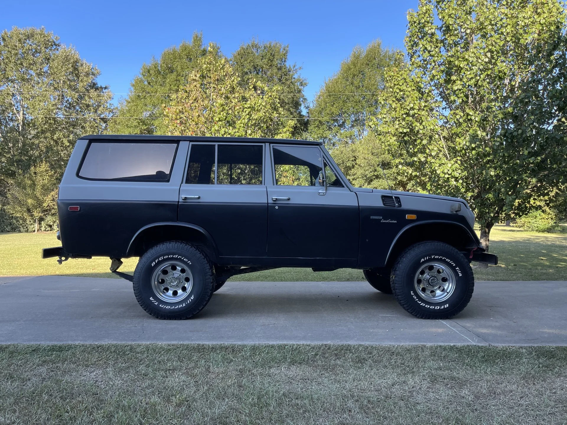

Been on this journey for awhile. Lol trying to get it there.
Was not bad at all. Thanks for adviceYou’ll be glad you did
Thanks for that info , I need that ! I did not know that part was out there ! Woopeeeee !

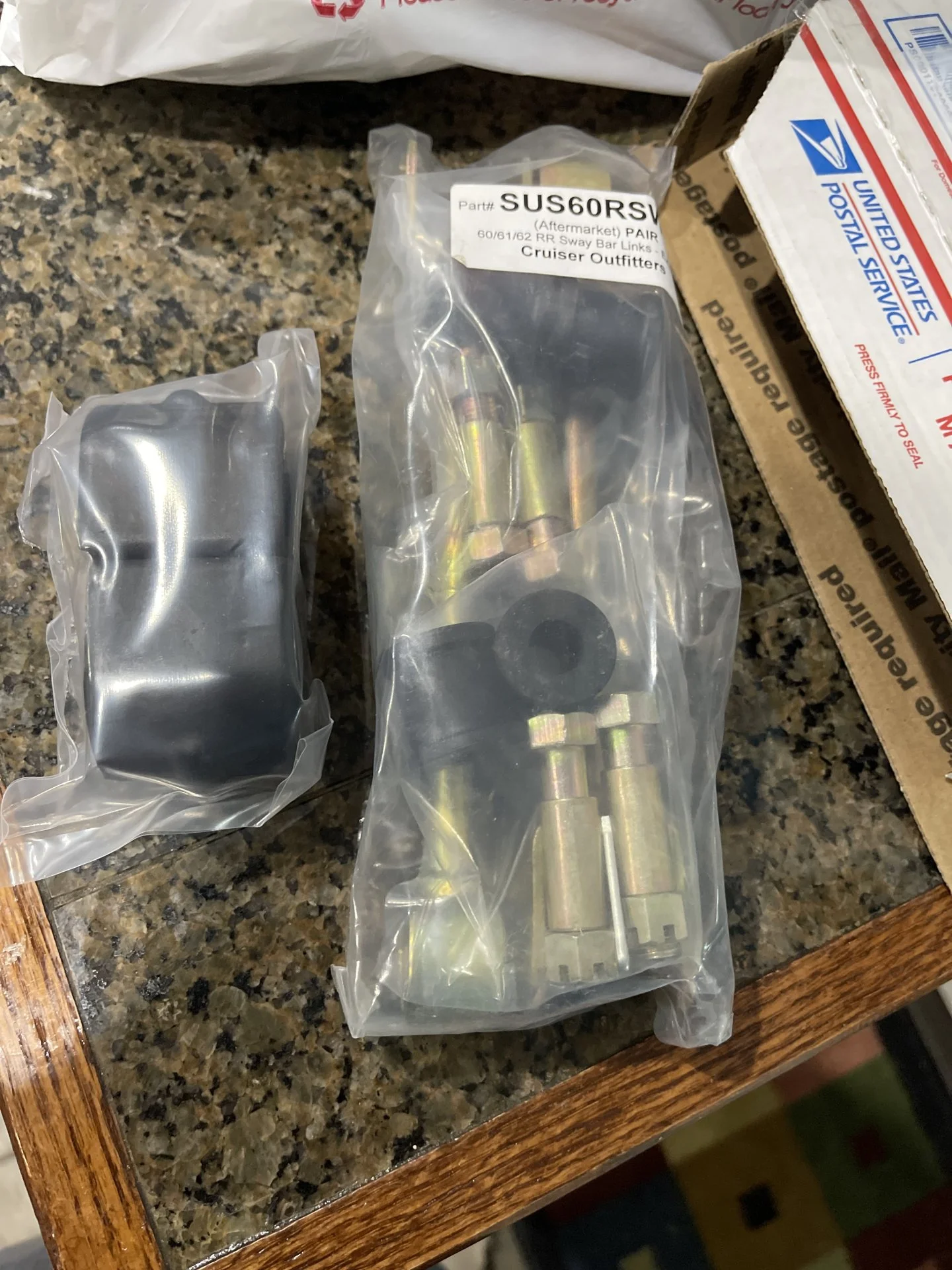

Just call these guys order my whole kit from them. The bar bushings are separate. Got them in like two days.Thanks for that info , I need that ! I did not know that part was out there ! Woopeeeee !
????? What part # is the big rubber bushing ? Thanks

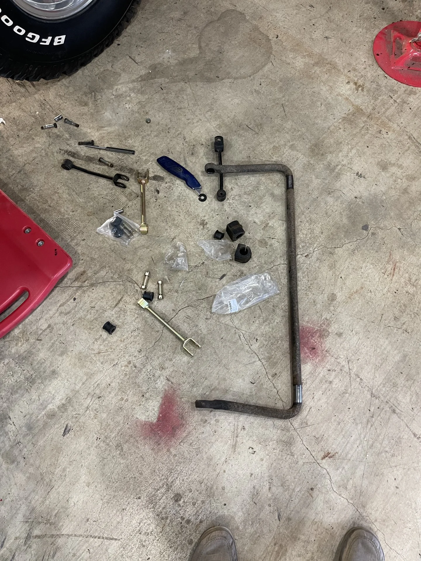

What was causing it to be twisted?Could not take it. Had to go back and undo passenger side fixed shackle it looked twisted. Sure enough it was. Two steps forward one step back.
What bushings did you use? Still available OEM?Looks really good! Nice work! Brings back lots of memories from last winter and spring doing this work. I really like the way my pig rides. I’d also recommend replacing the bushings in the rear sway bay while you’re in there.
I ordered a kit from Crusiers Outfitters worked great. The bushing on bar was made just like OEM. The link end replace all bushing and hardware.What bushings did you use? Still available OEM?
The new OLD EMU bushing were so thick was not sitting correctly. Had to take more off, works awesome now. Just was surprised about bushing thickness and fitment. Was not called out, but they were all over trying to help me though.What was causing it to be twisted?
