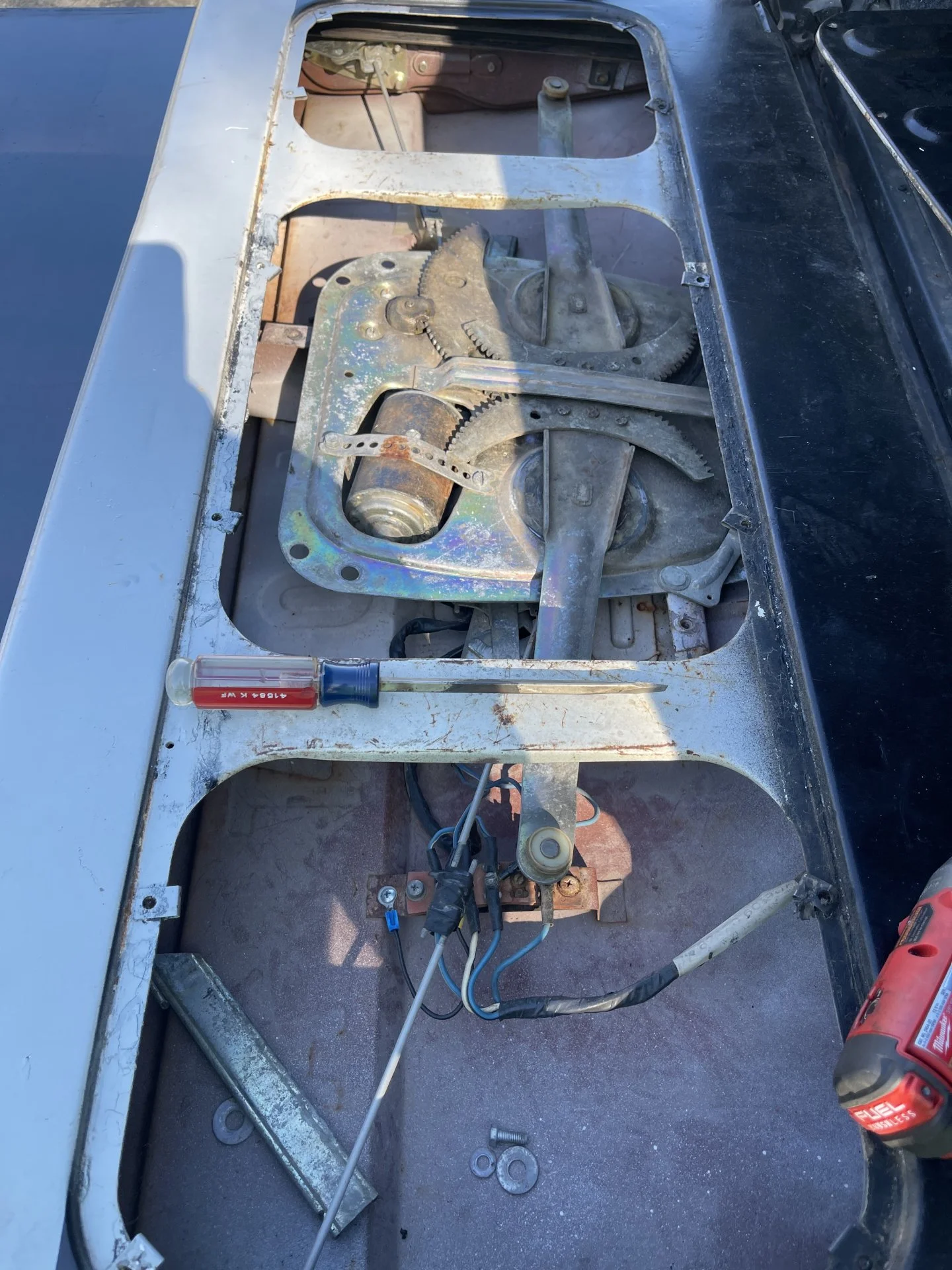

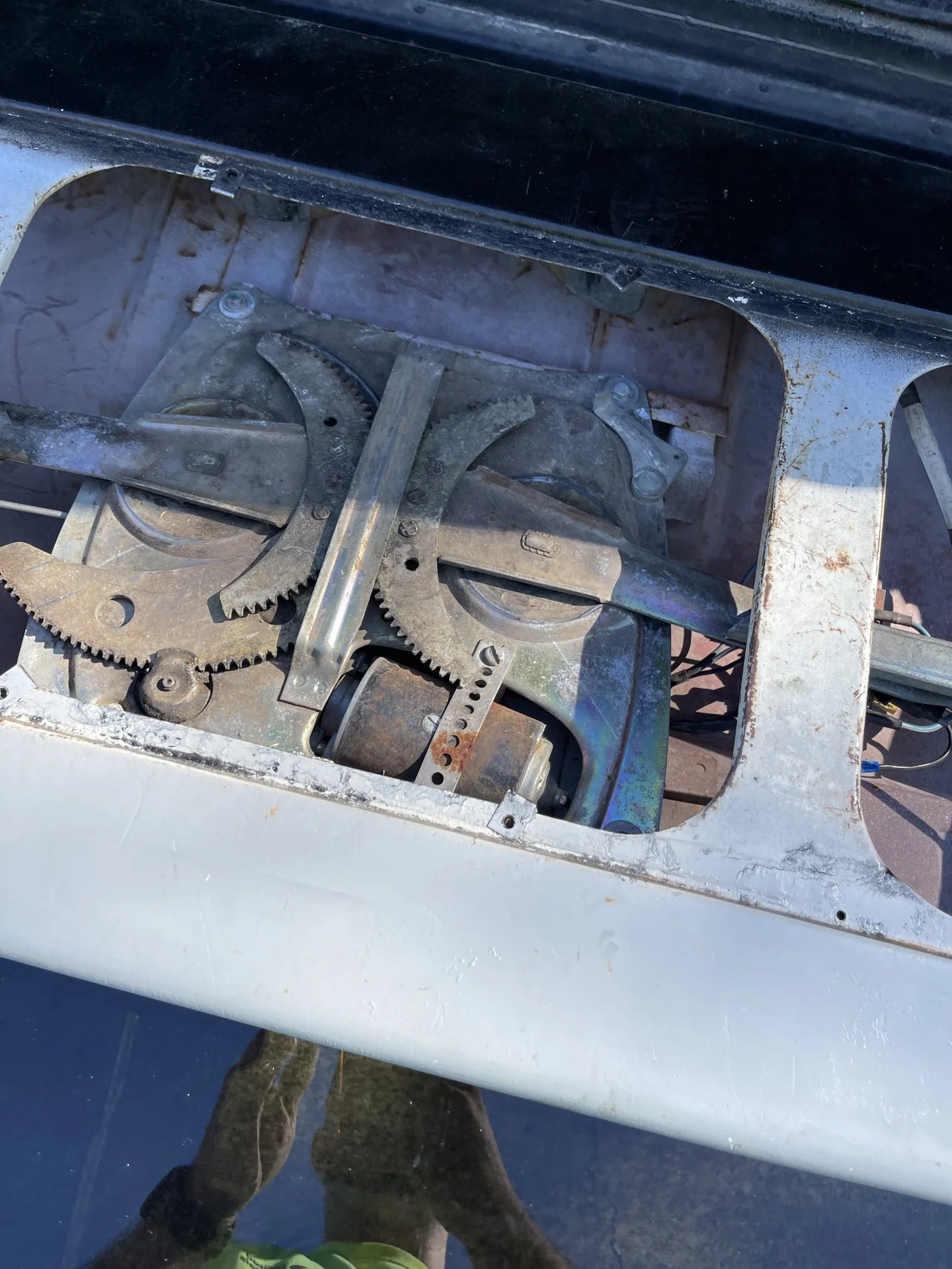

Both switches works, just seem like it’s still in a bind. Hit switch and lights dim. Finally got it up. I have a older motor spins free great when out of regulator. Thought the plastic gear had it solved but guess not.
If it’s even slightly bound up with the weather strip on the sides it will trip the breaker.
If you can use the key, try it putting pressure on the tailgate by hand and see if that helps. Lube the runners too

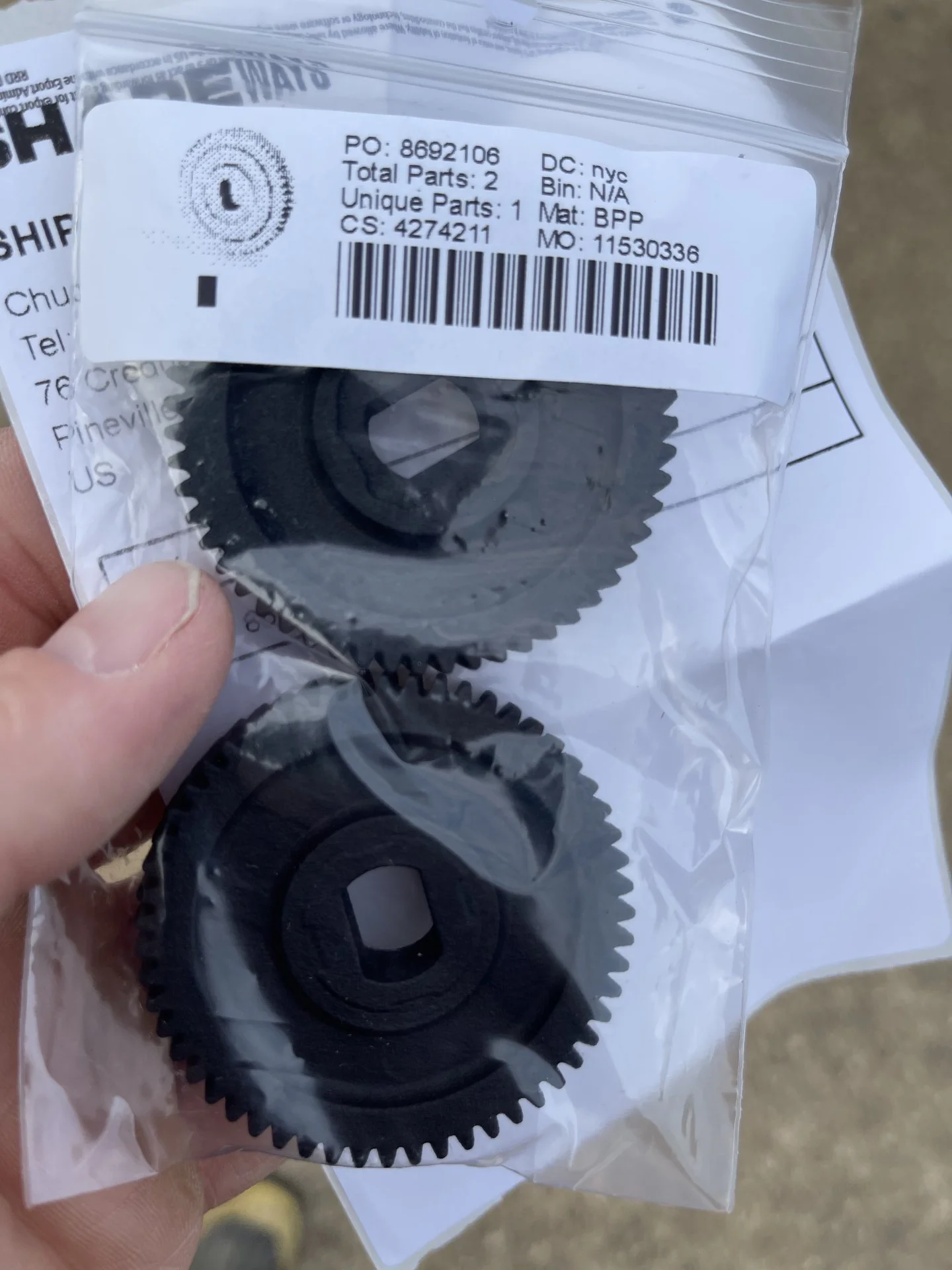

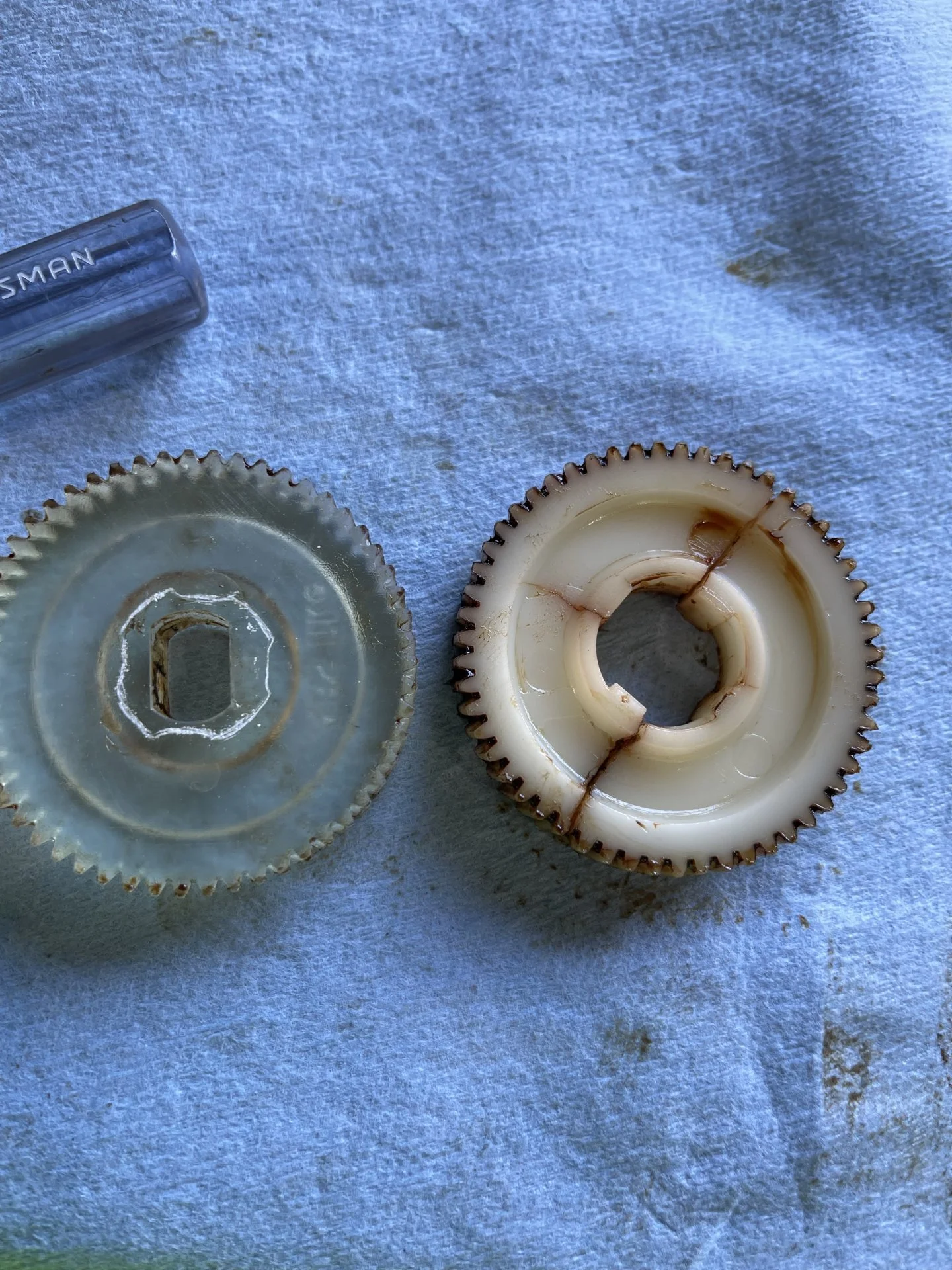

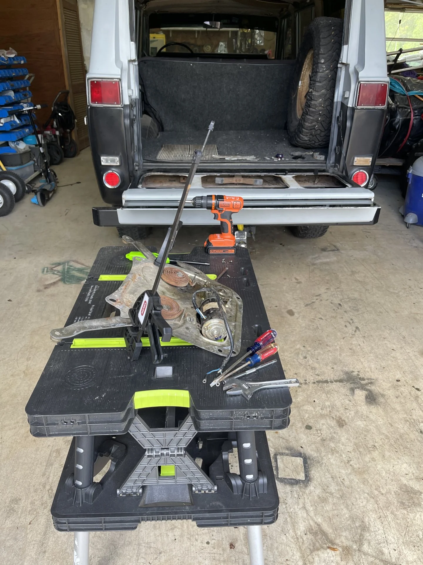

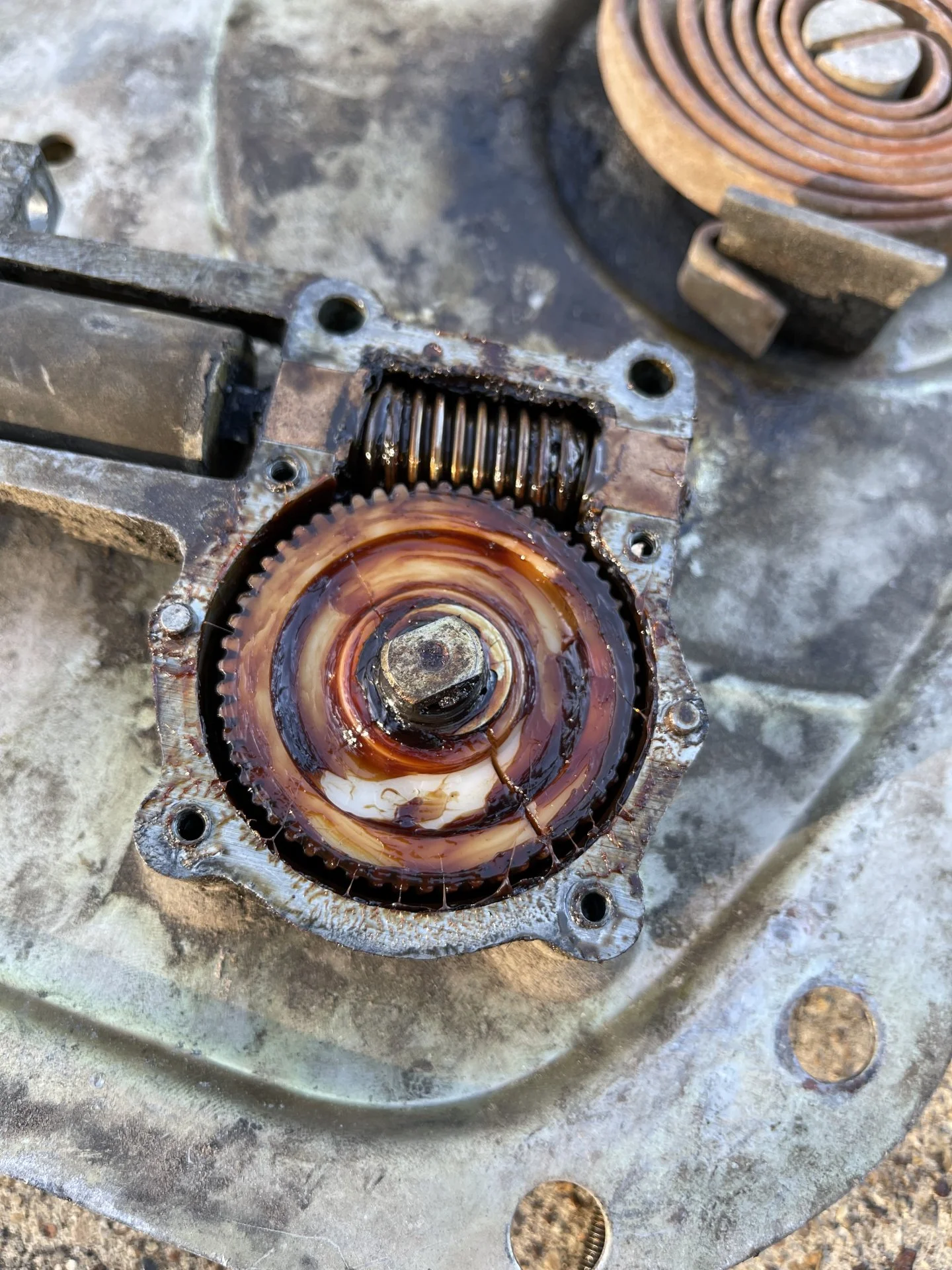

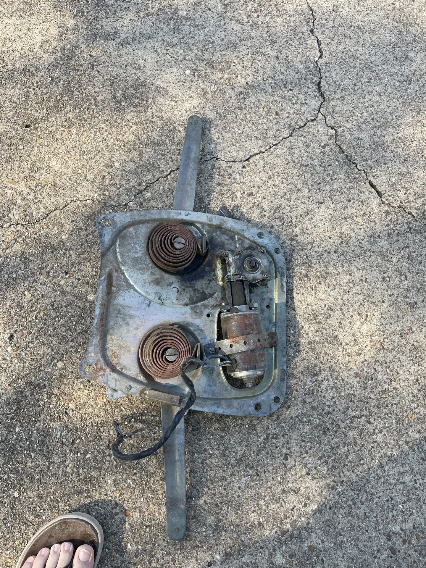

Guess I need to check track, you can assist it with key up and down. Even with the glass unhooked from regulator it still struggles. The center of my plastic gear was different I just milled it out till it fit. I need to order the correct one. It may be slipping on the shaft.

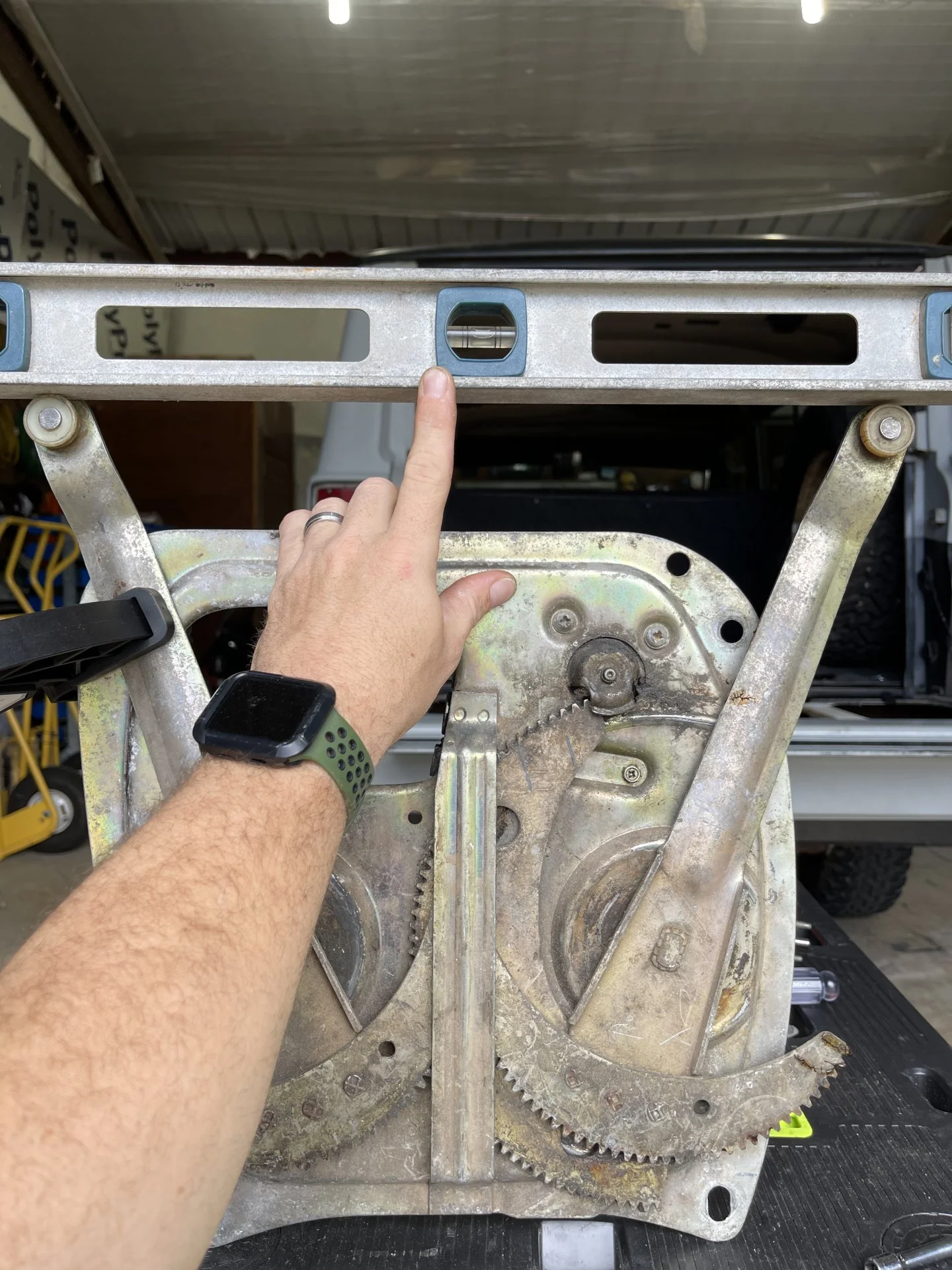

Pretty sure I am a idiot. I didn’t realize that come off the shaft and that bushing was separate. I now need a rear window gear and then going to break down regulator and clean and lube. I milled mine out with a bit and drill press. Trying to make it work….lesson learned.
Back in action. I still seems like she struggles on the downward side and strong on way up. She is working though, if you raise and lower her couple times back to back circuit breaker will trip. It’s does reset though.
