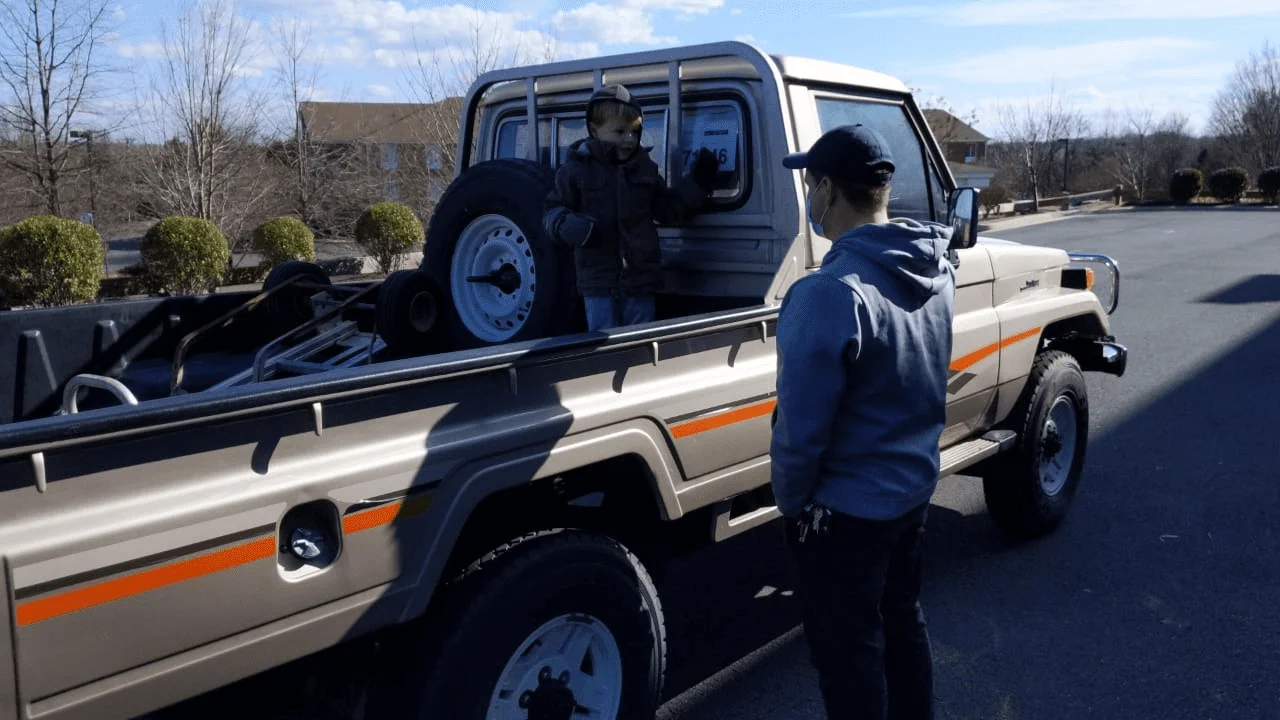

After getting the corrected title I met D21FJ60 and his young son to hand off the rims.
There is something very gratifying about using Golden Boy for his intended purpose. The truck is of a very nice size. Not big. Not small.
As D21FJ60 mentioned above, he and his son took a little drive in Golden Boy. And then there was a little shooting the breeze and so on. Really nice.

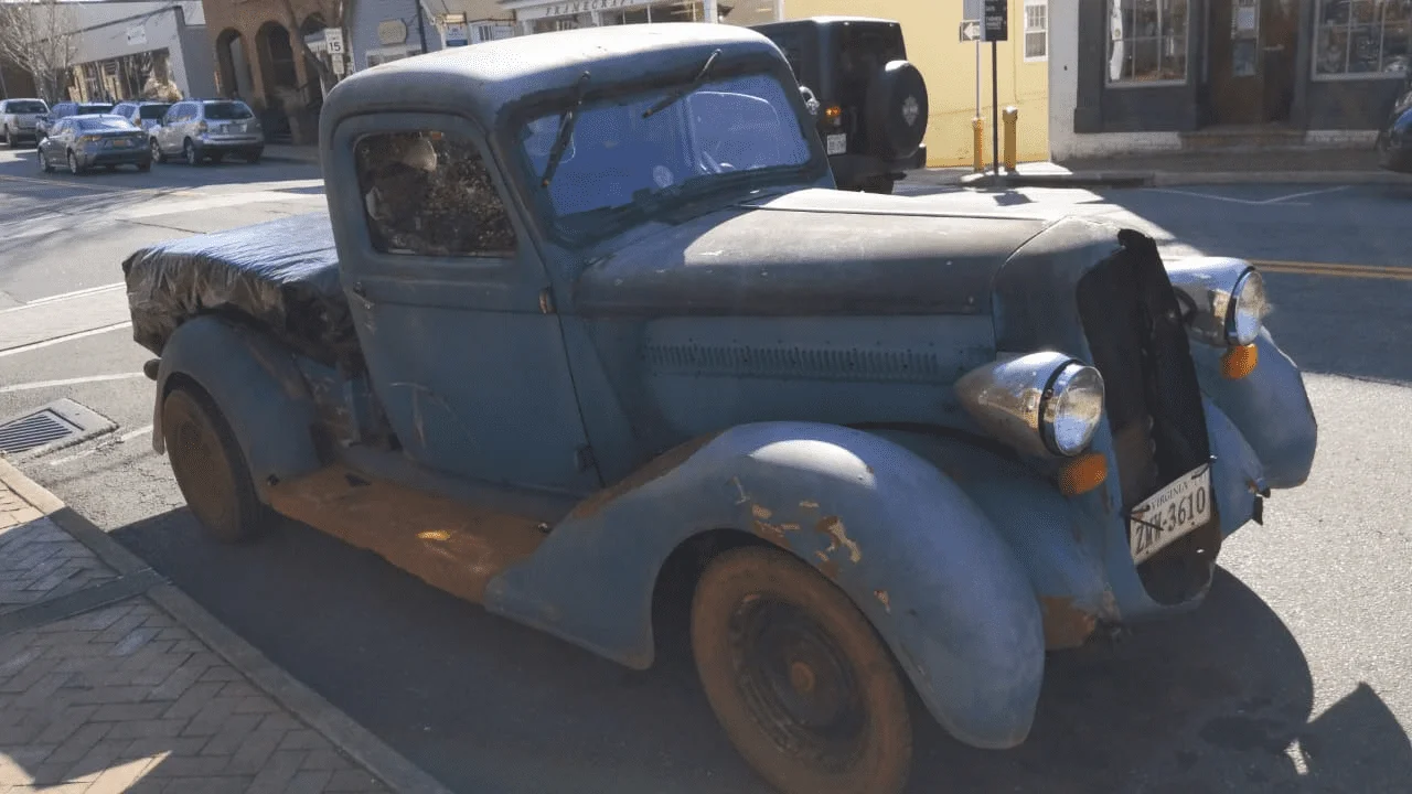

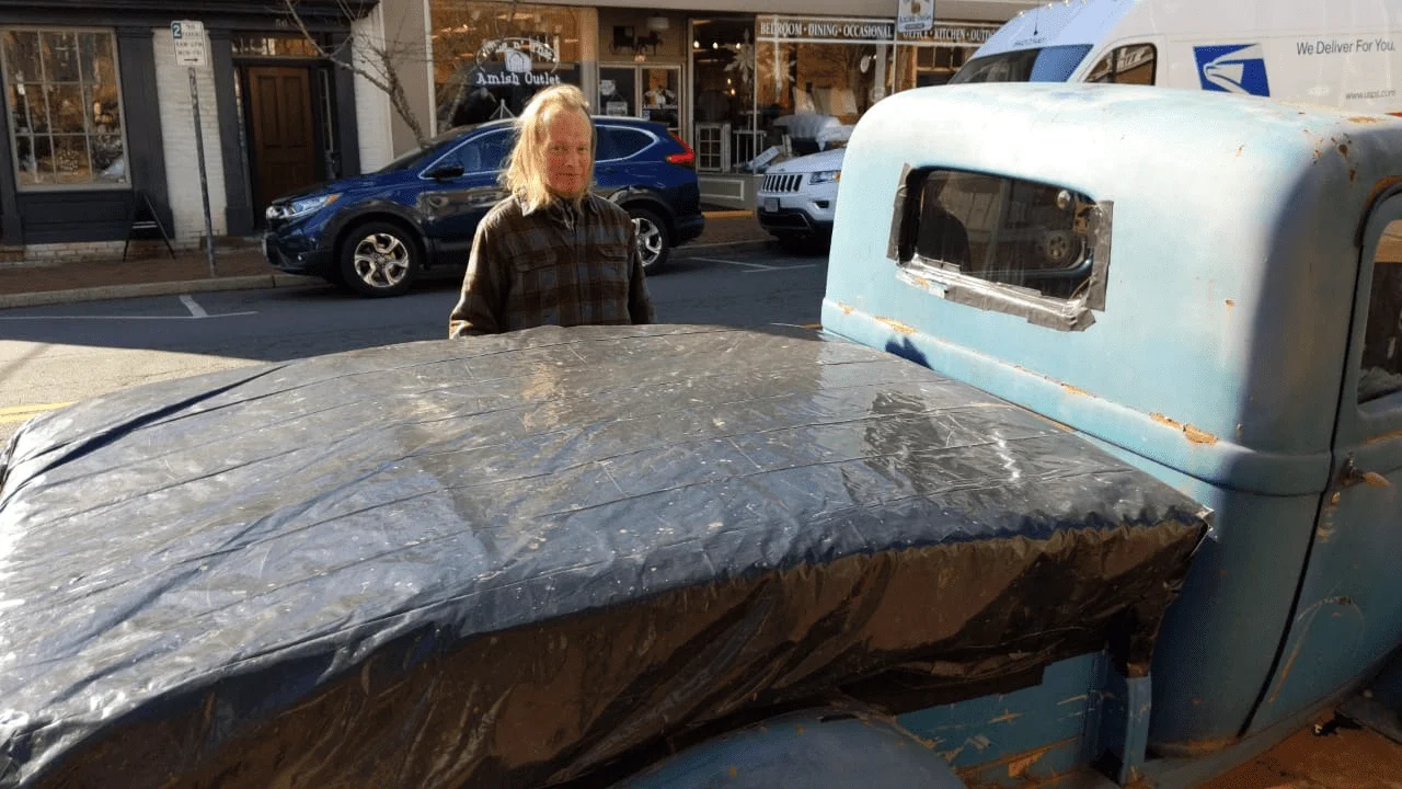

I'm not the only one in the area that likes old trucks...
It's a Dodge in case you cant tell. Here's the owner, Matthew:
This old truck has been his daily driver for the past 40 years, he told me. Had a nice conversation. Currently he has a 350 he bought as a crate in the 80s that is getting a bit tired. I suggested he look at the Cummins 2.8 crate as a replacement.

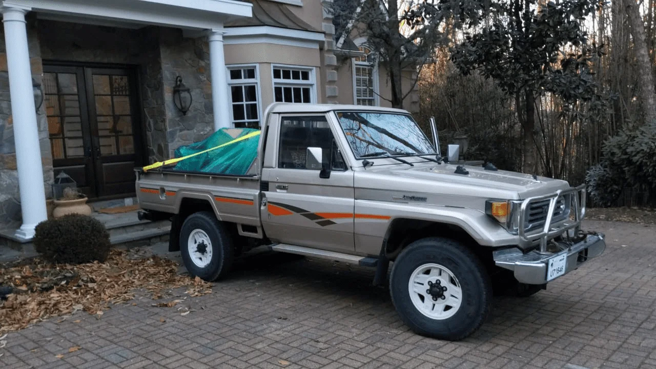

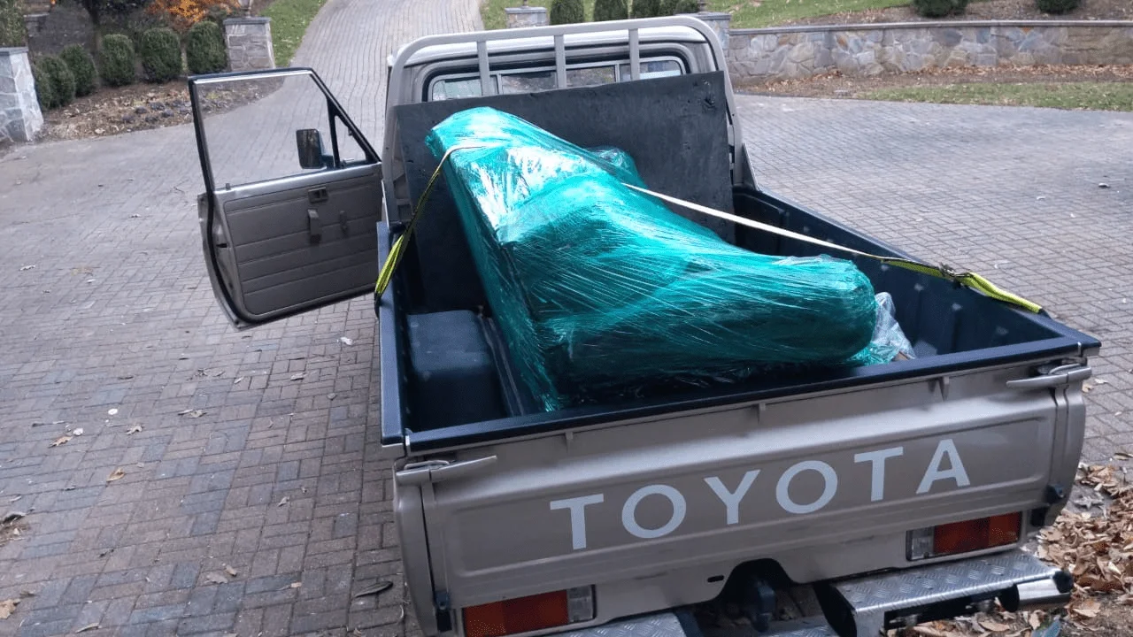

Today the boy and I put GB to his intended use: hauling s**t. I found a pair of sofas I liked on Craigslist and purchased them. GB handled it like a champ:
I now can confirm that the 5 figures I've put into GB have been well worth it!

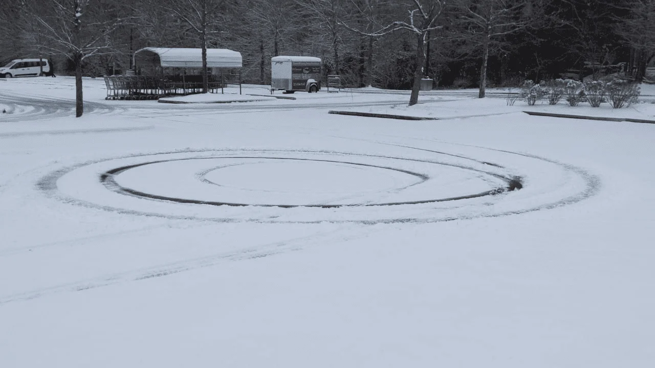

Had a little fun in a parking lot this morning.
Almost picture perfect!
Crop circle:hillbilly:

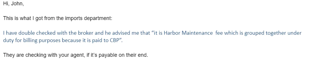

When the truck finally made it into the US, the Amercian-side logistics company sent me an additional invoice for "Formal Entry (Customs Duty)" in the amount of 234.21 USD. They originally said that it was because I had owned the truck less then a year. But when I showed evidence I had owned it for more than a year in the UAE, the logistics company dispatcher (a very nice guy, BTW) said this:
I had a look at the customs declaration form and although there were some fees on it, there was no actual duty. I believe this is because the truck was my personal property being repatriated to the US. EDIT: I think they must have used some kind of blue book value for the truck because the number on the customs document was a couple of thousand USD lower than what I put on the import forms.
