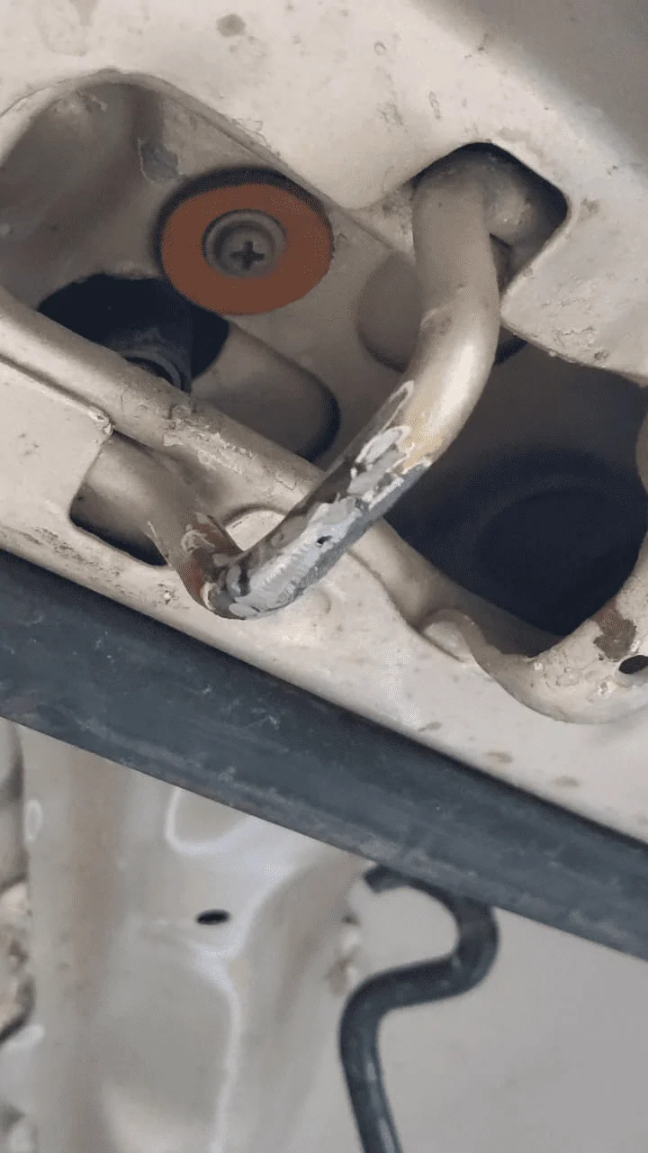

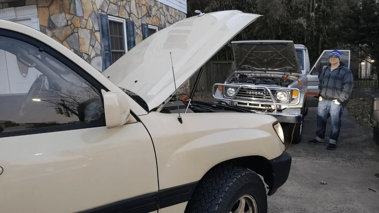

The first little project that needs doing is to figure out what's wrong with the hood latch. It locks, but not in the fully down position, so the hood tends to bounce up and down a bit. I noticed that the u-shaped catch (?) in the hood itself is quite worn. I'm thinking of firing up the little mig welder and building it up again. Maybe I will try that tomorrow.

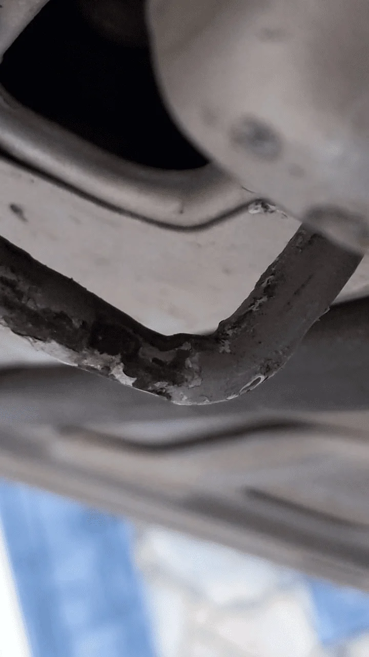

I also should crawl under and have a look at the rear tank. It seems to drip a bit when Golden Boy is parked pointed uphill.

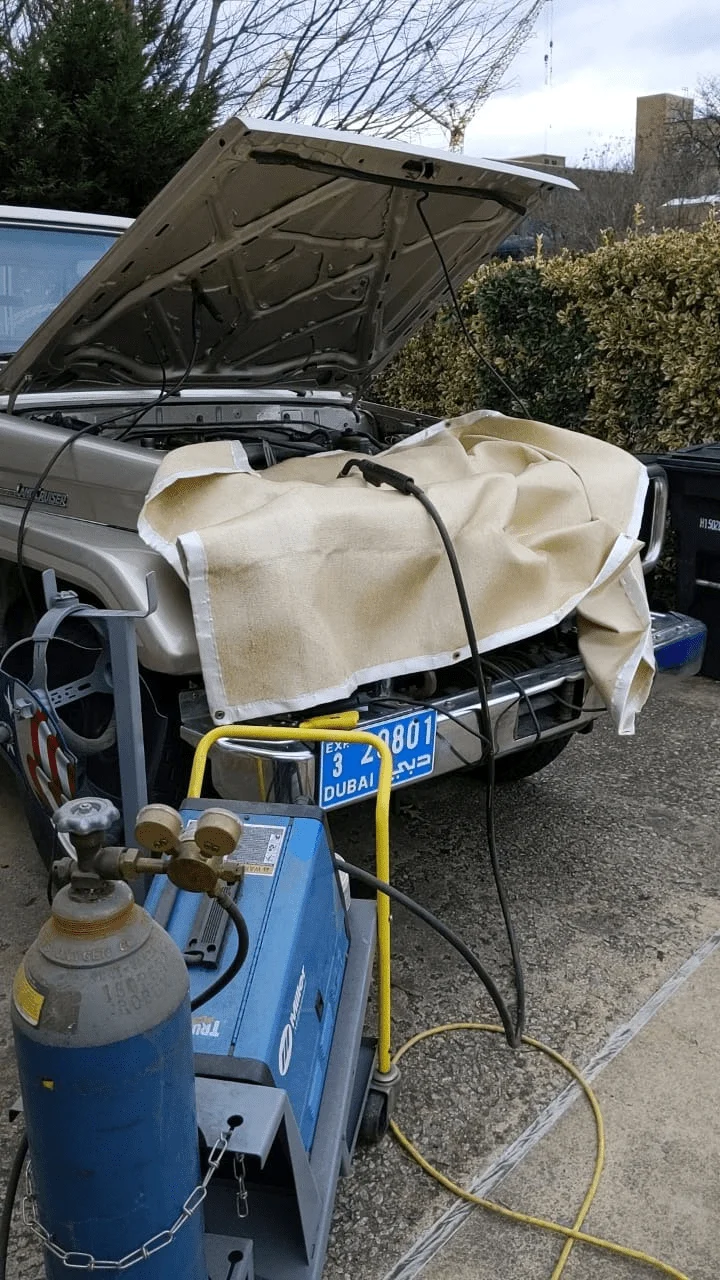

Well I worked on the hood latch this afternoon.
I was convinced this was the source of the problem:
I cleaned it up with a Dremel:

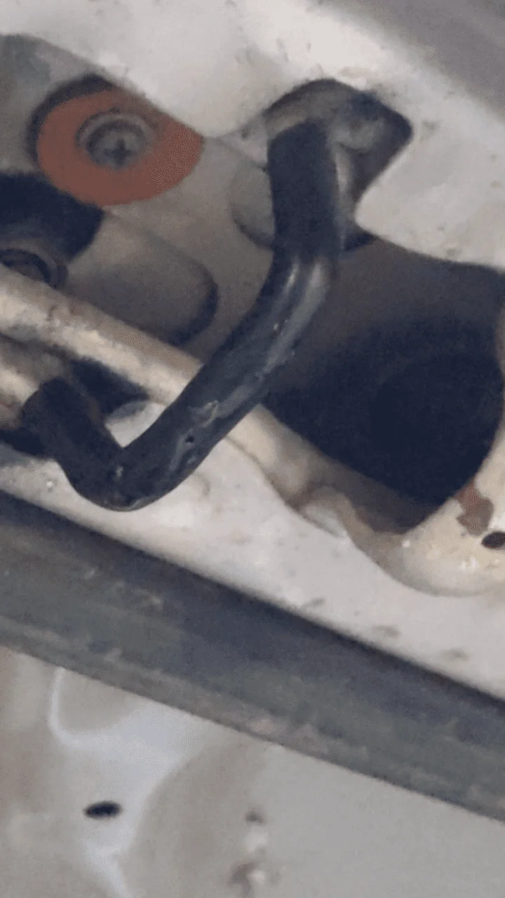

Then got out the little MIG.
I won't show you what it looked like after I finished the welding build up. But after I annoyed the neighbors with an angle grinder and a little more fine work with the Dremel, this is what it looked like:

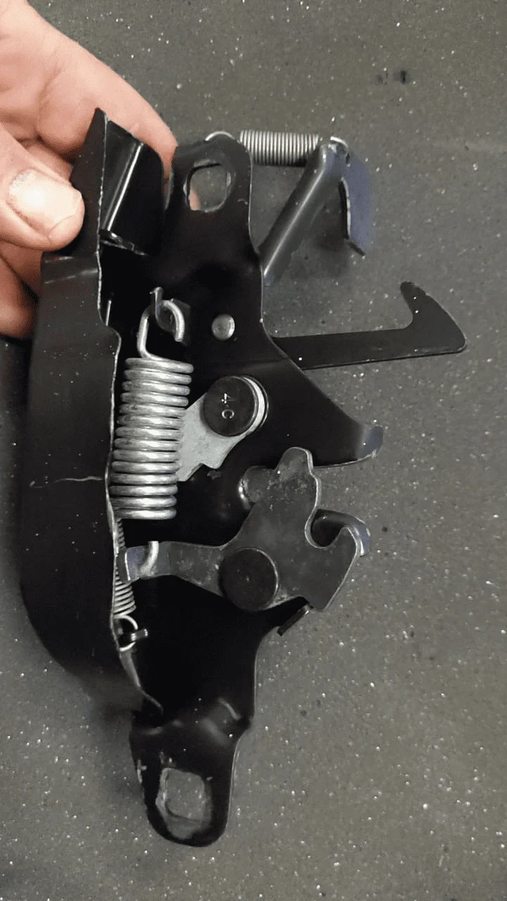

The latch itself cleaned up very nicely with an ultrasonic bath and some simple green and didn't actually show much wear at all.
And this is what the loop looked like after a little rattle can treatment just to avoid having bare metal exposed.
And here's the punchline. I got it all back together (using a plastic spudgie to hold the cable actuator part so I could get the little ball into the proper position), and I held my breath and closed the hood. It worked! Wanting to try it again to further savor this minor triumph and also to make sure I had gotten the actuator cable correctly installed, I went to the cab and popped the hood.
Then I tried closing the hood again, and it wouldn't lock in the fully down position. I hadn't fixed the problem at all., dagnabit!
Then it (finally) dawned on me: what if the problem was not in the latch or the loop, but somewhere else....like the pull cable. Sure enough, the actuator cable was a little sticky and when I pulled it out to open the hood it did not retract all the way by itself. Lubed it with some penetrating oil at both ends and it is pretty much fine now.

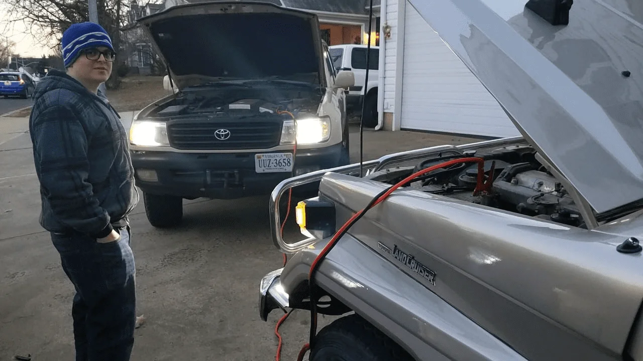

Unfortunately Golden Boy was a little cranky, and would not start.
That's the 98, a truck that also has in excess of 350K miles.

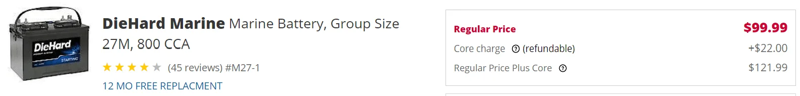

Golden Boy still won't start. It's cold out and the battery in it is not sized correctly. I think it was just an old battery that hung around a little too long. Off to the diesel forum for battery recommendations...
Group 27.
I'd leave that sleeping dog on the porch. :steer:
My first Land Cruiser was registered as “farm equipment”. Did I bring the mistake to their attention ...... the short answer is NO.
Thanks to CruiserDan, my shopping was easy, if puzzling. The local chain auto parts store had two relevant options (they also had an Optima battery for 329 USD but that is a bridge too far):
I did a bit of reading and it seems marine batteries are kind of a hybrid between regular car batteries and deep cycle batteries. They also are supposed to be more heavily built structurally because boats, I guess, experience higher g-forces. The cold cranking amps was higher on the marine battery, and it was 50 bucks cheaper. So the marine battery was better, stronger, and only 2/3rds the price of the regular. Sure it has only a 12 month warranty, but given what this truck will be doing, that's probably not going to be relevant. Really, even if it had been the same price, or even a little more, I would have bought the marine battery for the 80 extra cold cranking amps, given Golden Boy is a diesel.
They had the battery in-stock and here's my younger boy installing it:
The new battery performed its duty, and with a couple of plunges on the oversized fuel filter primer, Golden Boy was running again!

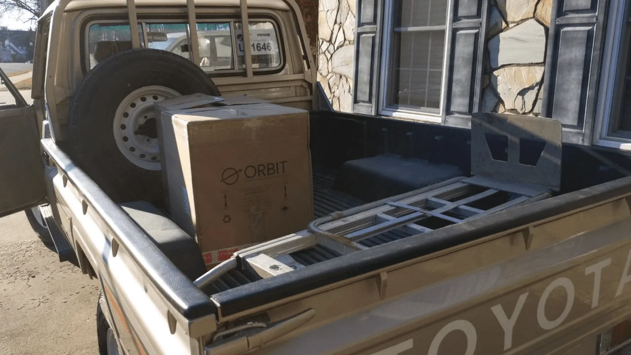

And here is the first official use of Golden Boy for its intended purpose of being a pickup truck:
Transporting a small piece of plywood from one place to another! Hooray!
