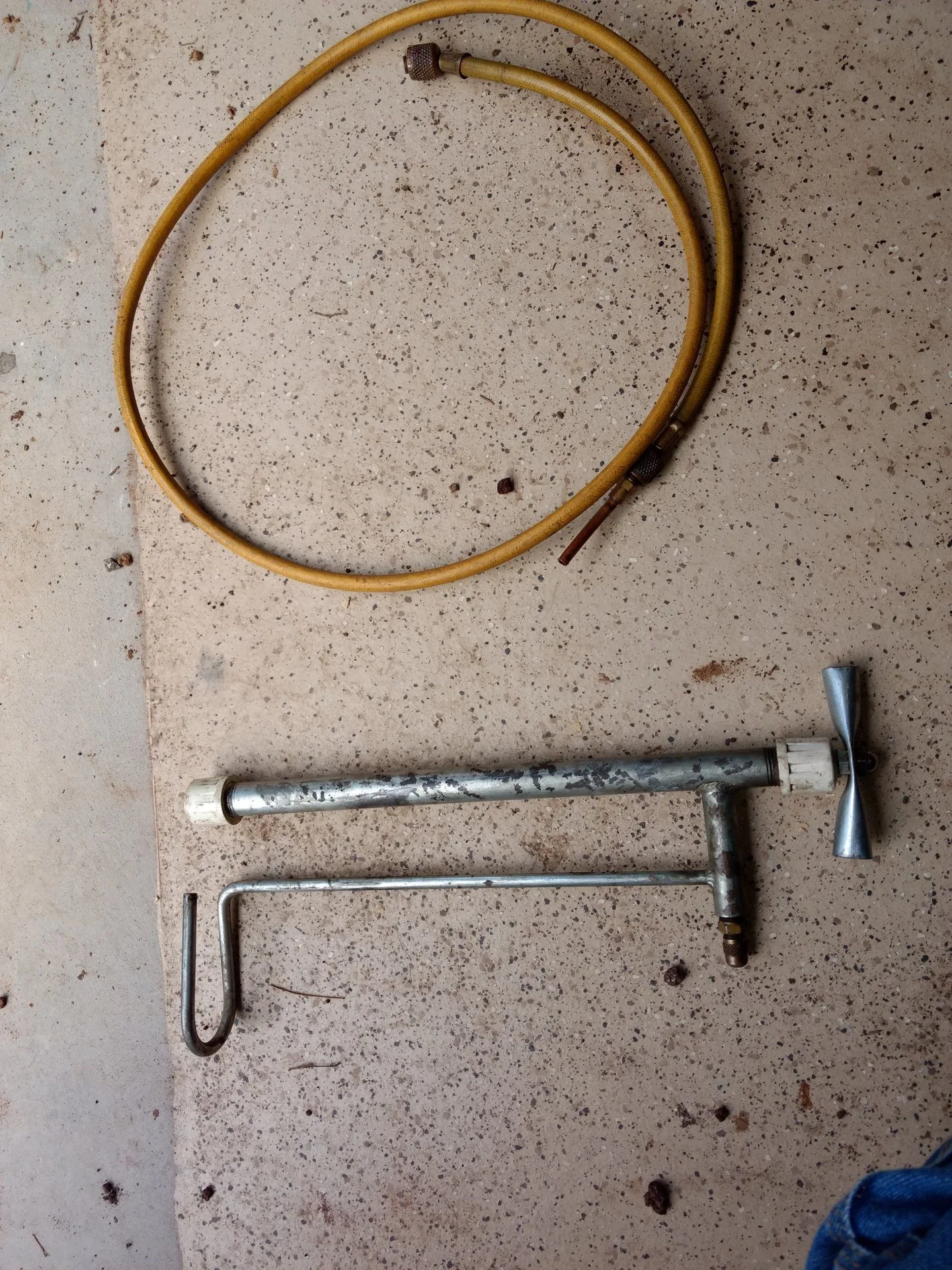

Old HVAC tech and have a couple of oil pumps used to change oil in semi hermetic compressors. Use a 6' hose off a set of gauges. Use schader valve with 1/4" copper tubing on the other end of the hose. Can operate the pump next to the vehicle not underneath it. Tube just fits inside a gallon container. Can snap a picture if you want?
Hey John that would be great, much appreciated sir! Bummer I missed Casner but had a good time with my folks.

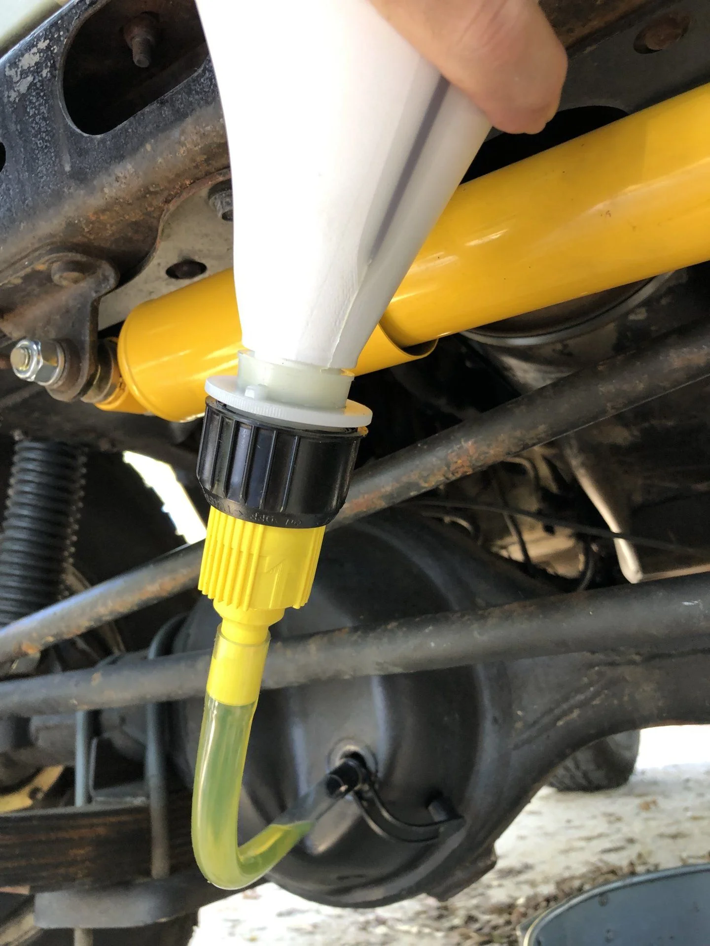

cheap ones work just fine. I have this style and the pump style...no issues at all.
