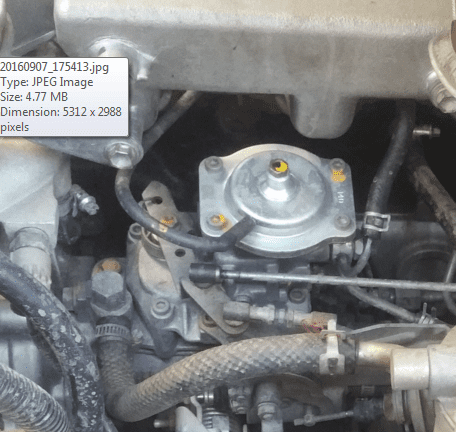

No worries above is a pic from the Gturbo tuning guide that Gturbo provides as a example of what a modified pin should look like when done correctly. I have mine looking as close as possible that i could get it.
Have my car booked in on there rollers in mid April for a full dyno tune and will provide an extra pin i purchased for them modifiy if they are not happy with how mine turned out.
I'm looking forward to the results an will post what my car puts down with the auto box, 35" muddies, AWD, safari snorkel an stock air box.
that's how mine is, but the nut has been ground to raise the pin with the standard boost comp cap. Now that I have the boost comp spacer its a bit too high (overall fuel pin length too short) so even with the off boost cam adjuster set on max the pin is over the top of the ramp by a few mm
Yeah right i was lucky enough that the previous owner of my car had already played with the pump a bit an installed what i'm pretty sure is a Zexal type boost comp as found on the patrols? this style has lock nut with a threaded rod through the middle which allows a lot more adjustment.

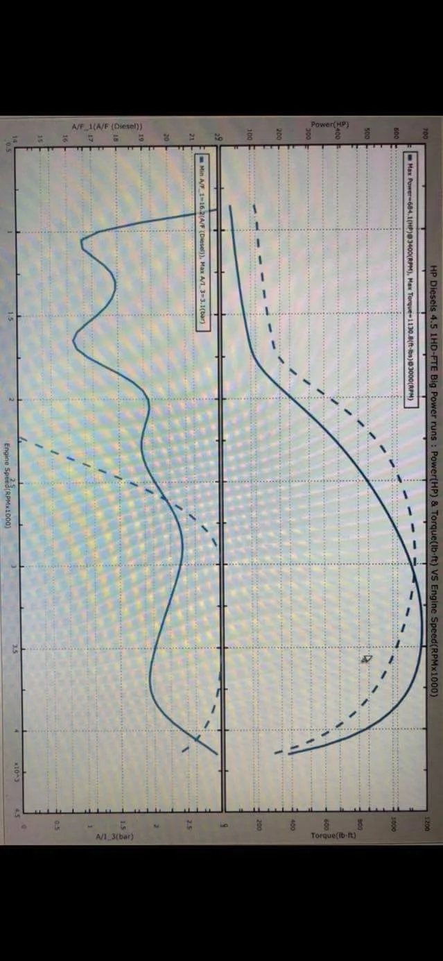

510kW/684whp 1550Nm at wheels 1HD-FTE!!!!!!! Congrats Jim for the effort and inspiration and Mark at HP Diesels for building a sweet engine (HP Diesels 1HD-FTE 4.5 stroker). All on 37 degree day.
We believe a record for a Landcruiser Diesel engine in Australia? Not sure, but we just punched out 2 runs at 510kW/684hp over 1550Nm at wheels in 4WD on 35” rubber.

We ran out of fuel on dyno so stopped for today. Will come back in a few weeks to see if we can crack 750hp..... we think it’s realistic.
Run was done conservatively - we could easily bring in torque 400rpm earlier and 15% greater. Clutch is having some issues though (1600Nm NPC).
Engine sounds awesome on dyno
Next stop the mighty Toyota 4.5 V8. Easy to get similar results with direct bolt on turbo.
Ignore the boost graph - sensor had error
Regarding dyno;
All wheel drive, no weather correction factor (37 degree day)

The same car did 484rwhp without the water/meth and NOS. Super impressive especially considering it's single turbo!
