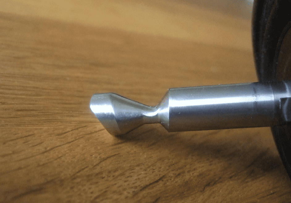

The pins are made from hardened steel.
Theres pics of pins floating about that show grooves rubbed into the aneroid pin by the little pin that follows the taper.
So you don't think spinning up a blank to grind a new profile will work? It can be beat tempered when complete. I have seen people grinding down the stock ones but I'm not that brave. I would rather make my own but if the gains I'm after can be achieved by just rotating the stock pin than that's the route I would like to take
I have not done it but I can't see why you could not do it. As mentioned it will need good casehardening heat treatment once done to prevent wear.
Depending on the boost your planning on running, I think even the stock pin will require mods.
Lumpskies pin looks a little different to my 1hd-t pin. Mine was early 1990 though, so they may have changed
@vwluv10338 If you can case harden after machining, I dont see why not to make your own blank. The stock pin is fairly highly polished

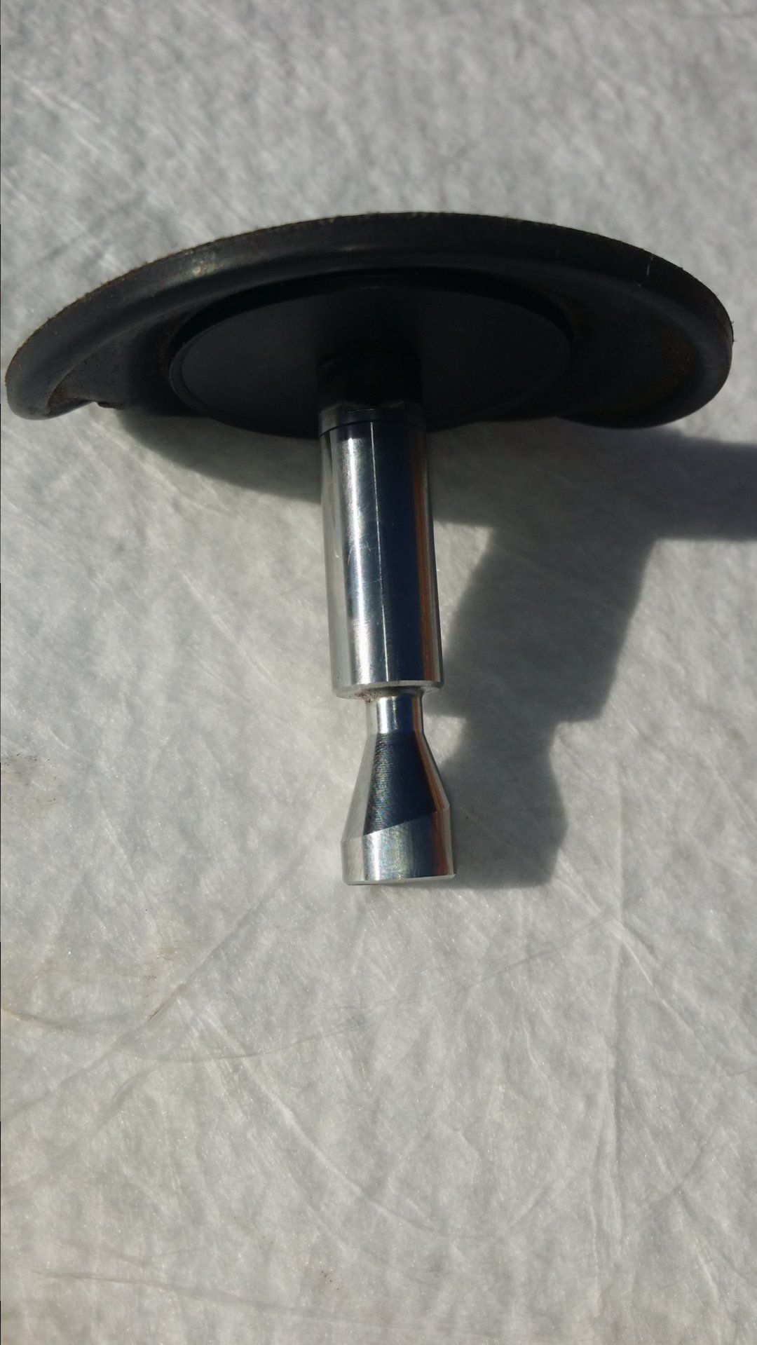

Here are a couple more pictures of my pin, in case it helps... I'm curious if you guys think it's stock or not. And if it's not, what is it?

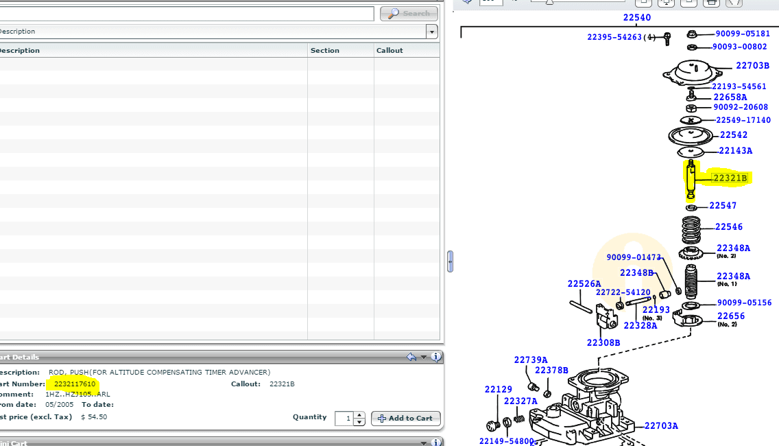

Sorry blank post! I'm trying to upload pics but failed. Anyway aneroid pins for the HZ 105 with the altitude comp style pumps can still be purchased and can be easily modified to suit the extra fueling required for the gturbos I currently have one in my car an it provides more then enough fuel once the correct groove is ground into it.
Part number: 2232117610 about $55 aus

Thanks Grevis, I ordered the rod and a diaphragm $98aud, wasn't showing as available from Amayama but the local Toyota dealer could get them from Japan
