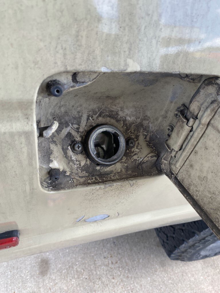

My gas cap key cylinder seems to have snapped, then some plastic things fell out of the side. I could just buy a new cap, but it seems like maybe the metal thing where the cap sticks in is bent. I'm not entirely sure.
What should I do? What are my options?
If y'all think I should replace more than the cap, is it hard? I think my local mechanic would love to never see me again.
If I sound stupid, it's because I am not familiar with this at all.

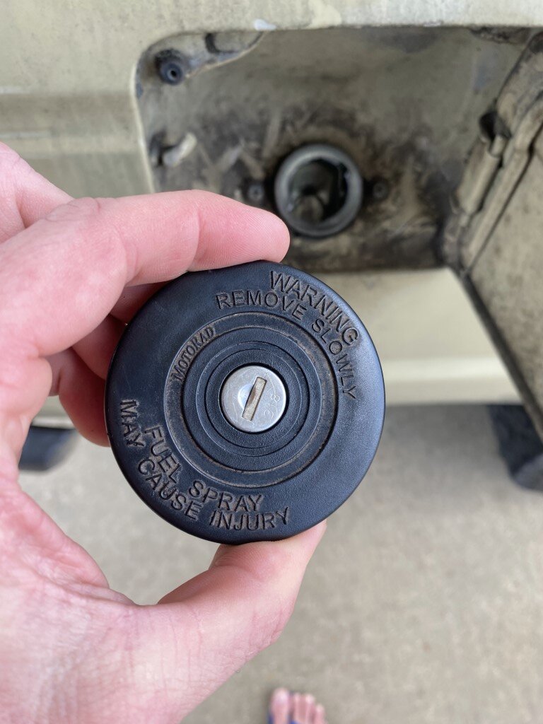

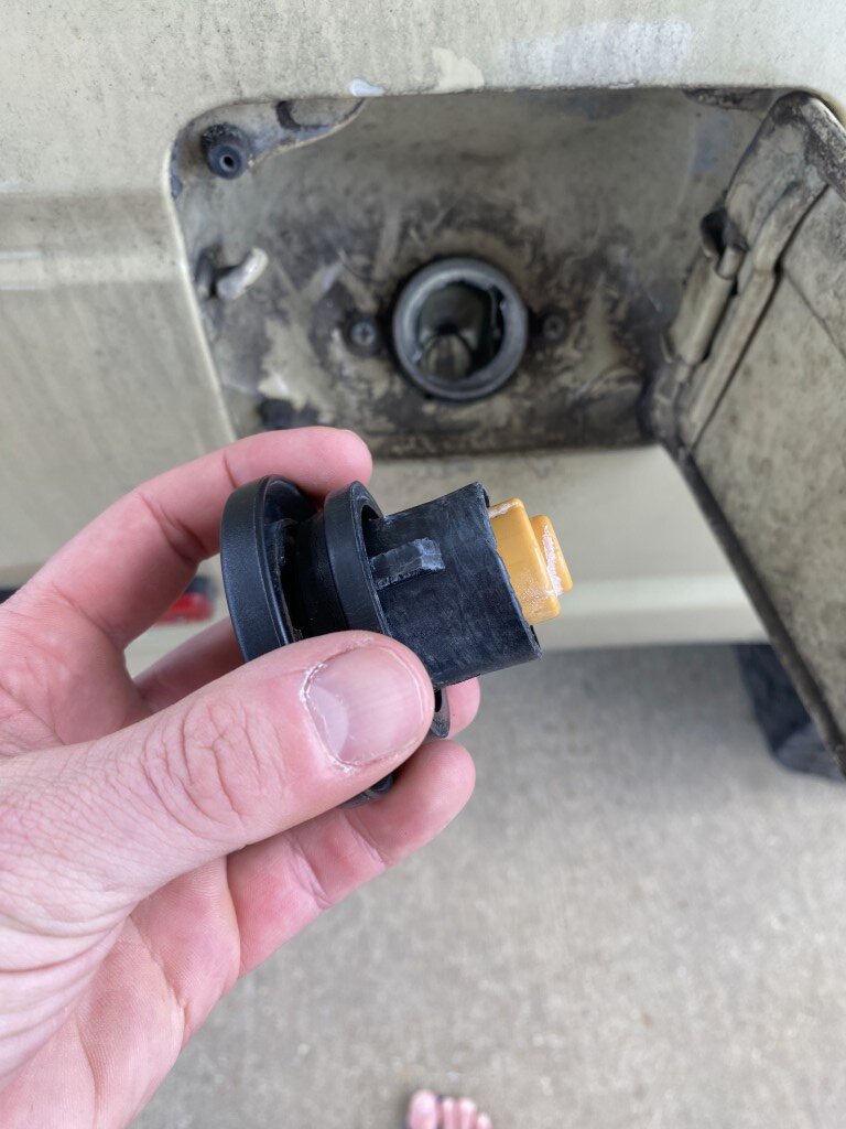

I used to use one of those locking caps and can say with complete confidence: THEY'RE JUNK. What happened is the tabs that hold it in place and retract when you turn the key broke off, so now it just can't secure to your fuel filler tube. You can, however, get a non-locking Stant fuel cap that'll work well.

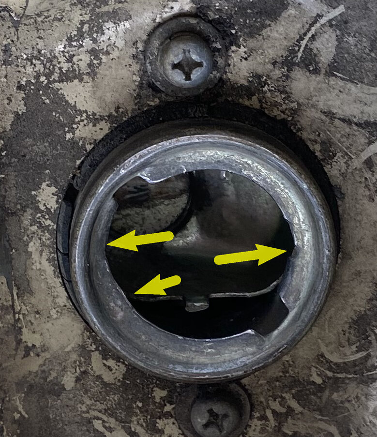

I don't care about locking at all. Do y'all have any opinions on the apparent bending of the opening into which I insert the cap (as shown in the pic with yellow arrows)?

@partchanger the ridge in your filler tube looks okay from the picture. Looks like you're just seeing slight wear where the lock tabs of that other cap would slide over when it's put in place. Here's a link to an OEM non locking cap from Cruiser Corps: Gas Cap / Lid - OEM - FJ40, FJ45, FJ55, FJ60, FJ62, BJ 1980-1990 - https://cruisercorps.com/collections/gas-caps/products/gas-cap-lid-oem-3

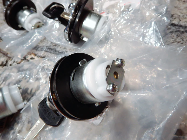

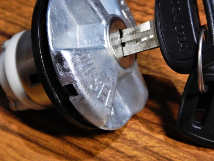

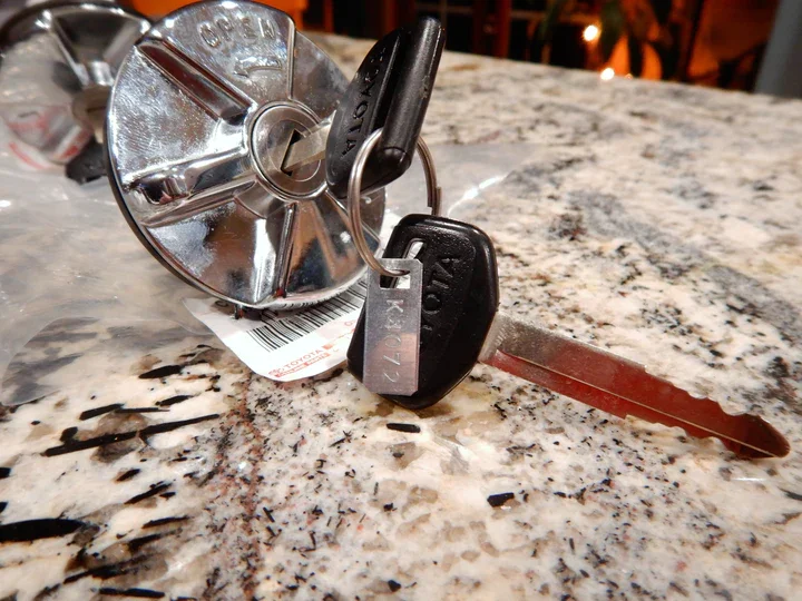

this is IN FACT a FJ60 FJ62 OEM toyota NON-=USA genuine parts locking gas cap ,
- some 60's series did NOT have a locking fuel door , hence the locking cap
i can AL:SO NOW re-key it to match your factory K- SERIES code
- i DO have also HJ and BJ DIESEL variants too ....
- TECH VIDEO = it absolutely does indeed exist ... :cool:
