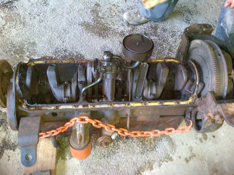

took the engine out today. what a pain. I kept pulling and the engine, transmission, and transfer case all came out at the same time. It was heavy. I couldnt stand it any longer, so I started tearing the engine down to see what was freezing it up. The cam looks pretty good, nasty, but good. The oil pan was 1/2" deep in crud, but no apparent metal. I took all of the rod and main caps off and there was nothing more than some slight corrosion on the crank. I think .010 and it will be fine. My problem is getting the crank out.
1.)How do you get that plate that goes around the crank timing gear off? THere are some huge flatheaded screws in there, but I could not get them to budge. I broke a gear puller also, trying to pull the gear off.
2.) The clutch......how does that come off. I scratched my head a minute on that one. I have never taken one off before, and with the engine out and upside down on the floor, it is not really intuitive on how it detaches itself from the crank. I can lift the crank only a little on each end, but not both at the same time. Any pointers?
Look at the oil pump, please. Tell me if you think a 2F will work on it.
Thanks.
Thanks.
1) loctite freeze and release, then hit with impact drivers. if still nothing, then heat with torch and then freeze and release again
2) you will see some bolt heads near the original bottom of the bellhousing, now top, unbolt those. the issue will be getting to the ones you can't get two while engine is frozen. with the caps off the rods and mains, you will hopefully be able to turn crank/flywheel/clutch and get the other bolts where you need them to be to get them off.

I have isolated the source of the locked up-ness of my engine. It is the pistons frozen to the sidewalls. The cam turned freely once separated from the crank, and the mains and rod bearings were all loose, albeit some mior corrosion on some. However, I cannot move the rods enough to turn the crank. I am going to hammer the pistons out or break them. Either way, they must come out, and will not be reused. Then I can turn the crank and get to the bolts you are referring to. I just hope the pitting is not beyond boring out. I will find out soon enough. Thanks for the help.

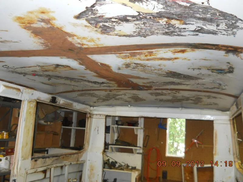

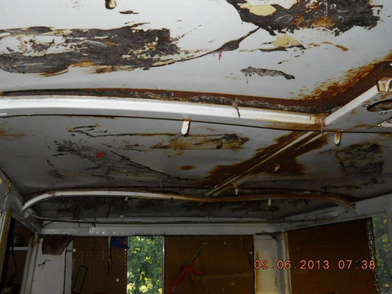

We have been working on the roof too. I will be adding two more support ribs, but I really need some stiffeners for all of them. Any suggestions? I was thinking 1/4 " square tubing molded to the curve of the roof and welded on the inside channel.

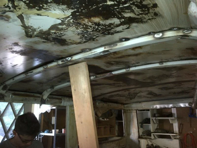

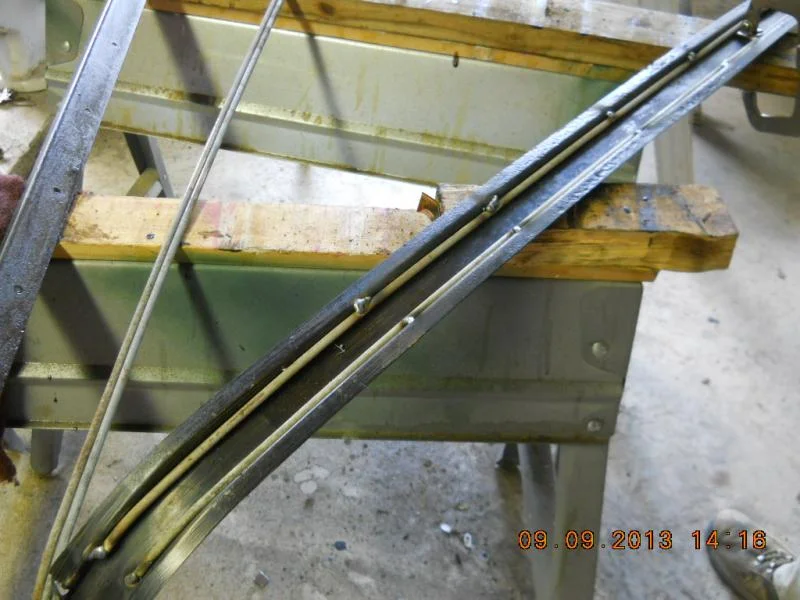

Friday, we removed the roof ribs, and corrosion proofed their tops and the roof. This week we are adding stiffeners to them, and welding the two originals plus two more in. No roof rack is going to cave it in again. We will also, weld up the pillars and cut out the rockers so that I can see how many floor supports I need. Once I have that done, it will be time to get with bobm.
Anyone with tranny experience? I know that the Haynes manual makes it look easy diasaembling the transfer case and transmission. This is something I have zero experience in. Should I attempt it or should I get a professional to do it? The inside of the transmission is clean, and no evidence of broken gears or corrosion. I want to replace the seals and bearings just so I know that it is done, and will not need it. Anyone else done this?
Body work begins
Well, we are getting serious about making the pig good for something! We started with the caved in roof system by taking out the original two ribs, reinforcing them with healdiner rods, welded in, and then putting four of the ribs back in the ceiling. Should be pretty stout. I am very pleased with how supported the roof will be when we are done.

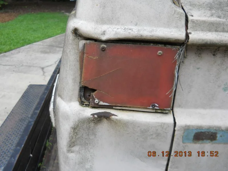

The DS rear tailight has been giving me heartburn since I saw the dent. Turned out to be a piece of cake. Look at photos. Used screws, crow bar, wooden block, welder, and a grinder. We have the first layer of bondo on now.

roof rib bracing
I thought this was an ingenious idea since I had an extra pig's worth, and have no intention of installing a new headliner. What do you think?
