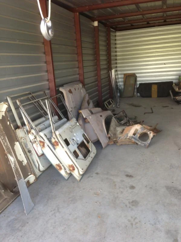

I've got your glass covered. All but the windshield.
Edited: I see now that the pic doesn't show stack of glass...but it's there.

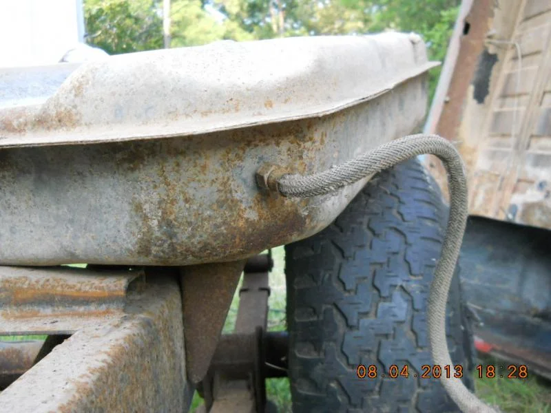

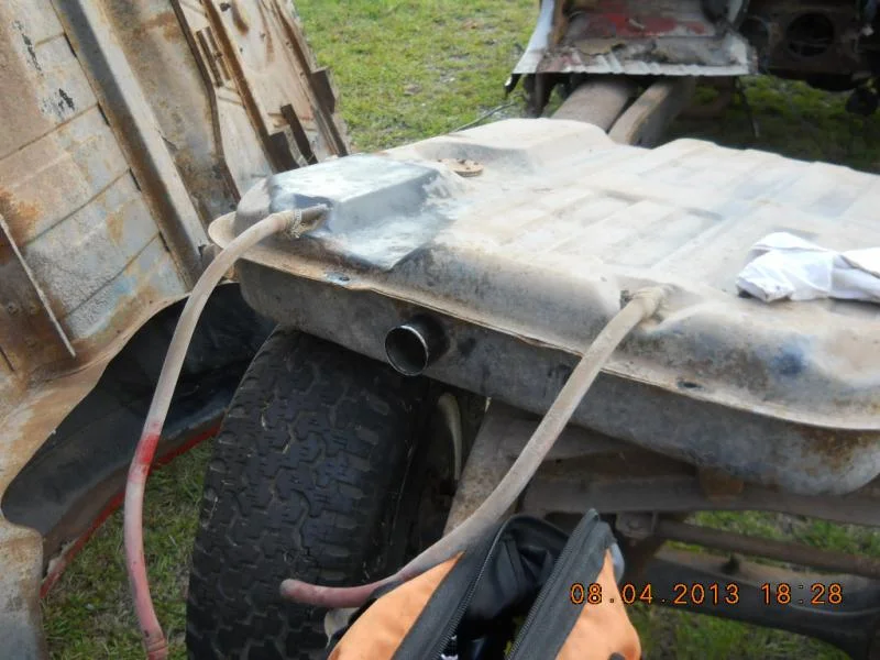

I hope no one had sentimental attachments to this pig....notice the fuel tank with only two vent ports. i cut the DS rear panel around the taillight, since mine is bent on the grove, like someone backed the taillight into a tree. i may try to weld in a patch for that. I also cut out the B pillars, since mine are rotten. I got a good underside look at the pig also. They are not too complicated, now I understand what bobm was talking about. I thinking about getting this frame sandblasted and painted, and being done with it.....Oh well, Nik's old pig died a slow death, but parts of her will live on in multiple other pigs.

It appeared to have two vent lines to the filler neck, and then a single line to the fuel pump. This is a lot simpler design than the setup with all of the hoses going to the emissions, etc. I still think, that I am going to go back with the stock setup for the 73/74 model. Mainly because I have the tank ready. However, I am not convinced that the emissions compueter and all of that is still operational. What would you guys suggest?
