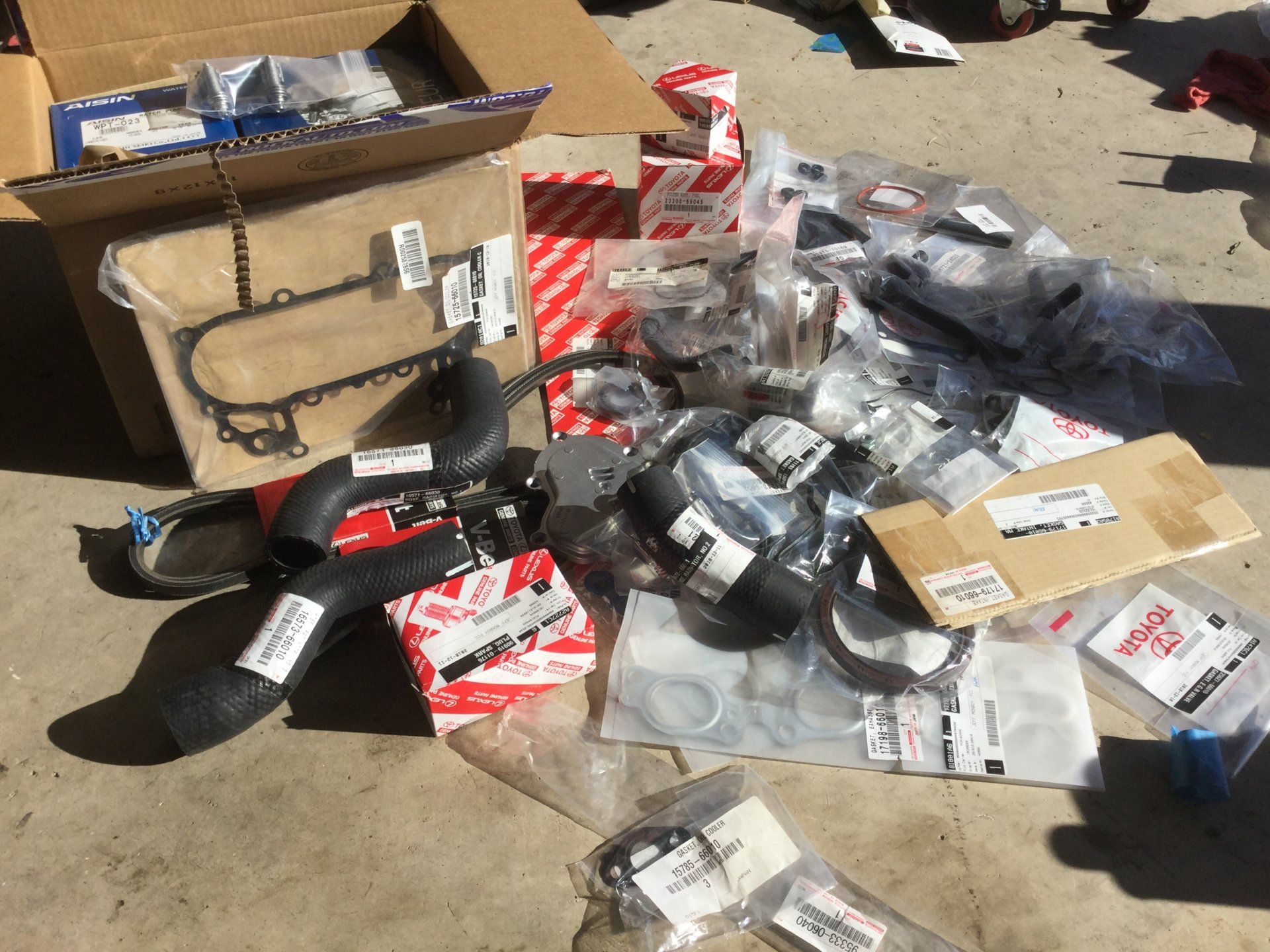

Freshening up the 1FZ before it goes back into the frame. Replacing every gasket, seal, hose, grommet and belt with all OEM parts. also replacing the water pump and AC compressor (Aisin, Denso)

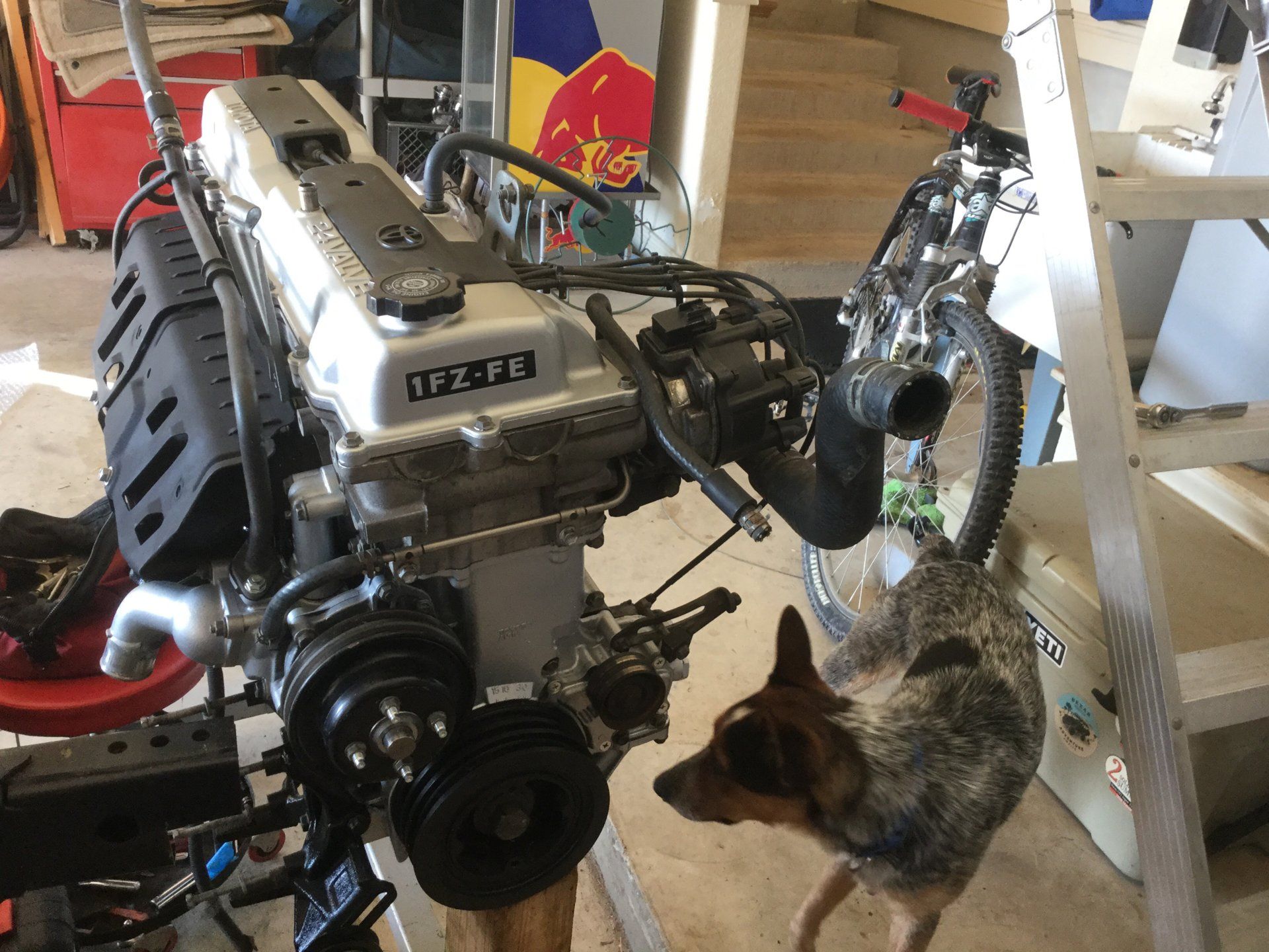

Almost done, waiting on new knock sensors then I’ll put the intake back on. Should be painting the frame next week.
You bringing it to SAS3?
Motor done, just need to swap the top of the AC compressor and install the belts.

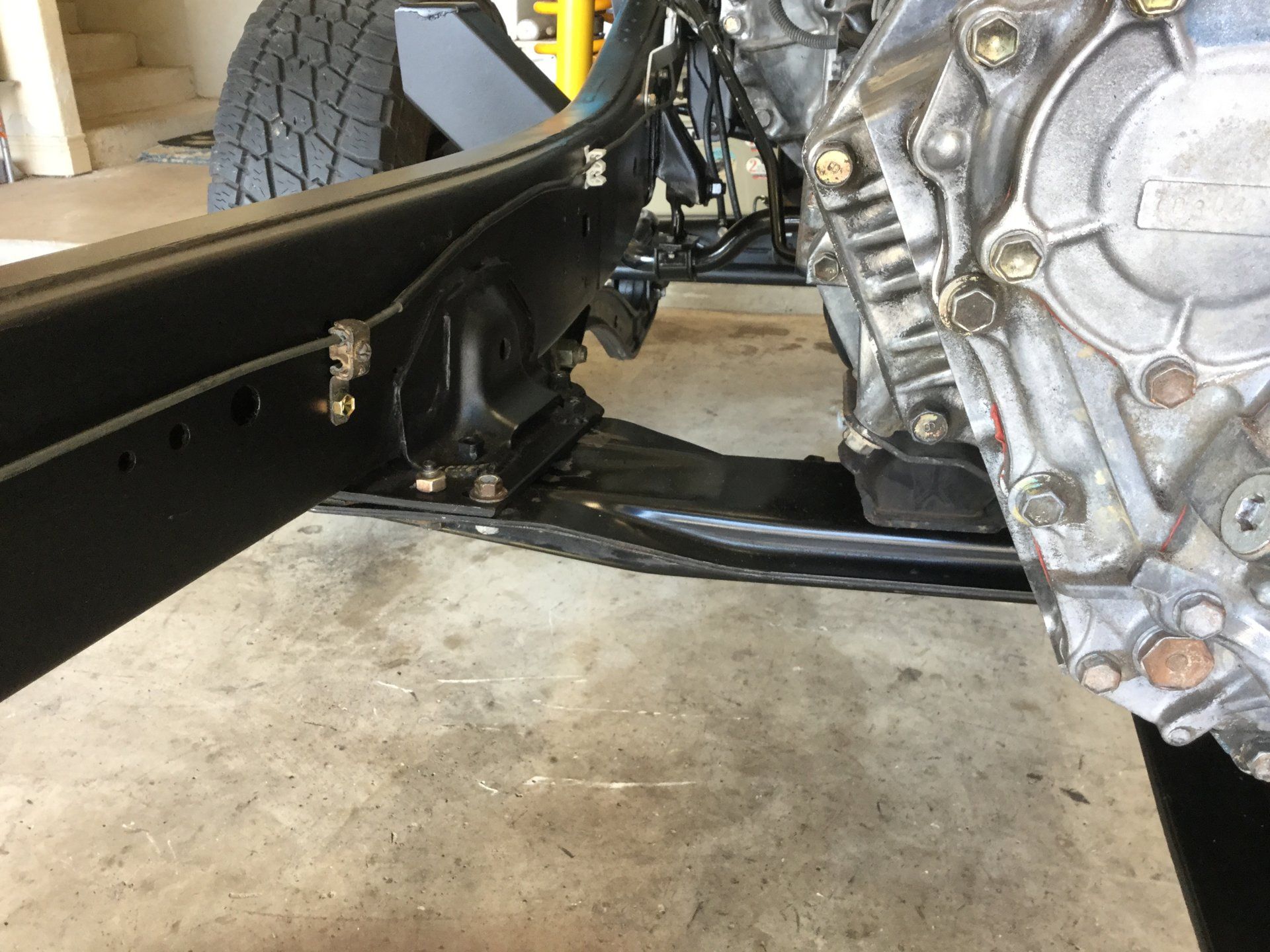

Update time:
Painted frame and axles John Deere Blitz Black then assembled chassis.
New OEM Parts
All soft brake lines ( including first gen Tundra extended lines)
Brake line mounting tabs
Non ABS front hard lines
5 new FJ Cruiser steelies
All lug nuts
Rear locker guard
Most hardware
New aftermarket:
555 tie rod ends
Bilstien shocks
OME stabilizer
Ordered new starter and OEM power steering lines today. Sending off the drive shafts and mounting the fuel tank this week.
