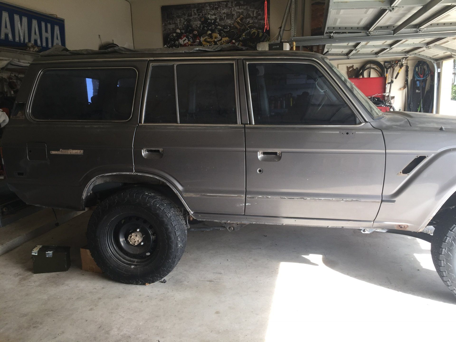

I will need to look to see if I have some pictures. I removed the 4.7 inches from the section of frame that is parallel by removing the weld from the front section of the LCA mount then plating it both inside and outside then rewelding the LCA mounts to the frame. very clean looking and done on a frame jig to make sure it was dead on square.
Been a slow process with other projects that keep getting in the way. Still collecting parts, have almost everything now.

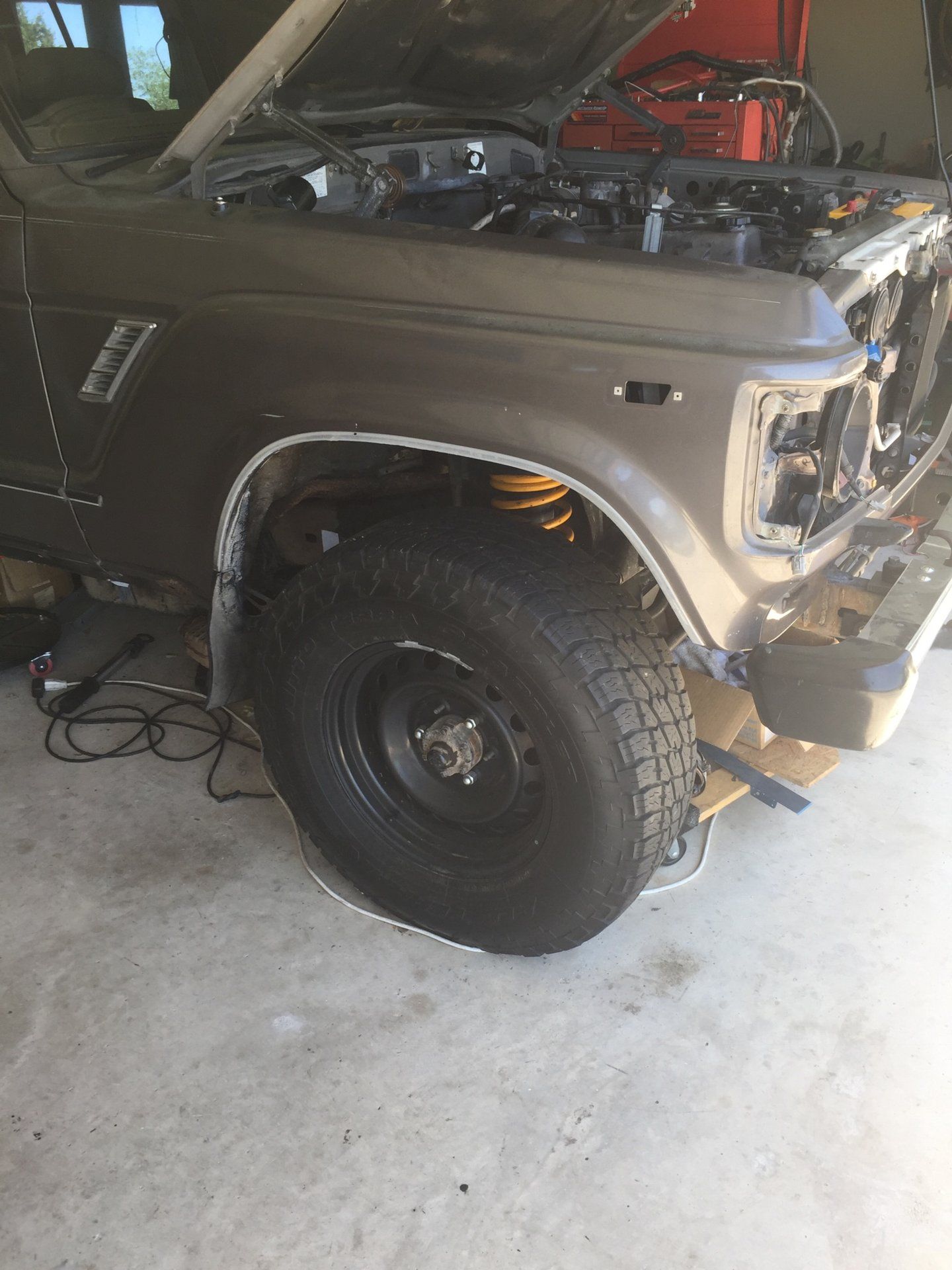

Cleaned up the heat shields ( you can see the frame modification point at the LCA mounting bracket)
Using stock exhaust brackets and figuring out the routing.

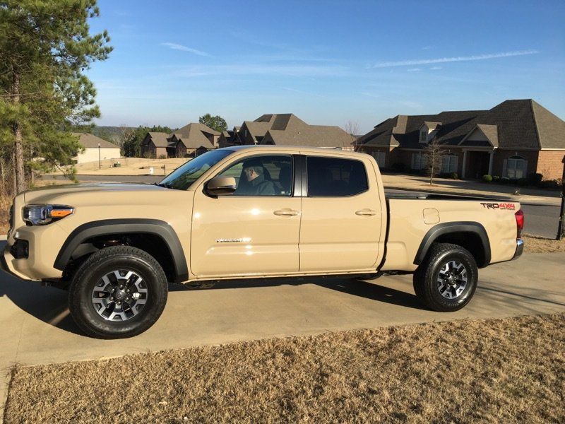

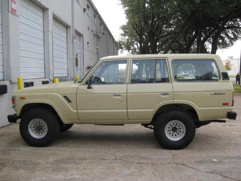

Need help in choosing a color, 1987 FJ 60 tan (464?) or 2018 Quicksand
Id vote for the tan. I guess your off the cement gray from the new Tundra your driving?
