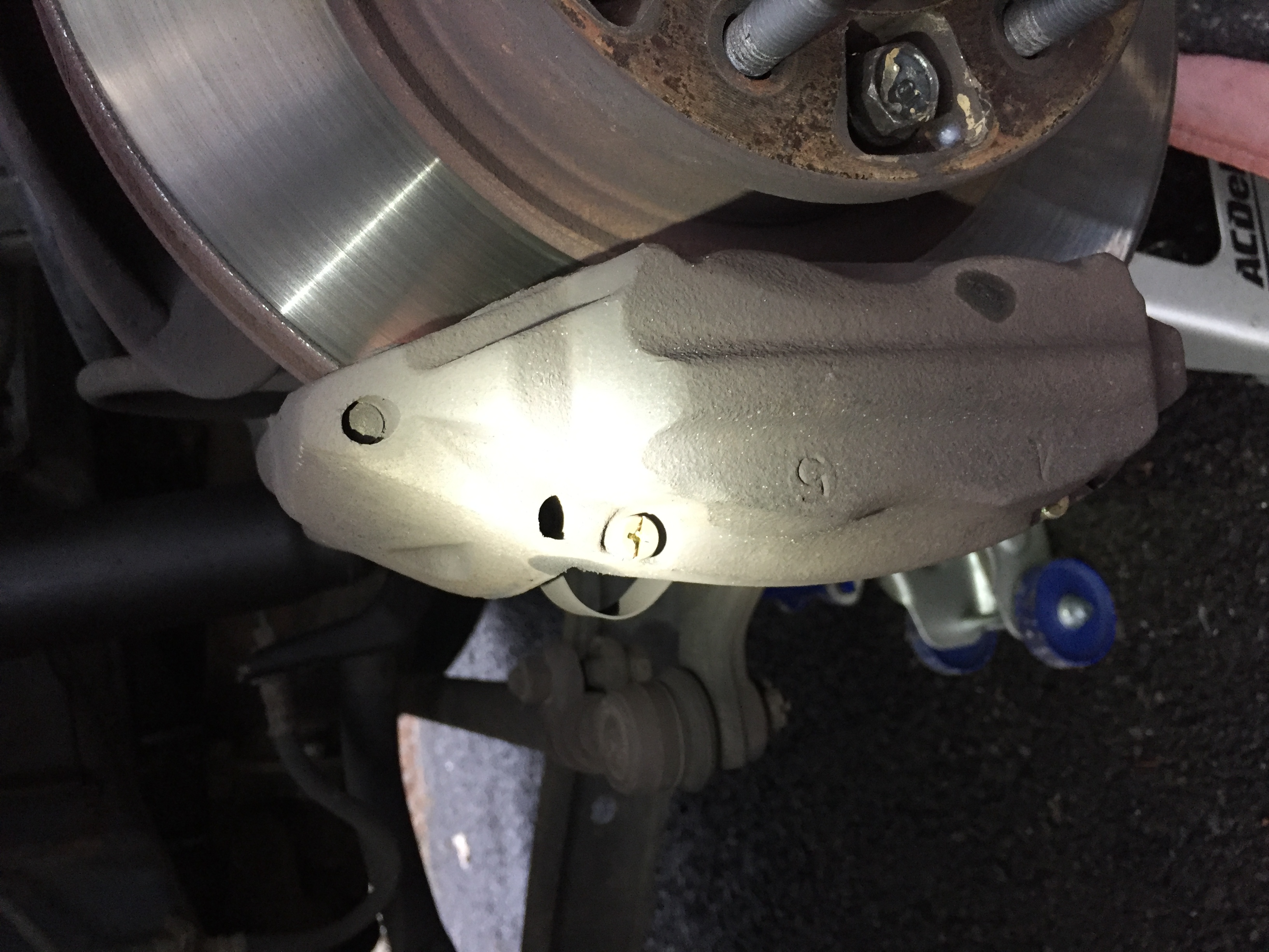

OK Ladies and Gentlemen; I finally pulled the wheel off this thing. The noise and pull seems to be coming from the passenger side, so that's the wheel I pulled. Near as I Can tell, everything seems to be in order.Prior to pulling the wheel, I gave it a good push/pull and there seemed to be little to no movement in the bearing.
The rotor and caliper are in good shape. All of the fasteners are secure.

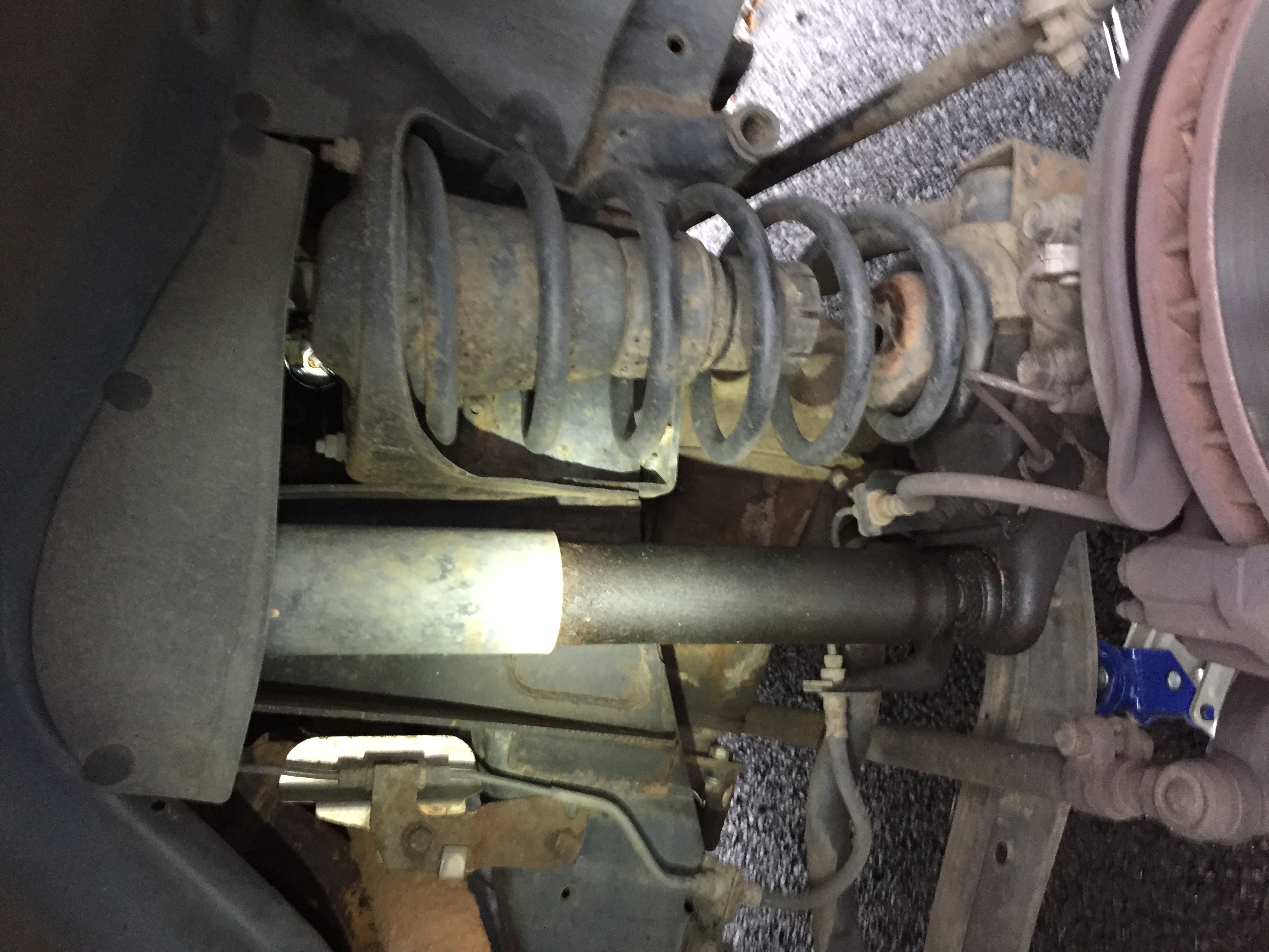

I did notice the Shock Absorber seems to have shot is load:

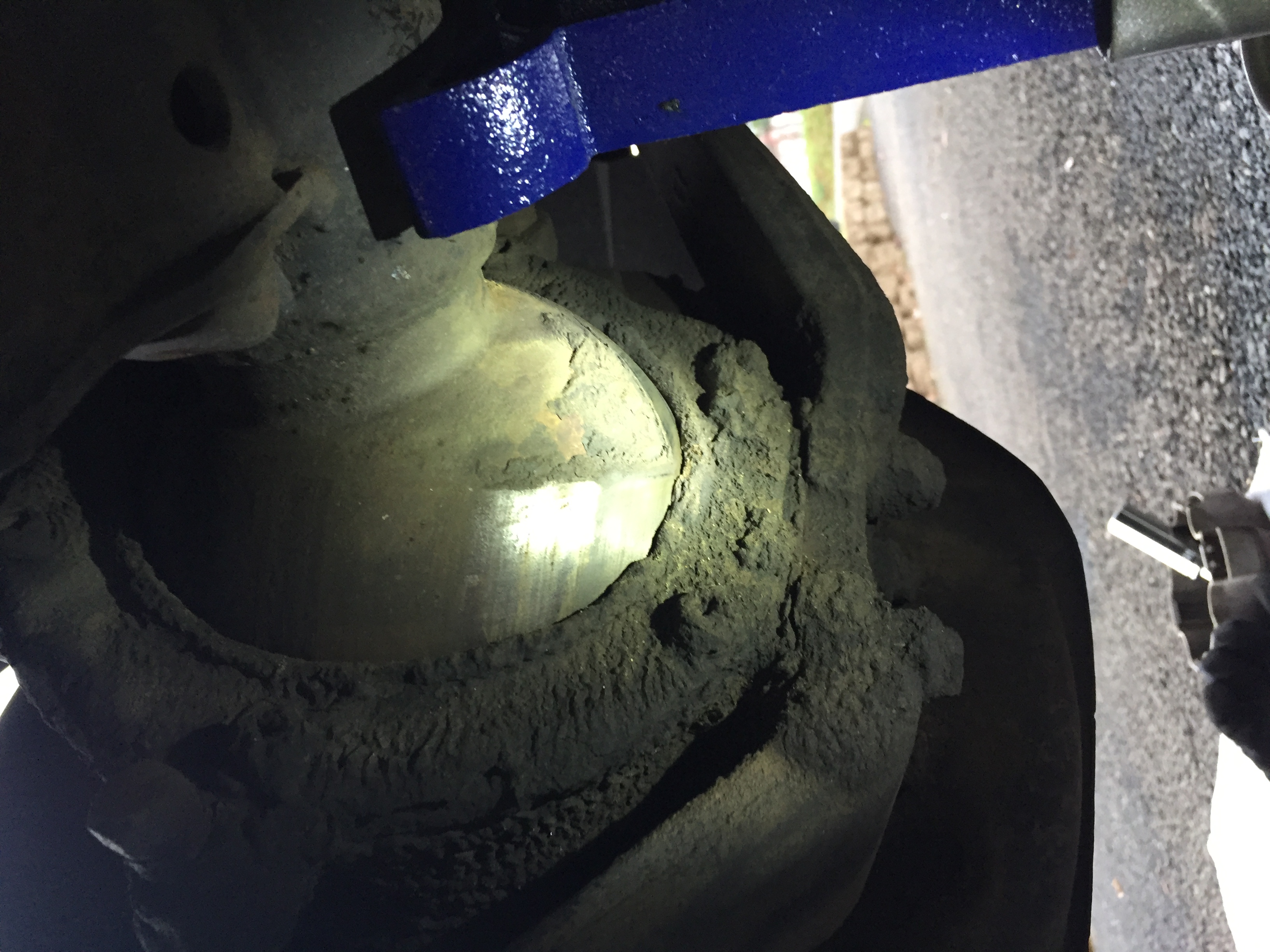

I also checked to see if there were any rub marks inside the rim, but it has an even layer of filth:
There were no obvious signs of problems on the birf/axle. Although it did look to be a little on the dry side. Is it possible that needing to grease this joint could cause the noise/grabbing?

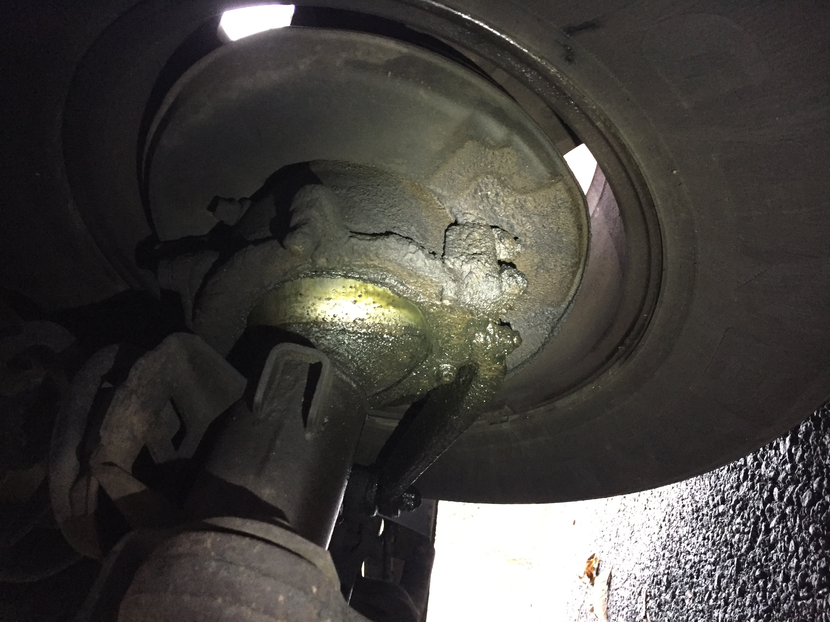

In other news, I noticed the drivers side was WET while I was under there. This can not be good:
Aside from being completely filthy underneath, do you see anything out of the ordinary?
I am thinking degreaser and a pressure wash is in order. Aside from that, what would my next steps be?

axle needs a rebuild but your grinding sound could still be something on the outside
I had the rivets on a brake pad completely let go and the friction material exited the scene. Made an inconsistent grinding noise. You may need to pull the calipers off to check but that was what caused a similar sounding condition for me :beer:

Outer and/or inner axle seals are leaking. Its not a hard job but it's messy and takes some time, spend some time here researching it and get a complete kit from one of the vendors on here (I recommend Cruiser Outfitters). I dont know if I would take it on as a winter driveway project, keep the front diff full of fluid and wait until the weather is warmer or you find a place inside to work.

I'd just pick a weekend and rebuild, axle seals bearings , and repack birfs, if that grinding sound is a bearing it can fubar, the spindles and hubs
Lots of good videos and threads out there. I liked the trail gear offset inner axel seals if you have grooved axels from the factory seals. Upgrading the front axel breather will help mitigate cross contamination between gear oil and cv grease.
The knuckles need a reseal job. If it's being driven, the more immediate need is lube, leaking seals will make a mess, but insufficient lube will destroy parts. If it needs to be driven, I would put a tube of moly grease in each side and see what that does, may need more. Also check the diff fluid for contamination.
