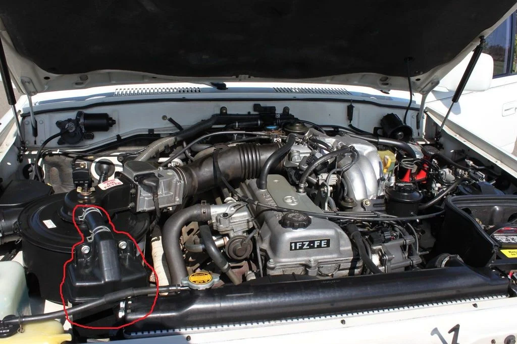

Comparing your original engine bay to your dual battery setup, what did you do to eliminate the silensor?

Is it as easy as rerouting the No. 2 air hose from the air filter to the PAIR valve? I think the silensor's bracket is permanently attached to the air filter lid--did you just cut it?
Oh, and, 1) what's the siren thingie in the top right in the original picture? :grin:2) what's that installed in front of your ARB breather?
1. Removed and cut. Found rad hose at local store that was the size and shape I needed, cut to fit.
2. Alarm that was removed. ARB compressor.
