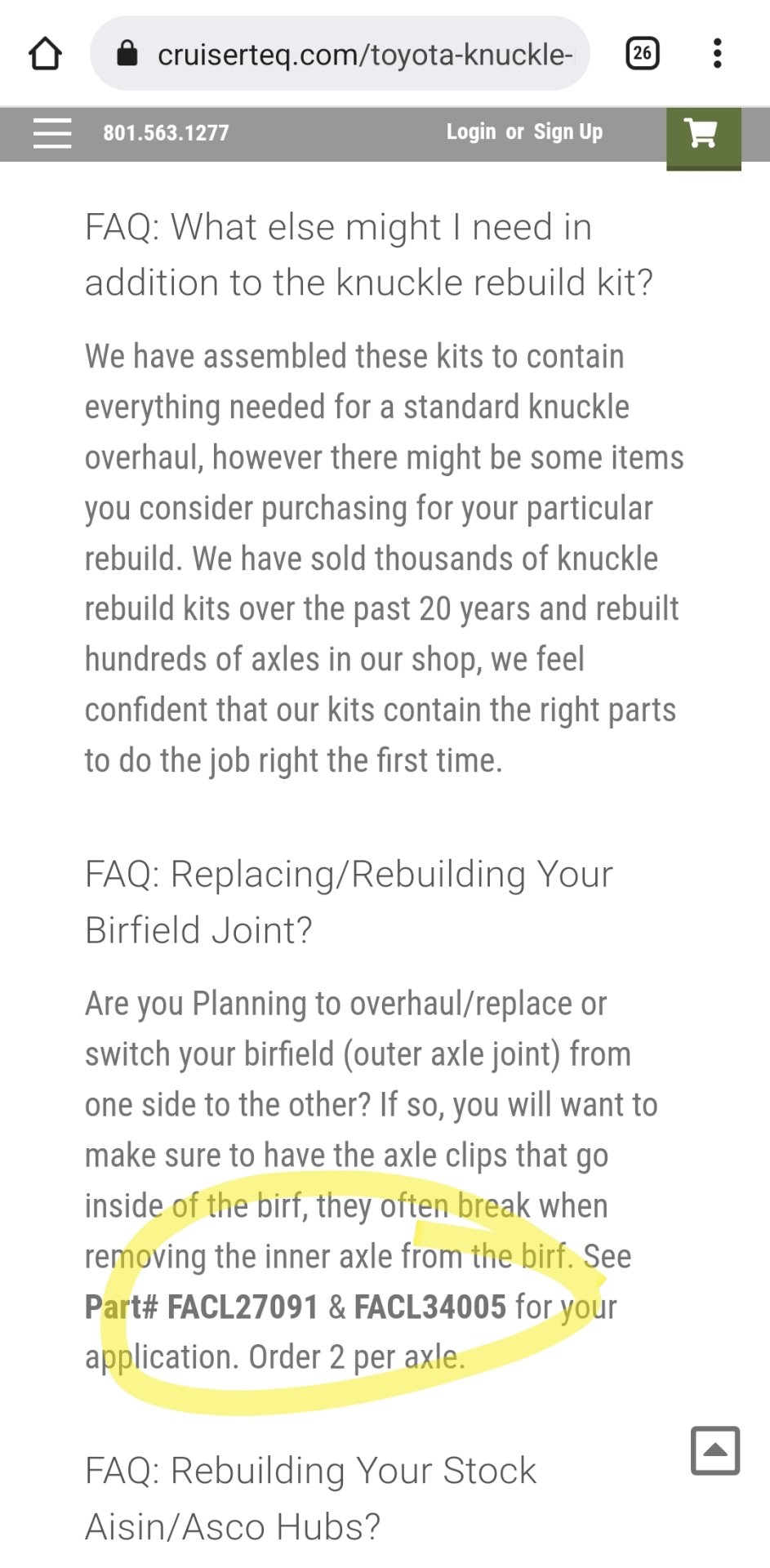

Understood. But the clip is like step 2 of the entire premise of the job (not counting removing the wheel, but after removing the dust cap.)
My heartburn with it is that nowhere is this considered a reusable part, and they even include a new clip with a birf (I know because I ordered two.) I also spoke with them on the phone to make sure I was ordering what I need.
So I get gaskets that I don’t even need but not the axle clip that starts the entire process? It’s not like I wouldn’t have ordered it if they’d just let me know it wasn’t included.

FWIW, snap rings have never been included in our kits nor are they commonly included in any or the commercially available kits sold around the world by many different manufacturers/suppliers. There is no limit to the 'add-ons' that some would love to see on a 'kit' and are potentially disappointed daid item isnt included. We feel that we've curated a high quality kit that covers the 99% of users while offering anything/everything else as needed (with clear photos and descriptions of what is not included).
Fwiw it's my opinion most don't separate their birfs when doing a knuckle overhaul. For those that do, we cover those needs in our Knuckle Overhaul FAQ linked under the FAQ of the FA9097 kit:

Definitely the latter. As in, the clip at the end of the axle. While maybe “countless (millions)” of times have seen them reused, it’s also clearly listed as a non-reusable part in the parts diagram in post 305 on page 16 of this thread. I can’t imagine how any retaining C clip in any application is considered a reusable part. (See also - birfields.) The only way to remove it is to deform it after use by use of pliers. Again, it’s not like this was a stab in the dark. I called and asked the questions I thought were needed and made it clear that I was ready to order whatever was needed for the job, to the degree that some things I had in my cart and ready to purchase were removed based on recommendation. In other words, it’s not like I cheaped out on a c clip. That would have been far cheaper to order than the new flanges and spindles I was prepared to buy if needed And asked about. More on birfields below.

I've pulled birfs out of a lot of axles, and never deformed that clip. It's beefy as hell for the application, its function is pretty clear, and even if it did deform a slight plastic deformation wouldn't affect its ability to function properly. If it is installed, it can't go anywhere with the grease cap over it. I have several cabinets filled with new OEM spare parts of all kinds (axle to differential studs anyone? I keep them on hand, just in case!) but I've never considered buying new outer axle clips.

The only way to install that same clip is to "deform" it with pliers.
It doesn't have a duty cycle of one. As an engineer, I have zero issues calling it a reusable clip. This same finding is exactly why every kit on the market from Japan, Australia, India, etc doesn't include those.
I'll definitely mention it to our sales team to offer up. We dont want people short parts to finish a project, particularly when it's a part (FACL31007) we have on the shelf by the hundred. It's never made it to our FAQ guide for the same reason but it's easy to add and mention. We are very transparent with photos and descriptions of what is included... we will continue to be that way.
Full disclaimer. I don't know that I've ever had someone feel slighted that wasn't included in 30 years of selling tens of thousands of kits? Your absolutely right our "kit" (or all the others on the market) don't cover ever single part that could be needed. It's legitimately not on the 'top 10' of things we've been told shoulda/coulda been in the kit so I have no plans to add it, rather make sure we add it to the FAQ and sales team education.
The feedback is great and I definitely don't consider it character assassination. Our kits have the same (but Japanese) or more parts than TrailGear/Miku/Karsons/TrailTamer/Driveteq, etc so we all have room to improve in an attempt to cover 100% of the needs 100% of customers may encounter.
I agree about your kits, that’s why I ordered one 😀
I may go ahead and order the tie rod end kit, and I’ll definitely order new axle clips. I personally think that’s a replacement item. Not from an engineering standpoint, but humans are involved. And time - if this was a one owner truck and this was the first axle job and it was an actual duty cycle of one, maybe not. But it’s 30 years old and working on an unknown duty cycle.
