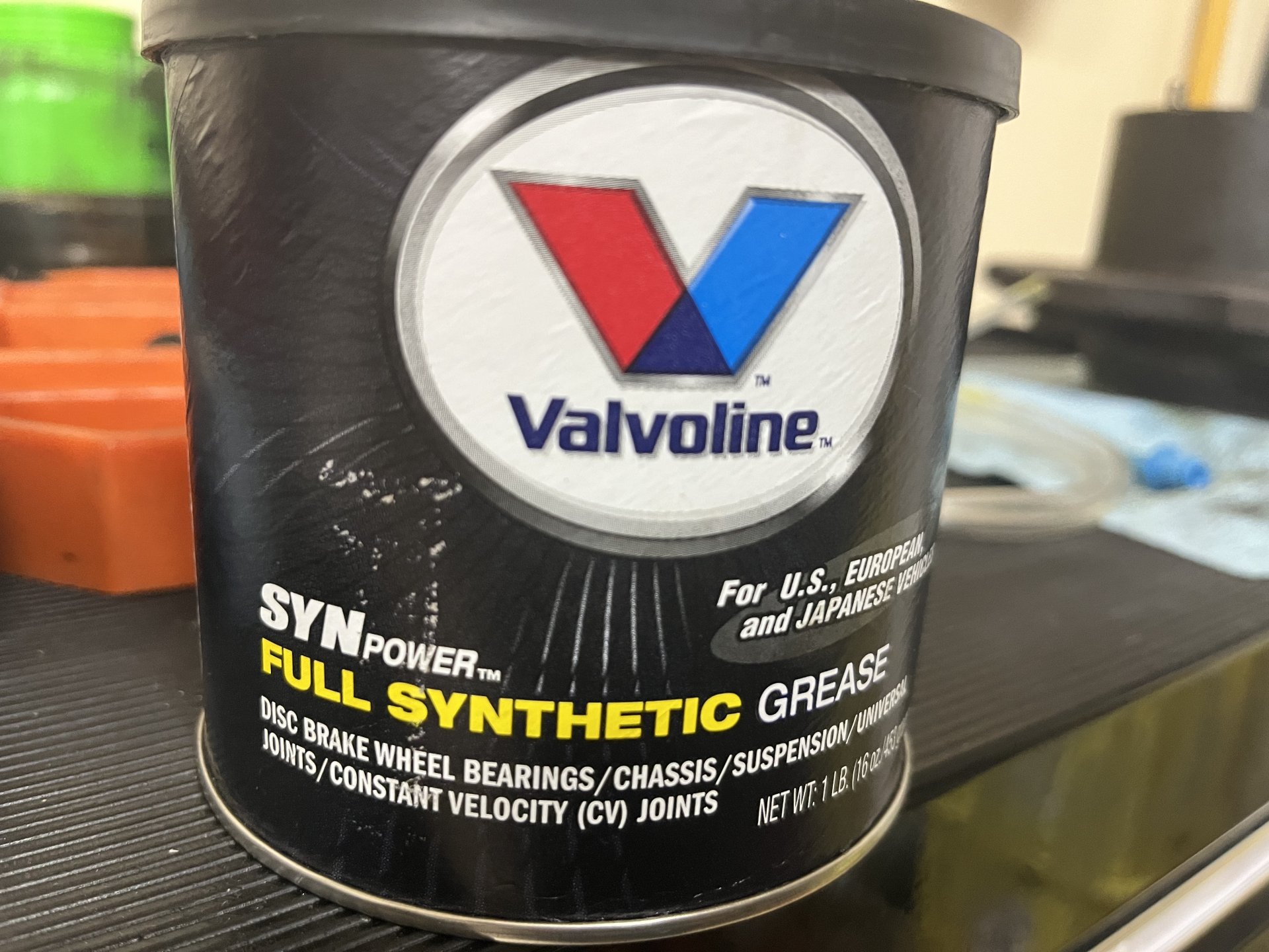

All I can find. FSM says gray grease in the knuckle bearings. Multiple sources call for red (here and the YouTubes.) 🤷🏻‍♂️
I use Red wheel bearing grease on all bearings, knuckle, wheel,
MP, Moly, Wheel Bearings grease is all spect NLGI2, it's all good
Similar to the new factory spindle needle bearings the knuckle bearings are going to be in contact with the gray birf moly.
I searched for Toyota specific MP Grease but then after talking to a oil industry lubrication engineer friend of mine, I understood that the NLGI2 rating means it's all good to mix.
I didn't have any MP grease but I had a whole case of Lucas, red and tacky.
I hope this is helping. If not feel free to PM me
It does, it’s just a topic that seems far more confusing and vague than needed. I suspect it’s just the nature of a 30 year old truck. Not much hasn’t changed almost to a revolutionary level since 1992.
That said, I went with gray moly and it’s done. I agree with the sentiment on bearings being “spinnie” things and getting red grease - but I also consider the knuckle bearings as more twistie things. Load bearing versus speed, so gray makes sense.
If the front end unravels…welp, I won’t do that again hahaha!

That's a really great way to put it. How many people have probably packed their bearings with multi-purpose crease not wheel bearing grease or use the Gray for all kinds of different stuff :hillbilly:
Good job, feels good to know how it comes apart and goes together now right, you are trail ready :flipoff2:

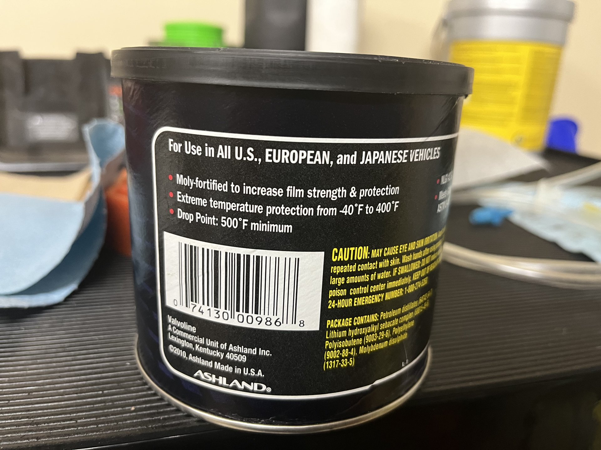

I used this on everything…the birfs, knuckles, wheel bearings, trunion bearings, and quite a bit on my shirt and pants. Did I screw up?
I'm an electrician, not a lubrication expert..... The carton says wheel bearings and CVs a burfield is technically a CV.
I recall a number of old school mud veterans. Talking about the quantity and frequency of Greece is more important than the type of grease.
I'm sure one of the more experienced old school mud veterans will have an educated opinion on this.
I use WallyWorld moly-fortified grease on everything, and my truck hasn't self-destructed yet. Grease has come a long way since 1997, it's not necessary to use different greases in wheel bearings vs. CV assemblies vs. u-joints any more.
