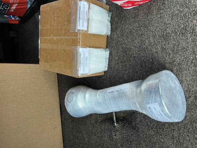

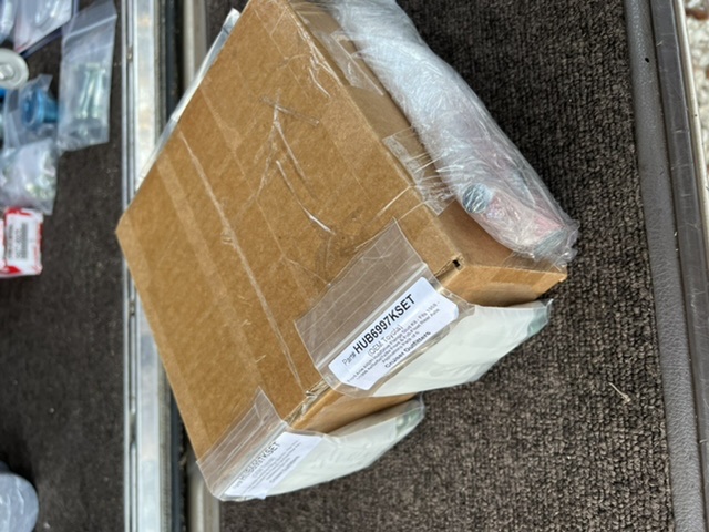

It’s starting…the parts have starting massing in the garage. The winner for packaging as a work of art goes to @cruiseroutfit
The full front axle kit and bearings in the box, new hardware, spring gauge, and Cruiser Outfitter swag all wrapped and taped neatly and conspicuously to the outsides, and two shiny new birfields packaged separately. Nice work.
