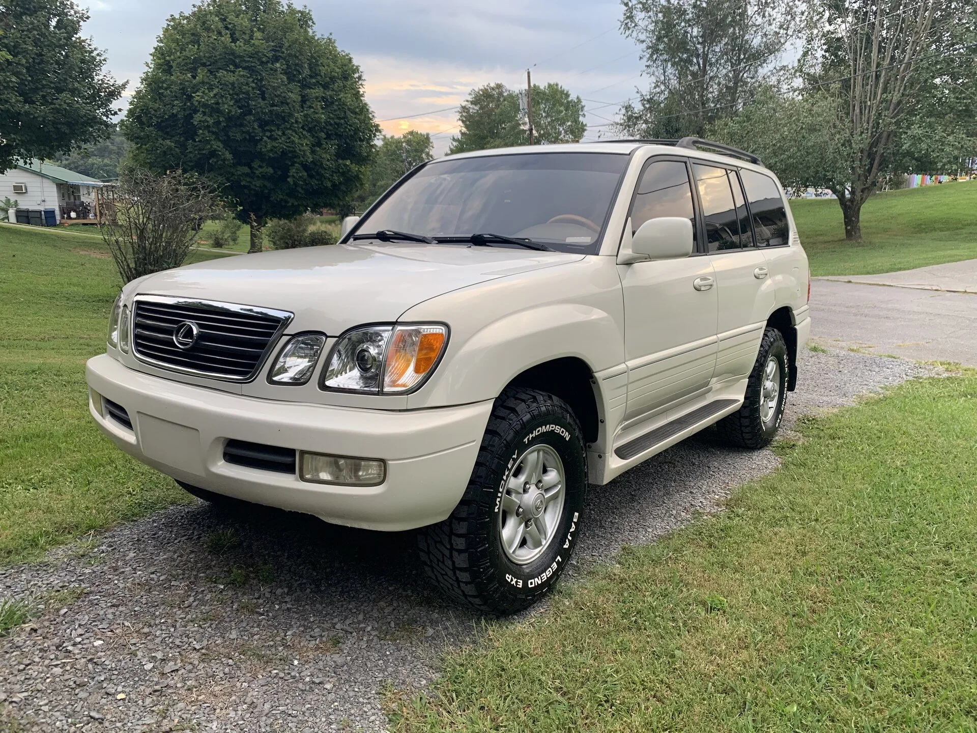

Just gonna start with a little background. Been a Toyota guy for some years now. I work as a parts guy at a Toyota dealership, and generally just love Toyota 4wd’s. I’ve owned 2 other 4wd Toyotas including a ‘94 LC80, an ‘07 FJC, and those are what made me want to stick with Toyota 4wd’s. Last October I ordered a new TRD Off-road Tacoma 6MT in lunar rock. It was so special because it was my first new vehicle and I enjoyed it until this June when a large doe ran out in from of me when I was running 70 mph and ultimately ended up totaling it.

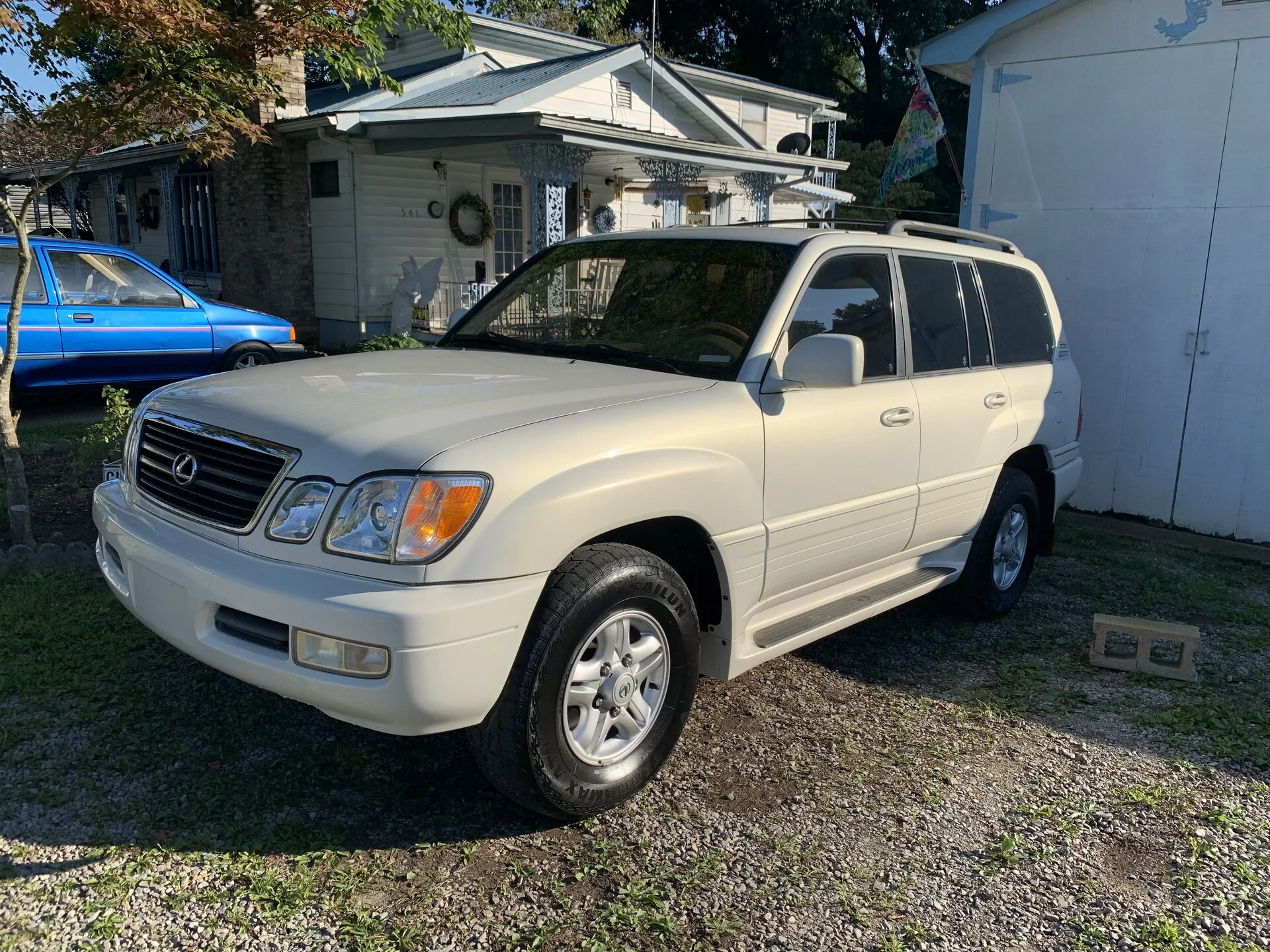

After struggling with insurance for 2 months, they finally paid me, and I took my positive equity to purchase this! It’s a 2000 LX470 with right at 282k on the clock. It’s had a good bit of important maintenance done recently (t-belt, water pump, alternator, etc) and it also looks to have a fresh brake booster/master cyl on there but with no paperwork to confirm. No rust to speak of, the underside is very clean, it’s been southern its whole life here in Tennessee. It needs tires, an output shaft seal is seeping fluid, axles have been or currently are slinging grease, and some misc small parts on the interior. It’s been well taken care of overall, I looked at another 100 a few days ago and it was rolling around still totaled basically. The very worse condition 100 I’ve ever seen in person, but anyway.

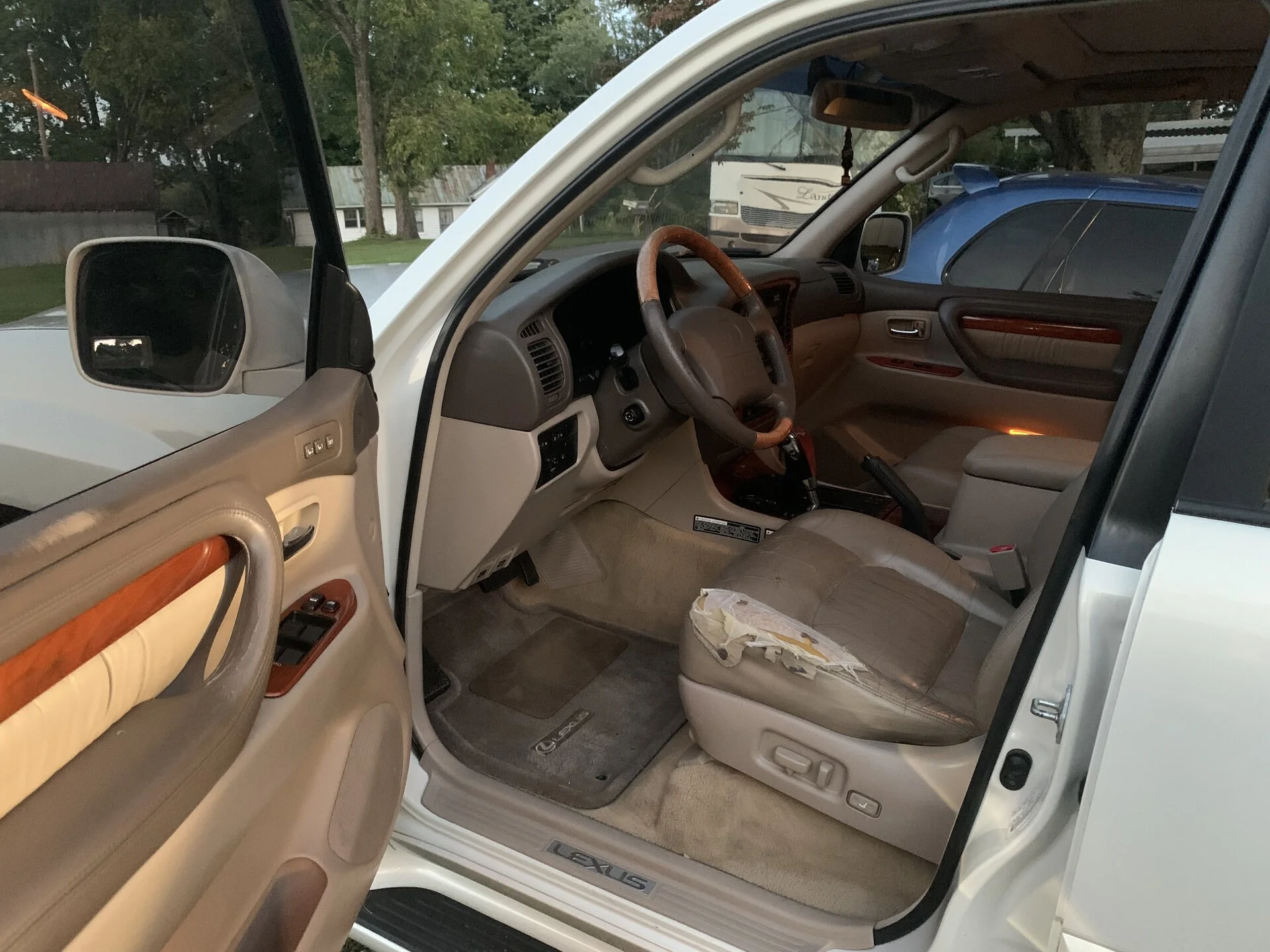

4. The front seats are not in the greatest shape like a lot of these trucks. I’ll end up shopping around the various sites that sell reupholstery for these and end up getting some leather to put back in there. The foam is still in shape and not crumbling so it shouldn’t be too bad of a fix. My neighbor is a retired upholstery man, so his expertise will come in handy when I get around to this!

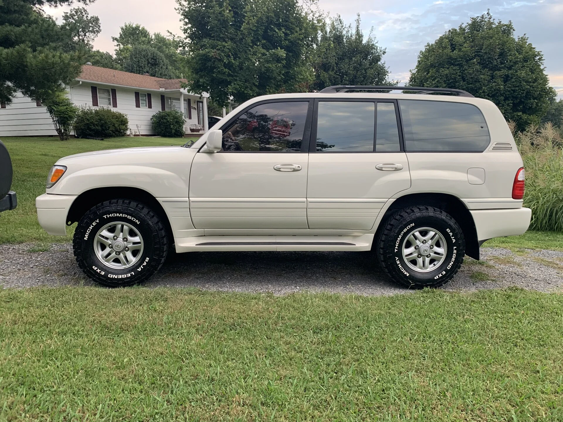

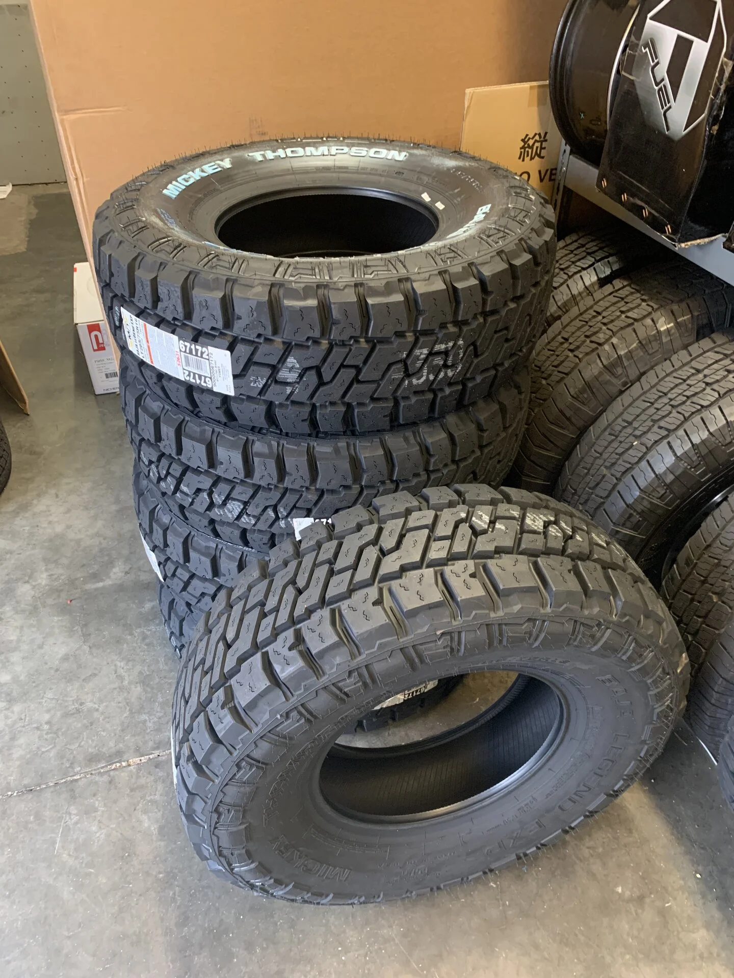

5. The tires are destroyed. I knew this when I bought it, and that’s fine and dandy because I’ve got 5 Mickey Thompson Baja Legend EXP’s in the shop waiting to be installed tomorrow! Pictures will follow.

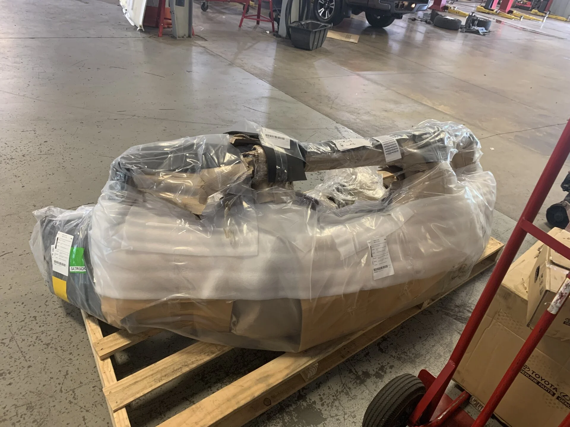

More things showed up!

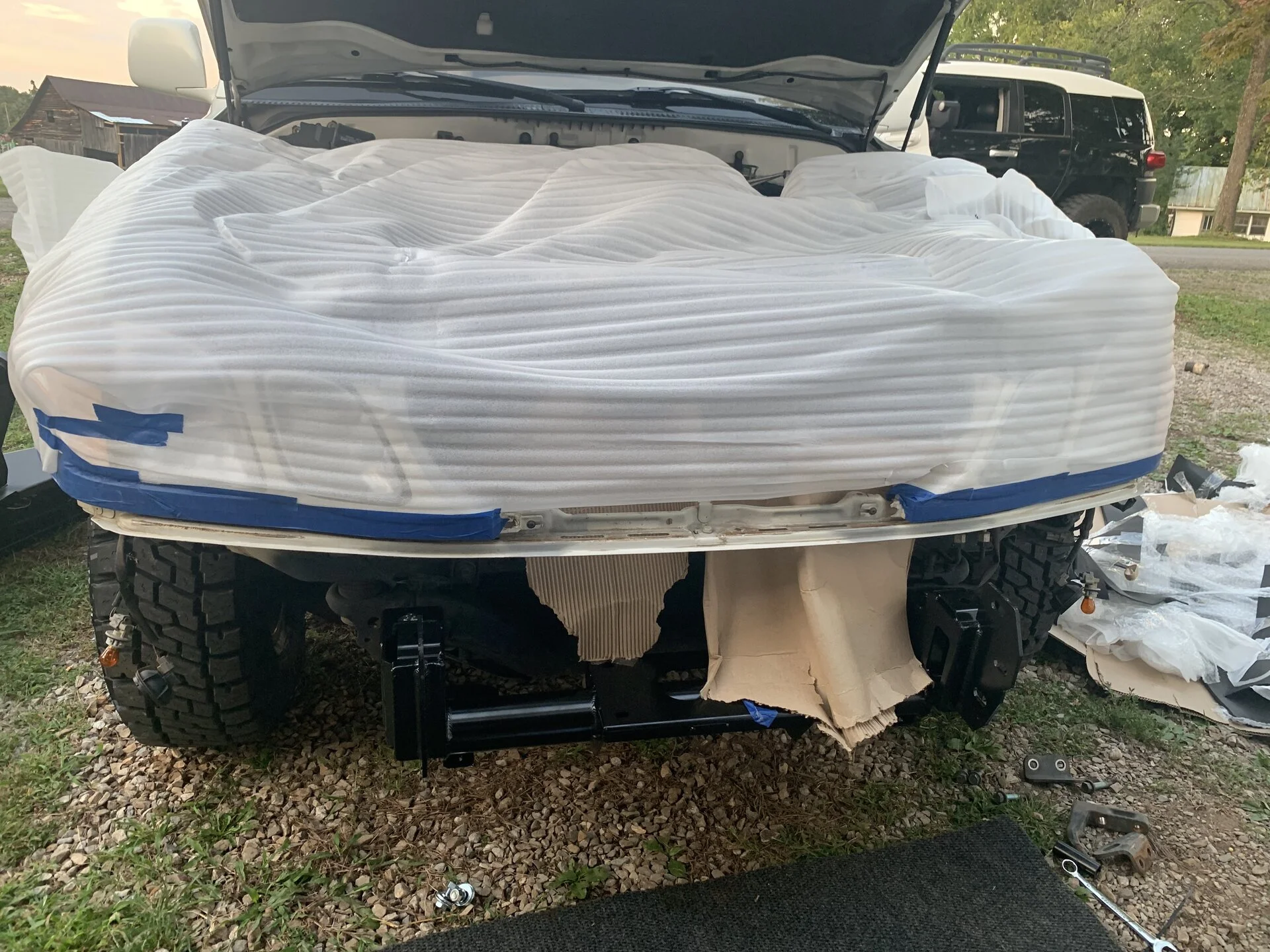

The bumper install will happen this weekend, I’ll be sure to post up pictures of that when it’s happening.

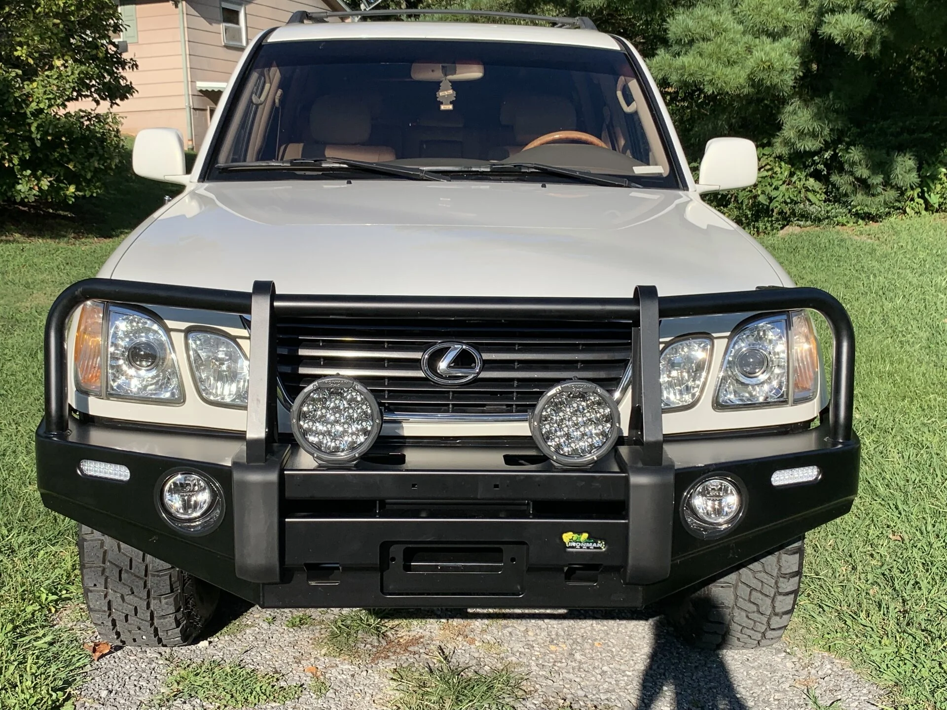

The bumper is physically mounted up, but I didn’t have time to do the fogs or turn signals tonight. Overall it was a very easy install. The hardest part was lining up the crush sleeves really. Gives the 100 a totally different look and I didn’t notice any huge difference in how it drives either, I’m sure that would change with a winch installed in there as well but I digress.
Pleased with the outcome so far, hope to get the lights wired up tomorrow and move on to the next thing!

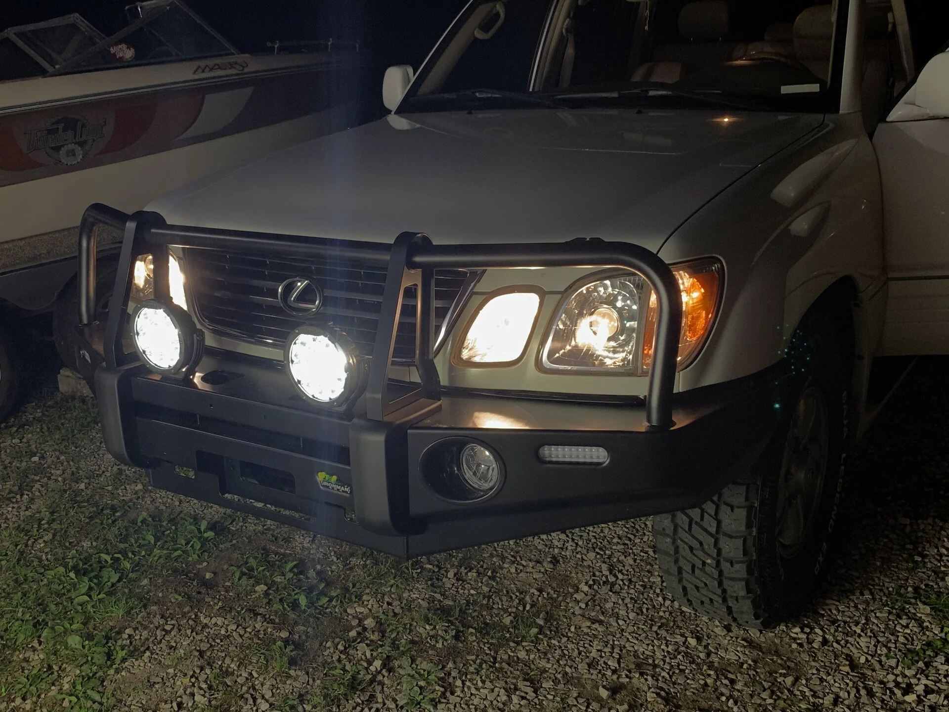

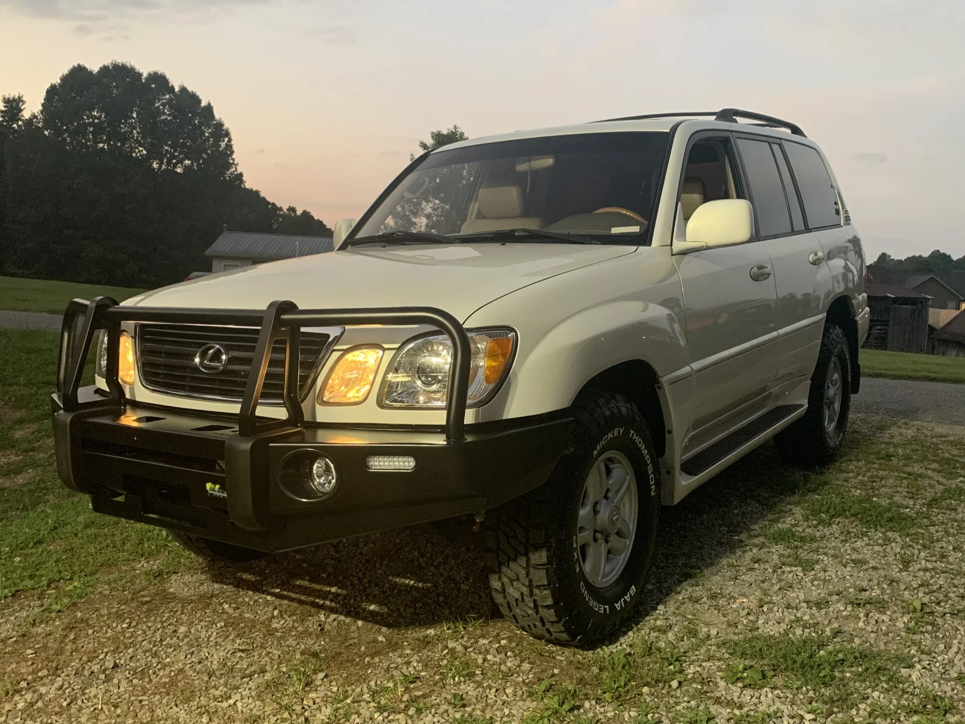

Got the 7” spots in the mail, mounted those up, and wired up the fogs on my lunch break today. Gotta finish up the heat-shrink on that tomorrow because I ran out halfway through the job. The fog lights ended up being pretty much just as bright as the headlights, if not brighter. Pleased with the outcome on the bumper overall, I’d buy another Ironman bumper for sure!
As for the spots, I have an oem style switch coming in the mail to wire those up too. The Ironman bumper came with a driving light wiring harness/kit but the switch in it isn’t the style I’d prefer, so once the other switch shows up I’ll tackle that job and post up the results. Here’s a few pictures of the LX for now with its new lights!

Got the 7” driving lights wired up tonight, although I was running short on time. They ended up being fairly easy to wire in with the supplied harness, and 80% of the work is routing cables to where they’re safe and neat in the bay. The light output is really good, they’ll definitely come in handy out in the smoky mountains back country :)
