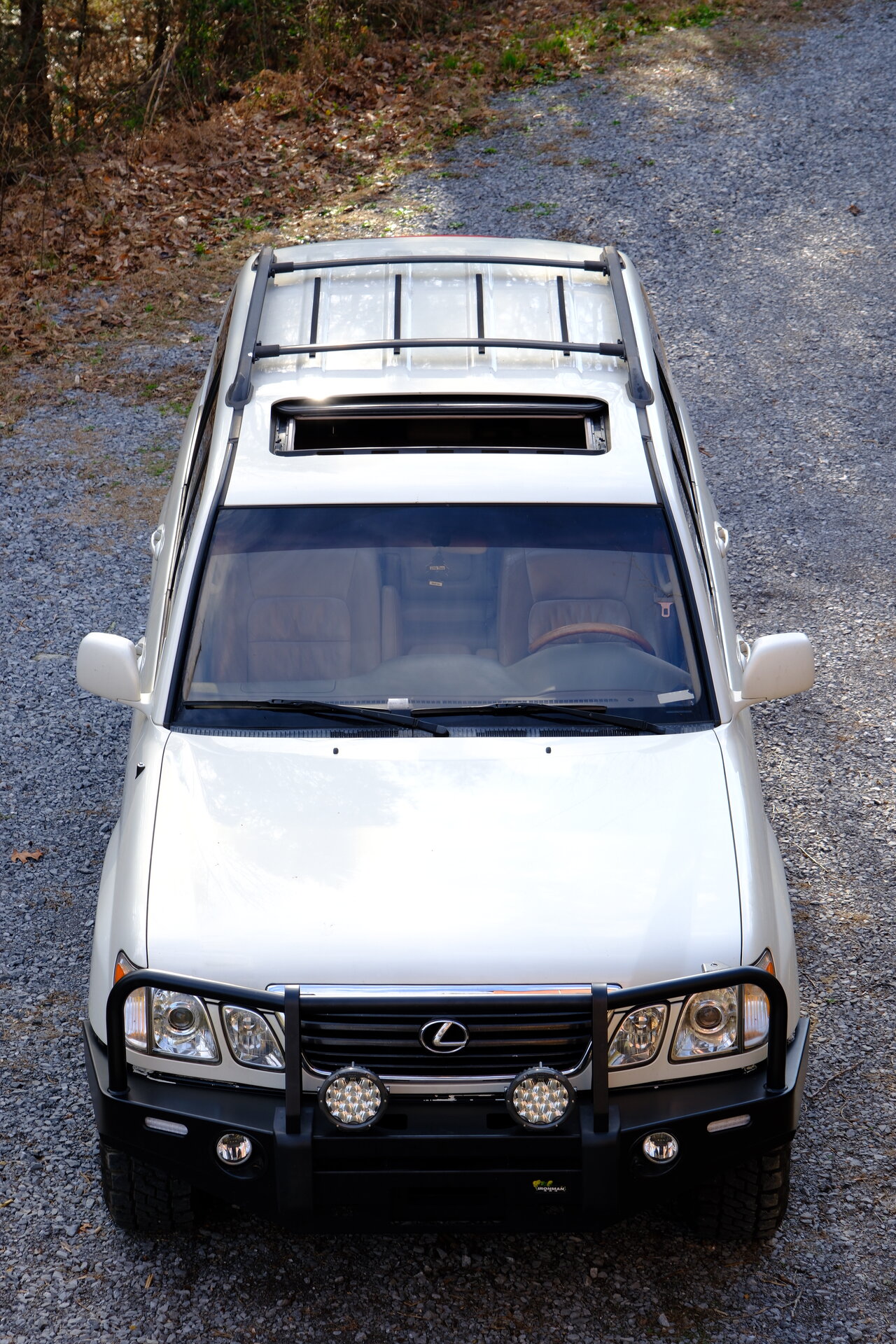

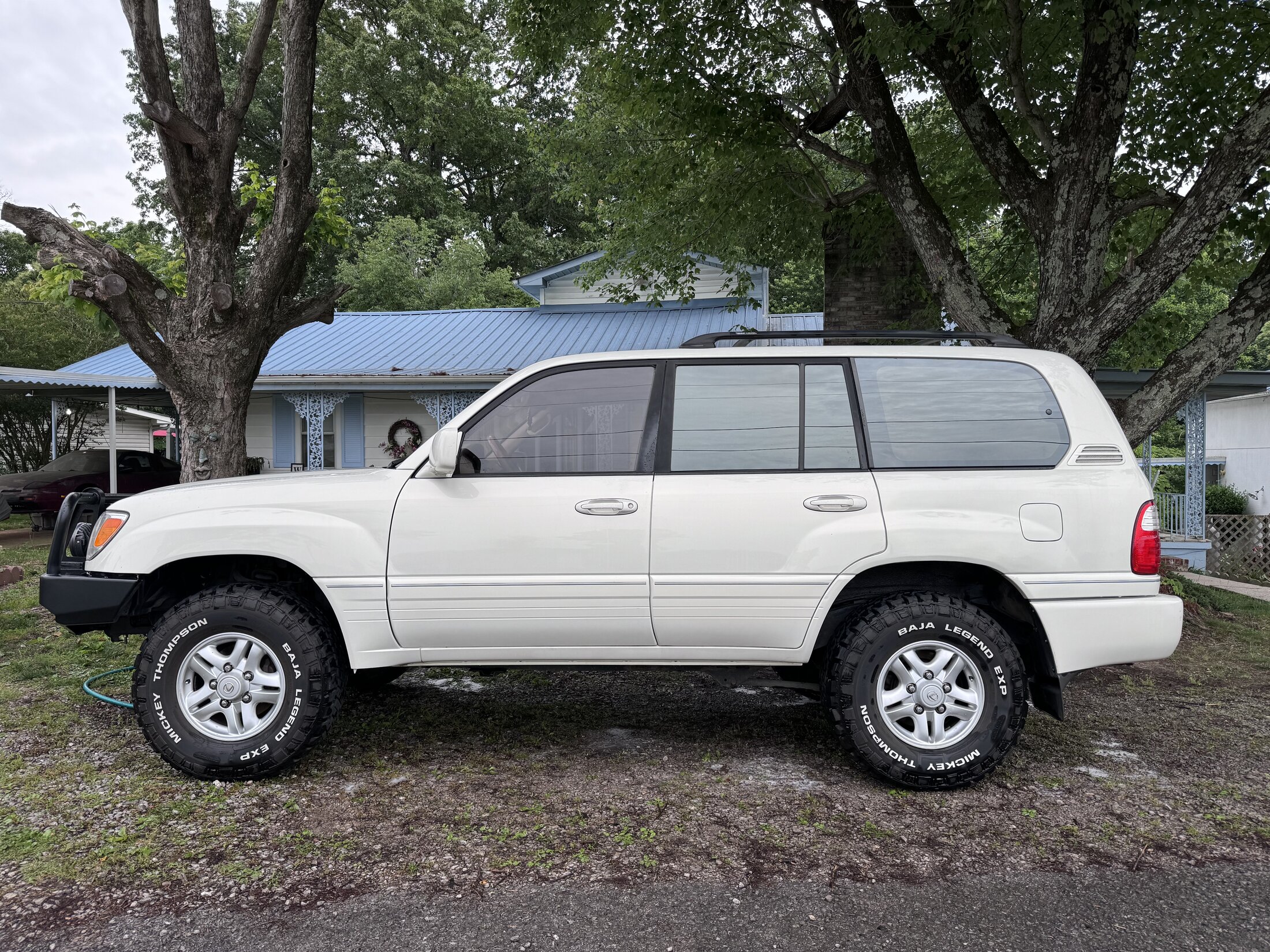

Took the 100 to the mountains for our 10th anniversary and bagged a couple shots with the new Fujifilm. Even though we didn’t do any wheeling, the cruiser is happiest in the mountains!
Nice rig! I have a 2000 LX myself (white too) and I have a nearly identical build planned. How do you like the ironman suspension? Was it a stage 2 or three? I believe both stage 2 and 3 has diff drop for better CV alignment.

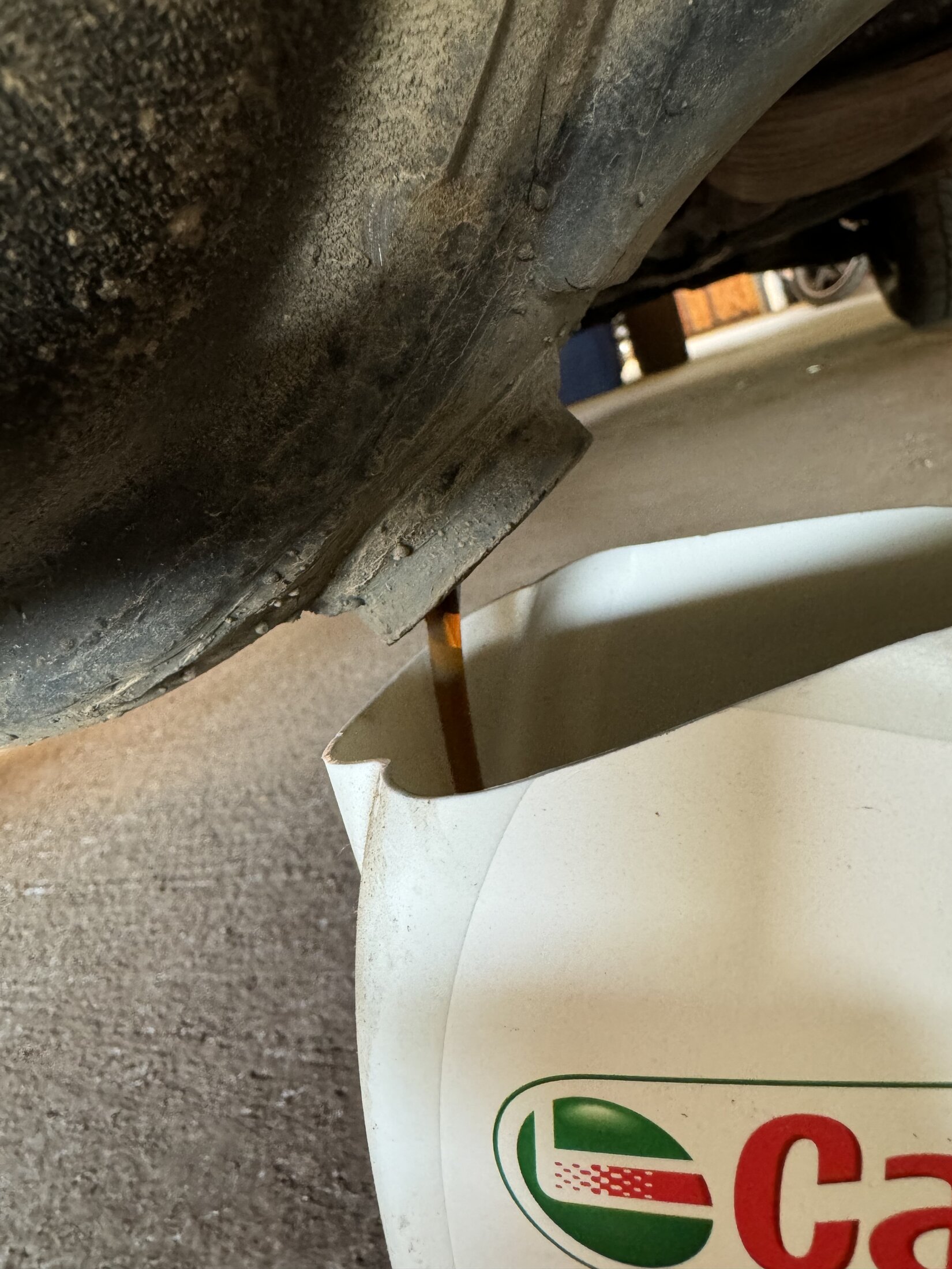

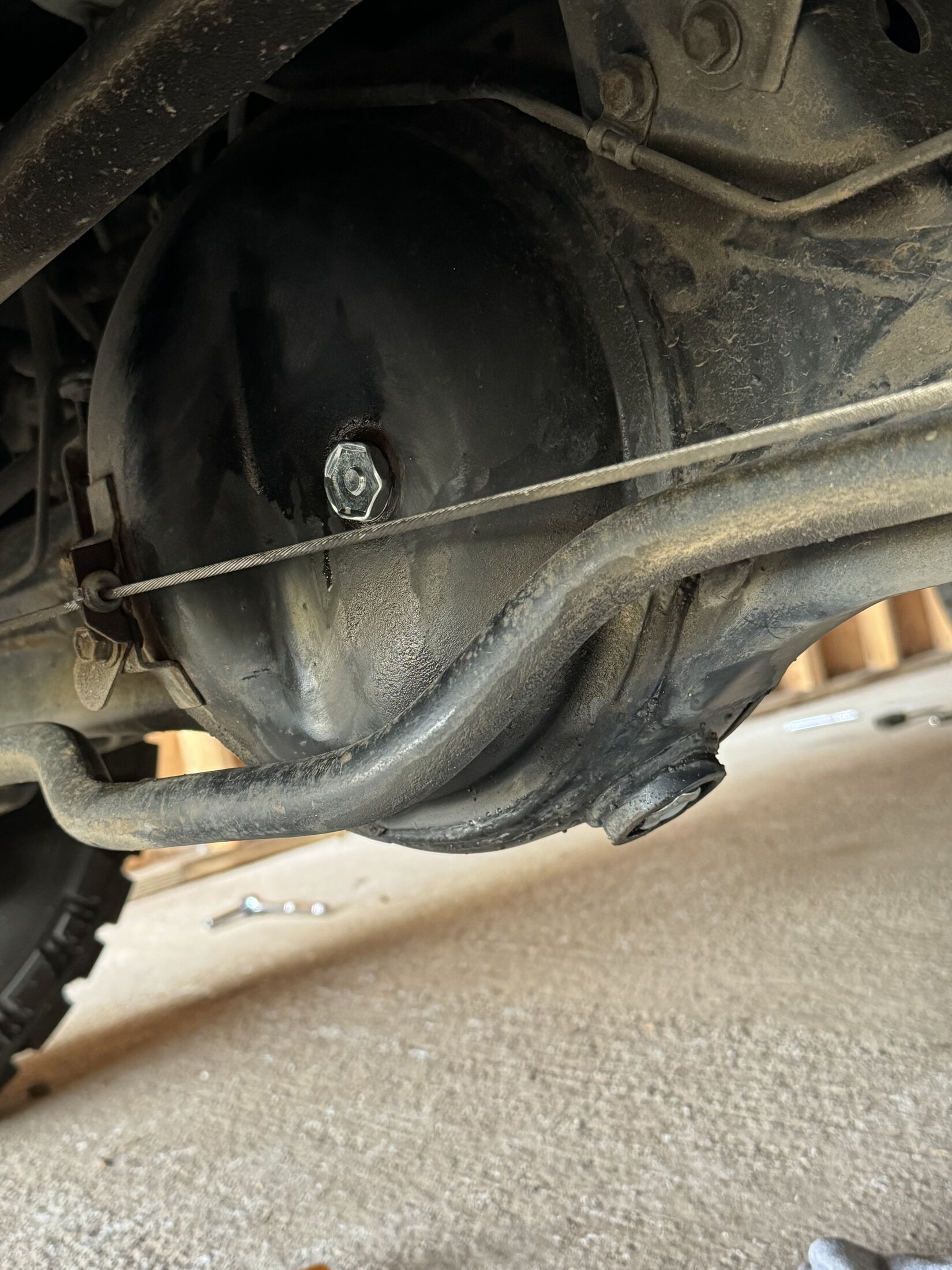

Finally got around to taking the side steps off and doing the diff fluid change. I meant to do the diffs months ago but things have been crazy and I’ve lacked the motivation after work and everything else.
The rear diff had been changed in the last 10k miles for sure. It still had a golden hue to it, just more evidence that this thing had been properly cared for by its past owner. The others were a bit darker, but the fluid wasn’t burnt or anything like that. Replaced all the plugs with new ones and new washers as well.
