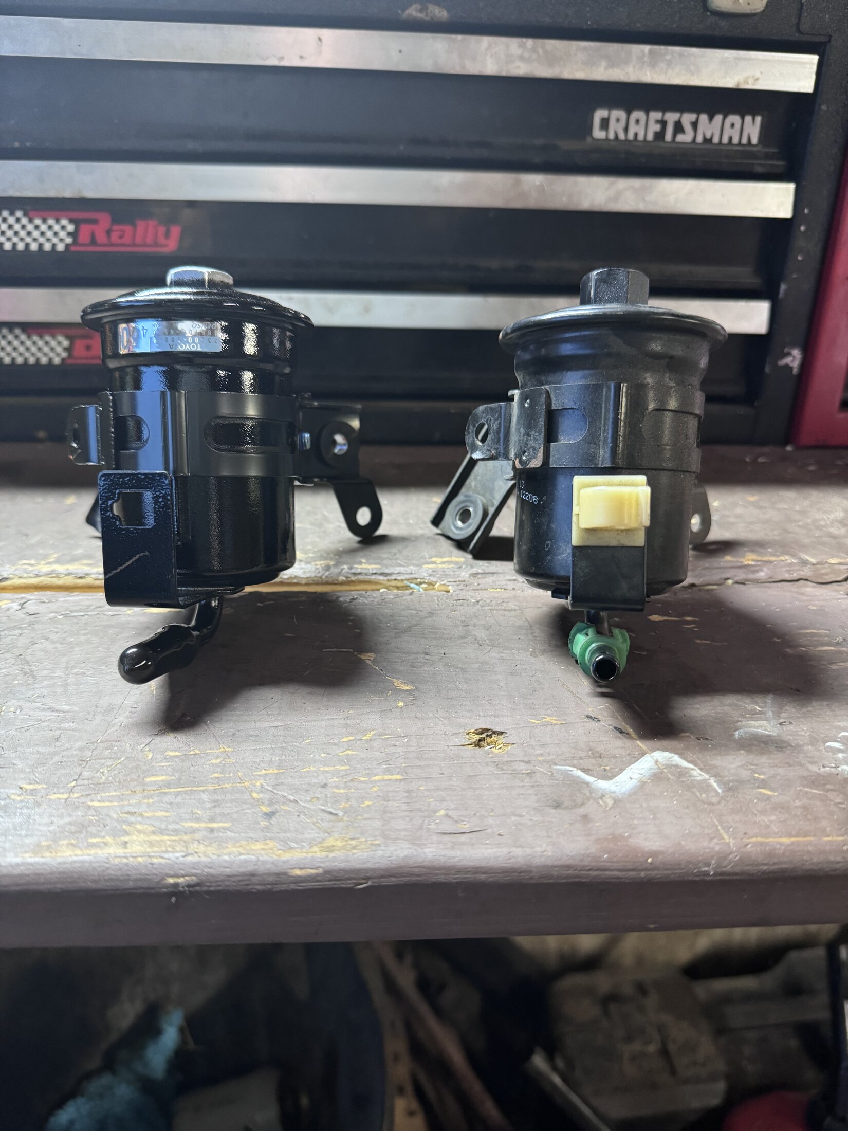

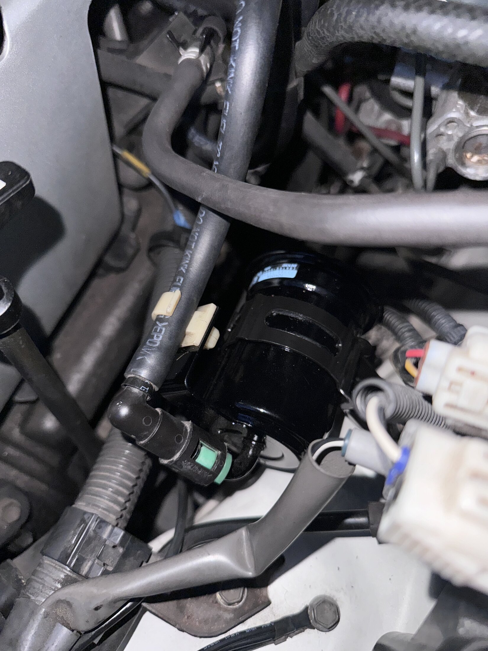

Did a small thing today. Picked up a new fuel filter since the one that’s on it has filtered thousands upon thousands of gallons of fuel. For $39 it’s piece of mind knowing it’s been replaced! Fuel filters are always something I like to change when I buy a new to me vehicle, and for those of you it might have inspired to do to your own 100, the part number is 23300-50090.

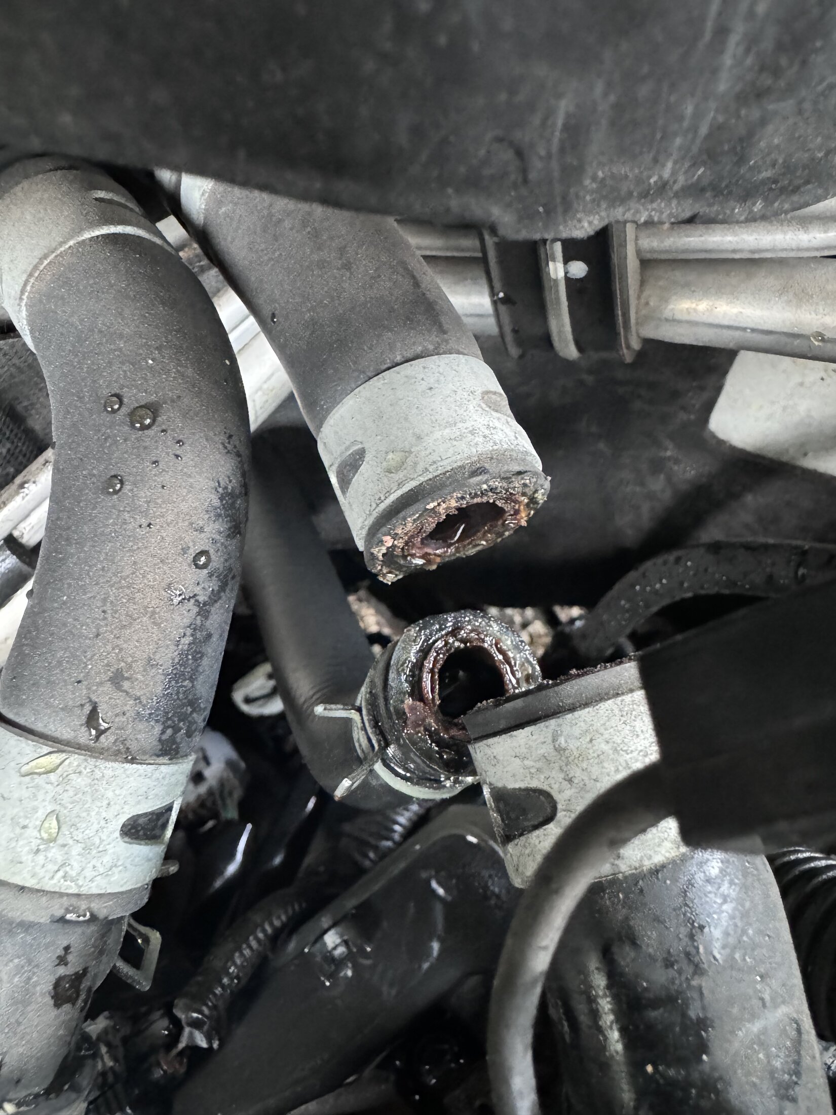

Finally got around to doing this… and it couldn’t have gone much longer! Both of these were so bad that they just crumbled and broke off into the heater hoses… which made the job much more tedious. But now they’re fresh and ready for many more years of service!

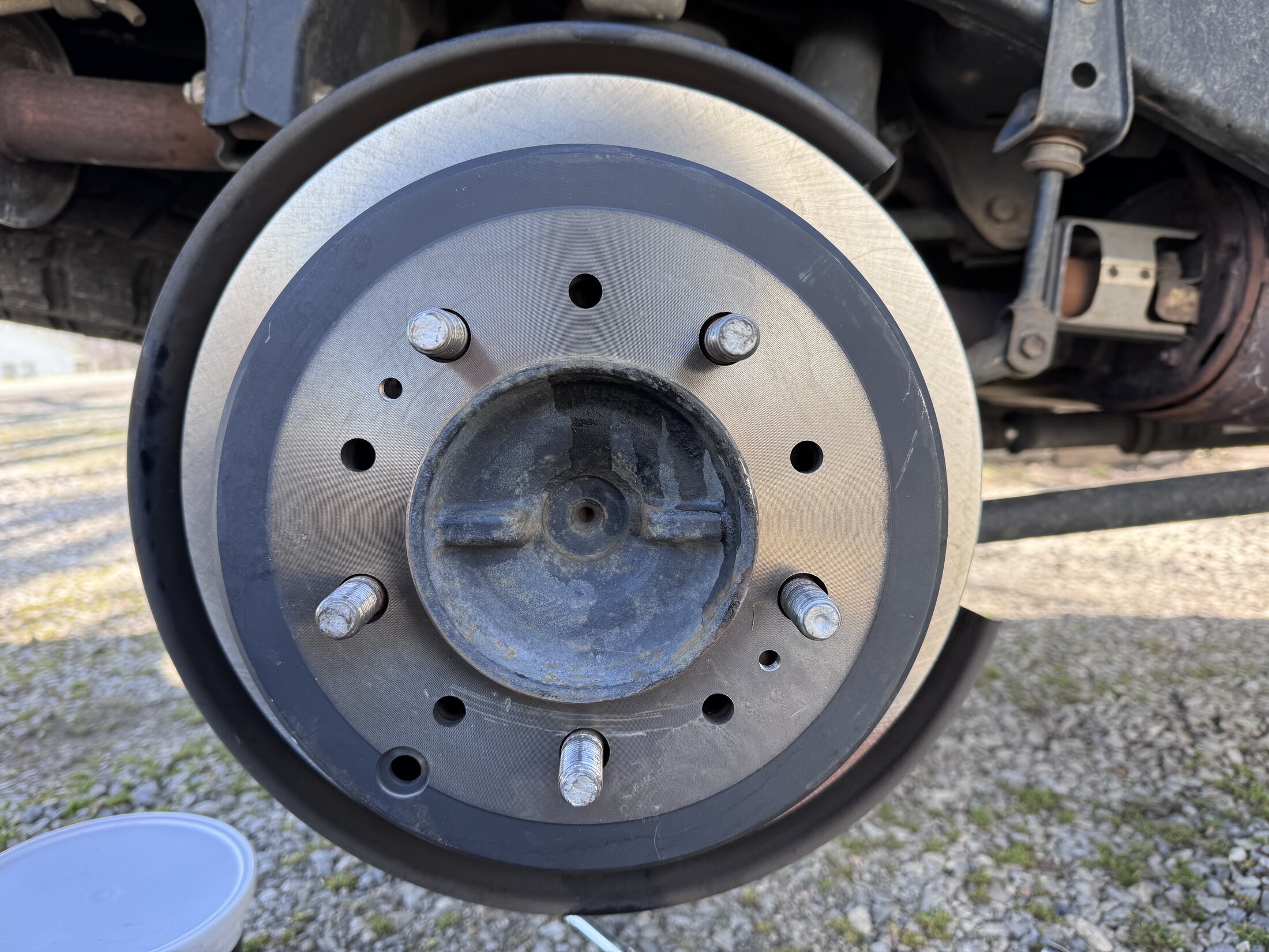

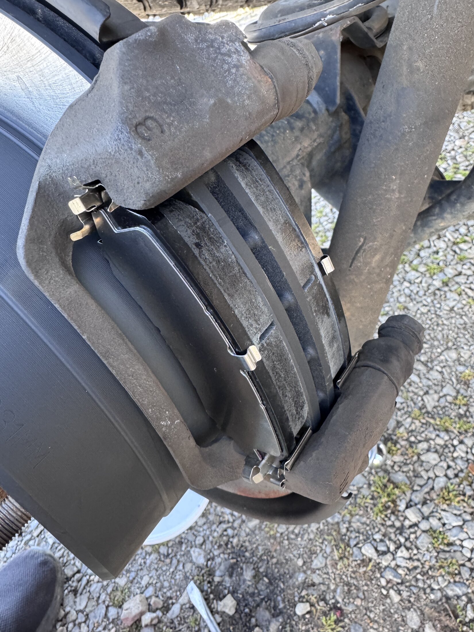

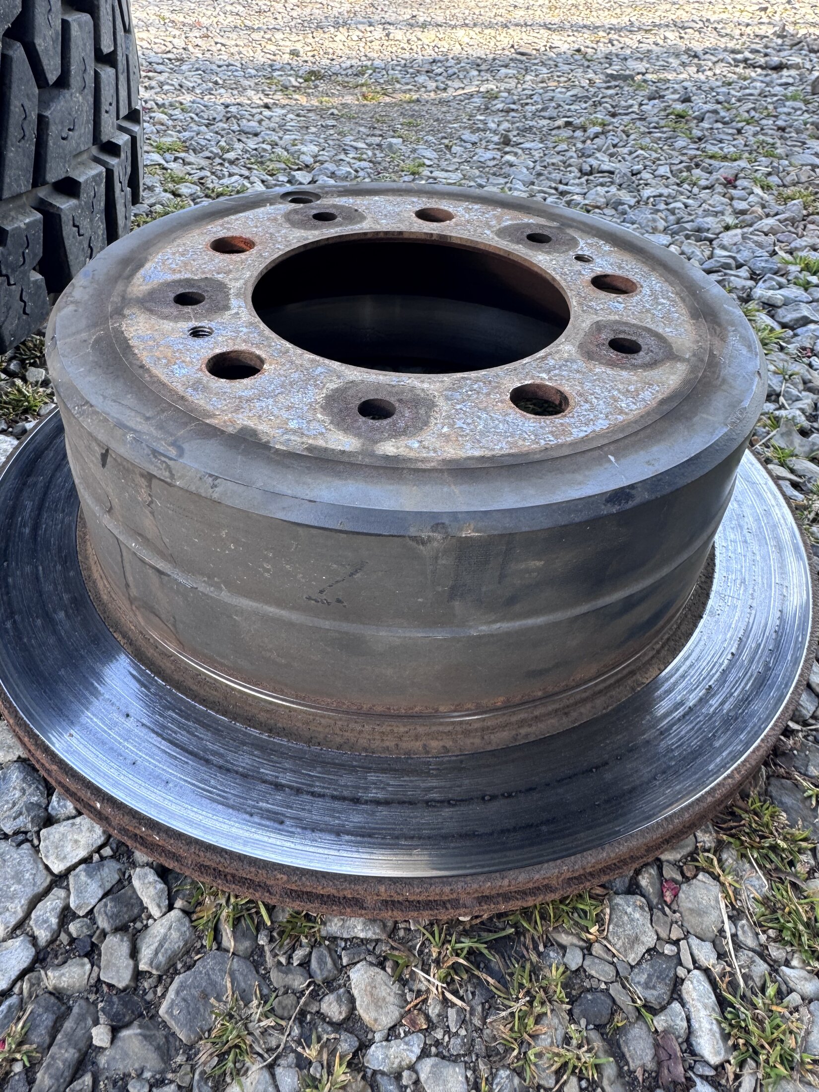

Finally got around to doing my rear pads, shims, rotors today. Been starting to hear metal on metal and I finally had good enough weather today to put them on. I usually never let brakes get this bad, and what’s worse is I’ve had these parts for months now. Oh well, they’re sorted now so that’s all that matters. I’ve got to get a few more little bits and pieces before I do the front brakes, but they’re not nearly as worn as these rear ones were. Figured I’d go ahead and do the wheel bearings, front sway bar links, and possibly the axles too while I’m at the front and have it all apart, will update soon as I get the stuff.

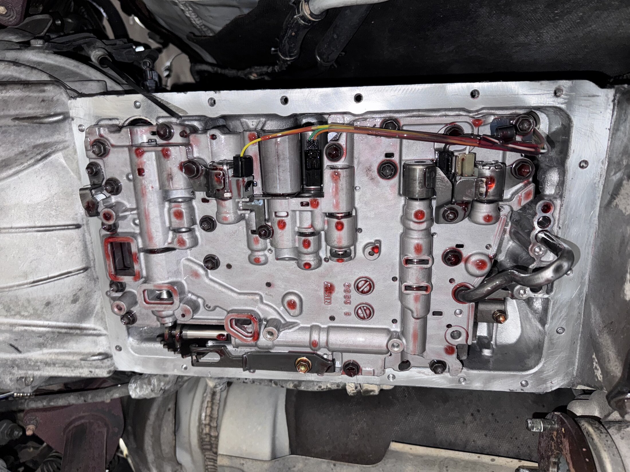

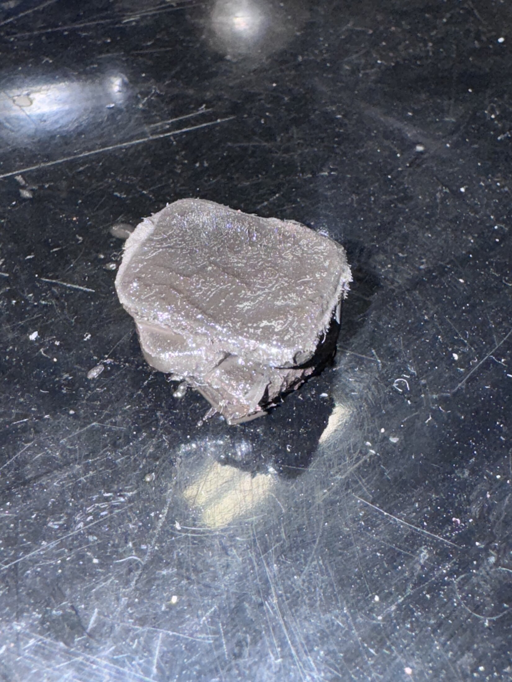

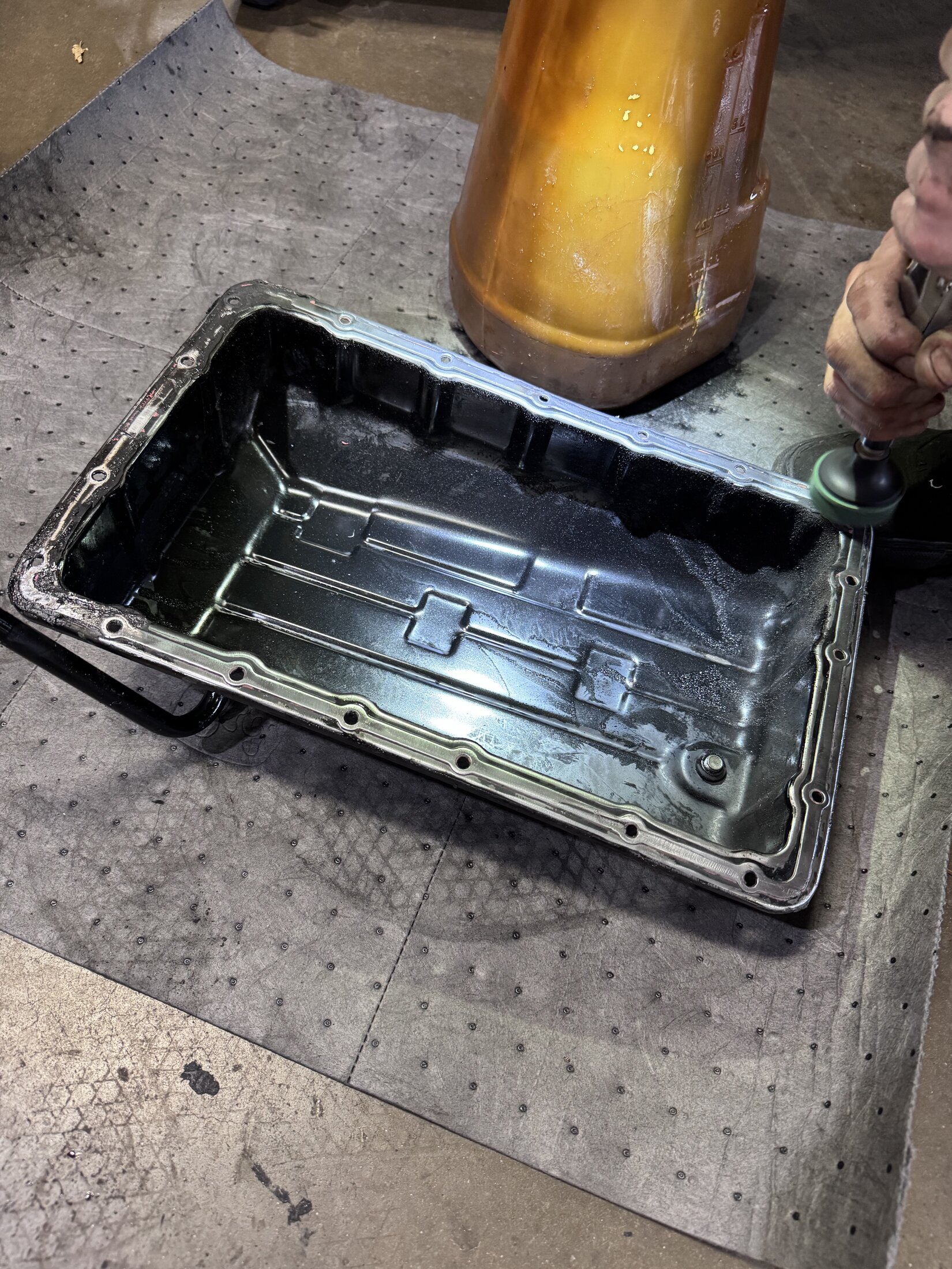

Fluid came out looking great still! Just a little cloudy but still nice and red with no smells or anything strange. Magnets in the pan look like they were most likely cleaned last time the pan was down, and only had a little paste on them, no chunks or anything out of the ordinary (there’s some old gasket material on them in the photo).
New strainer is going in and putting new FIPG on now to let it set up before we do the rest of the fluid exchange. It’s a WIP, so more pics to come in a bit.

i know how much time you spent on cleaning up that transmission sealing surface. Just recently did that myself
Thanks! Yeah that orange FIPG does not mess around, though I’m noticing a small drip of transmission fluid at the rear corner after getting it done and I’m thinking I may have to take the pan back off and straighten it out. May have gotten a little out of whack when the pan was being pulled off, it was certainly STUCK on there!
