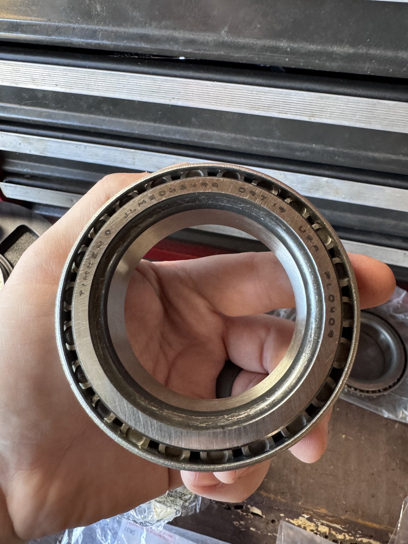

Before we start I just wanted to put this here; factory wheel bearings supply Koyo and Timken parts, for the outer and inner bearings respectively. I’ve heard some back and forth on this, and at least for me, this is how they came.

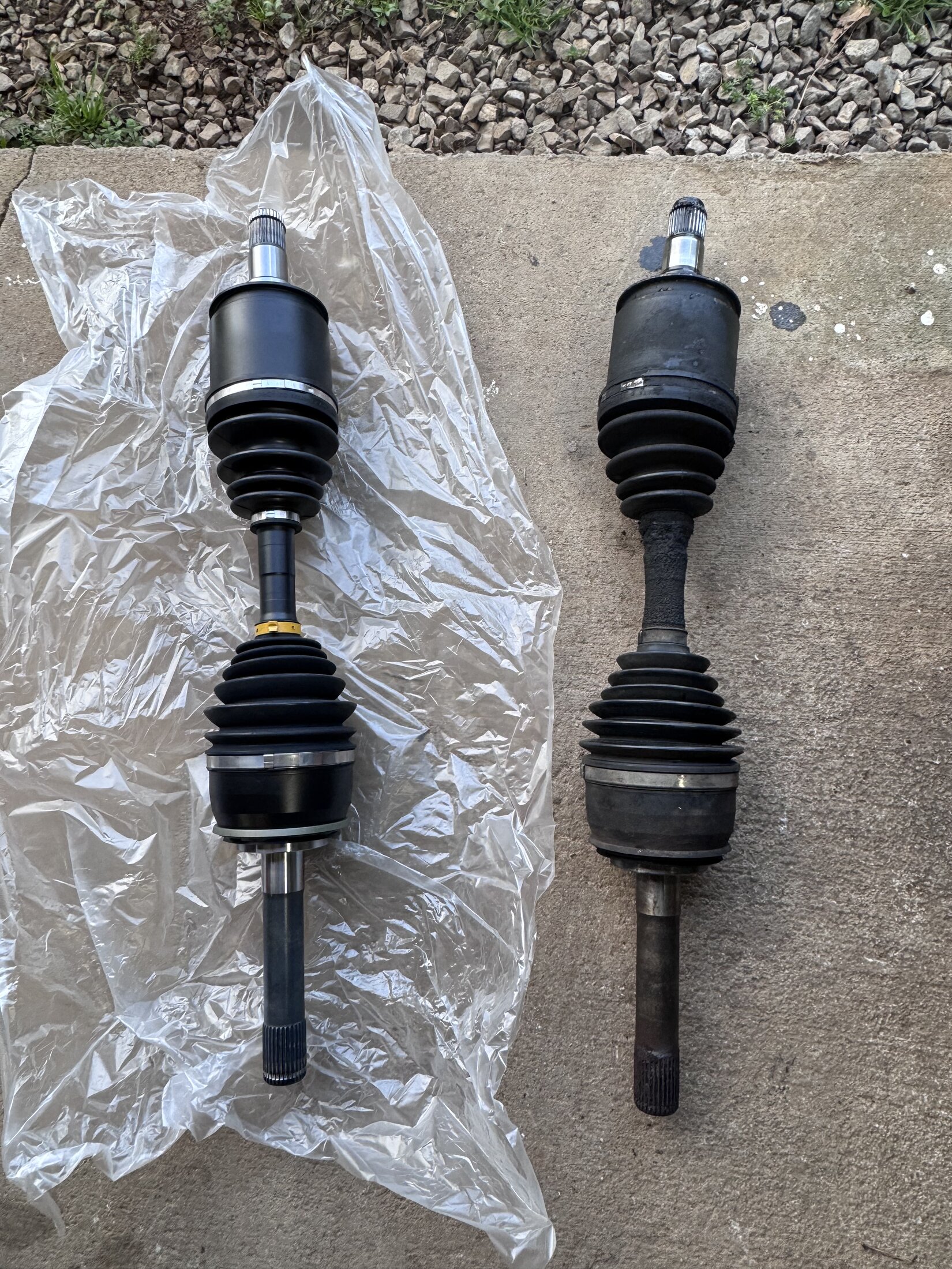

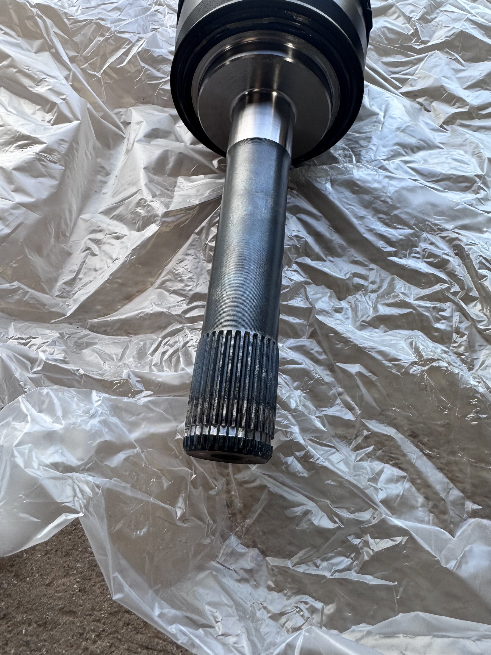

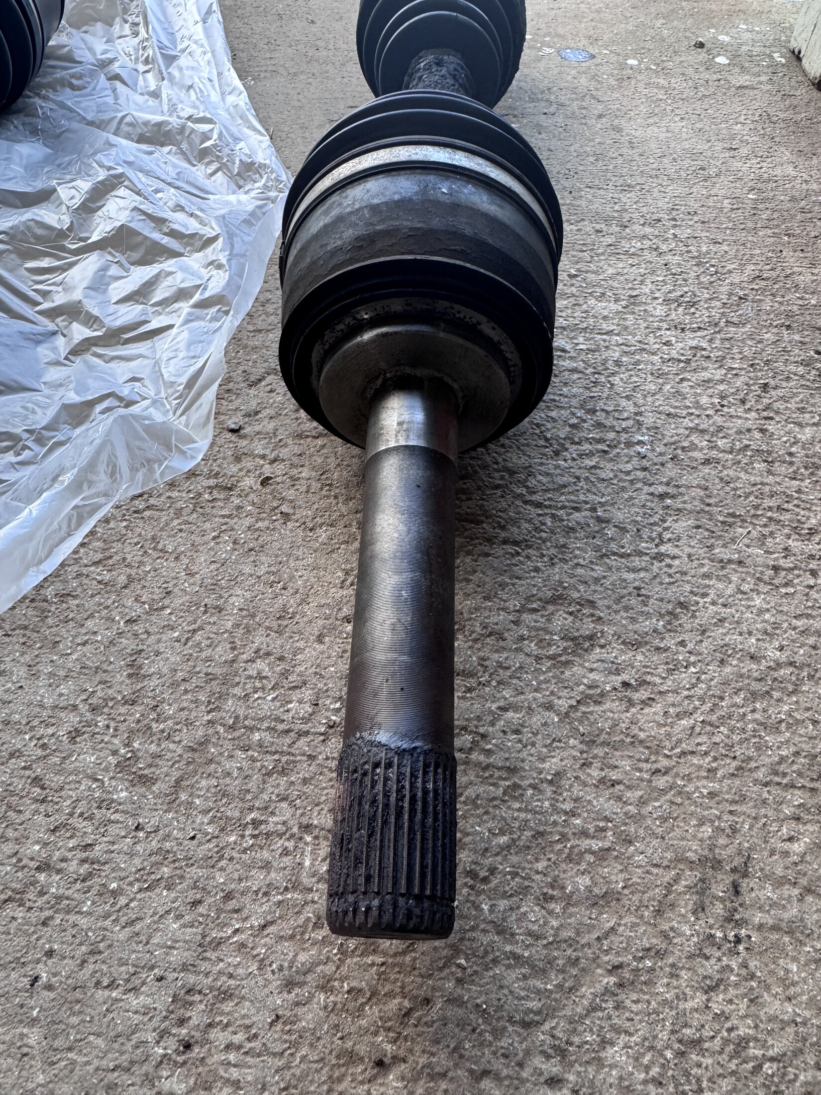

Found some crust and dust and grime! Most of this is from where this passenger CV axle had slung grease before, and nobody cleaned it up… so now it’s got 10 years of road grime and cv grease putty everywhere. Got a big jug of purple power and a date with the pressure washer after this suspension install for sure!

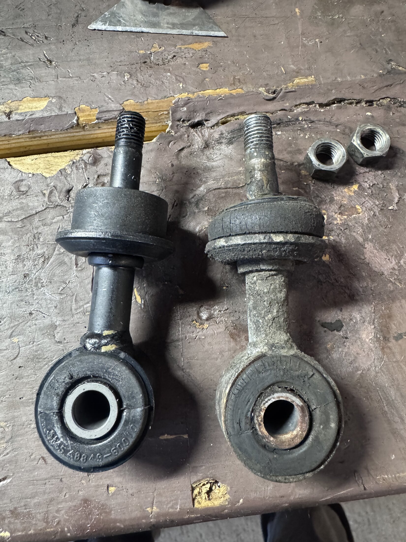

Gonna need upper ball joints before too long, so I’m shopping now to figure out which UCA’s to run. Can’t immediately afford them, but they’ll be on the to-do list along with a few other things coming up…including those poor poor sway bar and link bushings and main sway bar bushings, I’ve got those on hand ready for install also. The AHC fluid came out clear and had no trouble opening the bleeders to purge the system, which I’m thankful for. Really wasn’t wanting to take a shower with that stuff, it smells VERY strange lol

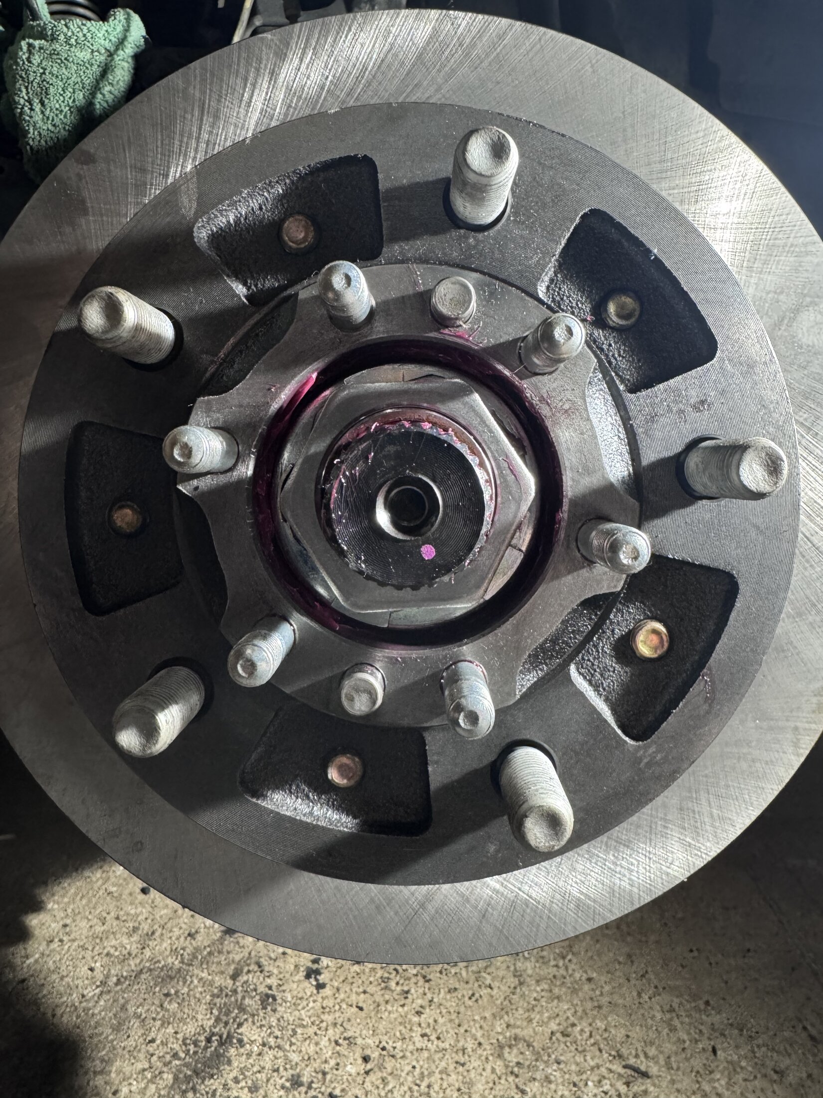

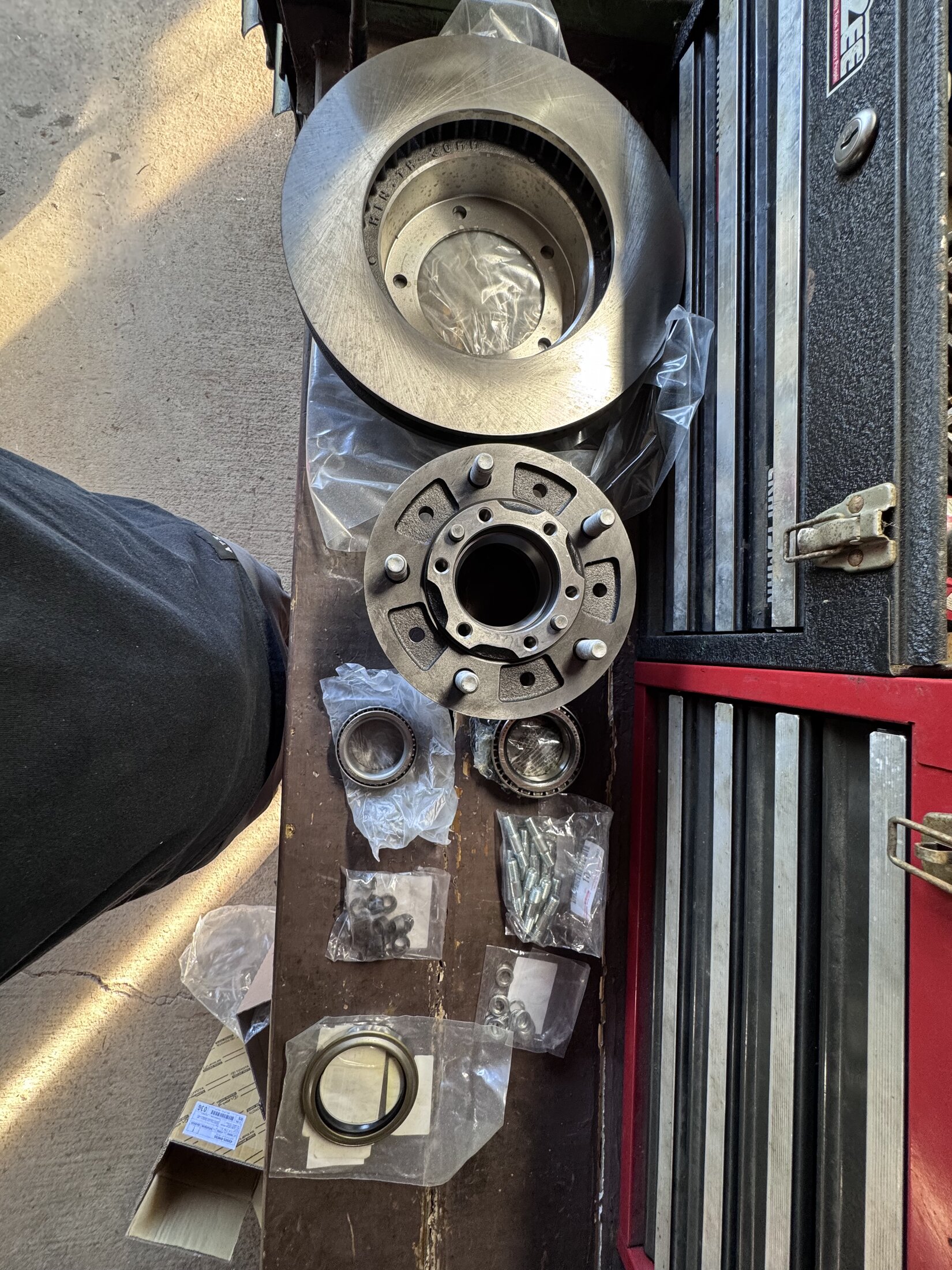

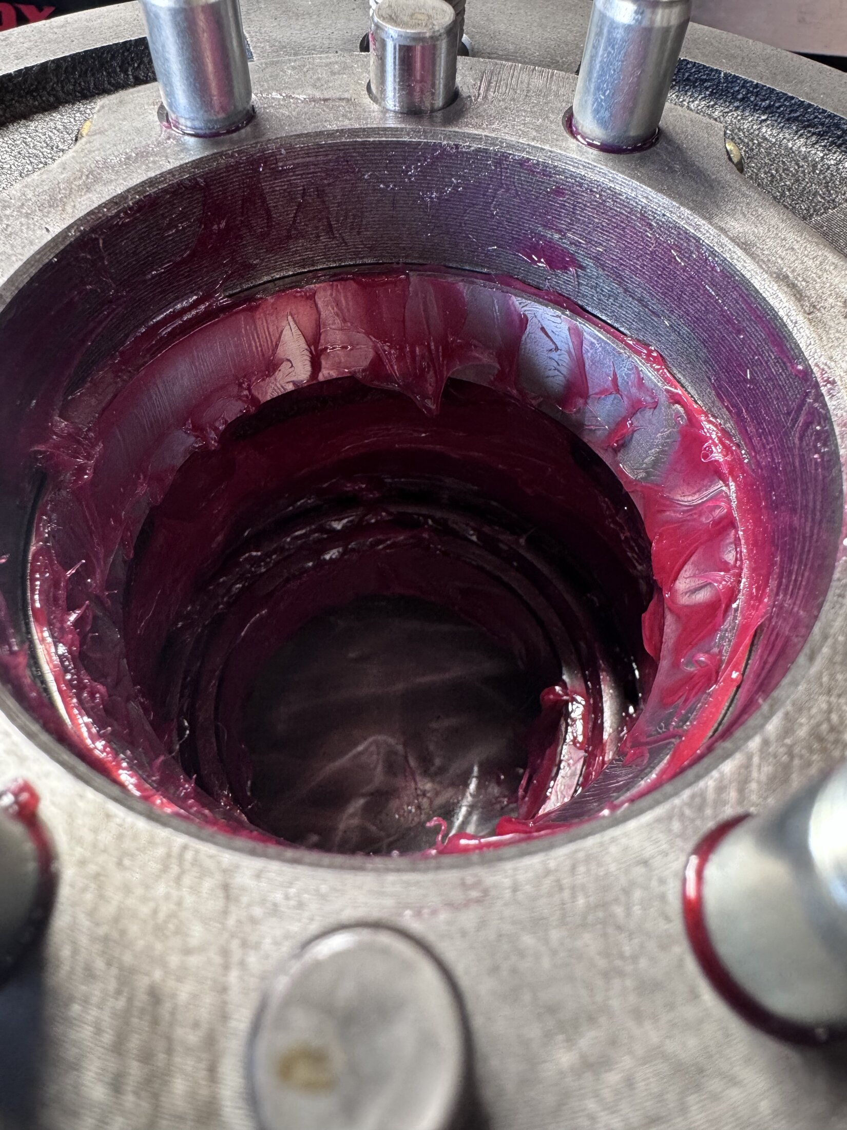

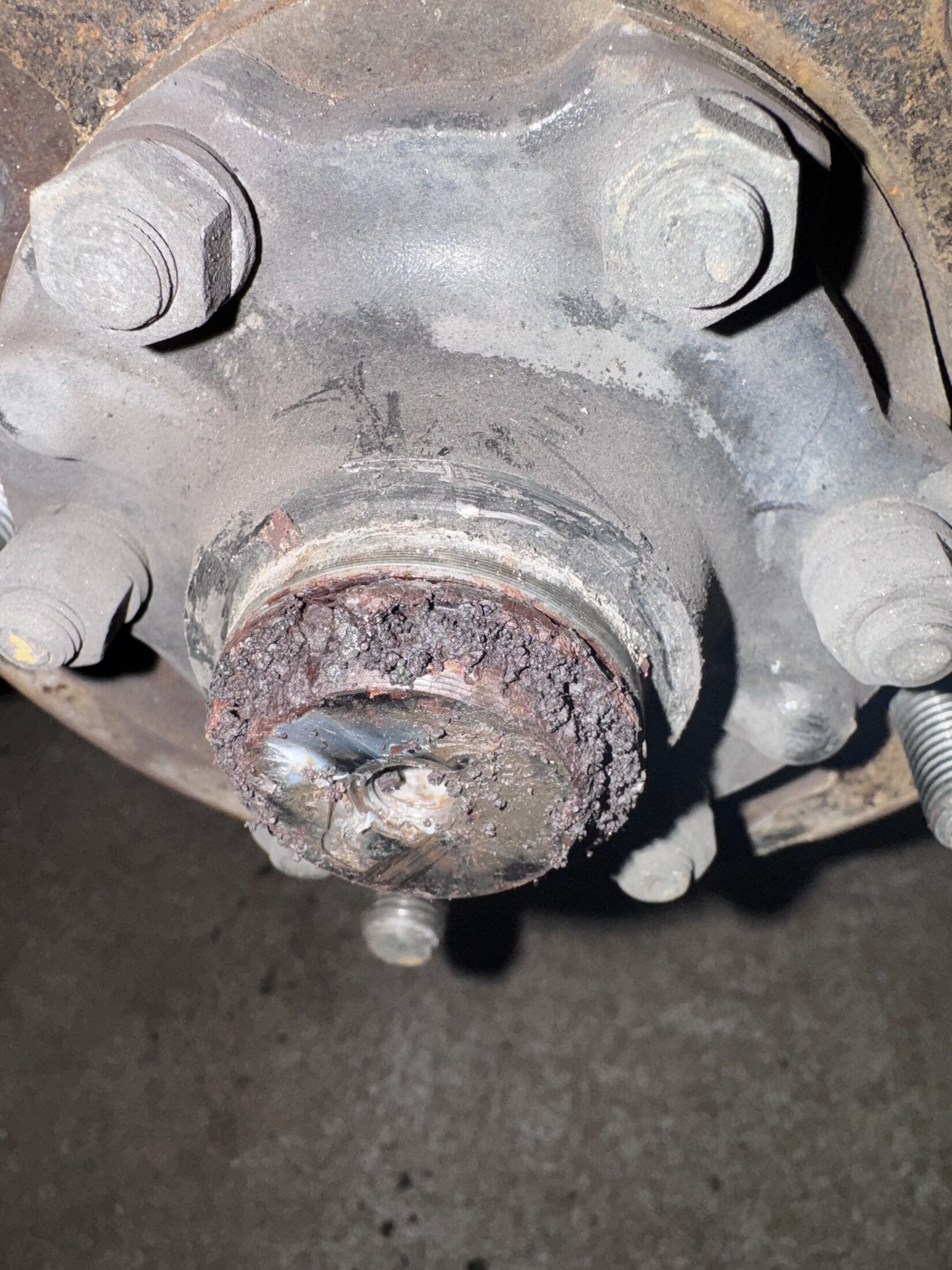

Wheel bearings/hubs are in serviceable shape, but I’ll be replacing that stuff, so if anyone is perhaps interested in picking these up for rebuild/spares lmk. Somebody had been in here in the last 30-40k miles, but I’m not sure that the correct grease was used for the wheel bearings. Everything still looks like it would clean up great though. The 100 will be down a few days while I work on it after work, but everything is going just fine so far at my snails pace. Eager to get it all done and see the end result!

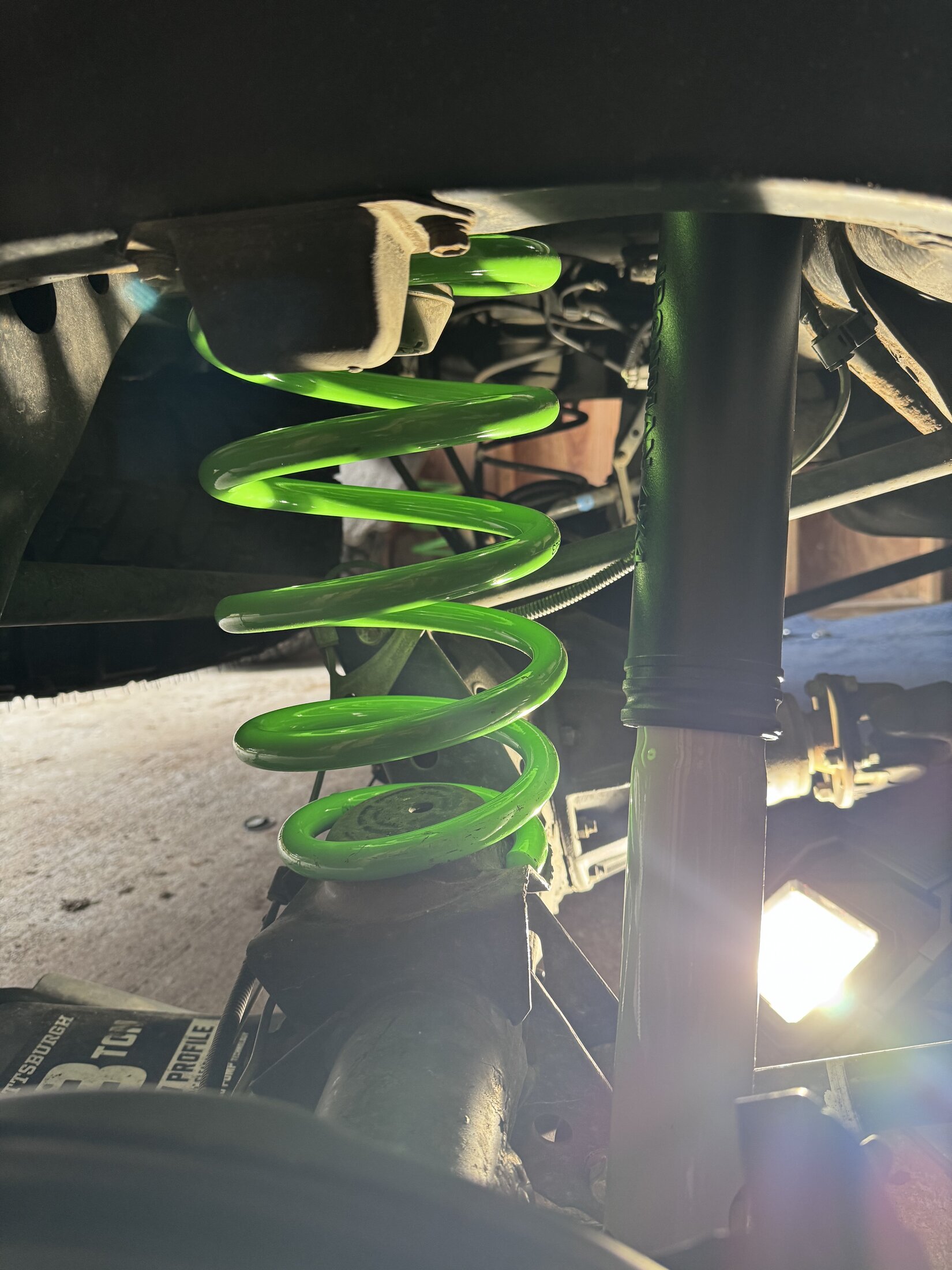

Overall, the lift install itself was not that bad. The shock nuts on the rear were a huge pain (especially on the drivers side), but everything else was just a matter of simple unbolting and preparing for new parts to be installed. I certainly wouldn’t do it again in my garage though, a lift would have been a lifesaver more than a few times! I got my torsion bars pretty close to where they need to be, I’ve got a short drive to and from work so I’m gonna let it settle for a day or two and remeasure/adjust before I get it lined up. On the test drive the truck drives great. Definitely not as firm as OME sports I’ve ridden in before, but I’d say it’s about like the factory suspension set in the 2nd firmest setting, just less bouncy.

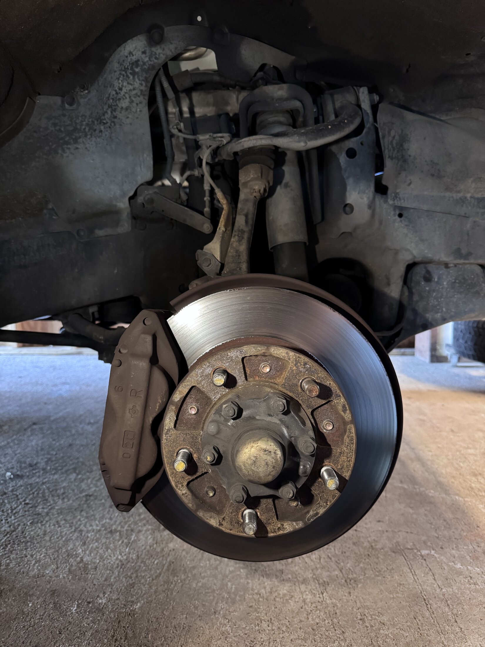

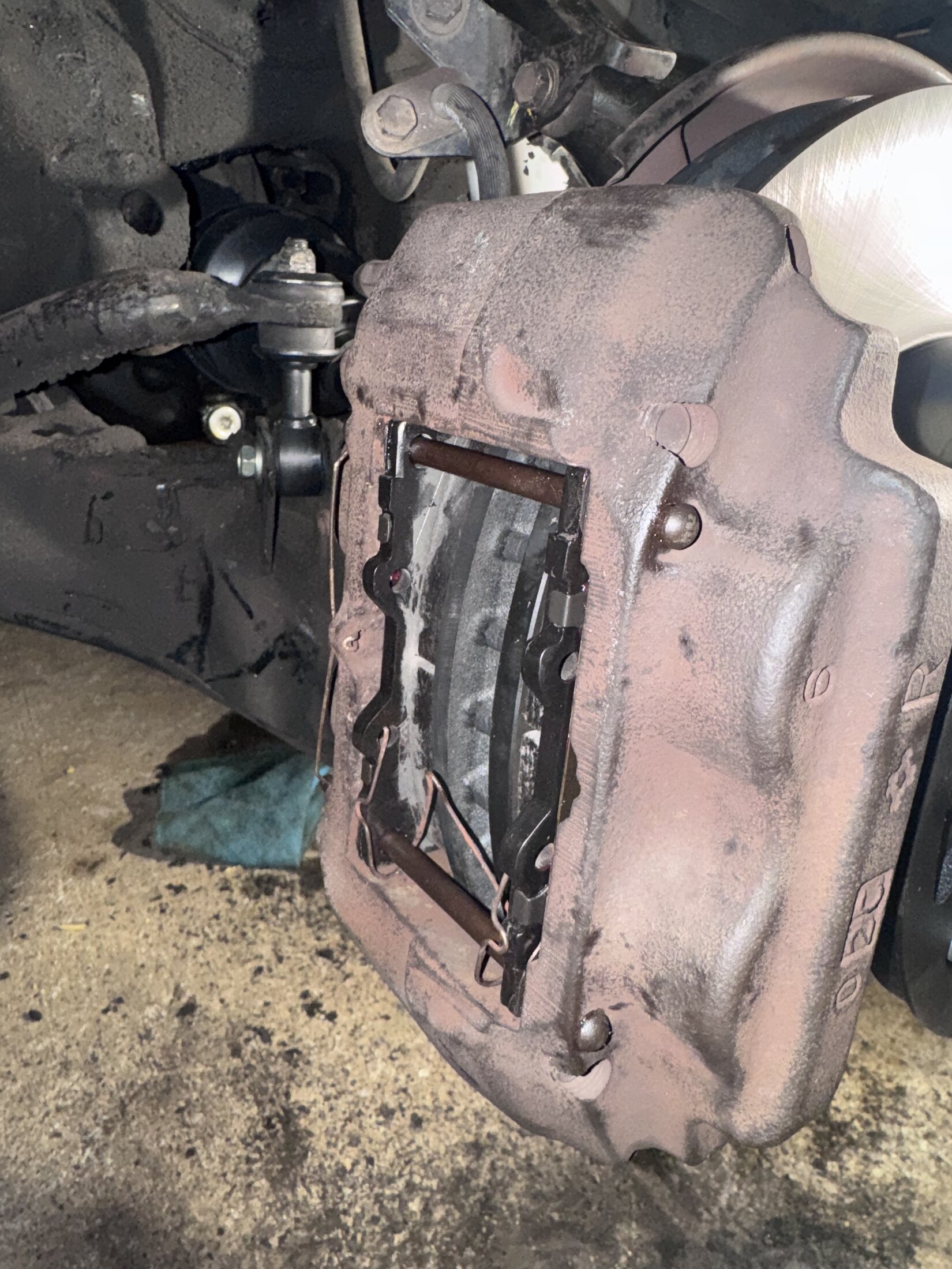

The brakes and rotors and wheel bearings are night and day and now I don’t have that slight roaring noise I was getting from the passengers side front.

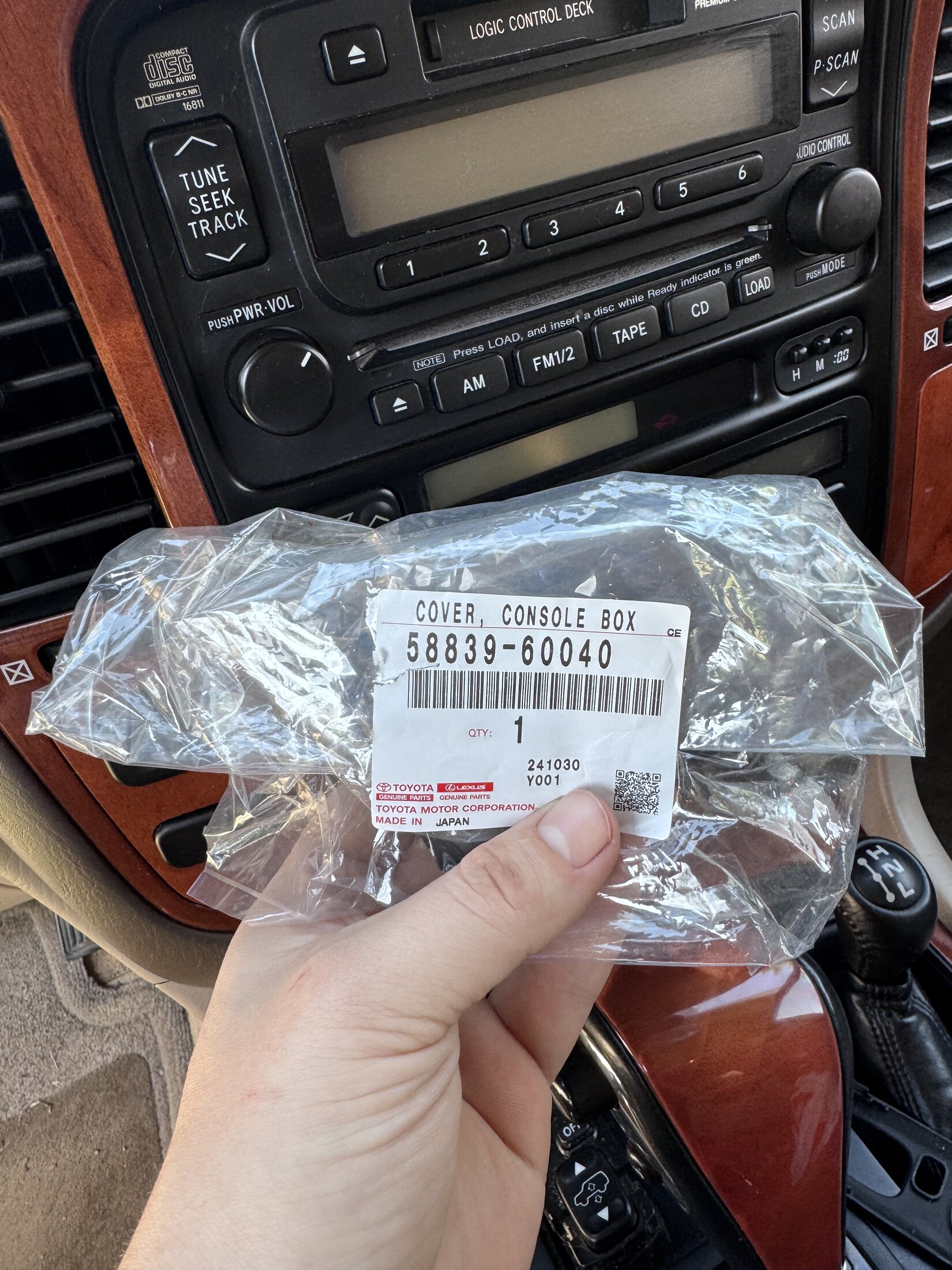

Also, here’s a neat little doodad for those who don’t know/may be interested in this. Here’s the part number for the AHC control panel delete, and what it looks like. It’s a smaller cubby, but it’s certainly more useful than a switch panel that doesn’t have any use anymore!

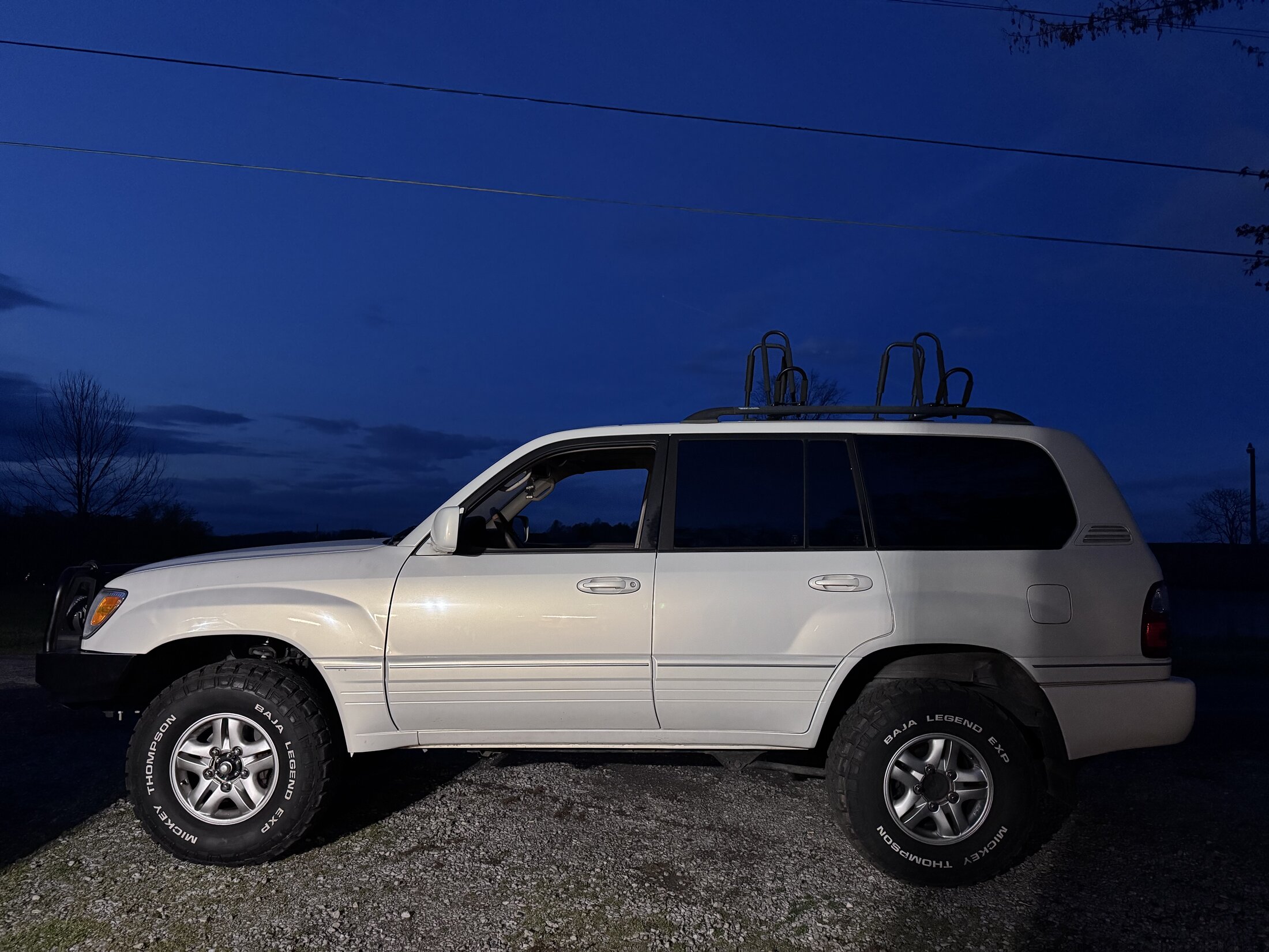

Took the 100 fishing near the Dam last night, got the camera out and snapped a few photos. This one is my favorite of the lot though!

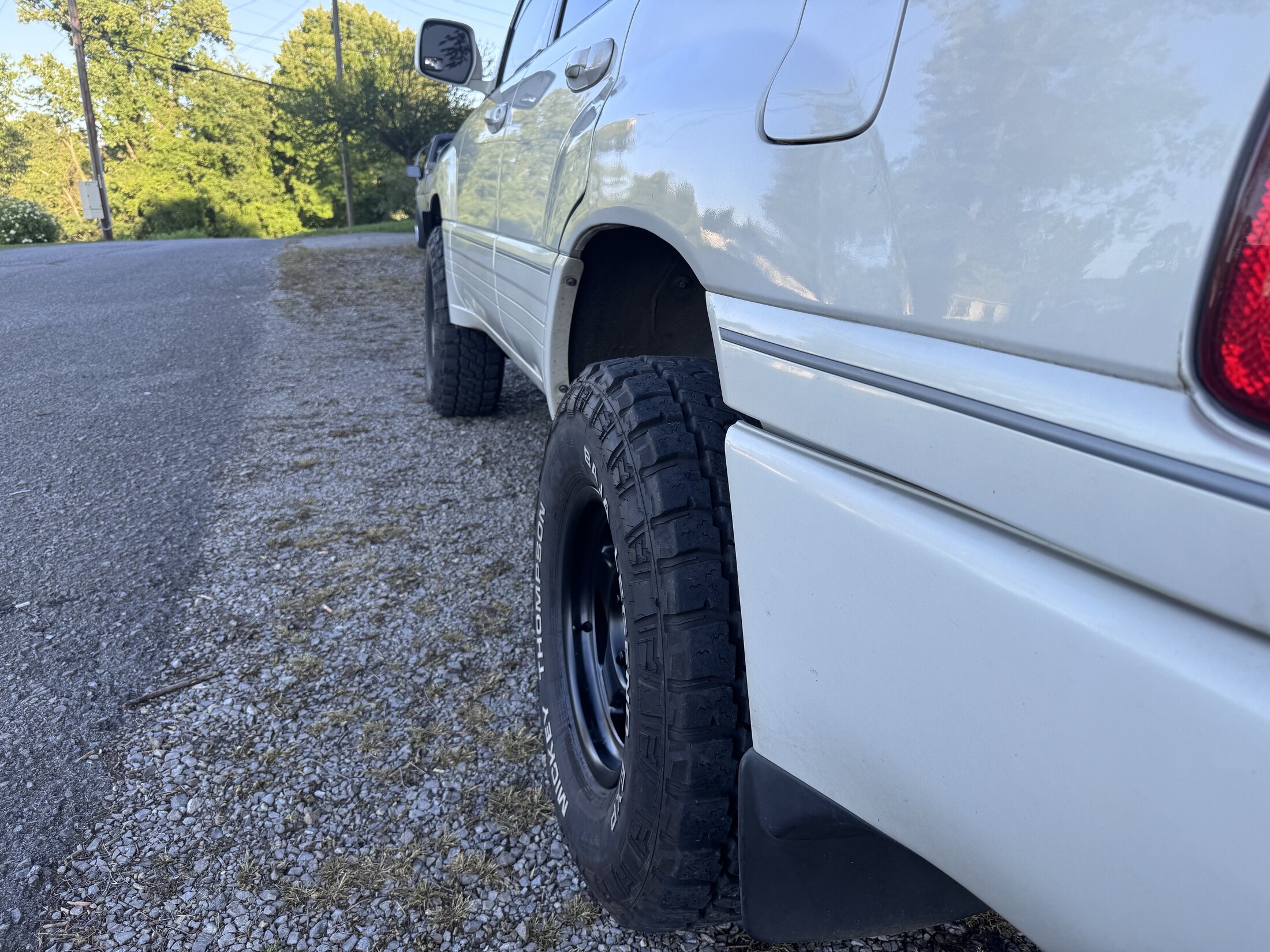

Finally got them put on this afternoon, what a huge difference in the looks and the way it drives! Please don’t mind my absolutely filthy tires, I haven’t had a chance to wash the thing since they were installed. Everything balanced out great, and I can tell a different in the way it turns, stops, and accelerates now. The oem wheels were heavier than these for sure!
These provide just enough of a poke to be tasteful and not interfere with anything, and overall im super happy with the outcome! I’d have preferred grey I think, but the black looks good too.
For those who may be new to the thread, I’m using Mickey Thompson Baja legend EXP’s in 285/75-16, Ironman stage 2 nitro lift, and the wheels are stealth custom series in matte black 16x8 +10.

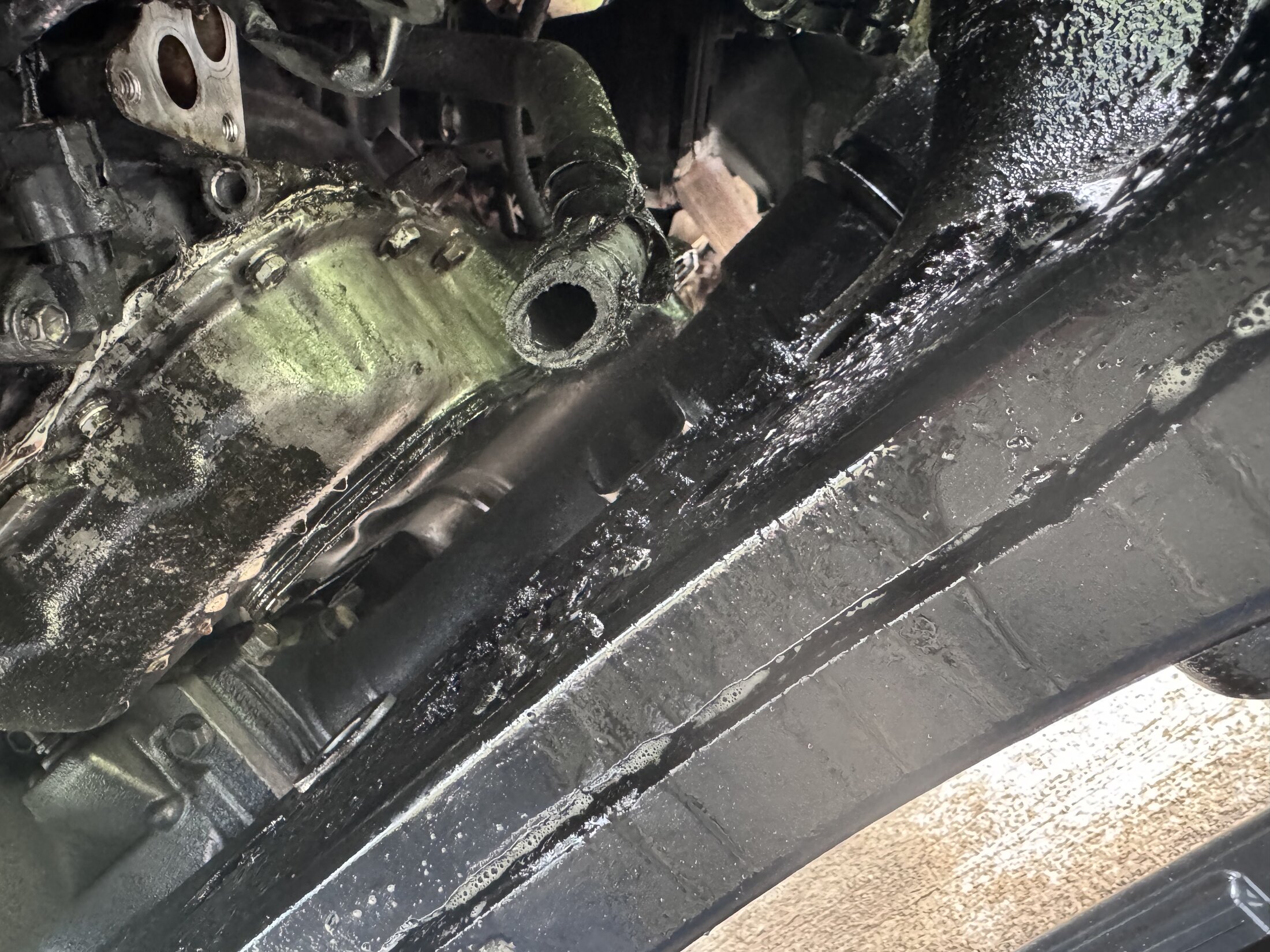

All the bolts and nuts have came right out with no PB blaster at all, but the leak on the drivers side of the rack was worse than I thought, once I got in there it was just caked onto the back of the crossmember and all the parts below it, making this a messy messy ordeal.
The fluid was ok in color, no smell, some black specks in there… but I ran some BG p/s cleaner through the system before I drained the fluid out. I plan to clean up the reservoir before I fill it back up with new fluid. Will update tomorrow with more pictures!
So a few days have passed, and I’ve been off and on working on this. WHAT A PAIN this can be. However, it’s one of those things where there’s a silver lining once you figure out the trick to get a wrench in a certain way, twist something for more leverage, etc. I’ve mostly just been frustrated because the old rack absolutely shot fluid out all over everything on the RH side. The cross member, steering parts, suspension parts, the bottom of the engine, the front differential even. I’ve just been so nasty every time I worked on it.
I finally got it out and this is what it looked like.
And here’s what it looked like underneath
I took some purple power and got what I won’t be able to reach with the power washer, and it’s looking much better.

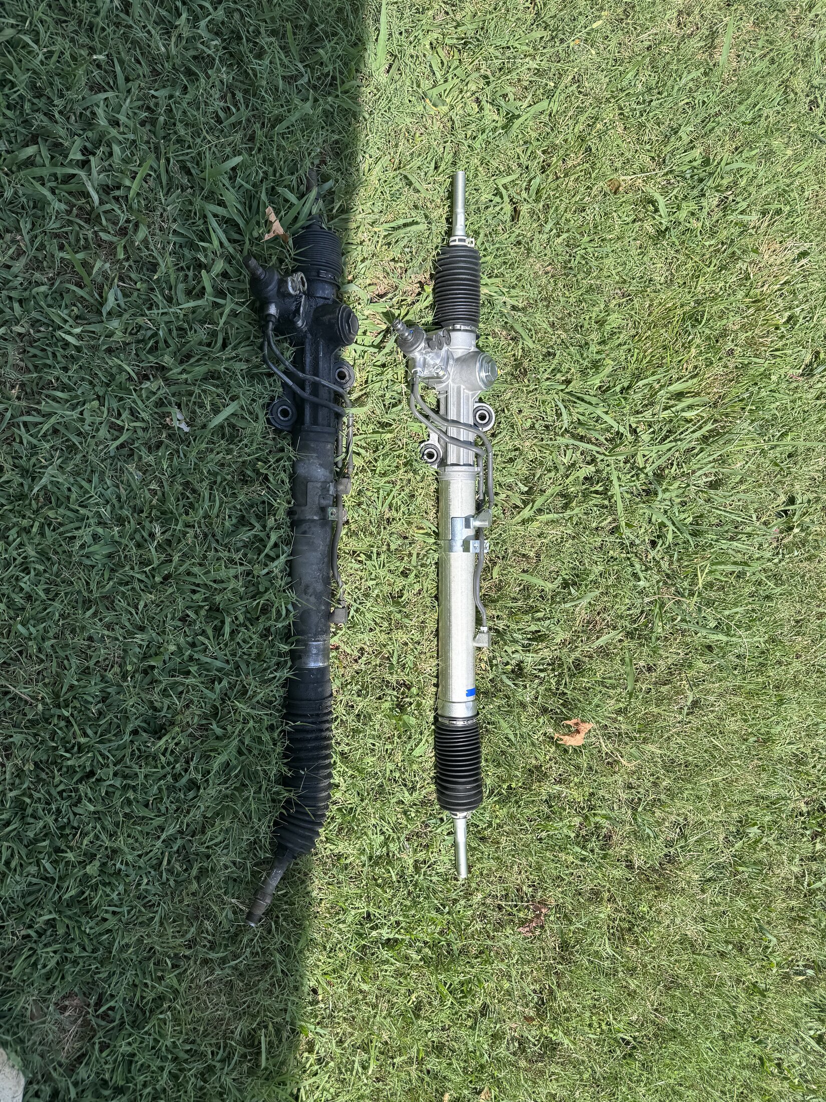

More photos of the cleaned up and greased up OFH and blown out rack next to the new one. Tbh I can’t fault the thing, unless somebody replaced this with a Toyota unit before, this is the factory rack at 303k… and that’s why a new Toyota unit is going back in!
