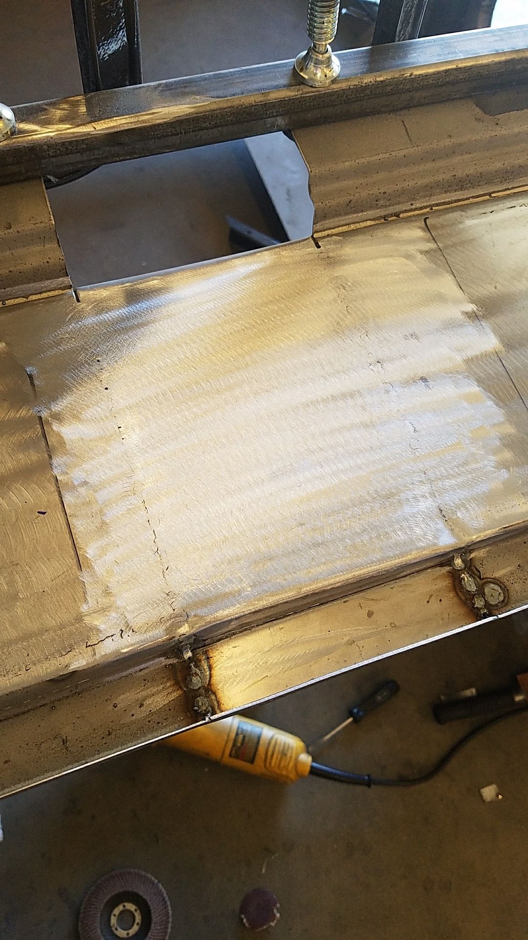

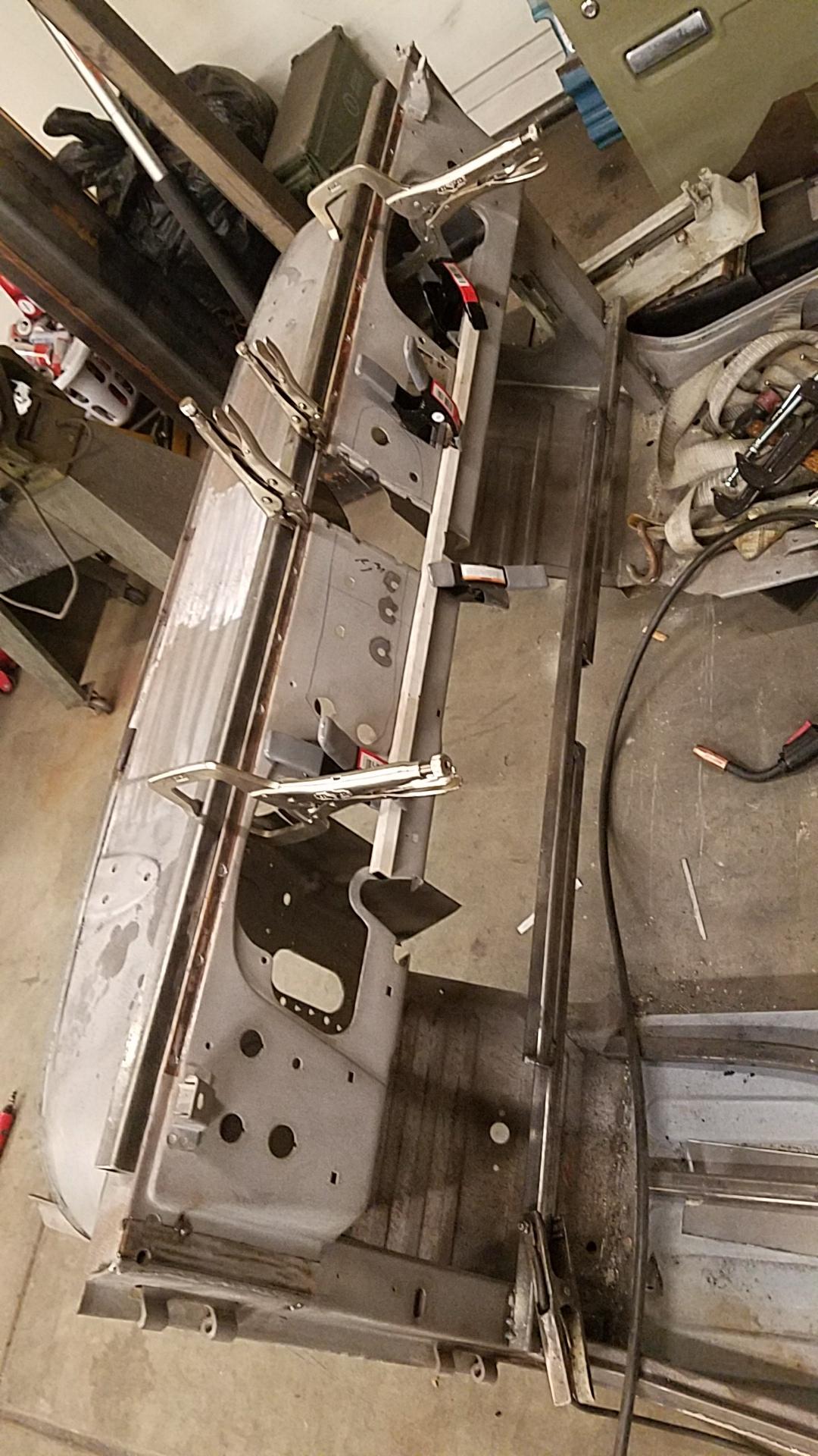

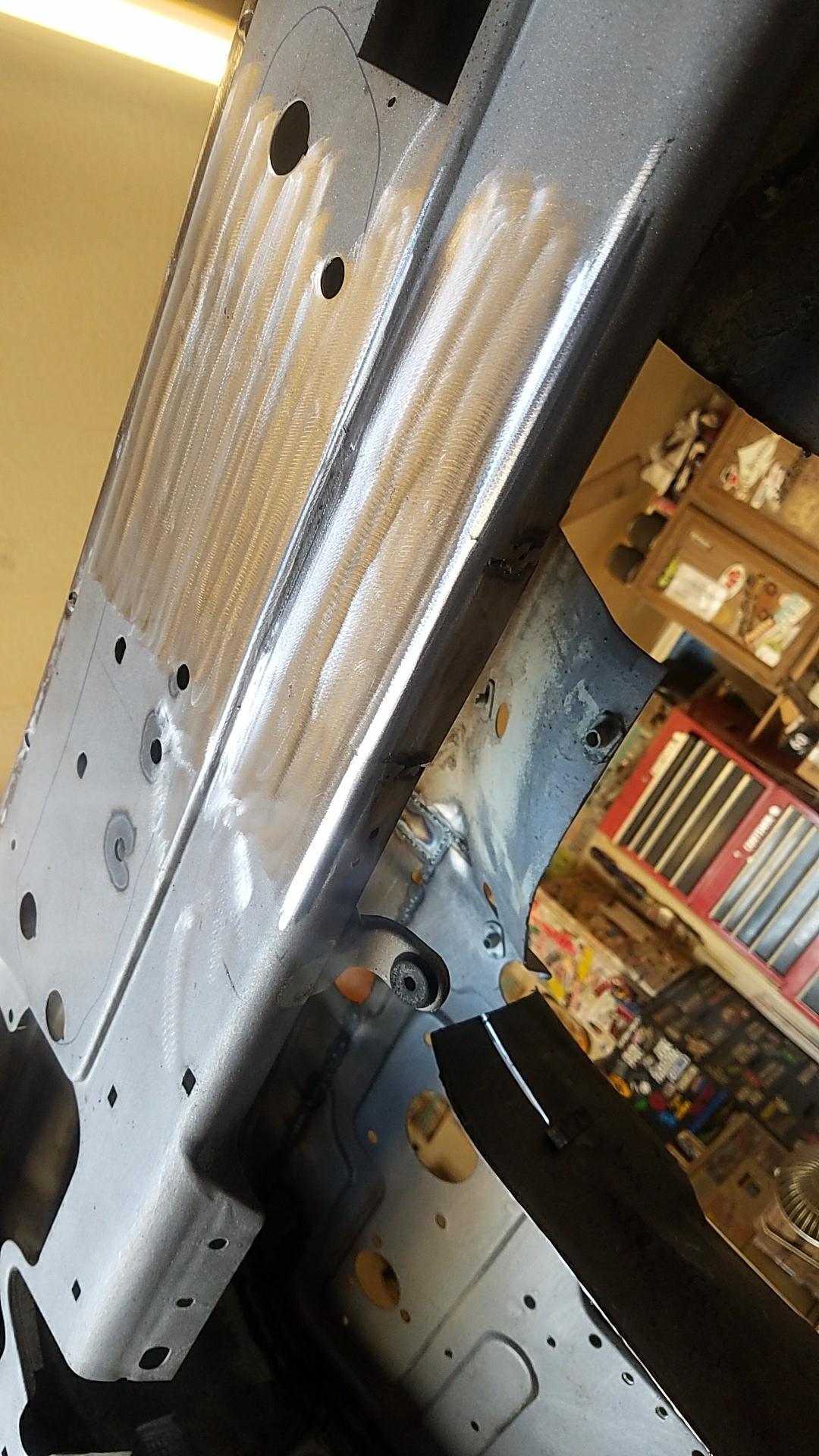

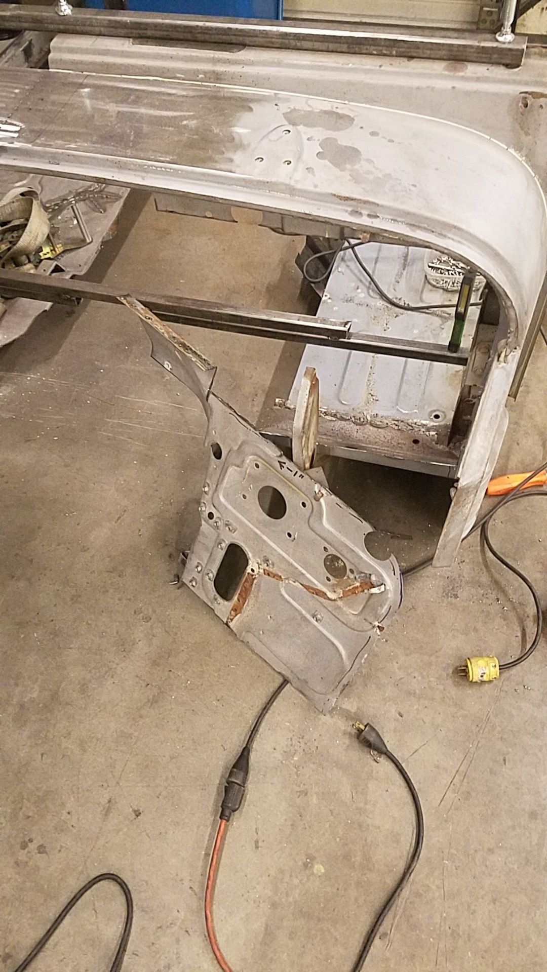

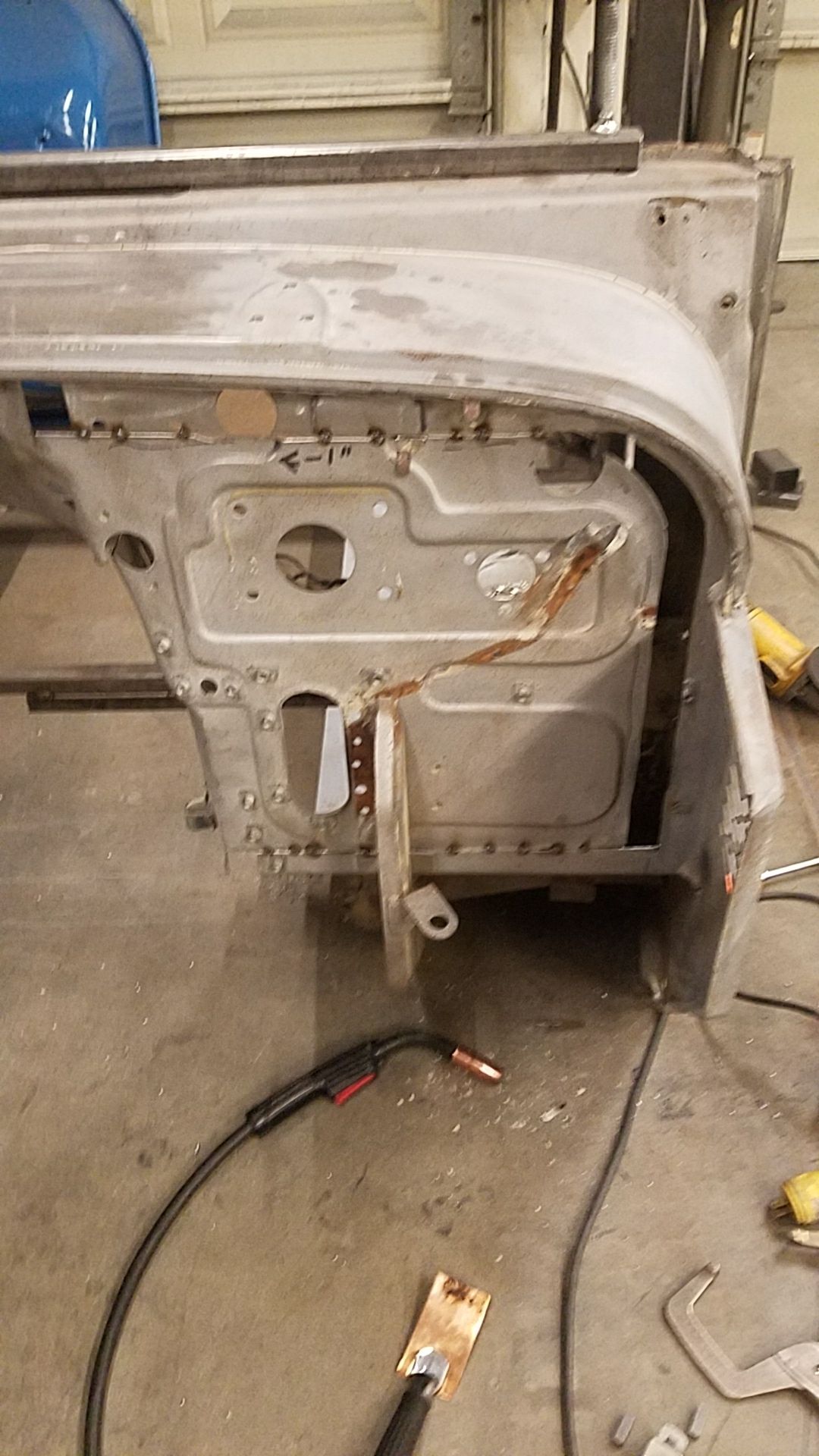

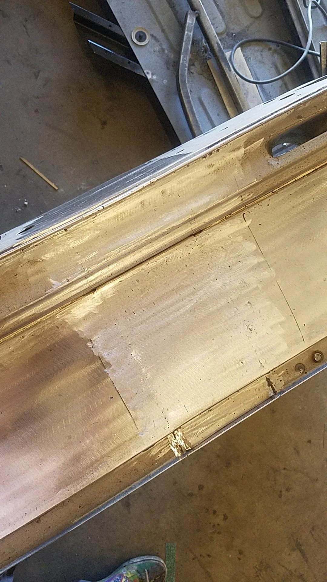

Are you going to add that rib back?
images

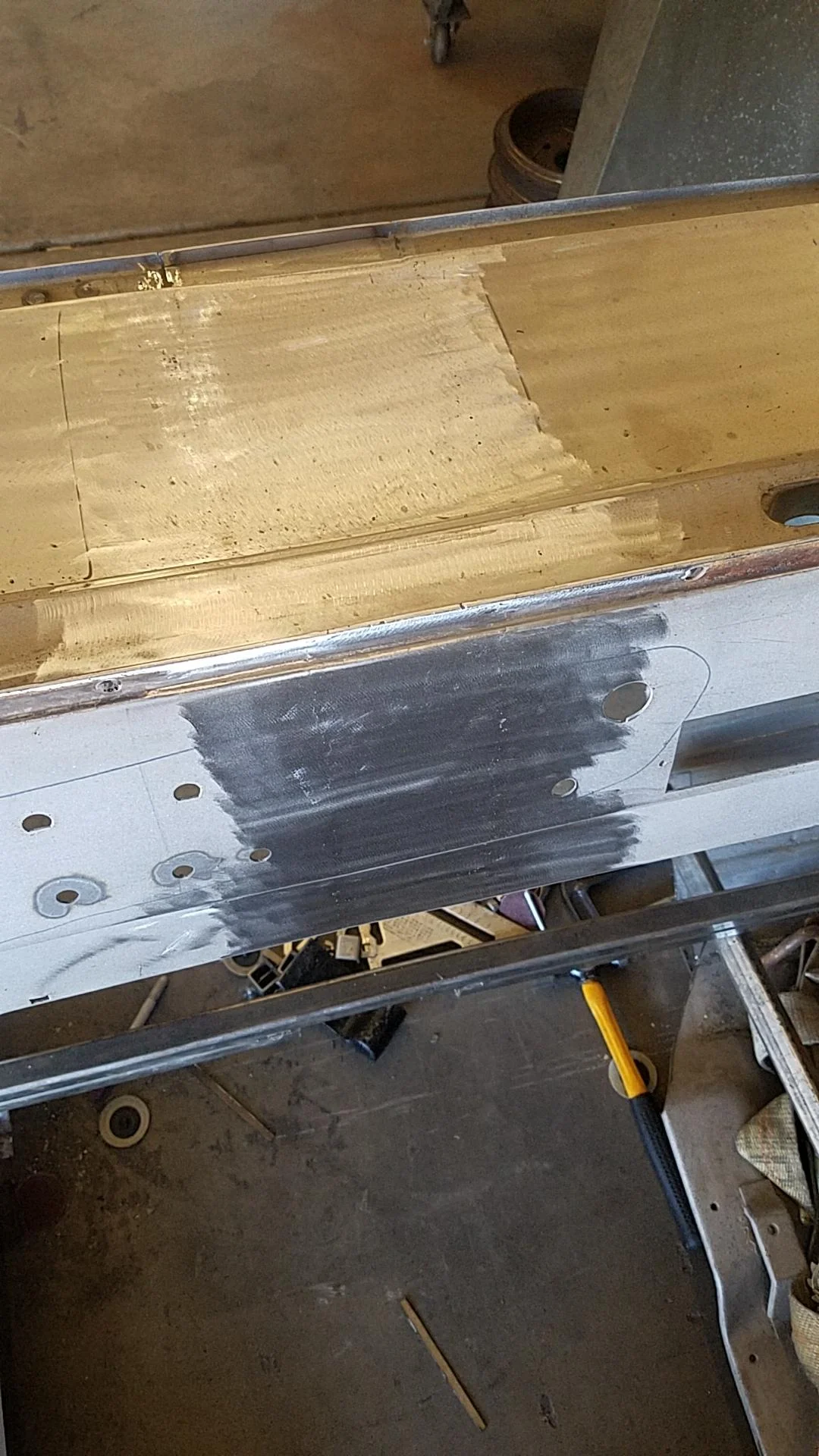

images
Not sure, going to have to mod that area for Dodge clutch master cylinder, and hydro assist brakes. If the brace fits in after that I will weld it in, or come up with a different plan to reinforce it
By the way, love the idea of shifting everything over 2 inches. Had never thought about doing that change, but it makes tons of sense.
