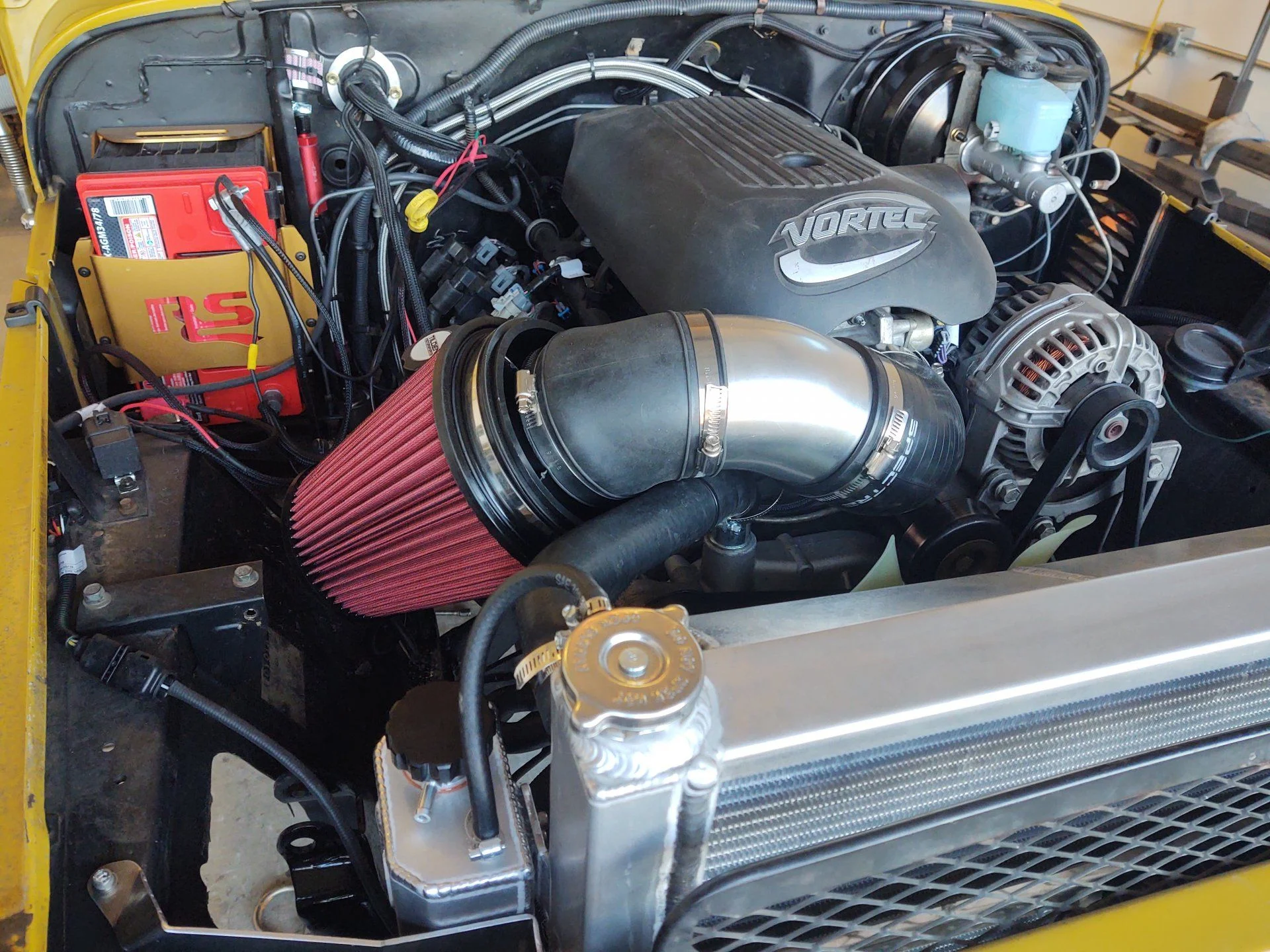

Air filter is in

Thanks, I really like the terminator. Only complaint I have is that you don't get all of the options on the hand held programmer. I needed a lap top to program which map sensor I was using. I also didn't like how rich the initial fuel map was set, very conservative. Once I leaned it out (really easy and user friendly) it really started to run a lot better.Congrats on putting it back on the road. How do you like the Terminator?
If you are familiar with the sniper u will like the terminator a lot. The harness is labeled really well, and software is pretty much the sameThanks, I’m planning on using the LS Terminator on my next build. I’ve installed the Sniper on our 72 and really like it so far, I’m excited to put some miles on it next spring.
