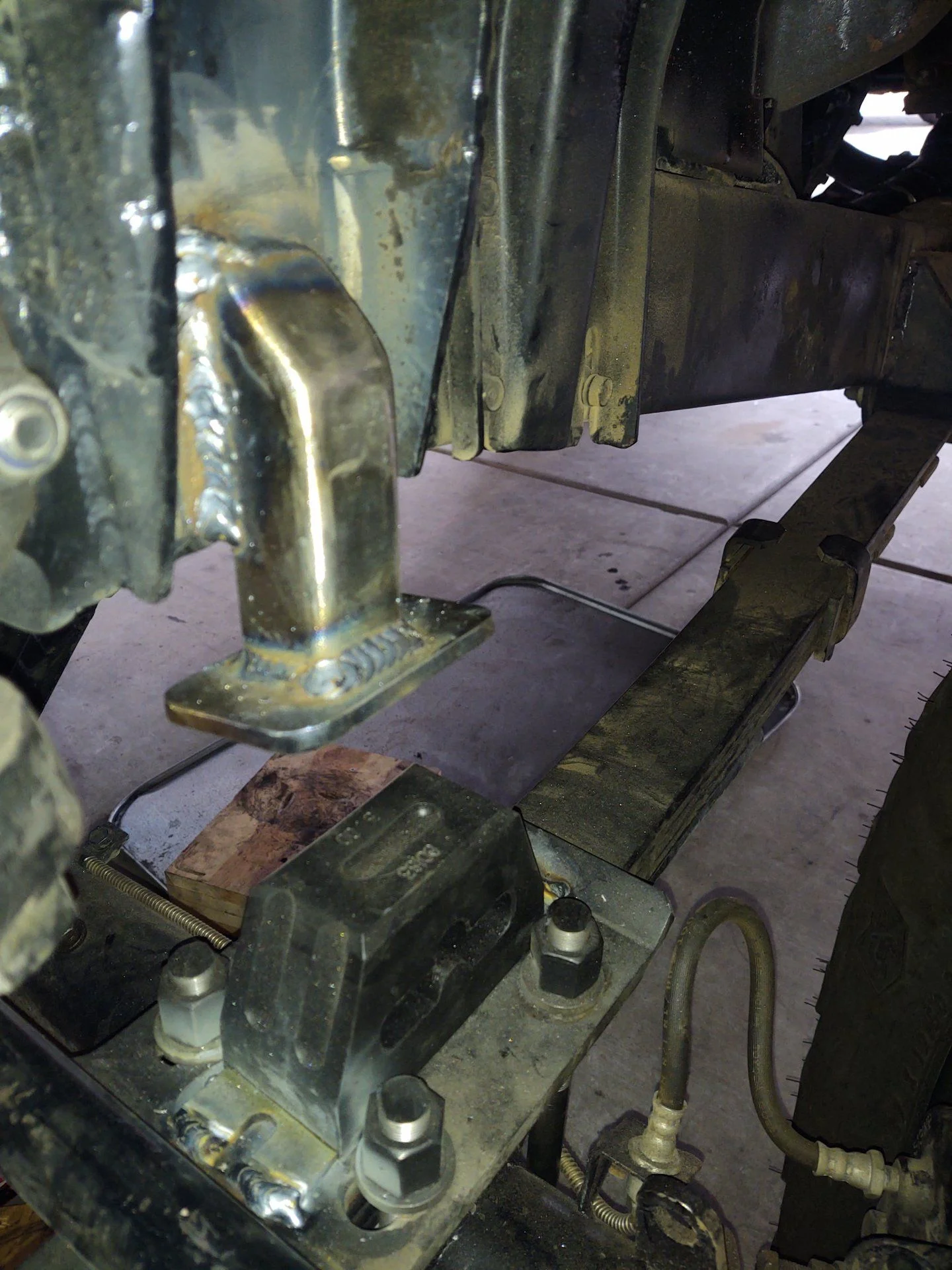

So after driving for a while I have some issues that I needed to address. First issue is notching the frame for steering gearbox was definitely the right call. Not notching the frame on passenger side was a bad call. When flexing the suspension, and it flexs really well, I had the steering linkages hitting the frame on the passenger side, and on the front cross member that the bib attached to. So I took it all apart and redid it.

So in keeping this as low as possible soa and 37's I have been having issues with clearance in the front with regards to tie rods. I added the over leafs back in and that gave me one inch more clearance. When bouncing on rocks I was worried that it was still going to hit, so just got done with some bumpstops. I don't have as much up travel as I initially wanted, but it is super stable. 3.75" up, lots down
