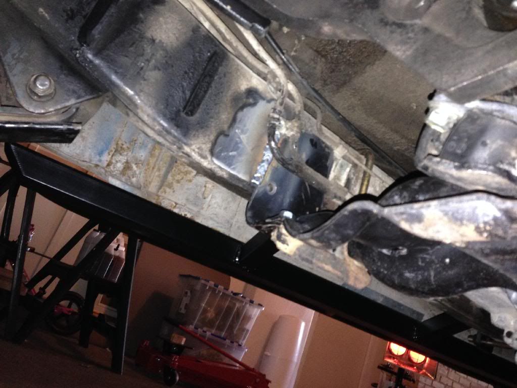

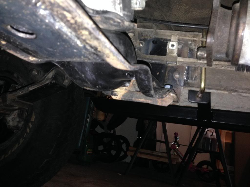

Got the cross-member burned in:
I was able to use a '84 FJ60 cross-member/mount cut down on the DS 1 1/4" and the mounting holes slotted a but. I had originally bought a '87 setup, but it won't work unless you go to the tilted bellhousing :-(

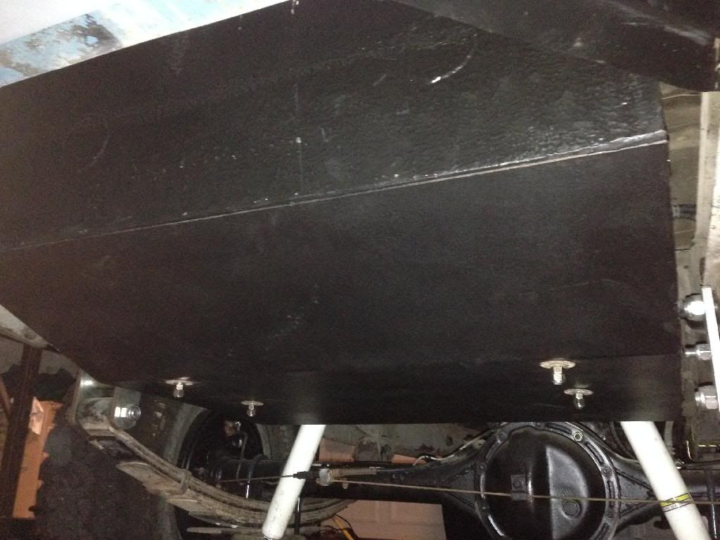

Tank installed:
