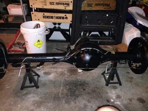

Spent some time assembling my '81 rear axle last night, hope to get it under the truck this weekend. Installed a 4:11 chunk from a FJ80 and got the brakes installed with new cylinders (shoes were rusty but still had a lot of meat so I re-used :hillbilly:):
Hopefully I'll get the diff cover sealed up and install the hardlines and ebrake cables tonight.

Tucker looks good. Have you thought about the E-brake cable yet. Where are mounting the handle? I'm commited to useing a 60 handle, which will hopefully mount to the left of the driver's seat.
I'm going to try to use my dash pull and splice that cable with this one similar to what LAMBCRUSHER did, I'll go to a floor mounted 60 setup if that doesn't work (worried about getting enough tension). The mini trucks used the dash pull setup with axle drum ebrakes, so I think it should work?
