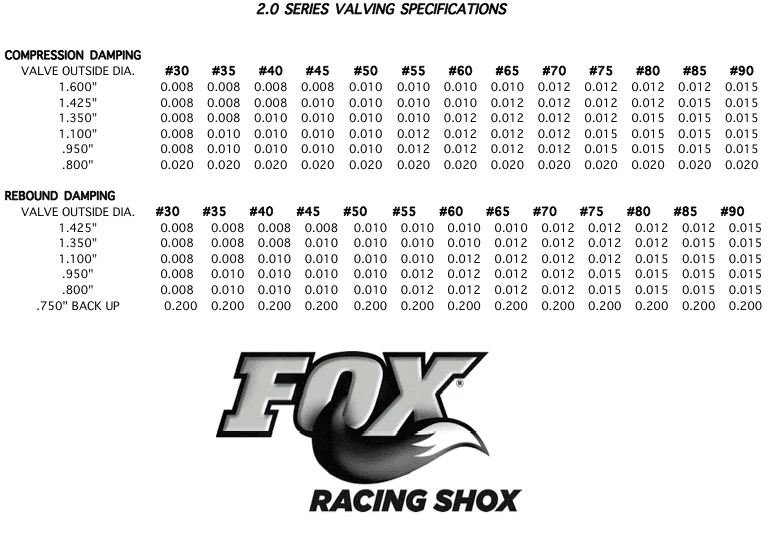

Below you can see fox's table for their standard valving. From this you can see the front is valved near a 40, and the rear is maybe a 45 ish, but it doesn't quite match up.
Thoughts:
This setup functions much nicer than the previous setup. It is still a bit stiff compression wise both on and off road on the small bumps., even with an ARB/winch up front, fridge, rear swingout, etc. It also feels like it could maybe use a bit MORE compression on the high end for bigger hits. However, at some point I have to realize this is not a position sensitive shock and have to design for what conditions I would typically run, which is washboard.
I think the rebound is pretty good where it is, and matches up fairly well with the spring rate (OME 850/863) and the weight of the vehicle.

Current valving is:
F-70-90
R-55-90 with compression adjusters
I believe they're running single bleeds, and I'm running 150psi nitrogen at full extension
Plans are to try something along the lines of what COAX has ended up with but a little different as I still need to retain some control over my heavy wheel and tyre combo..and weight/height
I'll add a couple of options I've come up with using the crossover type shim arrangement installed in the 3rd position
I'm aiming to gain some medium speed compliance and high speed to be quite a bit softer.. Without sacrificing much of the low speed control
Shim stack lists In order of first idea and second.. Second is in theory I believe softer (easier deflection) high speed by swapping the last two small diam shims down to thinner options and decreasing the overall shim stack thickness at the same time should give a higher deflection for the same high speed force ?
I think I'm reasonably happy with the rebound although may opt to drop that down to a 75-80 once I get the compression behaving how I like
