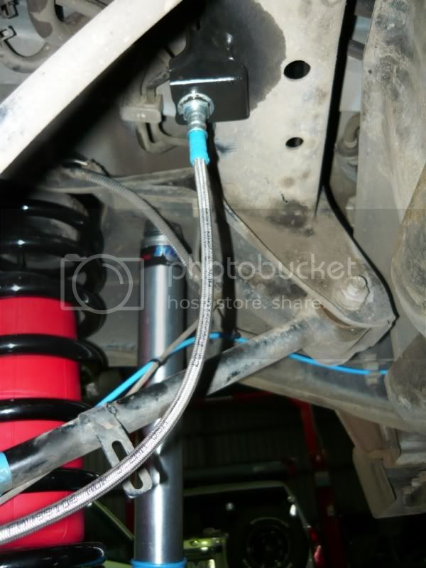

We have moved away from Fox, after lots of supply issues, and the pins poor welding seeing them break off the top of the 2.0 Fox shocks on 80's and 100's.
We are now using 2.5" rr adj Kings, ride quality is improved, strength fixed, lengths custom, like the Foxes we used with ourr adaptors etc.
My last 80 on 35's, which was factory multi valve hdft, we used air bags in the front coils, and rear coils, with Fox custome valved 12" stroke 2.0's, and loaded offroad at speed, we had the problem of the snorkel pulling the screws out of the a pillar, because it didnt flex as much as the 80 did.

The King 2.5's have a whole cup style arrangement welded in, where as the fox has a pin not even spiggotted, welded around the shank, which holds the washer from fitting properly as well.
