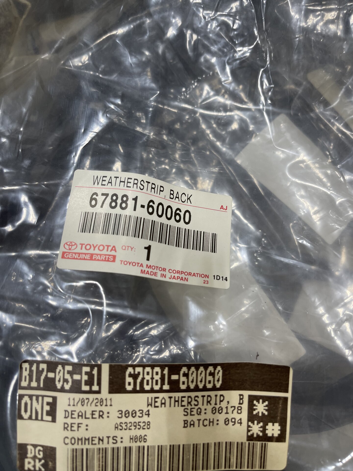

I’m hoping I can find the parts in the stash but it’s can’t recall what the rear window channel consisted of?
Doesn’t Slocruisers rear sill only protect the glass from connecting against body, without the channel?

Did little investigating and tried to reset window in drivers door without any luck.
Seems like if I was able to pull window up all the way I can get it set in the channels. Lots of play in the window mechanism and window binds up 4-5”s from being all the way down. In brief time I was playing around it appears that it is getting caught up between track and door mechanism.
I’ve got to think Chris has all the parts to repair it but I don’t get those parts until Friday. I was hoping to drive it some more today but we finally have some rain!

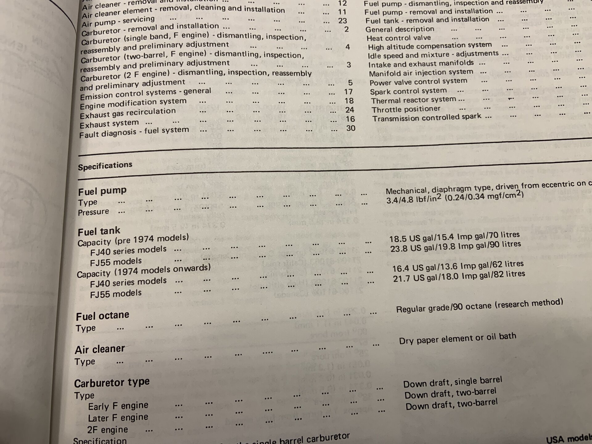

Anyone share how many gallons the stock tank is? This looks like stock gas tank?
No help on either window but yeah that appears to be a factory tank
Isn't a stock tank 23 gals. ? Can't remember anymore.
Some reason and I have zero evidence for my thoughts I thought it was less.

Wife working on getting insured and obtaining tag. Hopefully I can get windows addressed in the next couple week, if I can round up appropriate rubber!
Looks like 21.7 for the 76. Just got me curious after half tank and I put 13 gallons in but who knows how accurate the gauge is??
I must’ve been thinking FJ40, but I swear I never pumped anywhere close to 20 gallons into mine🤷🏻‍♂️
You would have if you filled it up to the cap heading out of Moab to Canyonlands. I think the plumbing kicks the fill off prematurely most times.

Sucks, I don't know where any of the books for the Land cruisers are. I need to research the rear tailgate to figure out the window seals
