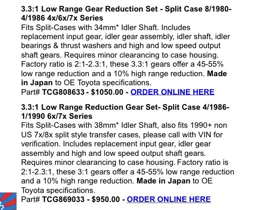

I think it’s the other way around, for instance normal OD is around 80% or like 0.8:1, a 10% reduction makes it 0.9:1, less OD, more rpm at the same given highway speed. But, I’ve been wrong before...
Me too!
It's a mystery...
Here’s the description from Cruiser Outfitters. Maybe someone can chime in with the low-down.

My low gear is 4:1 and the high gear does have a 10% reduction, which I didn't know at the time of purchase, assumed it was an overdrive. Anyway, I have 4:11 gears, 5 speed overdrive transmission and 33" tires with the 10% reduction = it does great all around! 🤷‍♂️ I guess a guy could get better highway speed with a different setup, but she does 60 just fine and RPMs never go above @ 2700.

It looks like your hi would 1.1 to 1.
