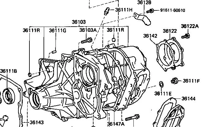

It would appear there is supposed to be a freeze plug in the split case just above the out put shaft.
:bang:
36111R or 96411-11600
It also would appear I do not have said plug installed. At least it is at the top where it will be easy to get to. :bang: :flush:
shifter shaft bore caps...is it leaking? more of a welch plug IIRC...
Oh, yeah. It sure is leaking. I stuck my finger deep in there an seem to have found more than plug. :lol:
I bet I could get a plastic plug at Ace Hardware and shove it in there. I did not notice a pass thru there when I put it together.

It would appear there is supposed to be a freeze plug in the split case just above the out put shaft. :bang: 36111R or 96411-11600 It also would appear I do not have said plug installed. At least it is at the top where it will be easy to get to. :bang: :flush:
this is an important post!
just jam some rubber stoppers in those holes till you can drive in the plugs...
That is the plan. It is there at the top. I can't see a problem with that so long as I get to the permanent fix eventually.

use grey gear oil RTV on the stoppers...
It is just one. I will take a pic.
