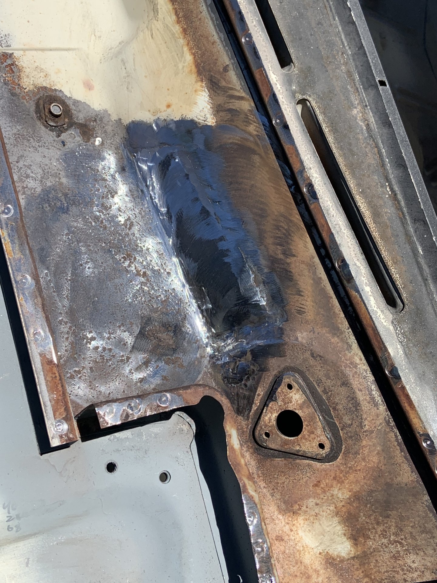

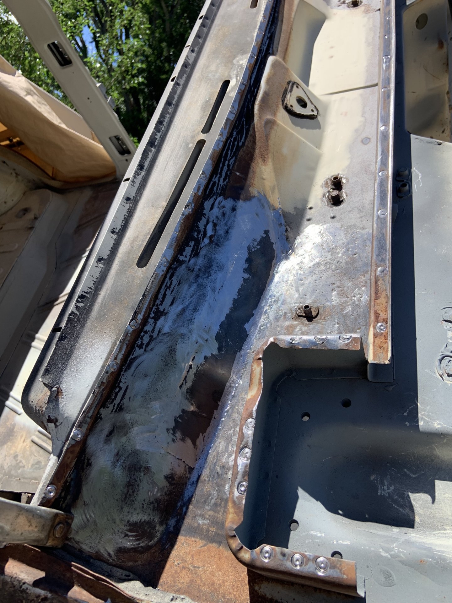

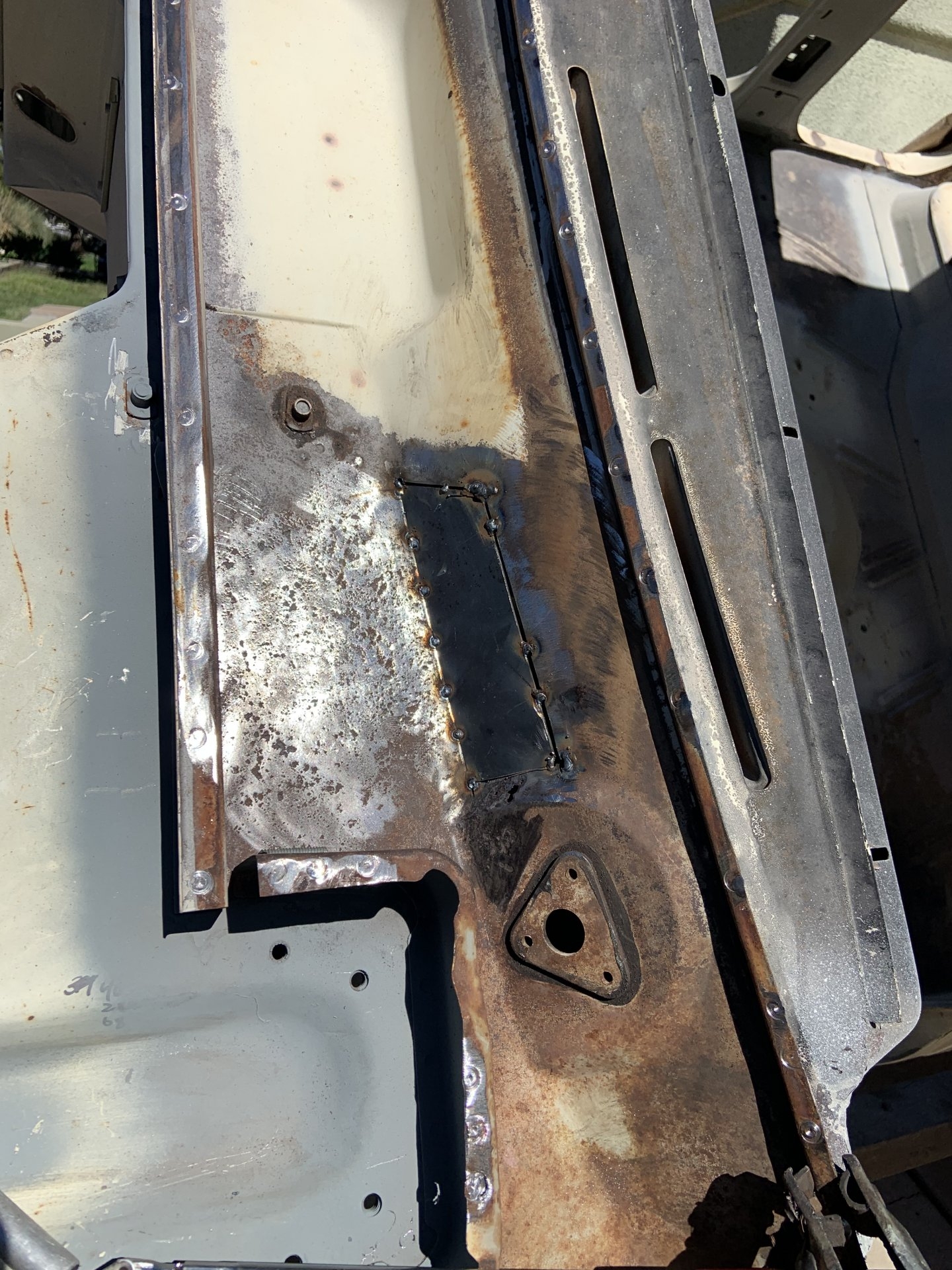

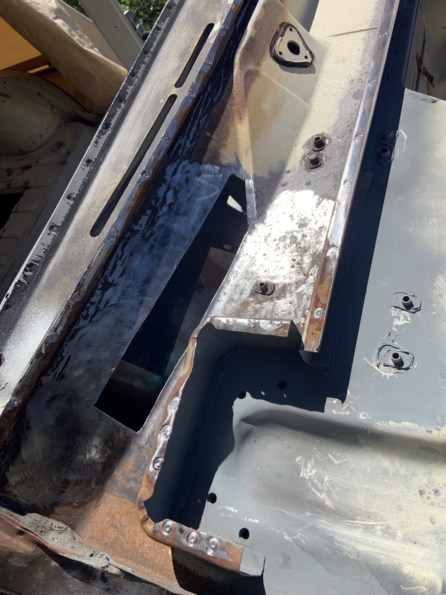

Step two of the cowl repair -
Cut out the rusted out areas and put in some fresh steel. Still thinking about laying down another layer of sheetmetal on top of the thinner, pitted metal in the trough. Might be unnecessary with enough layers of primer and paint? Don’t know, it’s not exactly confidence inspiring.
my thoughts on the layering is it may be a bigger moisture trap than properly treated single layer.. is it a strengthening part?
Neh, not really a strengthening part. Just a place where debris and moisture likes to get trapped and start the process over again.
