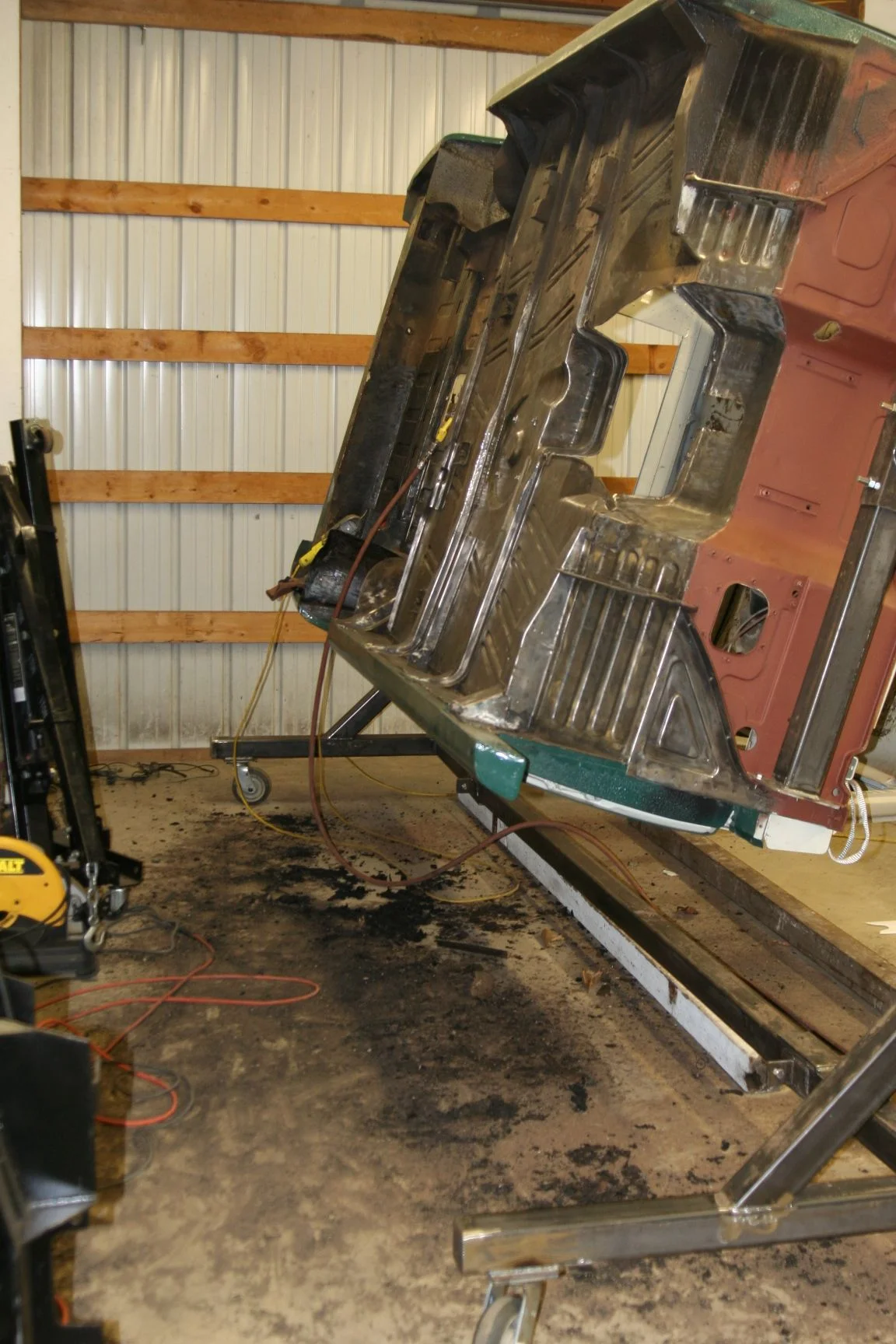

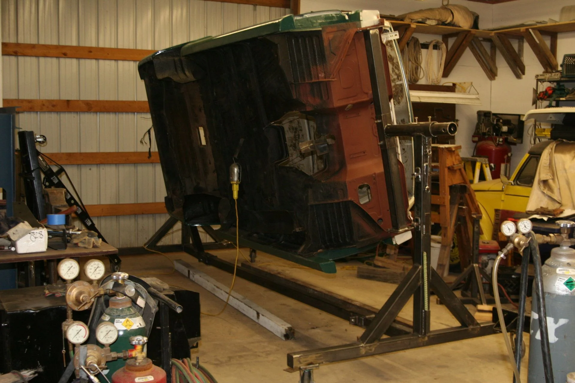

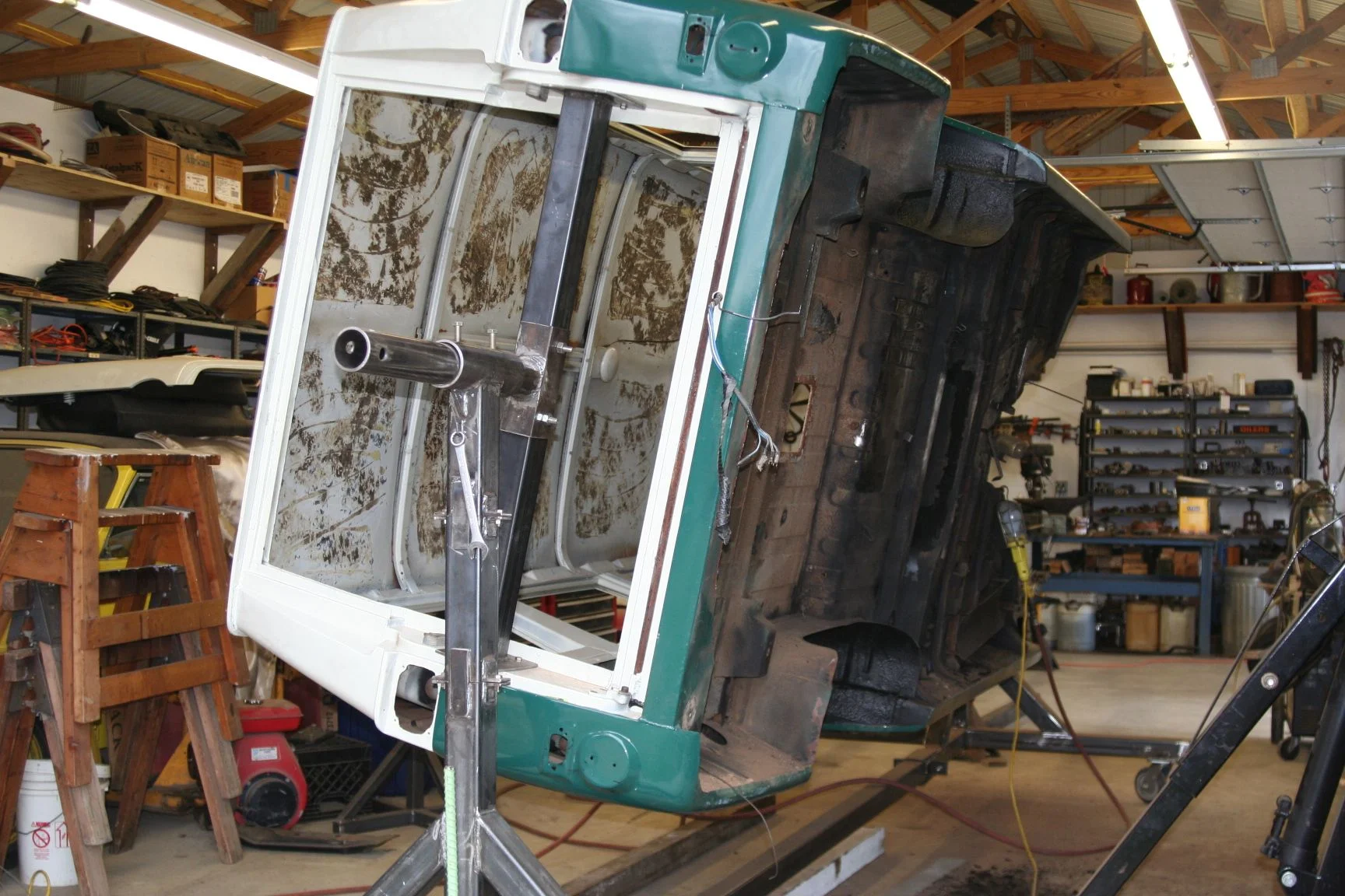

I used my cherry picker from the back after tail gate was off. Used a hi lift under each a pillar . Took about an hour working my way between each lifting point. Rolled chassis out and put it on blocks until I got my rotisserie.
I was thinking about picking up a couple of cheap engine stands and chopping them up to build the ends - not sure yet. I’d like to build them so the height can be adjusted, maybe just have pins and change the height with hi-lift jacks or something.
What do you think about building the base out of 4”x4” lumber with 3 casters on the ends and possibly one under the center of the long section, then building all of the diagonal supports and uprights out of square steel tubing?
Been kicking this around for a few weeks. I think it should be strong enough. A 12’ center on top of two 8’ ends with casters.
Any idea what the weight of the tub is?
I've seen some without a connecting base. Bolt one engine stand to the tailgate holes and the other up front (can't remember the holes I used, have to look). I believe a 4x4 would be fine to connect the two. Only need it for a little while.
We had a rotisserie that was heavier than engine stand but not connecting for spinning Datsun’s and Alfa’s, worked fine...no rollers though.
Huh.
I think about using actual engine stands like that and they don’t seem tall enough (to spin a tub without it touching the ground) or nearly wide enough (to keep from tipping over while spinning). But I guess some guys have done it?
Mine’s gotta be mobile, the plan is to work on it outside then wheel it into the garage to keep it out of the elements once paint has been stripped off while doing bodywork.
Please post some pictures too. I am about to build one of these things and could use all the help I can get!
Absolutely buddy! Thought I might have had a sweet start on it today using my old 2-1/2”x1/4” square tubing sliders as the uprights, but 2” square won’t slide inside. Hopefully get a running start on that maybe next week.
