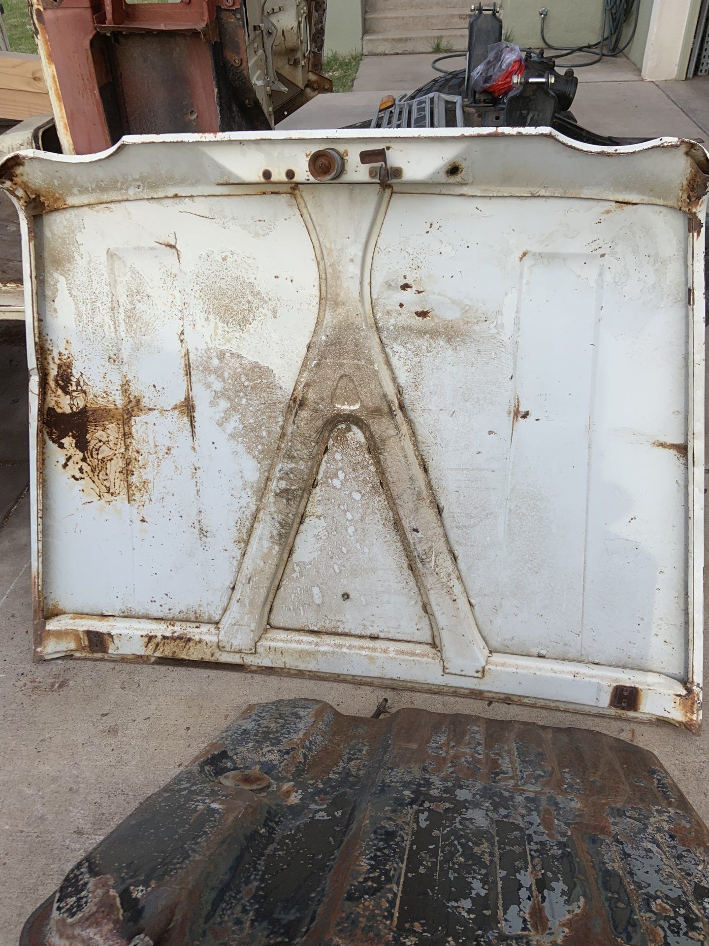

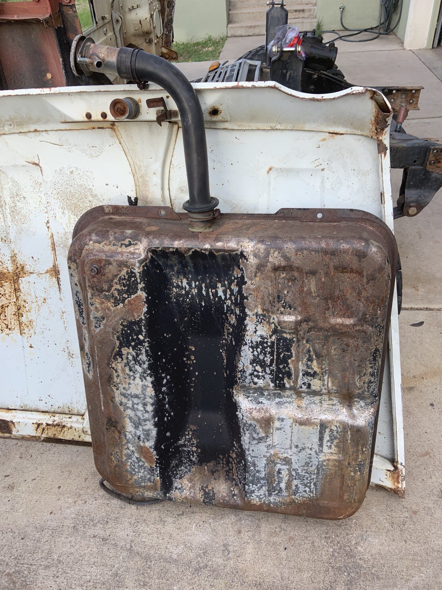

Picked up a small parts cache in Williams AZ today. Wanted to make sure nothing usable went to the scrapper before this group had a chance to see what all was there.
It’s not much, but an interesting story anyways.
Supposedly, the original rig was a 71 FJ55 that was imported in the 70’s. Right hand drive. The story was that it rolled onto its top at some point in the late 80’s and then just sat until recently (semi-recently?). It was dismantled and I picked up what was left.

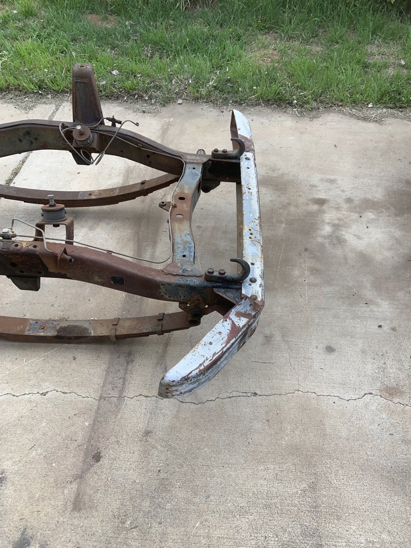

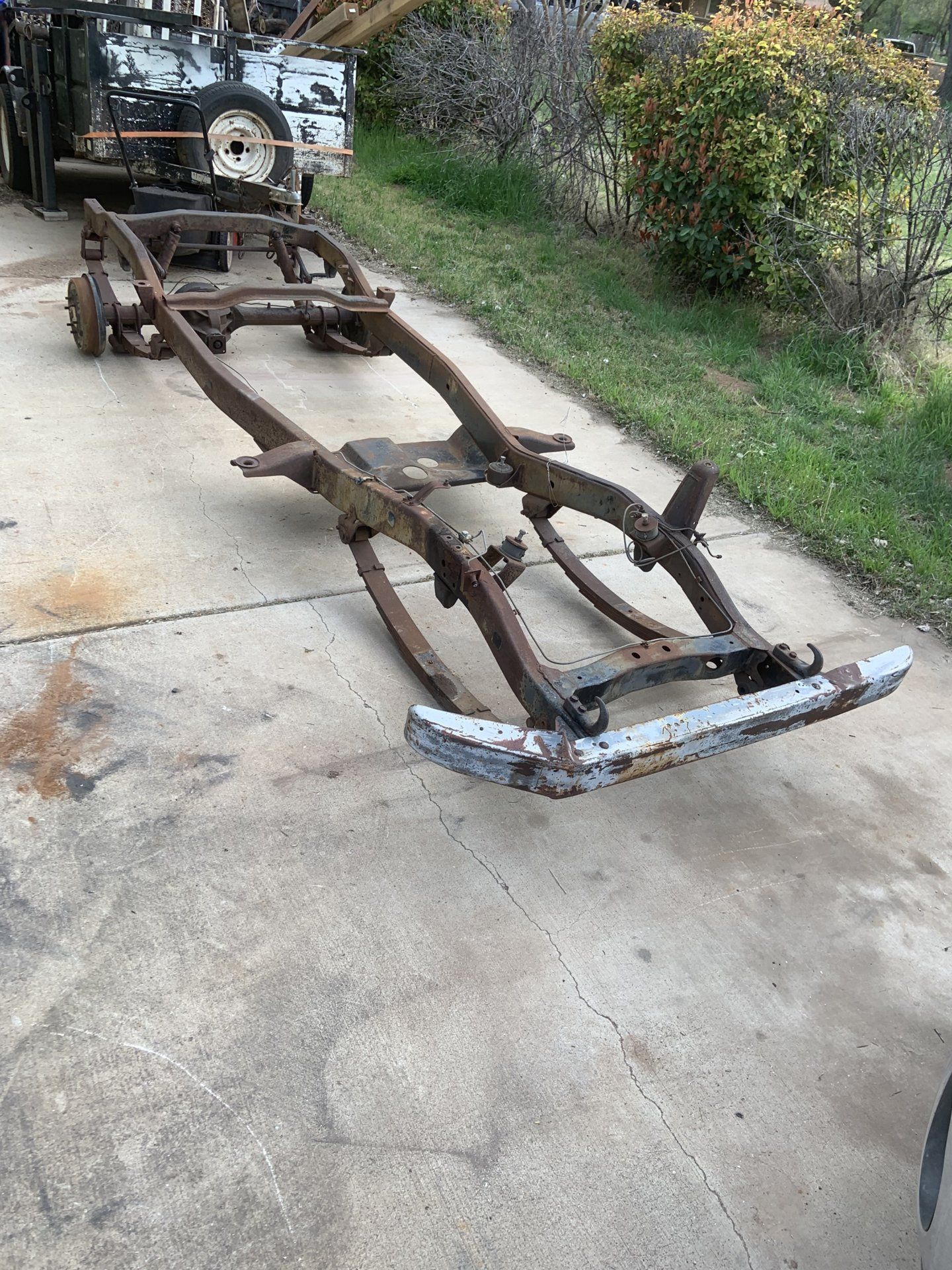

After an initial examination, I thought this was a FJ40 frame. But after looking a little closer, it looks like someone chopped the frame at the rear.
That fellow in Williams was the one selling ambulance doors a few months ago. He never would tell me what he sold them for. Always nice to get more parts. Grill looks nice.
