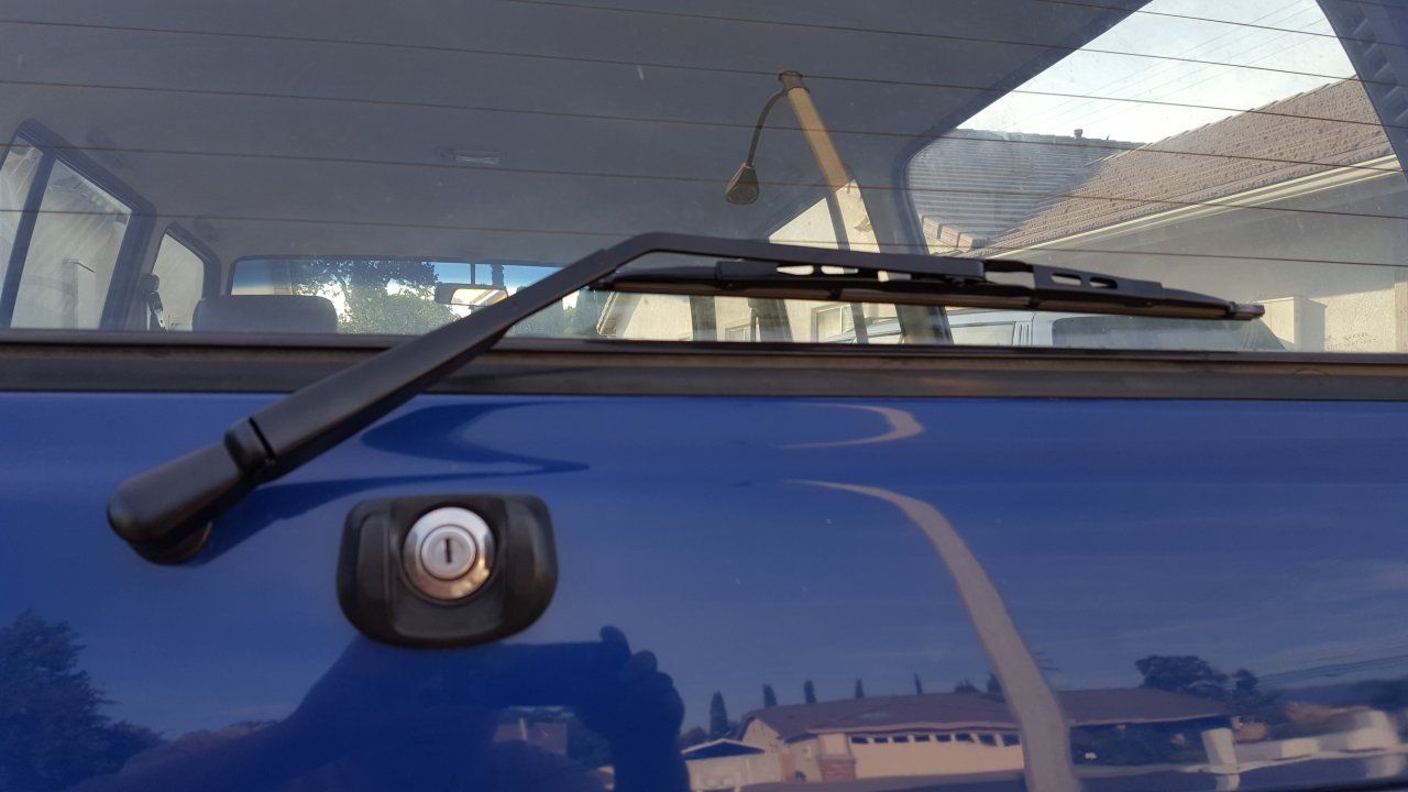

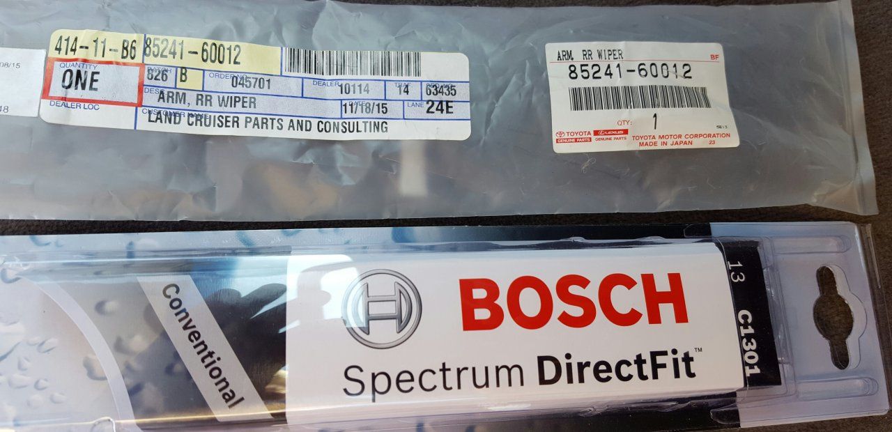

Any chance fj80 is similar upgrade?
I think the rear from an 80 works for the rear of the 60.

yeah mine came from a pick a part too. Two left hand arms from a 3rd gen runner. I scuffed them with a red scotchbrite and painted them and they looked brand new. Got both for like $15. Same with the 80 series rear

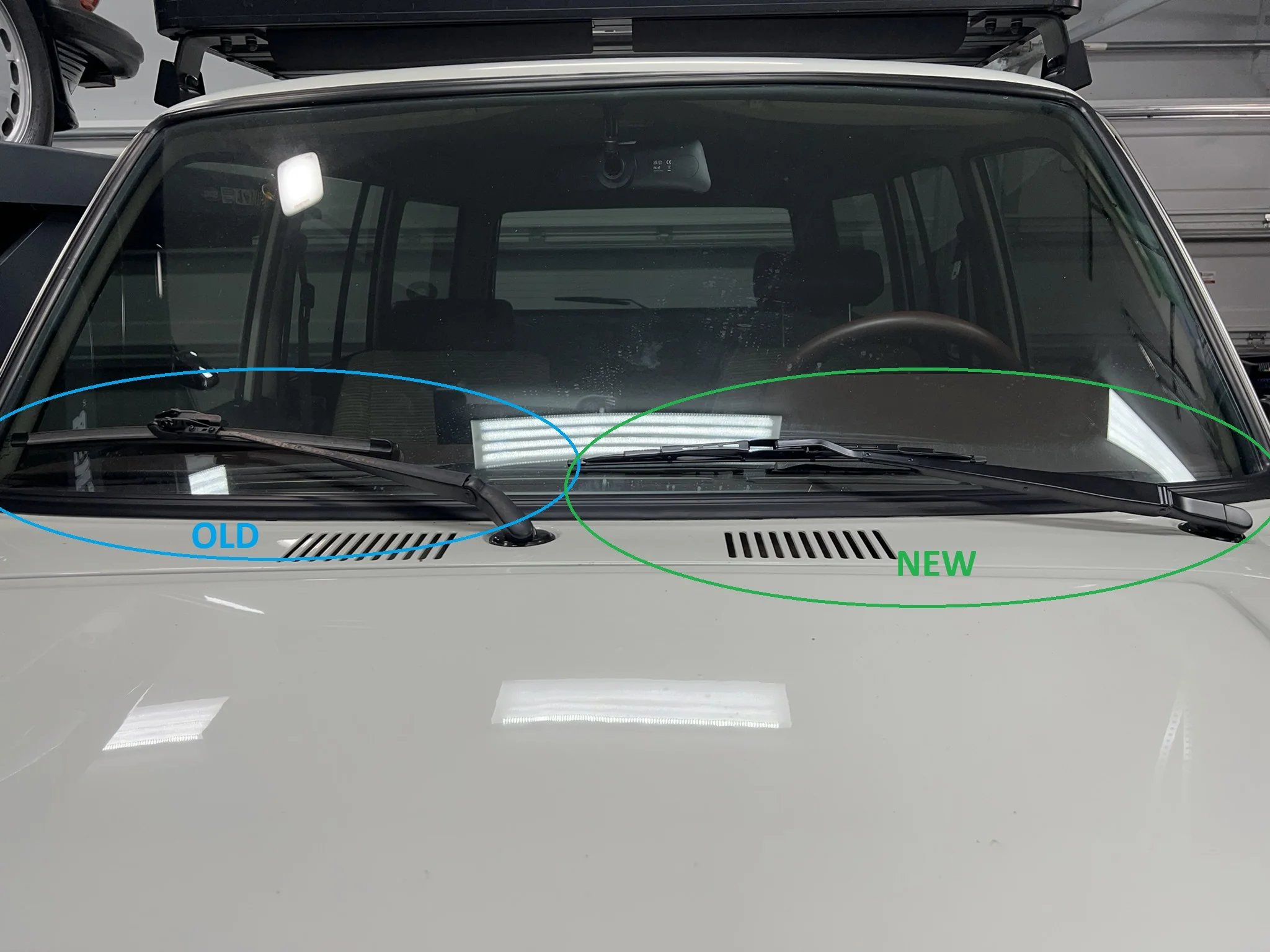

I’ll bump this thread and say that this truly is one of the best mods (and I’ve done a bunch) that I’ve ever done on my 62. Wipes cleanly and “silently.” Wow!

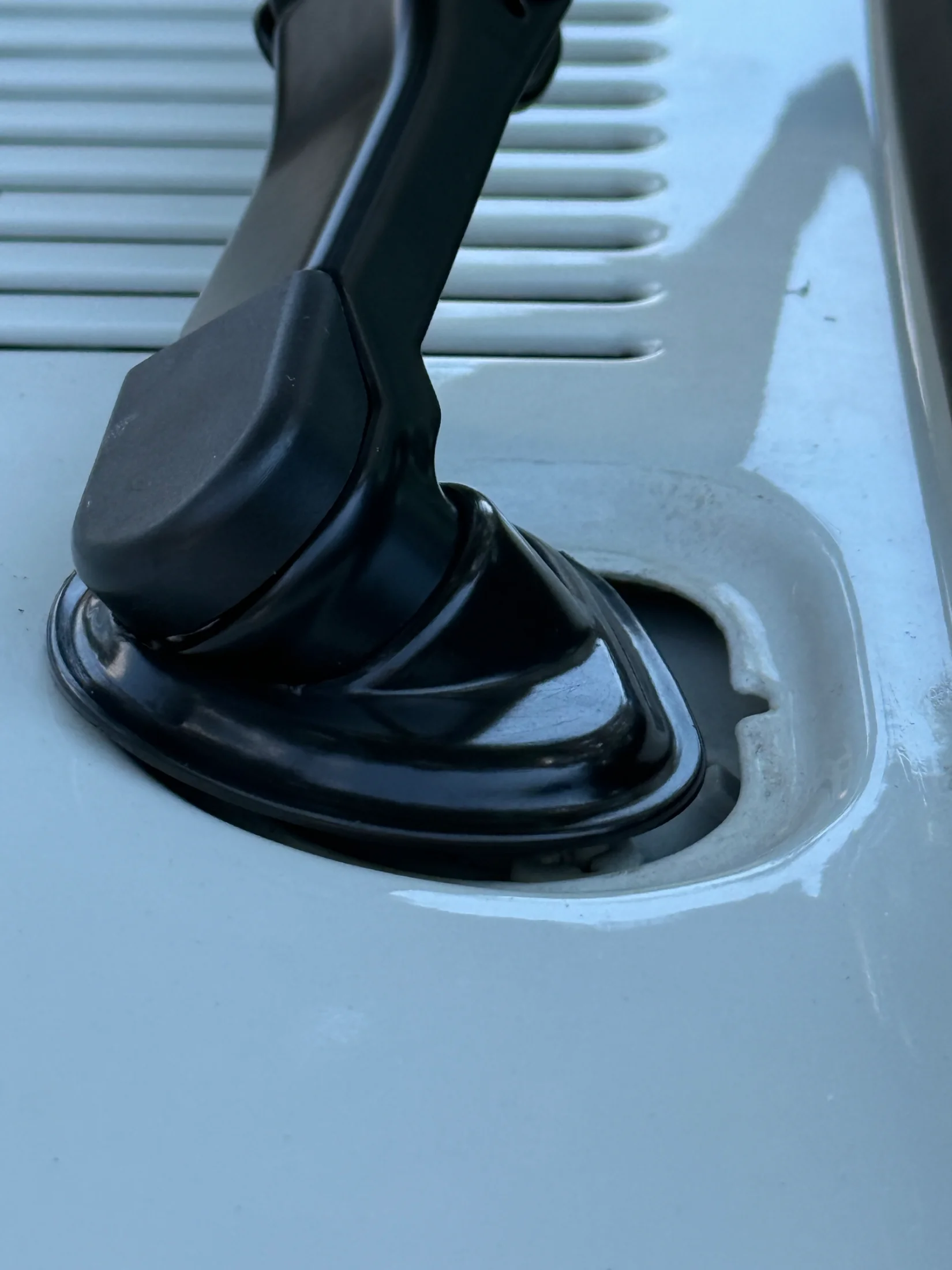

For those who have completed this upgrade previously, did you have to modify plastic cowl guard (85247-90A01) to fit with the upgraded arms (85221-35080)? When installing the new, larger arms it forces my cowl guard up and out of its seating (image below).
