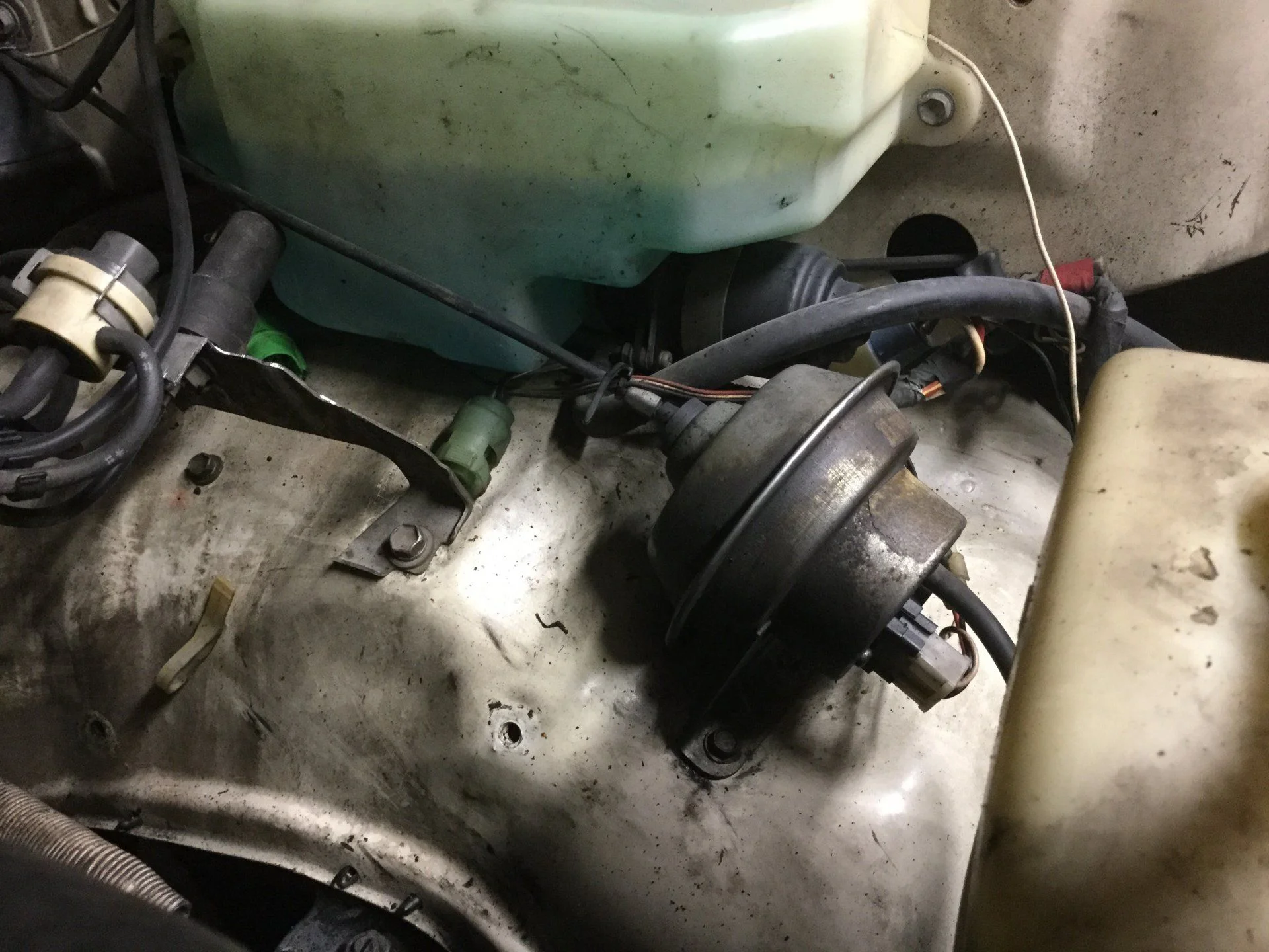

My only loose end is this thing. I don't know what it is and can't remember where the vacuum line was connected. Can anyone coach me on this?

I don't think that oem, I think it's part of an old cruise control set up. But I may be wrong, I am not denoted so it may be oem and hiding on mine
I thought cruise control to but there is no other hardware in the interior. The other end connect to the throttle via a small chain. It has a vacuum line that was connected before I started the desmog. Thanks for the reply.
no need to hook it up, plug the vac line. Pretty sure it was CC if it hooked to the throttle
It's definitely a cruise control module. I found the part on a hilux/ 4Runner forum. Funny thing is it is connected electrically. I assume it was use constant vacuum source so I connected it to the intake manifold fitting. Now I need to trace it all out because I definitely can't find the button that operates it in or around the dash.
